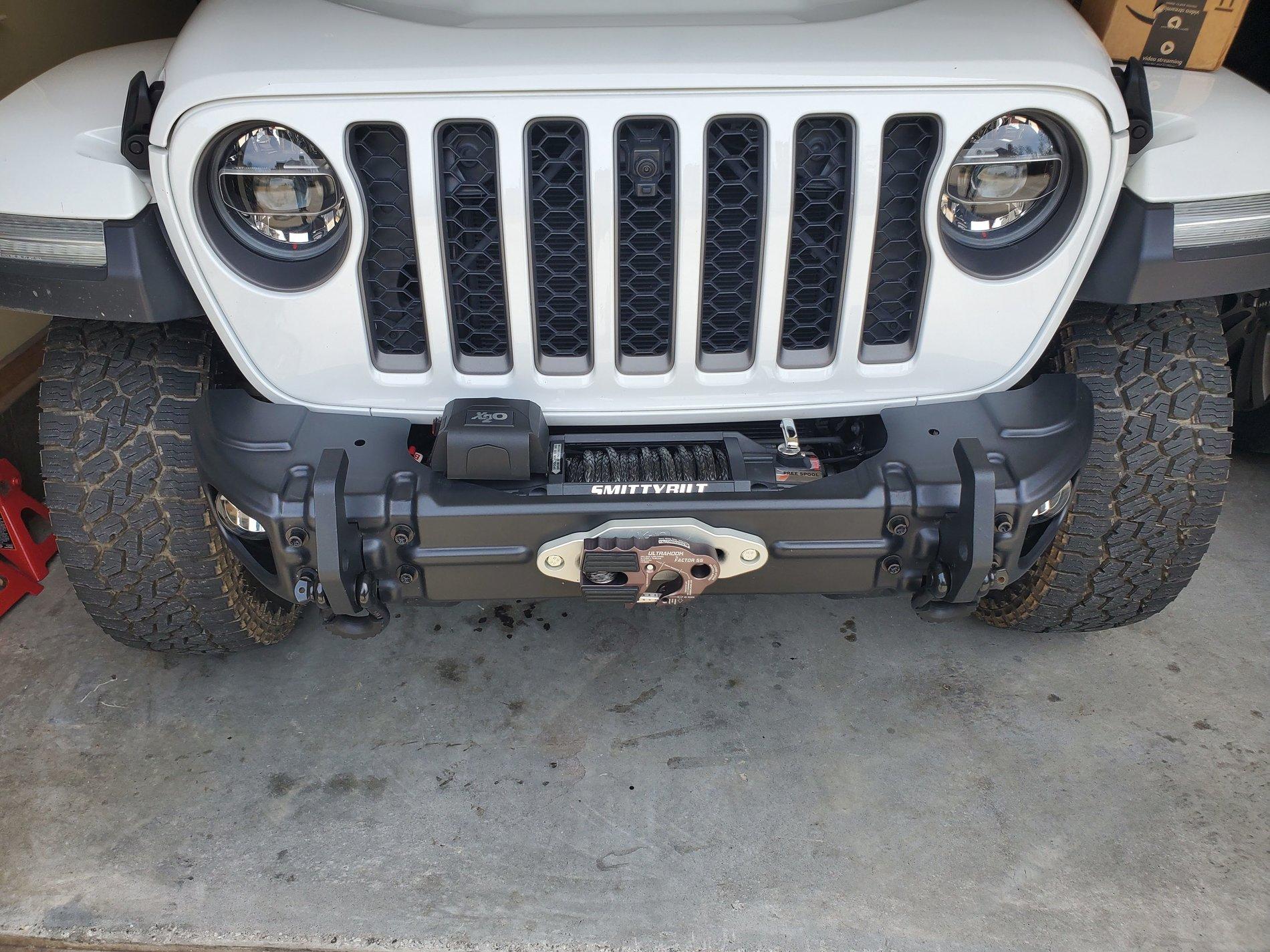

Looking to install this this Weeknd. Going with the Badland winch as well. Were any of you able to fit a cover over the winch to help keep out the elements? Of so which one?
I dont have a badlands winch, but my smitty doesn't have much clearance for a cover. I've tried and failed with covers so far.
