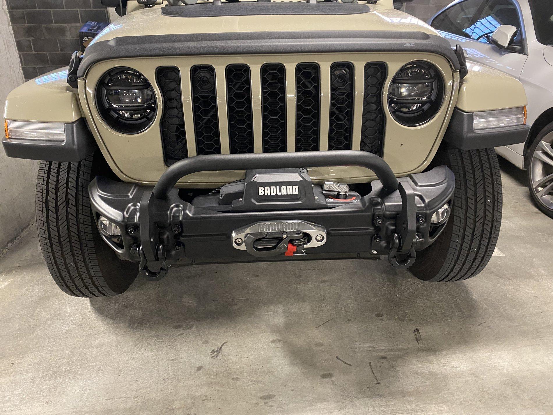

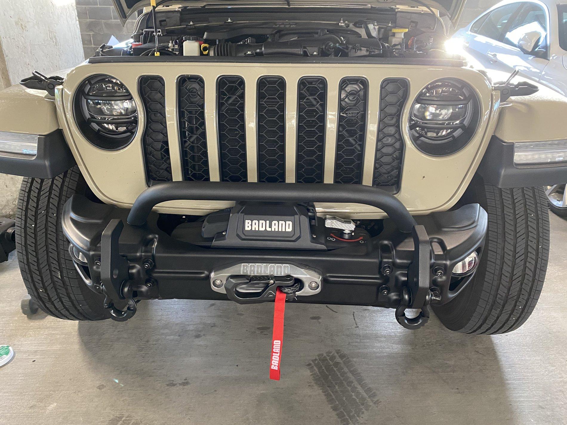

Looking to install this this Weeknd. Going with the Badland winch as well. Were any of you able to fit a cover over the winch to help keep out the elements? Of so which one?
Did mine today. Sadly I did it alone and getting that bumper on was a nightmare, although super happy with the outcome. I also drilled a new hole for the power wire to exit the control box, a little lower than most so it's actually hidden a bit more. Loving it so far, works great. Sure is a tight fit up against the grille, but I didn't bother using any spacers or washer, just shoe-horned it in.
Aberk
Jun 16, 2019
263
233
Atlanta
1997 Viper, 2020 Rubicon JT
I dont have a badlands winch, but my smitty doesn't have much clearance for a cover. I've tried and failed with covers so far.
