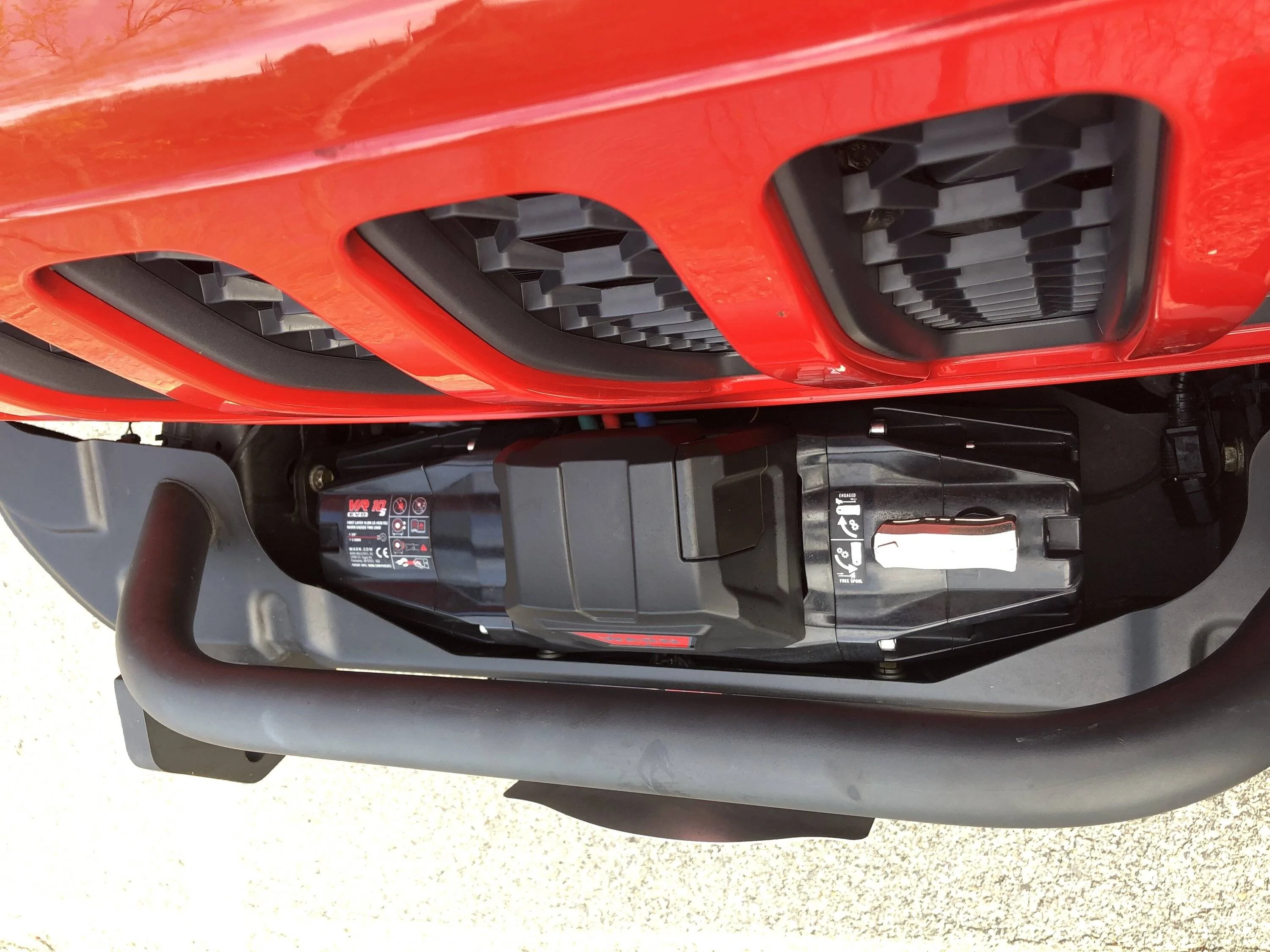

I have Smittybuilt X2O 10K in mine and it fits but its snug. No way I could take my grill off without moving the winch forward if required

I have the HF 12k older design winch on mine, and the cables coming out the rear of the box clear the grille by moving the box forward some (new holes in the box mounting brackets).

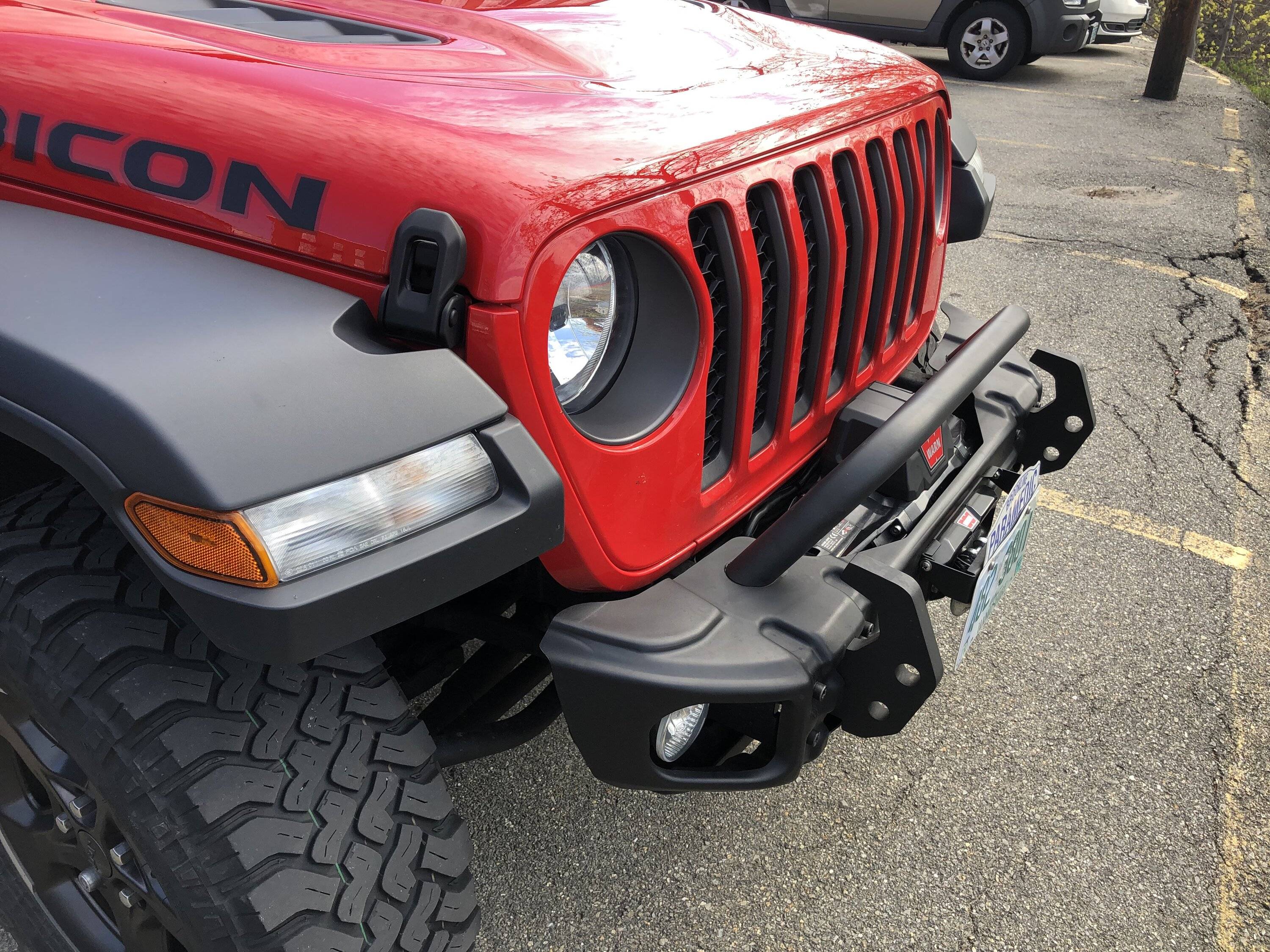

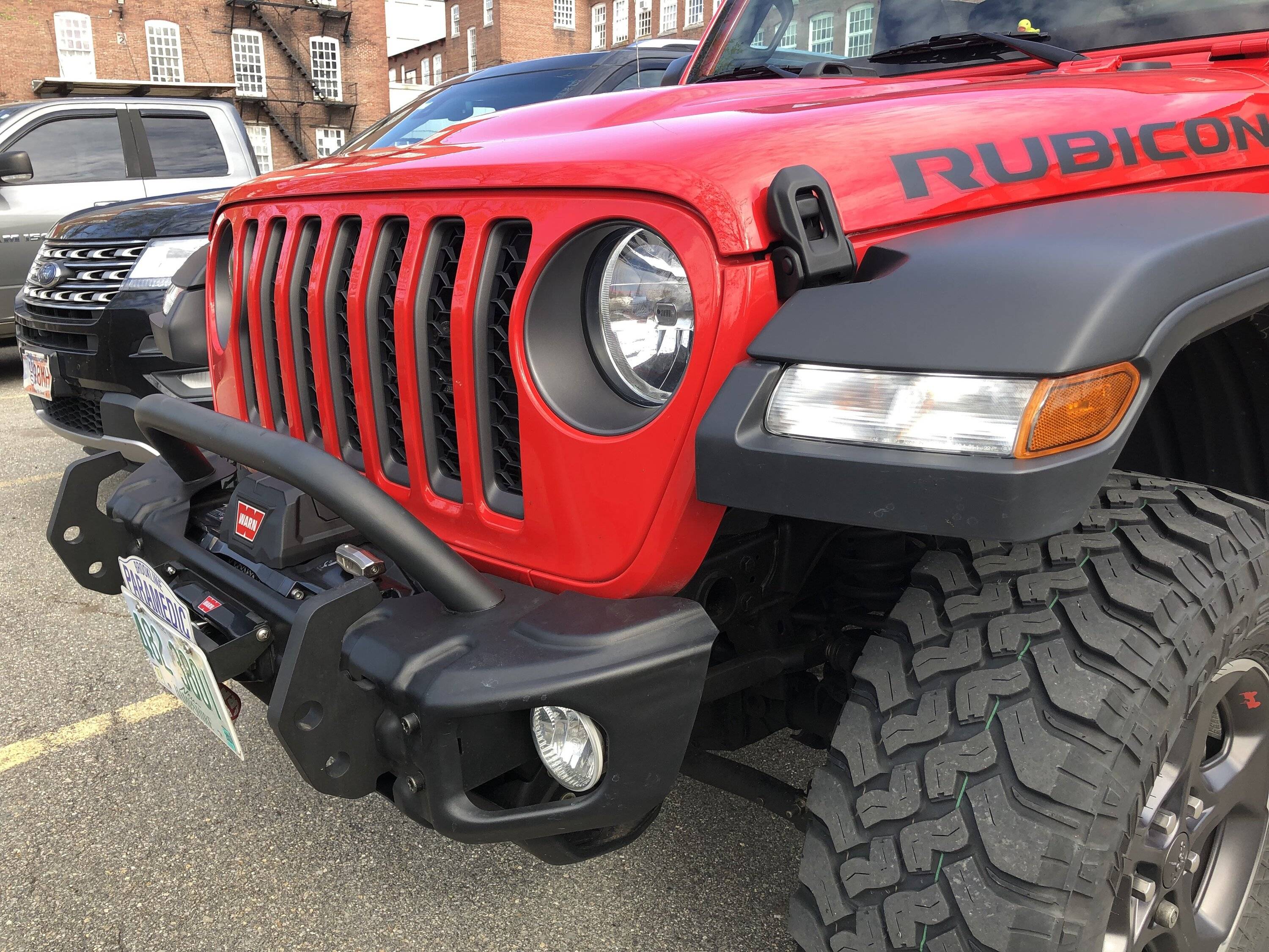

... here you go.
tight fit, but no mod to the grill. It's been a while, but the only "mod" was a couple washers between the skin of the bumper and the winch plate, just to give a little more clearance of the winch to the bumper. Fits well (and looks good!)

Are those the stock fog lights from your Rubicon?

Yes, getting them and the harness out of the old bump was a PITA. There’s like 2000 stupid plastic pins!

Perfect, Thanks! Been looking at the Arcus for a bit but hesitant since RR only mentions Sport and Sahara fogs fitting. Just found another member who swapped fogs from a Mojave. Good info.

The fogs from my 2022 Mojave bolted right up to the bumper.
