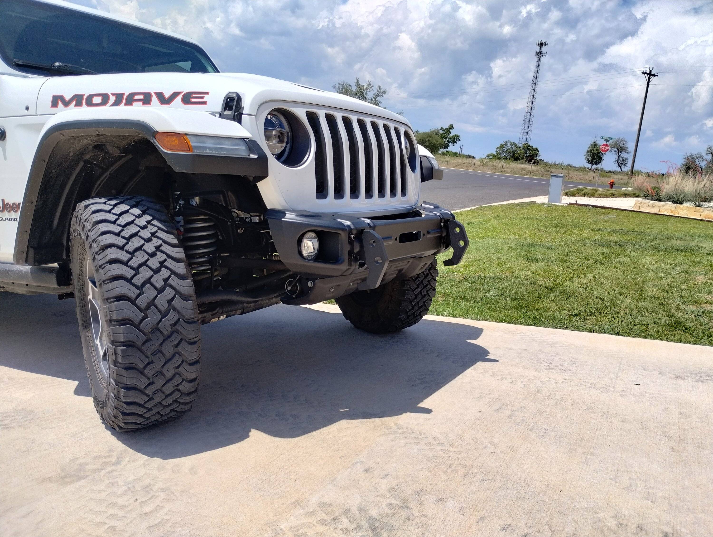

The XHD brackets stick out from the grille at the junction to the fender by about 9.3 inches.

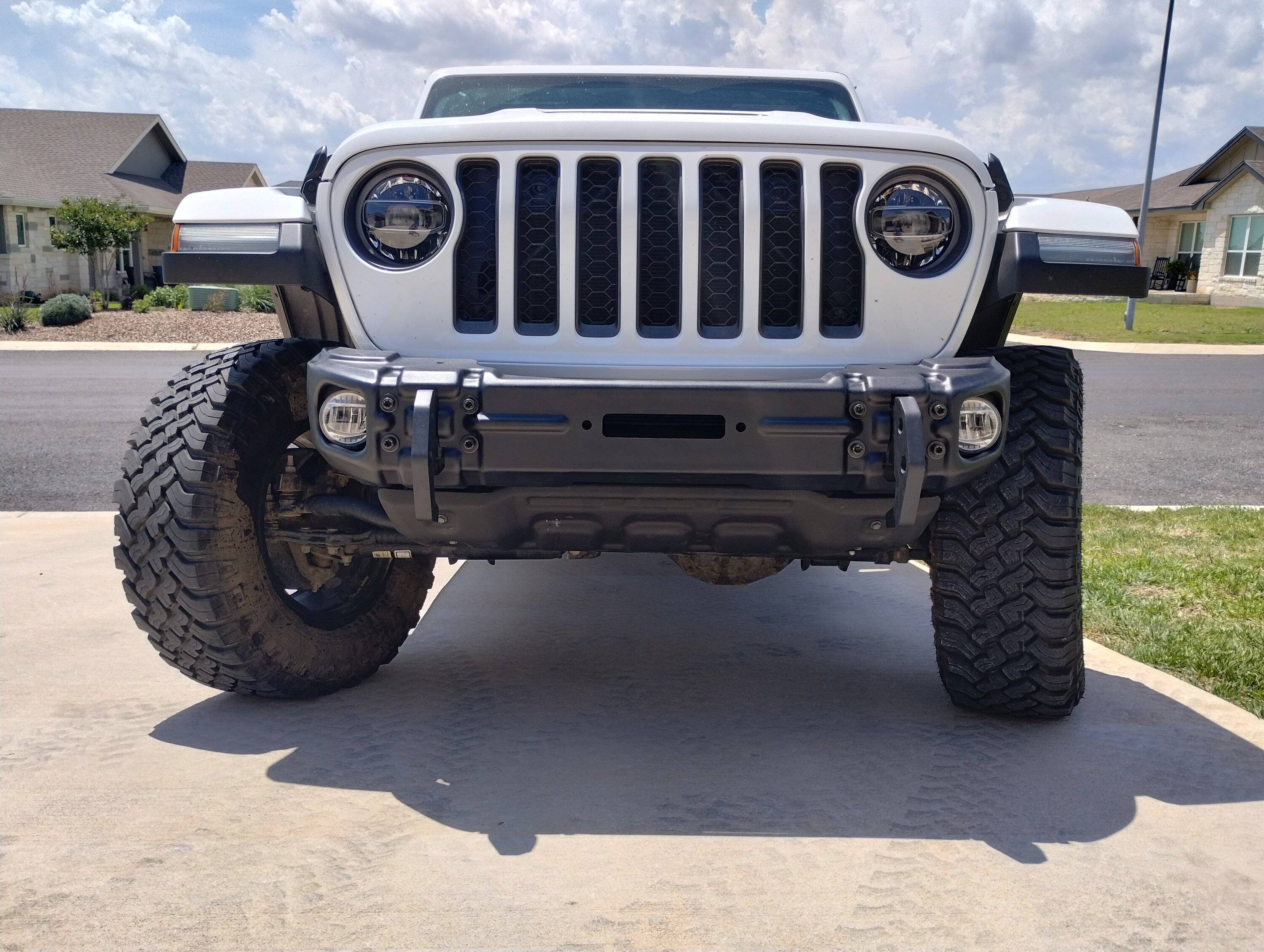

Got the Teraflex D-ring brackets today to put on the Arcus. They are beefy!!

I would imagine that it will be pretty hard to keep a strap on the hook like that.

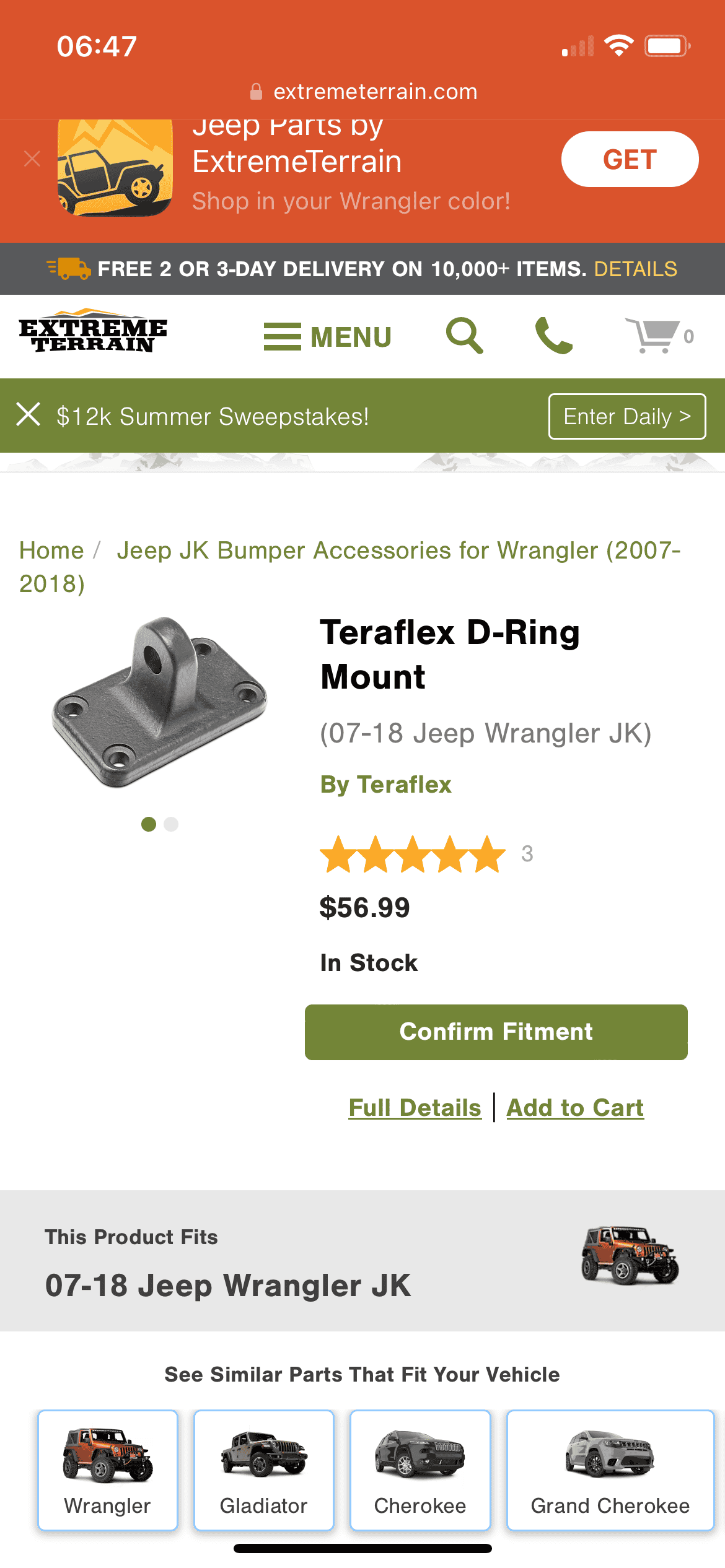

If you decide to get a different shackle mount, these are Teraflex.
The Rugged Ridge mounts don't project out far enough to clear the bumper shell when using a regular steel shackle.
I got the Teraflex shackles delivered but realized after the face you mentioned you had to cut something on the bumper in order to use them?

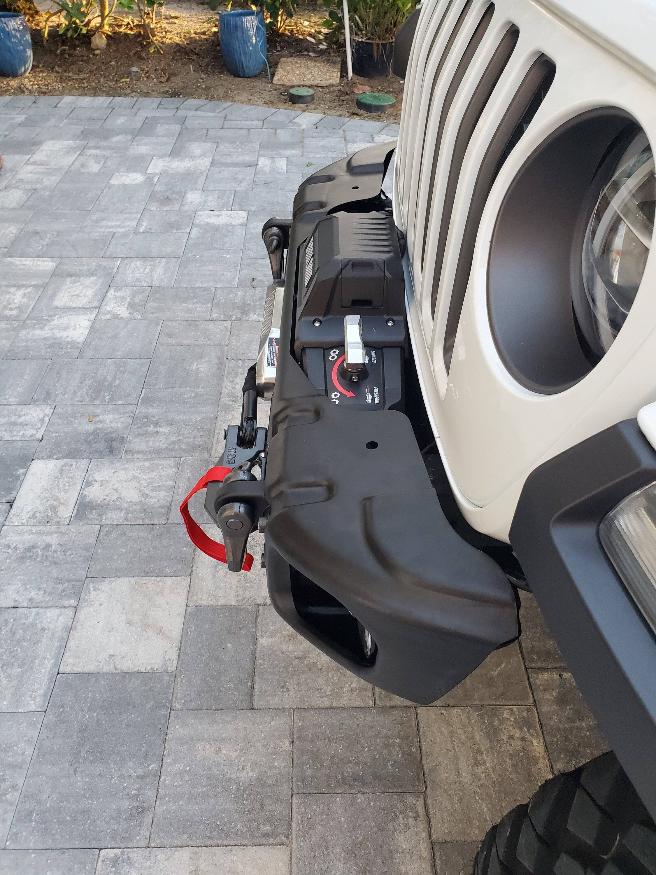

finally got the arcus and winch installed. Decided I didn’t want to mess with the teraflex cutting the nubs off and also test fitted the Rugged ridge version (see pic) but not being able to use a normal shackle was not ideal due to the Arcus outer bump.
Luckily the Arcus tusks when installed fit in my garage so just went that route and saved a few bucks. Like the look.

A quick chop with a sawzall blade removed the humps from the Arcus cover so the XHD mounts would work.
