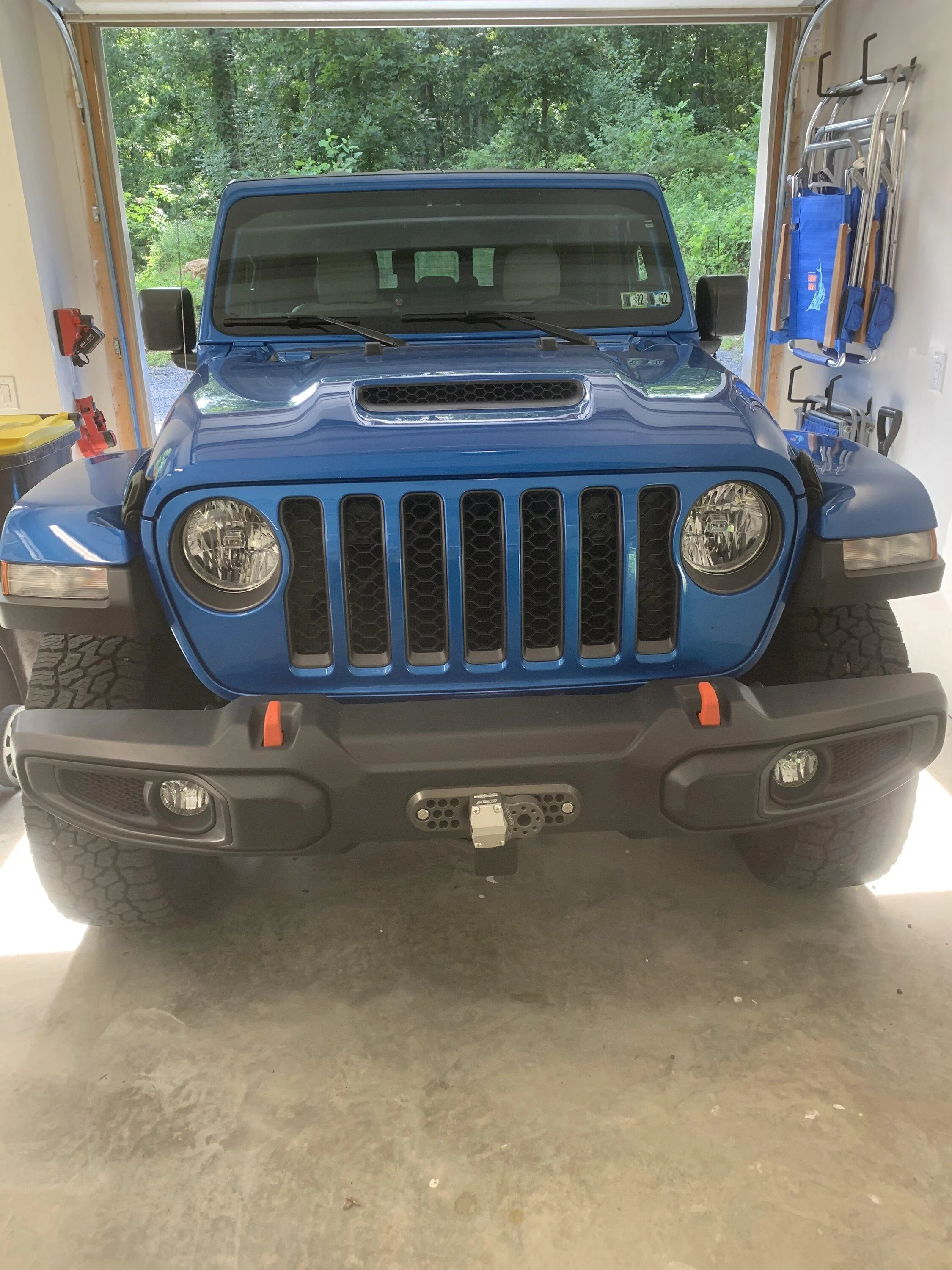

Not the OP, but my setup added 93 lbs to the front end (about 15 more than OP) and it measures 3/8 lower than before. Definitely not a noticeable amount.

Don’t think I’ve any drop but I did not measure, finished early in the morning and hooked up the camper and will be heading home tomorrow, measurement to bottom of Mojave fender lip was 41”, I’ll check.
Sorry Onesicpup, Ona they don’t show it in their website but Northridge4X4 has it in stock on sale for $144.99 part number
LODJWP0701, thing does weigh about twenty pounds, built real nice , powder coat is great, and is listed for JL but fits JT, and you don’t need any of the hardware they sent forgot to subtract that weight! Mounts to an existing bolt that holds the brace on inside of frame, and uses the tow hook bolts to hold in on front. I also added the LOD frame braces but not required pretty heavy (6lbs.) and I think they are an improvement but are about $115, not sure I would buy them again as perhaps overkill, but I had them and they are beautiful and was figured into my total weight already, got them from LOD. You guys have to be aware I did this with a Curt receiver hitch on already, which I should have taken off and put back on after setting plate, but a quick slot in one section of the frame horn fit it in. So if I didn’t have the Curt Hitch and didn’t put the frame braces on which had to be trimmed slightly things would have been simpler. I also bought spacers thinking I would need them but the winch plate is 1/4” and hauser support piece I fabbed is 1/4” so I ended up ok with the small winch I used which including line weighed 54lbs. just like Warn said. The LOD plate also came with spacers two of which you can see taped to rear of bumper with my hauser plate. I’ll put something together soon. Oh yeah as for links , sorry only links I do are sausage links! ….Jack

I did a similar setup. I would guess my droop is less than 1/2”. I’m planning to add a spacer back up front (I did the same thing with my JKU) but it’s pretty close to the same. More than it would be with a steel bumper.

Hey just like my original post with the box on bumper, zero, nada, nothing, front and rear are exactly the same measured to the same spot on fender, still the same and that is after towing up some big hills and trailering on bumpy stone roads. Now if my Factor 55 flatlink would ever ship, I could be done….Jack

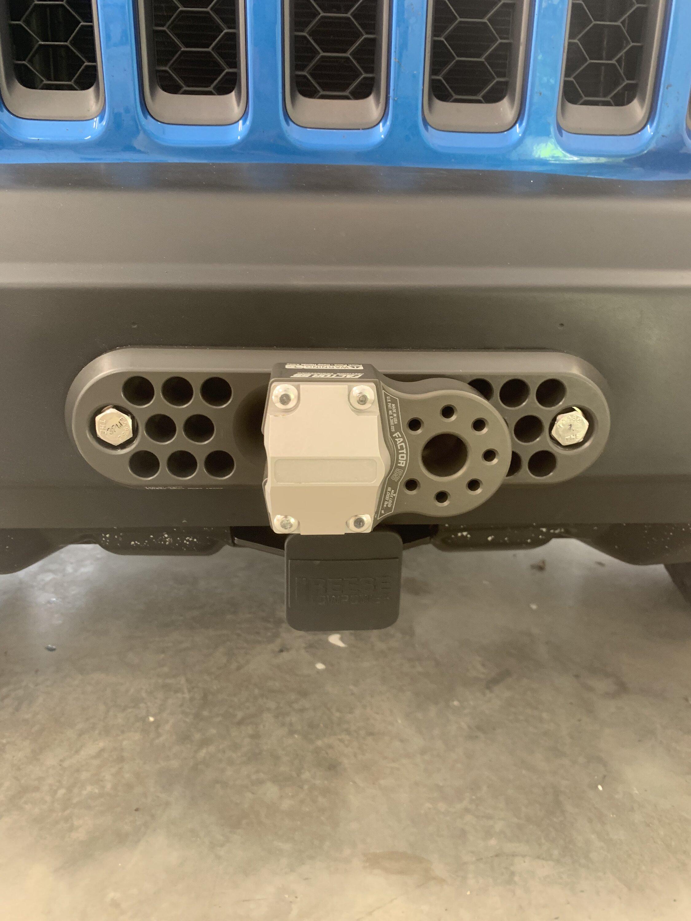

For what it’s worth, I like the thimble style more than the flatlink. The thimble lets you use a shackle either on the pin end or loop end where a flatlink only lets you use the pin end. Not usually a huge deal but I like the versatility and having the thimble saved my butt winching off a fixed point in Moab that I wouldn’t have been able to do with my buddy’s flatlink.

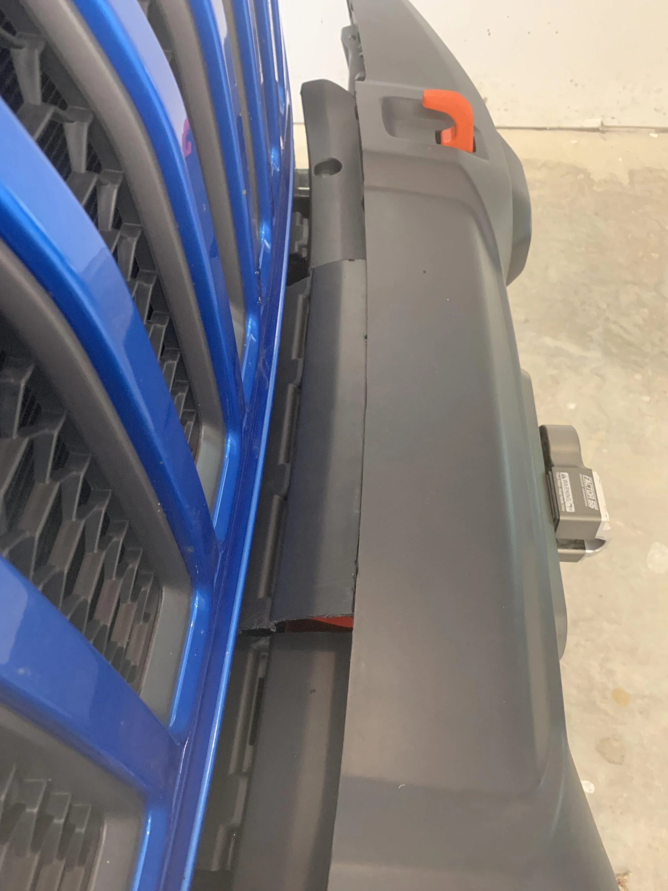

Gave up on vendor sending me the Flatlink, and also found out the 1/2” pipe thimble Warn uses on this winch does not feed though the hauser they supplied, so one call to Factor 55, quick talk ,flat link and short drum fairlead was here in two days. Fairlead is of course much lighter then the Warn but I’m done weighing things. Sorry Factor 55 but I put your logo on the bottom to keep it a little more stealthy, but their service and help confirming that it would fit was excellent. I live on a steep hillside so put the gladiator in stone driveway in neutral and wound it up. Also picked up the piece I cut out of the air dam trim piece and set it in top of winch and it snapped in, What…! It covers my line might rub on very bottom of grill but I think I see how it does and perhaps dress up the edges later…..Jack

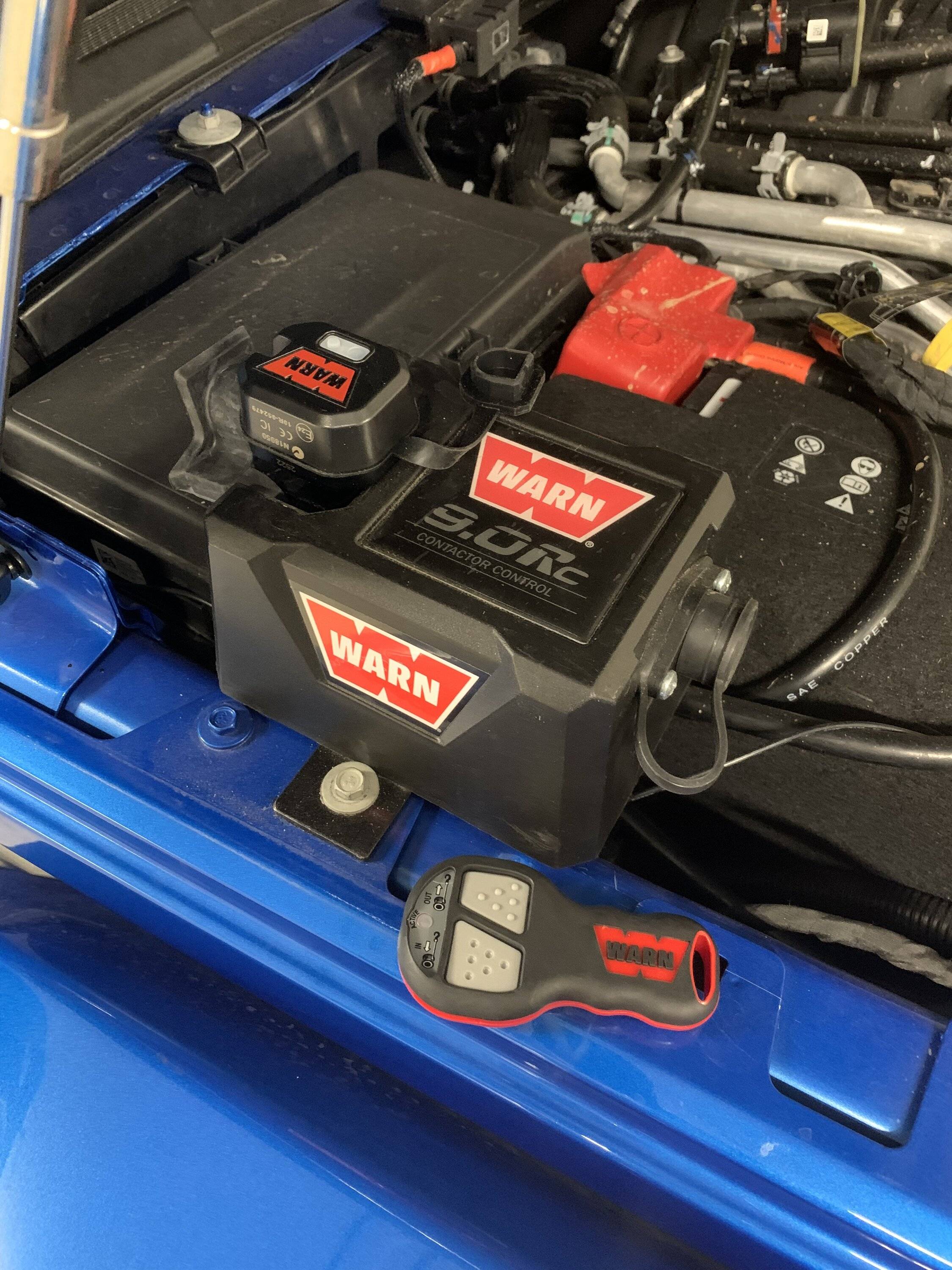

Ordered the plug in Warn wireless remote, I like it small, plugged it in under hood and it worked fine and I was pretty far away about sixty feet , so no problem with the steel Mojave hood blocking signal. I can unplug it and store in the glove box until I head out or need it, can’t bounce out because hood insulation just touches it. Note this install is on a Mojave with the much higher hood, not sure “lesser models” like Rubicon and others would have the room….Jack
