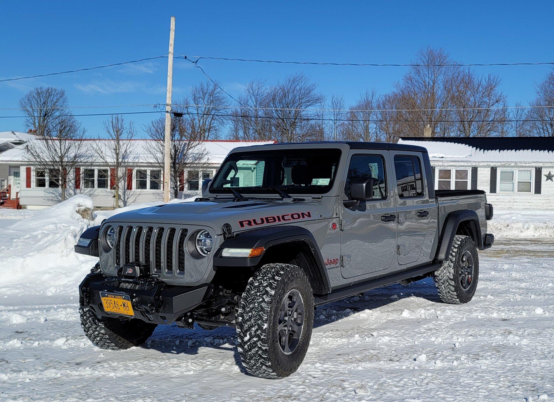

HD Stubby on my JTR. Factory plastic bumper LED fog lights bolt straight in.
Factory plastic bumper steel skidplate will require trimming to go back on.
I ordered the matching RR skidplate with the bumper on Black Friday straight from RR and its still on back order so I canceled it and am running without any skid currently.
The RR skid would also need trimming to clear the LED fogs though.

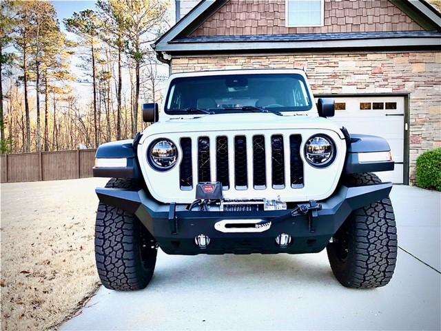

I didn't have any trouble with mine. Factory LED fogs fit as did the factory skid.

Nothing rubbed on mine. I do recall it took me a minute to figure out how everything went together so it wouldn't rub.
