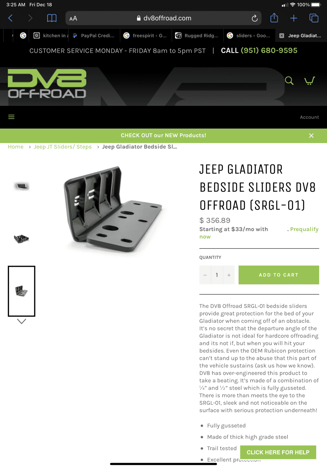

Rubi sliders have two attachment points. These only have one. DV8 has a worse reputation for quality then most manufacturers. I’ve seen several complaints on here about them. Sure there better then nothing. And yes you can weld anything you want together. I’m talking plug and play. Yes looks like DV8 will work from the picture. You will still need drop down brackets looks like.

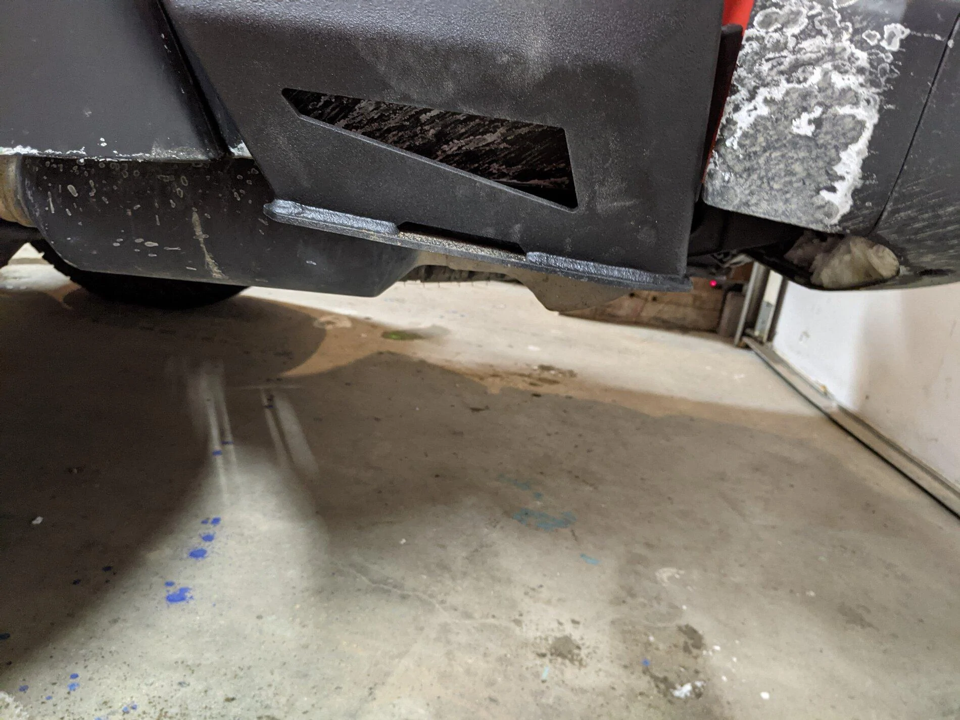

I have seen two reviews of the DV8 sliders that mention they don't clear the factory exhaust on the Drivers side... that you can't even install all of the bolts that come with the sliders because the slider sits against the exhaust pipe... and yes "rattles". So- I started looking for another solution... after many measurements I opted for the LOD sliders for less than 140 dollars for a pair shipped! They mount like the factory slider to the frame with a diagonal frame bracket in the existing factory holes. They have a metal plate near the back where the rear HD bumper comes around that you could drill and bolt together with a small spacer between the Rugged ridge bumper. They wrap up the side of the fender about 8 inches- compared to the Rubicon ones that are level with the bottom of fender panel. Very Heavy duty... Thicker than the bumper for sure! The color is a little off from the rugged ridge color...they are a glossy black, so I'm going to let it warm up before mounting them so I can paint them to match the bumper better. I really think this is a good and inexpensive option to have rear skids with this bumper! https://www.northridge4x4.com/part/rockers-sliders/jbs2061-lod-destroyer-bed-sliders-pair-black (I used a forum code to get the lower price.)
I'll post my own pics when I get them matched up and mounted.... (its -23 tonight... before wind chill...) I'm also going to mount some "rock lights" in them there is a nice protected slot for a small light.

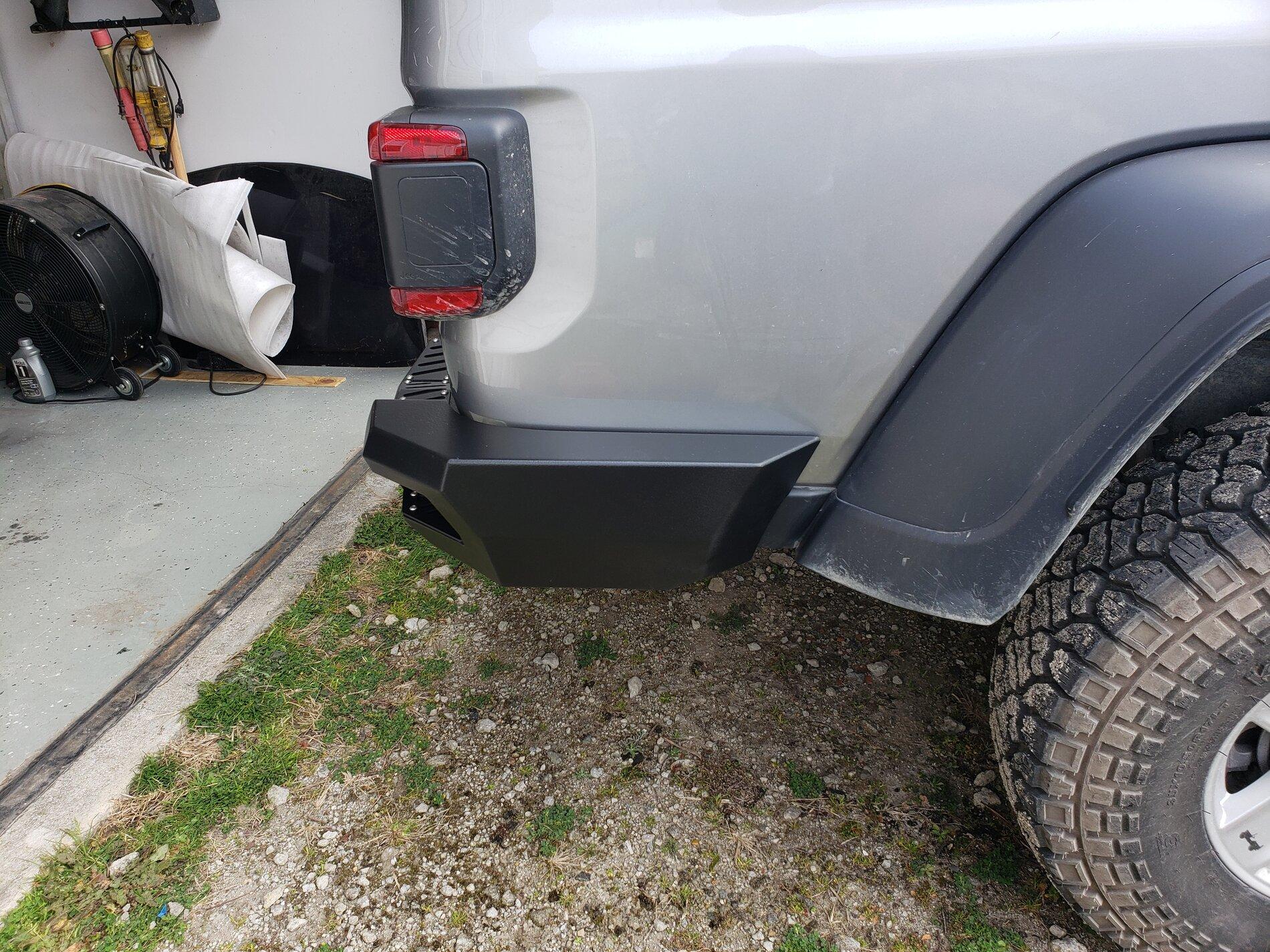

Jeep Gladiator Rugged Ridge HD Rear Bumper - Sliders Don't Fit PXL_20210214_003300820
Jeep Gladiator Rugged Ridge HD Rear Bumper - Sliders Don't Fit PXL_20210214_003240567

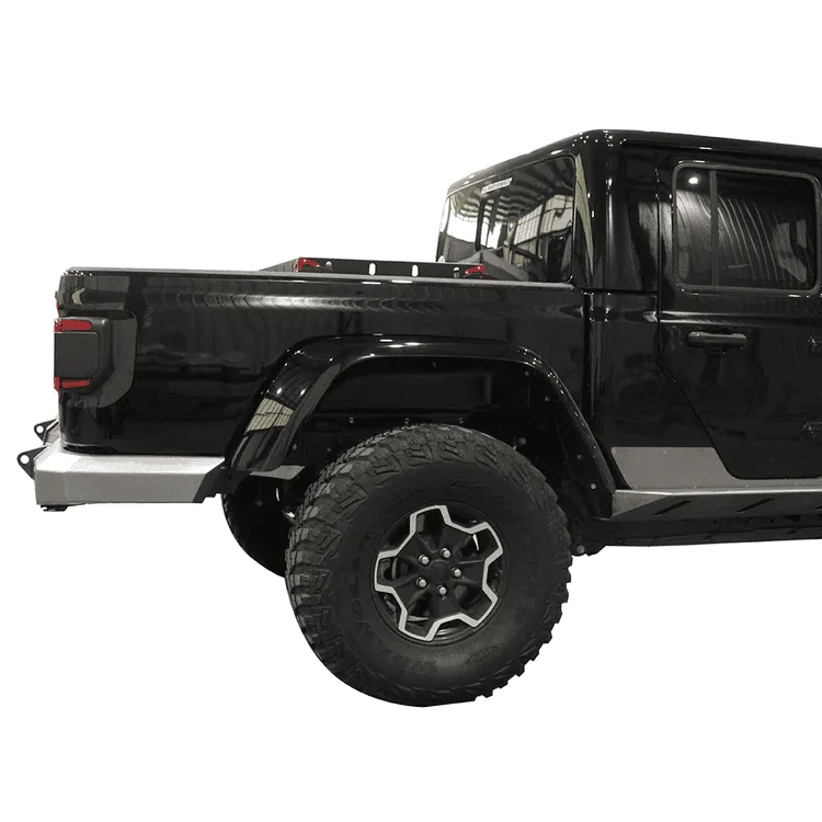

I would think/hope Rugged Ridge will either make some corrections on future designs or release a compatible quarter slider. That RockHard4x4 looks strong too but a heack of a lot less detailed and much plainer then the RR.

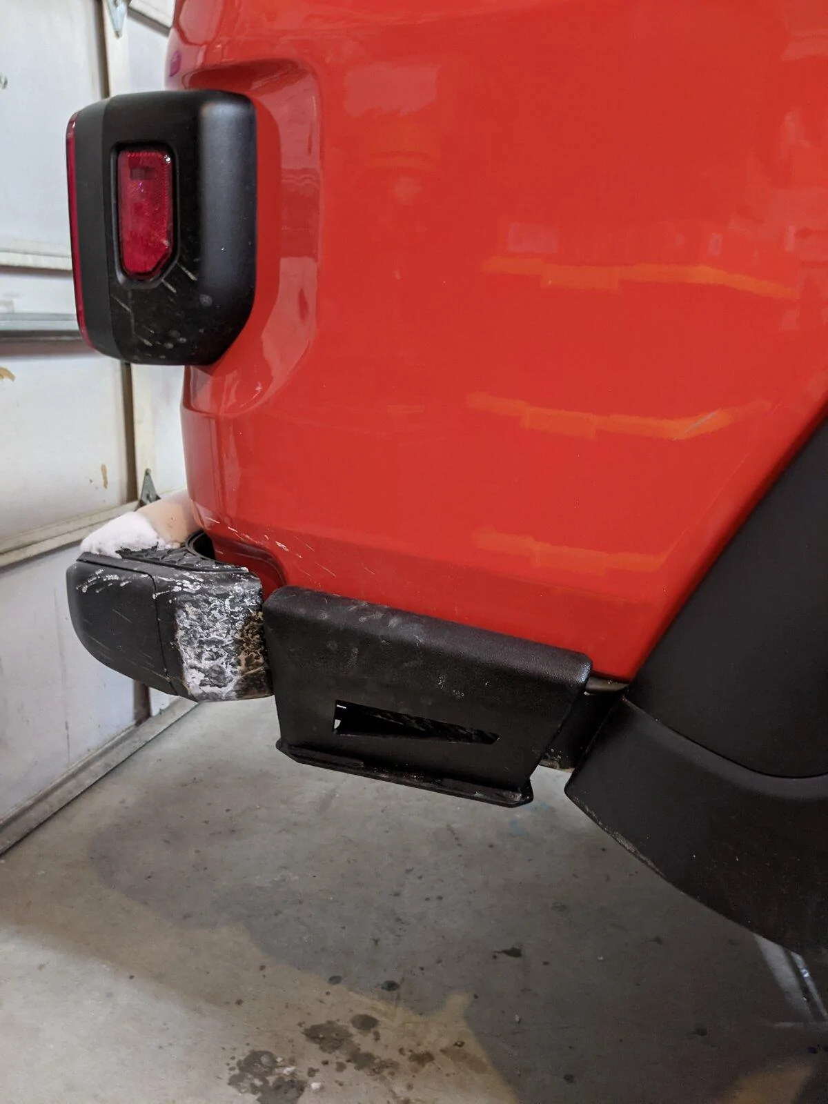

These are super strong, and fit with stock bumpers...and after market bumpers that do not extend around the sides past the "divit" in the body panel. The are frame mounted. This is with the stock bumper in this pic. I got them at Northridge... there are several discount codes... and if you are lucky and the code is active... You will pay less than 140 for the set! (The podwercoated black set) Bare may even be cheaper. Northridge is where I found the best price on these and free shipping! No drilling or cutting involved. Fits perfect over stock eghaust... just like stock sliders- mount in the same location with the same style bracket!

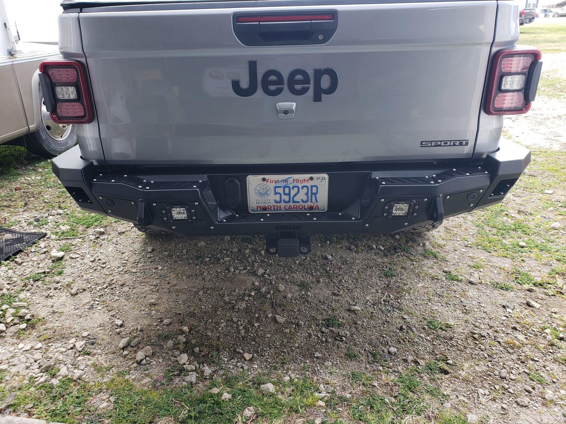

bodyguard and motobuilt are true wrap arounds. motobuilts side mount brackets cost extra. bodygaurds are included and it uses all your factory lights and sensors
Jeep Gladiator Rugged Ridge HD Rear Bumper - Sliders Don't Fit 20210227_111546
Jeep Gladiator Rugged Ridge HD Rear Bumper - Sliders Don't Fit 20210227_111537
