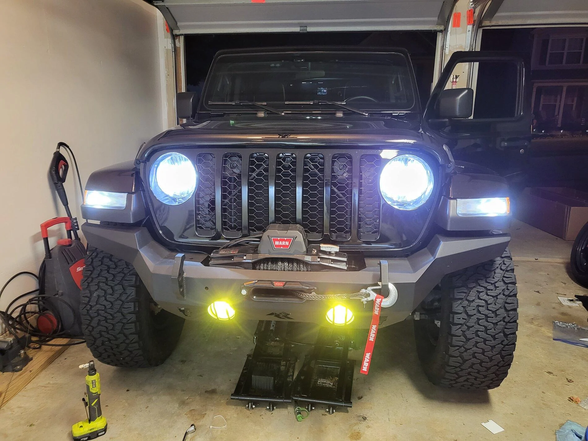

I installed the front bumper on Friday. Install wasn't bad, but I did fail a few times trying to align the studs, until... I noticed that one of the holes on my Jeep frame was off-center from the factory. A drill bit solved this issue.
The bumper really suits the front end. I'm digging it!

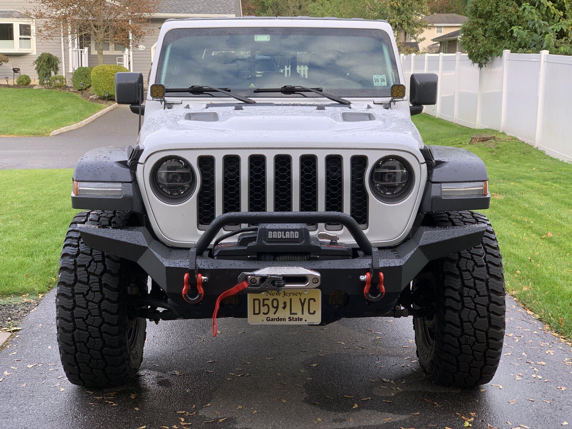

Got my Badlands Apex 12k winch installed yesterday. It was a tight fit but I didn't have to fully remove the bumper to get it mounted. I re-routed the positive lead from the winch out the side since there was no room where it exited the winch since the fit was so tight. I was surprised how little clearance there is between the winch and the grill. Basically there is none as it's actually touching ever so slightly. Did anyone do anything to rectify that situation with the Badlands winch?
