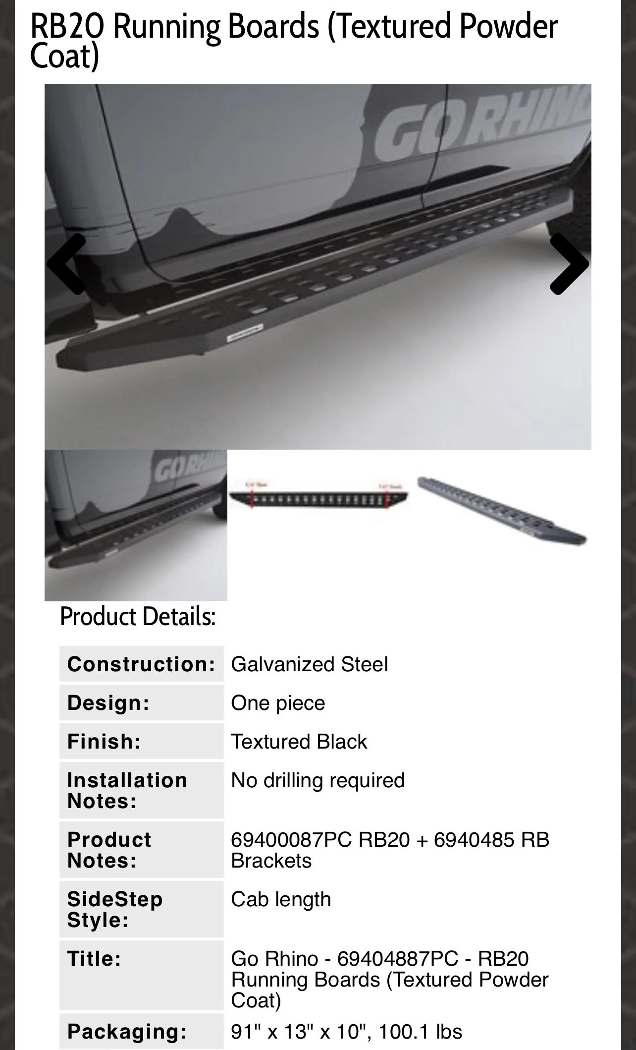

I got the Go Rhino rb20 for mine. Not too wide in my opinion. I like that they run the length of the cab and they also do a great job protecting against rocks and any other debris that fly's up. My only complaint is I wish they were a little more flush to the body, but otherwise I have liked them for the time I have had them on.
https://www.carid.com/go-rhino/7-5-...ZrXfYBYCgHdBEkpPrOgVbnGd8cmA0B3caAnSREALw_wcB

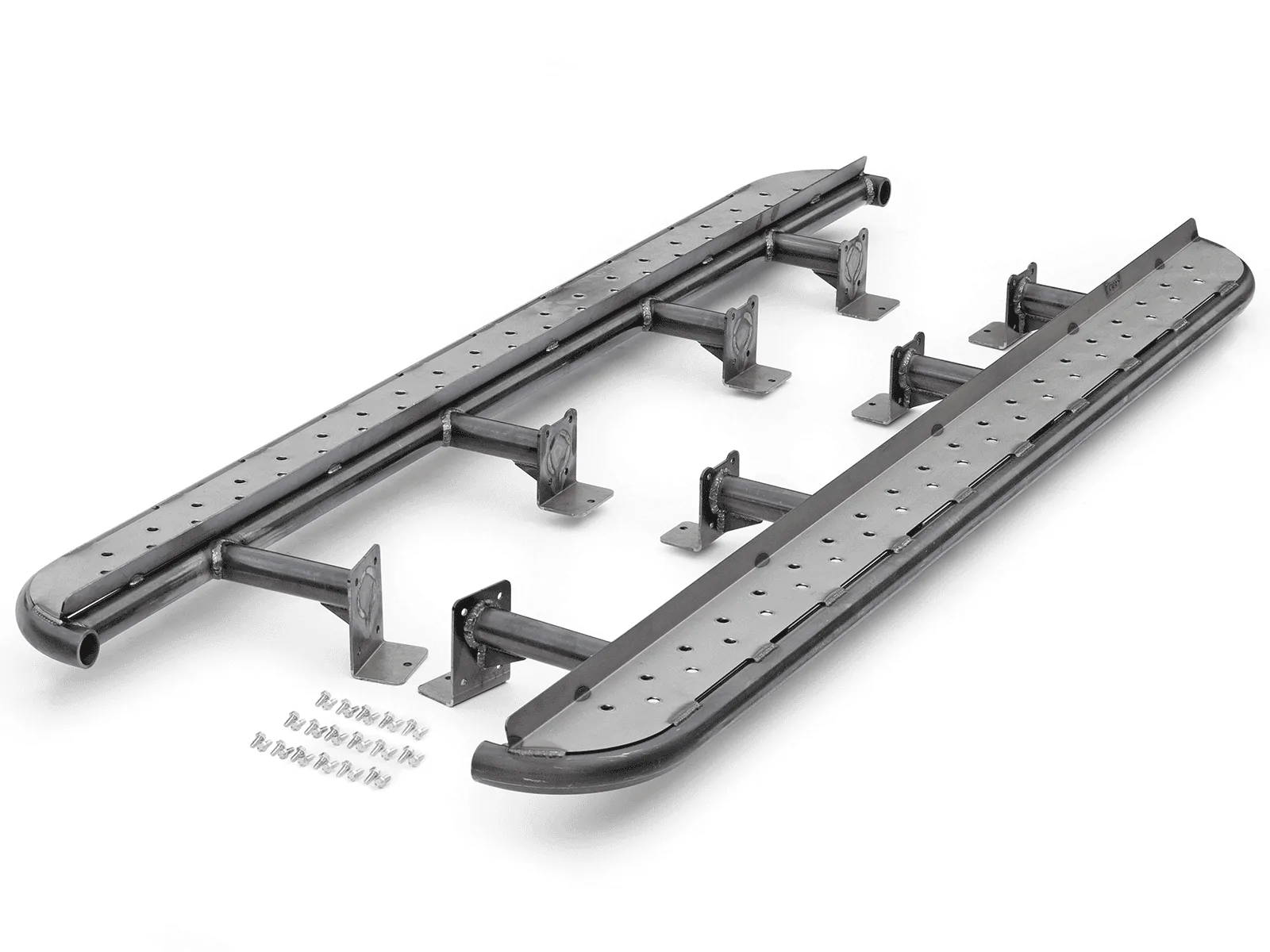

GenRight are the best design out there imo. Great step, huge tubes, but you really need to get them welded on. There's a huge shop here that prefers GenRights to anything else. Before welding they double checked with me on the permanent, which was fine. Never had to cut any off they said, they're really perfect. The design hides most of the pinch seam too. Uses .250 tubing where most go with .1875. Some like Rock Hard are down to 0.120" tubing. This also means they are heavy, almost 100lbs each.

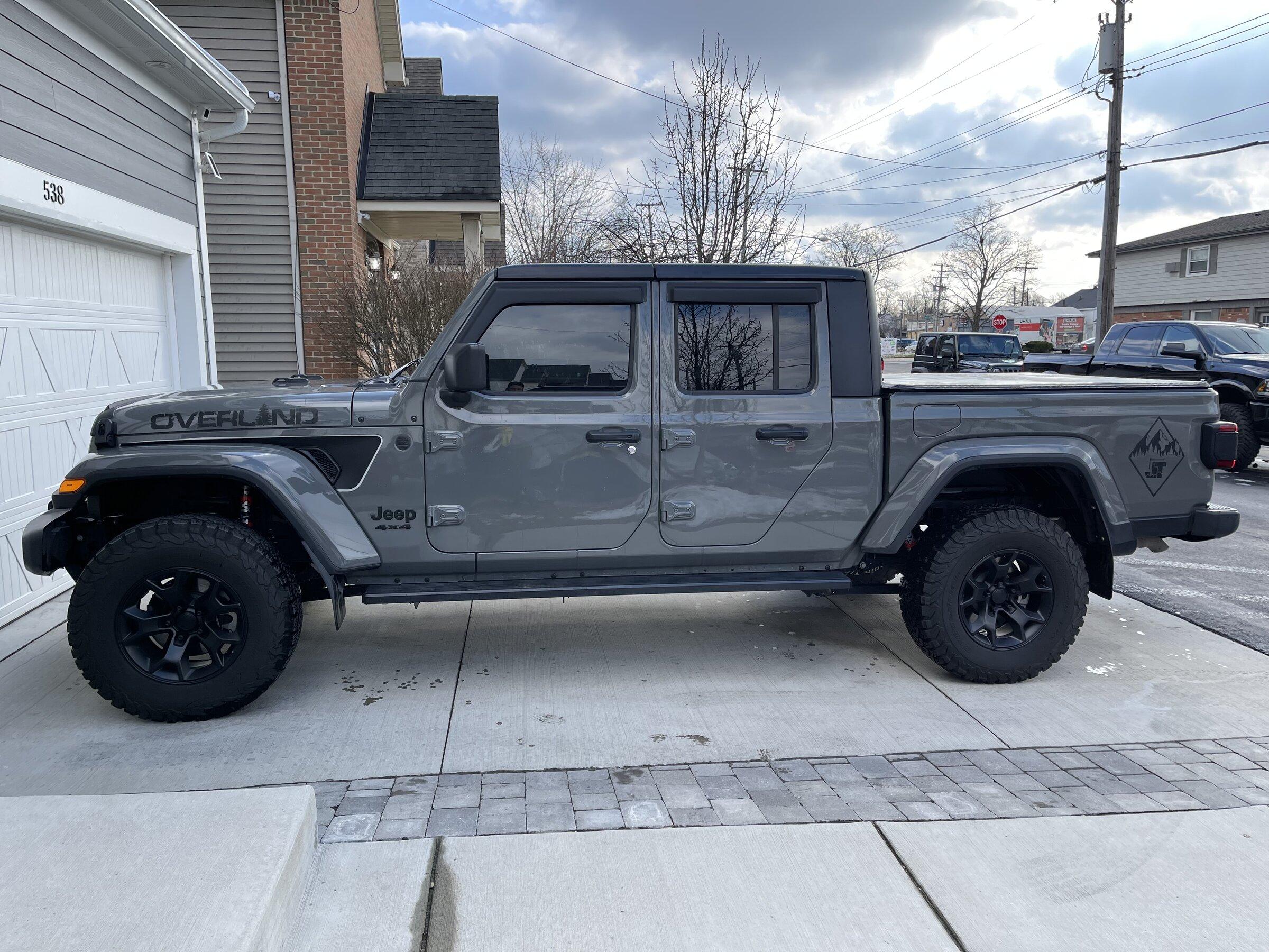

Jeep Gladiator Running Board Suggestions 1642013823019

So me personally I prefer a fell length step as opposed to a drop step. I have full lengths currently but they are in the stock form which aren't bad. Hence the reason it's not been on the top of my list thus far (although I may finally get them as my next mod). But I like to be able to step up anywhere on the truck for cleaning purposes or whatever, and not just by the doors. Also typically full length ones hug the body tighter a bit better which doesn't get hung up on as much when off-roading.
With that said I've narrowed down to the Go Rhino RB20's. And they come in two finished which I like. One in a bed liner coating.
