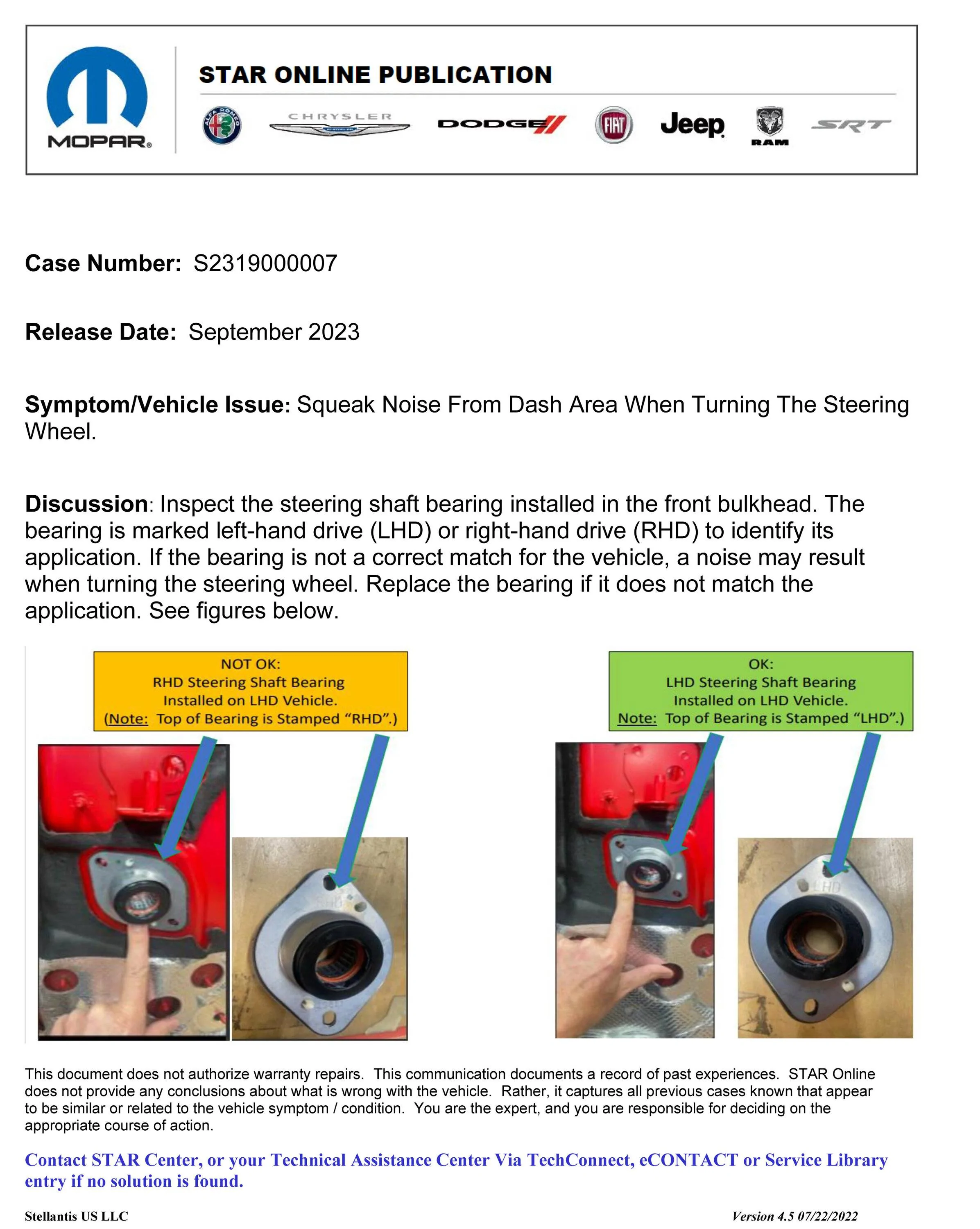

Apologies if it's already been posted.
Lunentucker Well-Known Member Joined Apr 24, 2022 Threads 248 Messages 5,888 Reaction score 15,437 Location Virginia Vehicle(s) 2021 Jeep Gladiator Mojave Occupation People Work? Nov 22, 2023 Thread starter #1 Apologies if it's already been posted. Sponsored
Hootbro Well-Known Member First Name Don Joined Apr 13, 2019 Threads 57 Messages 10,209 Reaction score 20,012 Location Delaware Vehicle(s) 2025 Gladiator Sport Nov 22, 2023 #2 This is the kind of thing I will have to carry the hand for my dealership service advisor if I have this issue because they will think I made it up even with copy of that Star Case.
