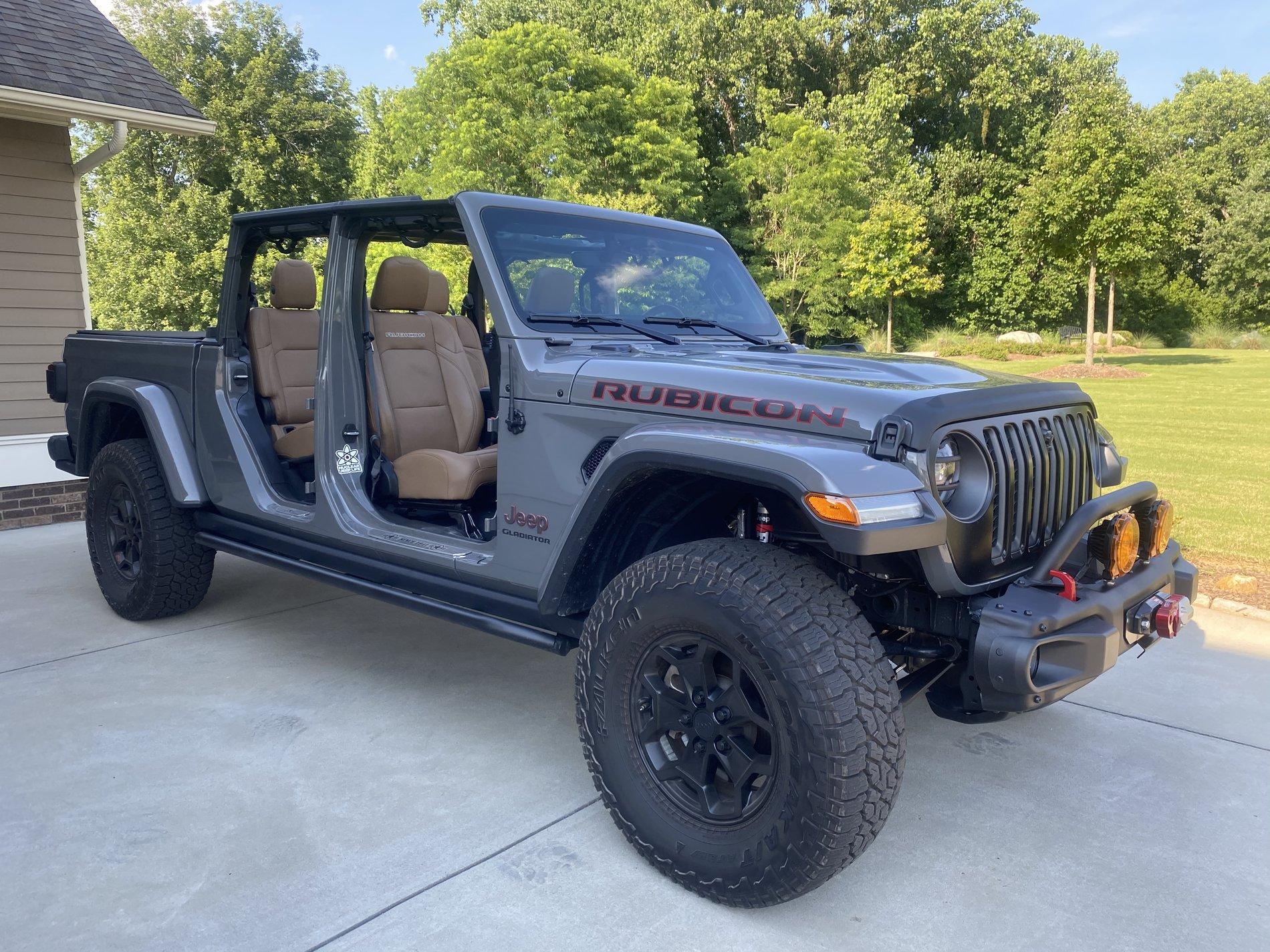

Like you said - the soft top is awesome! I am really enjoying the ease of dropping the top. I ordered the rear window bag yesterday.
now I need to figure out the best way to hang the hardtop from the ceiling in the garage.
Going high end, lol. I used an $8 piece of fabric and fabric glue to make an envelope to put my rear window in.

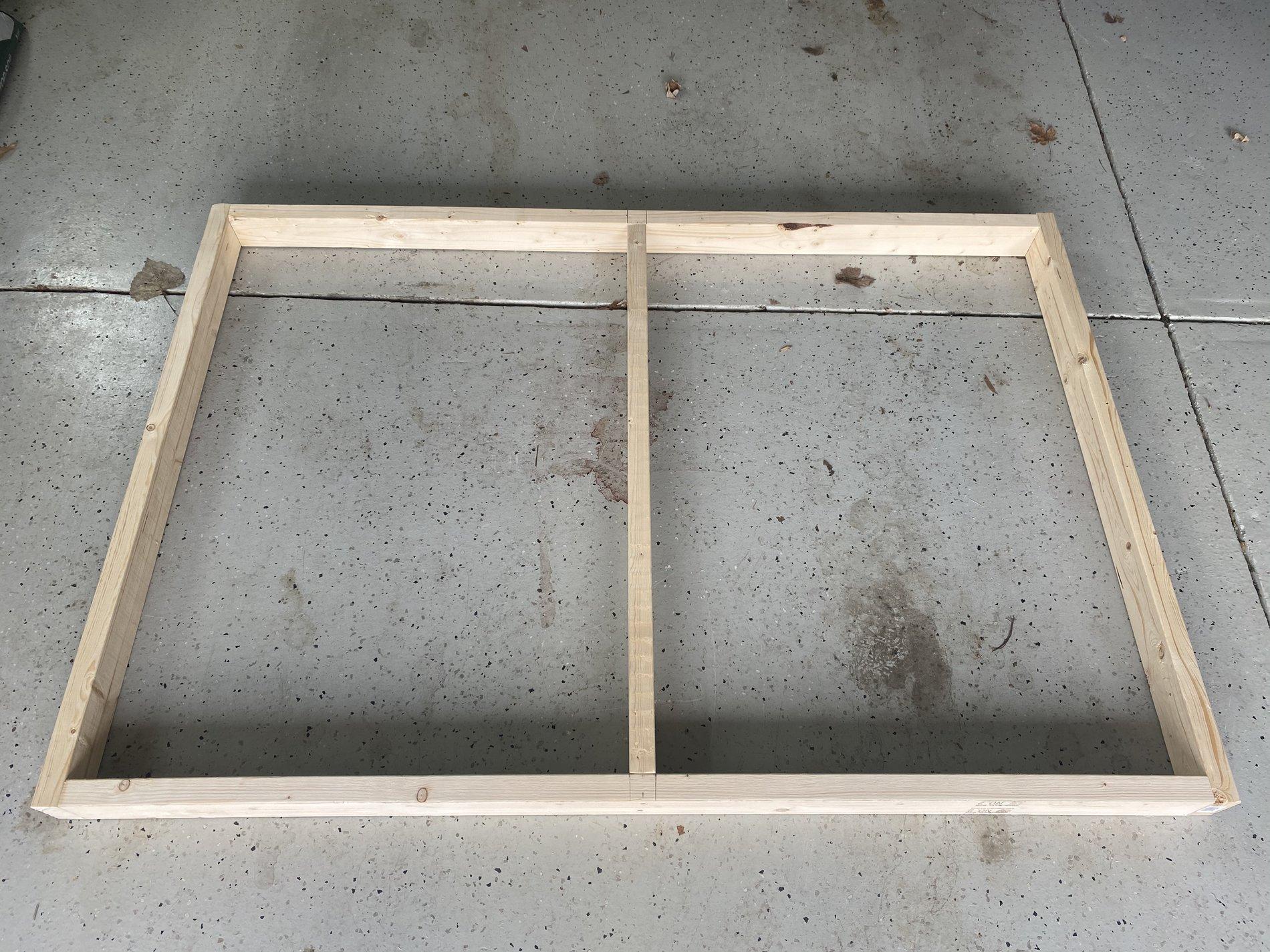

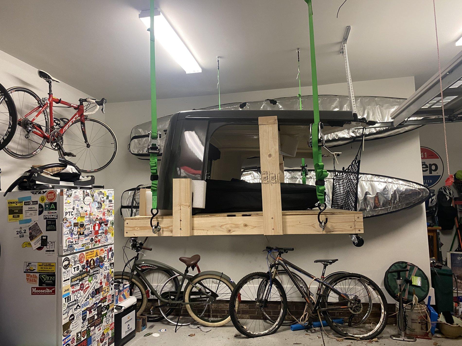

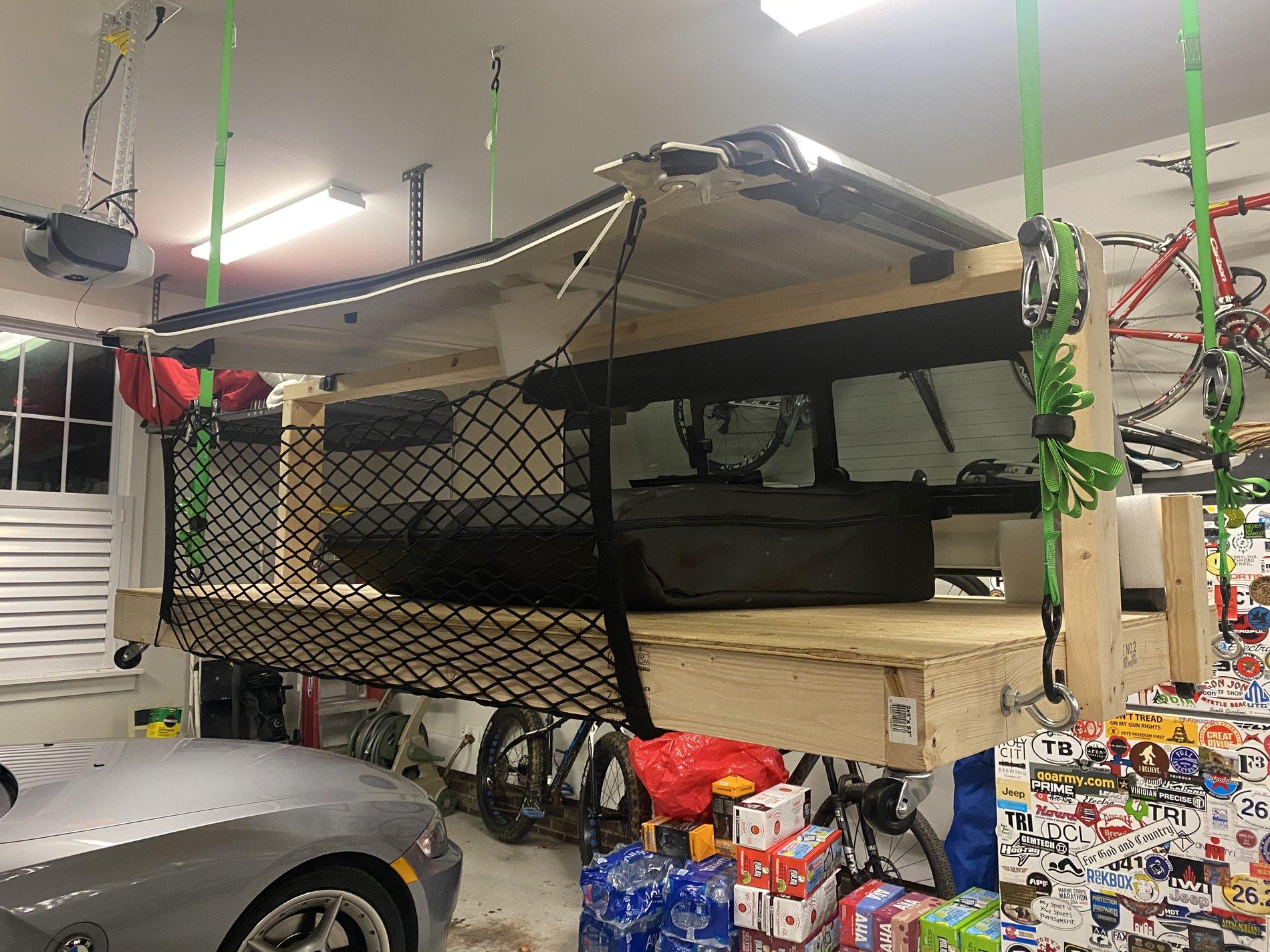

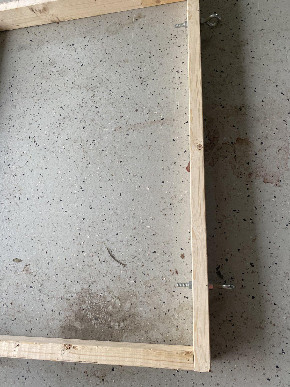

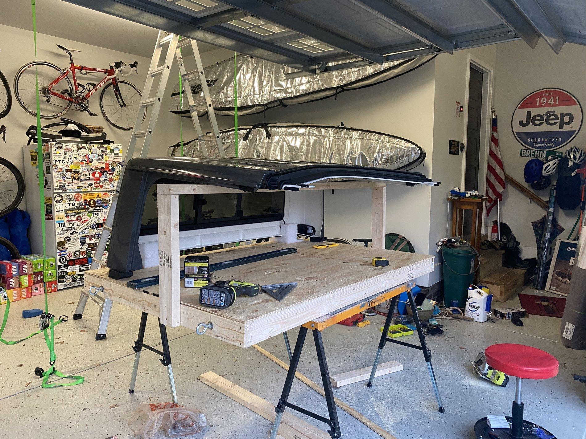

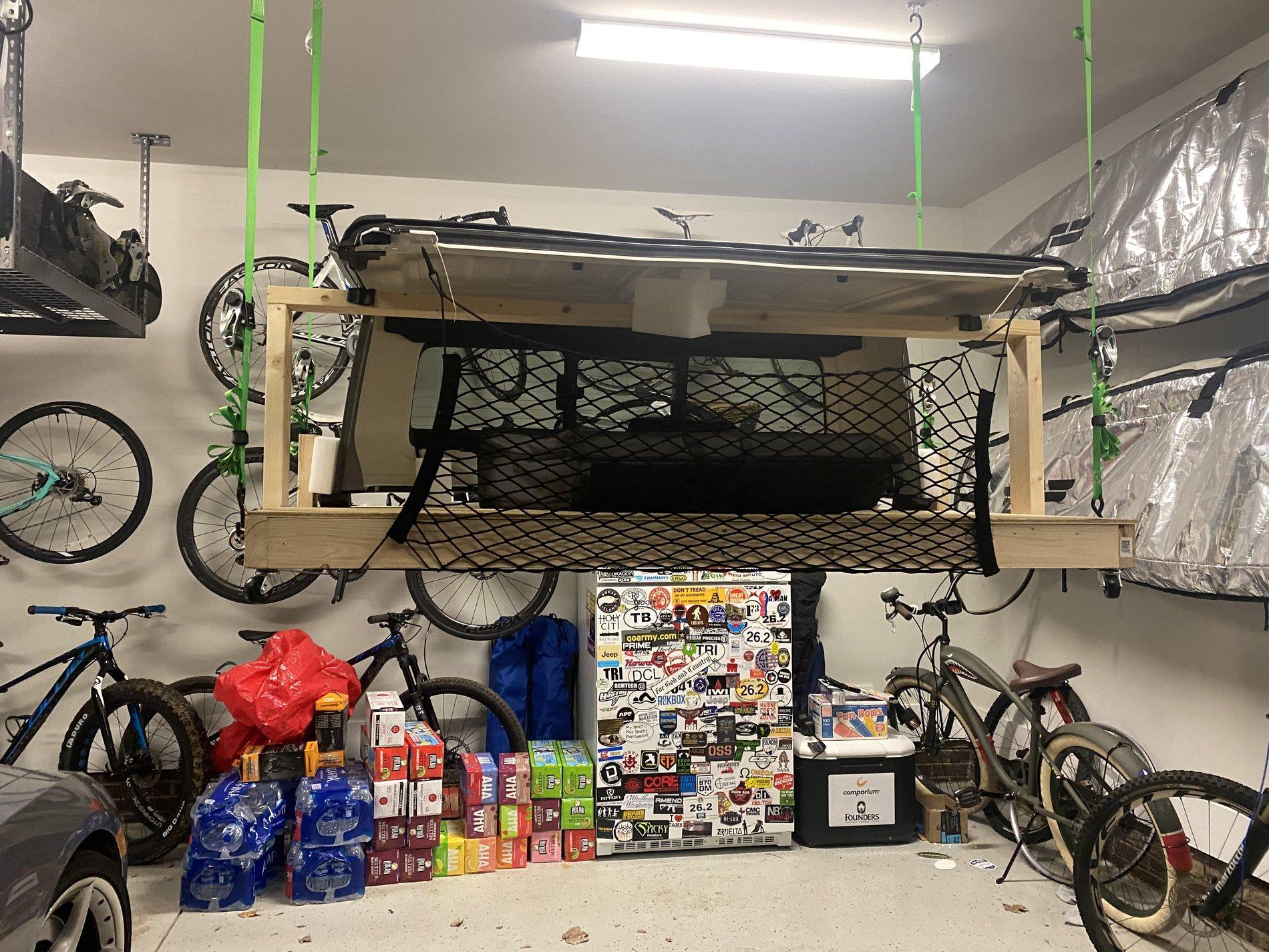

I built a suspended storage rack for my hard top and freedom panels. Made the frame out of 2x4’s and 3-inch #9 construction screws. It is 68-inches wide x 45-inches deep.
I used 1/2 x 6-inch eyebolts:

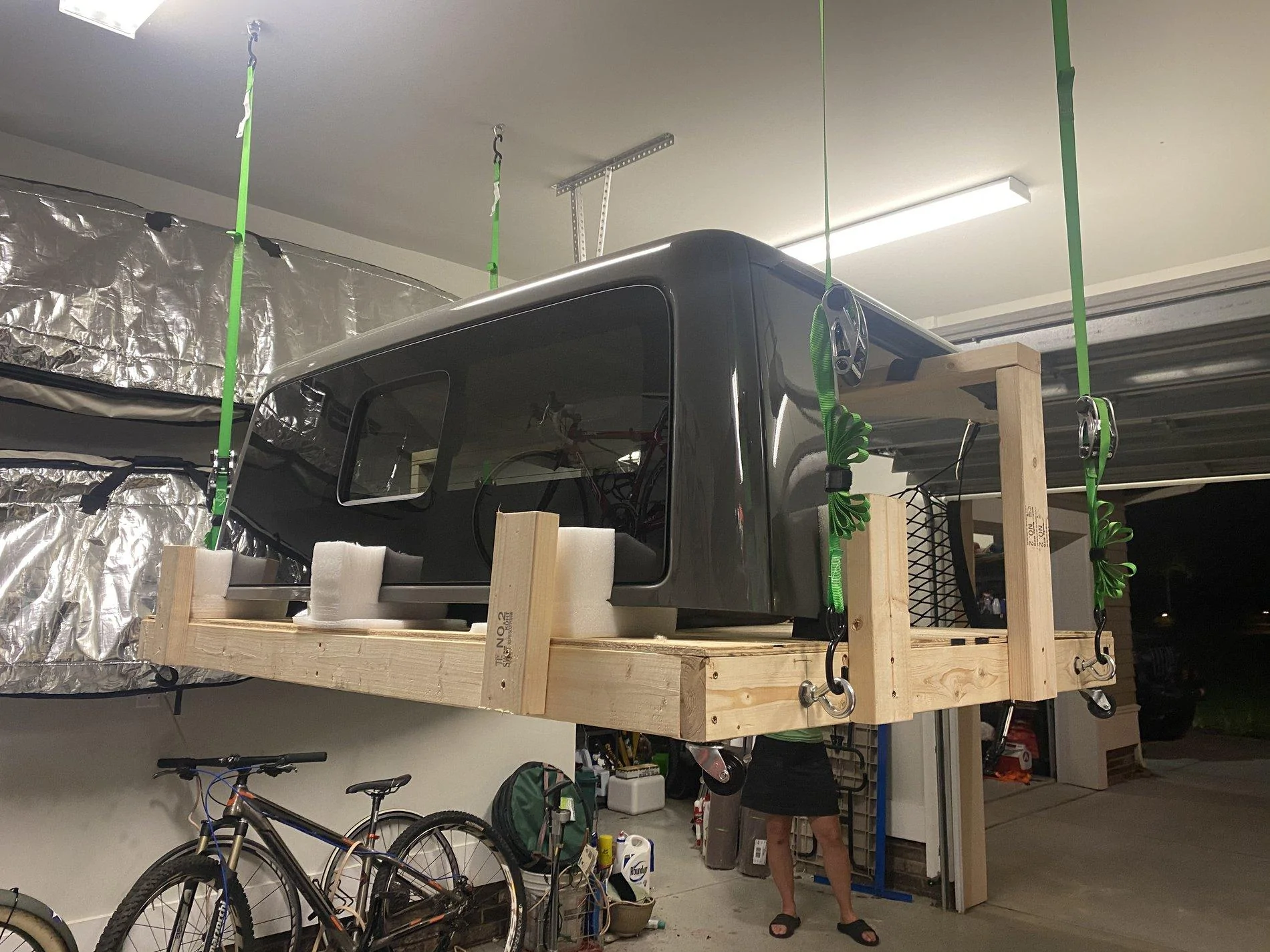

Added a support in the front for the top to rest on - there is garage door rubber seal where the top rests.

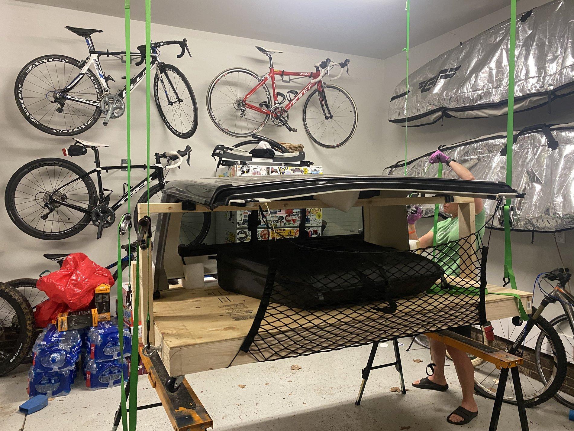

Added casters so I can move it around when on the ground and a few stops on the side and rear to keep the top from sliding off the platform. I had the netting from a past Grand Cherokee so I rigged that up to provide light downward force on the top in the front and act as a drop of the freedom tops shifted forward

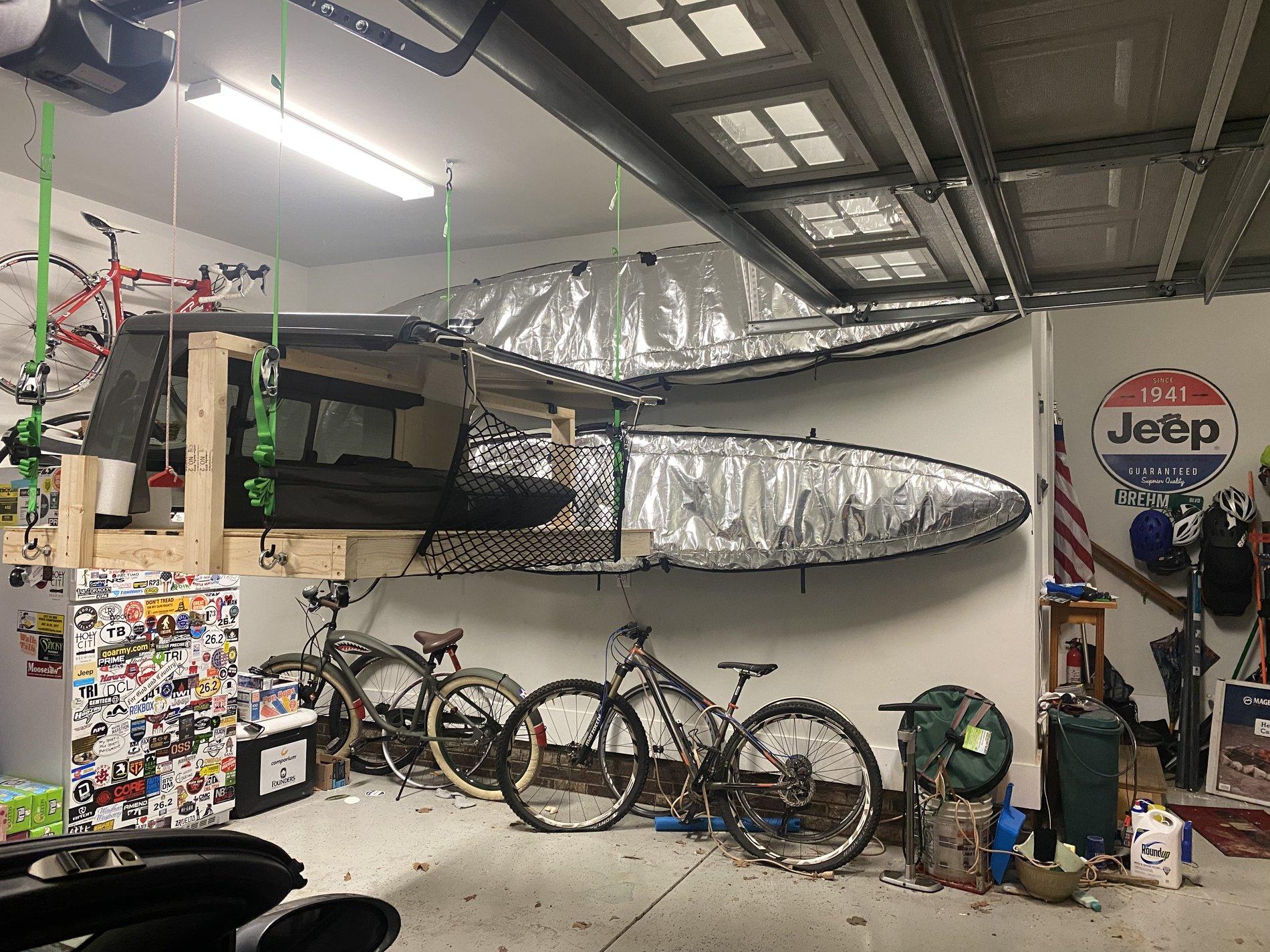

Suspended the platform from the ceiling with ratchet straps (500 lbs load rated) and the ceiling mounts are rated at 400 lbs each.
I added foam under the rear to support the top off the platform.
I only need it high enough that I can pull my Z4 under it. Going to let it hang overnight and put the Z under it tomorrow....

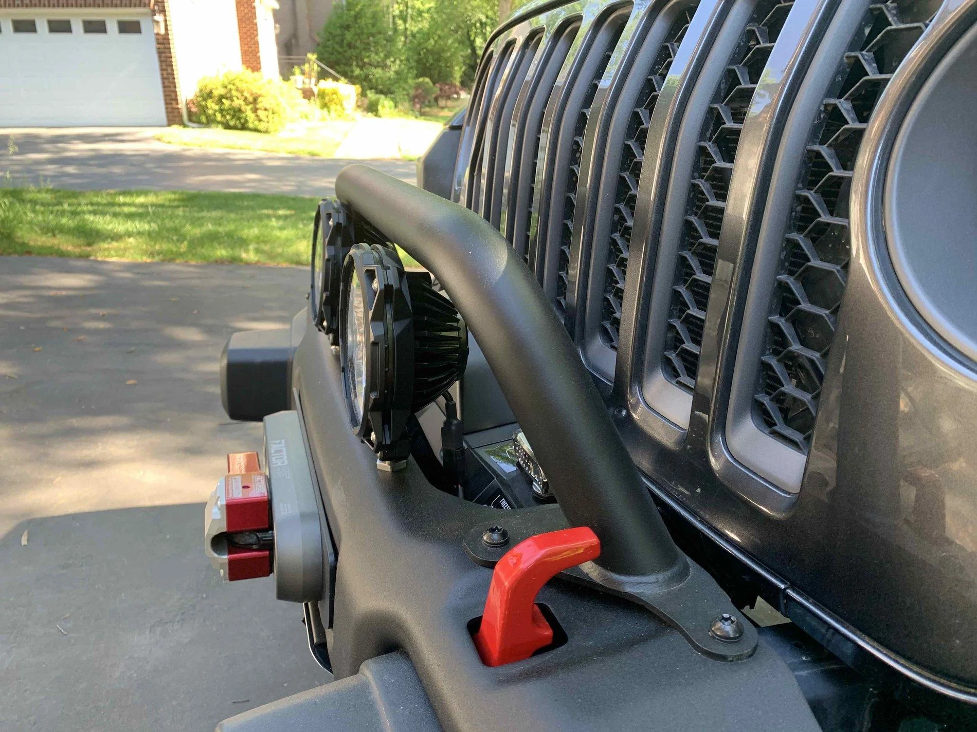

Hey, a quick shout-out of thanks for photos (much) earlier in the thread that showed your Warn grille guard with the KC Gravity Pro6 lights. I ended up going with the same combo and your detailed pix showed clearly that everything fit, had clearance, and looked good.

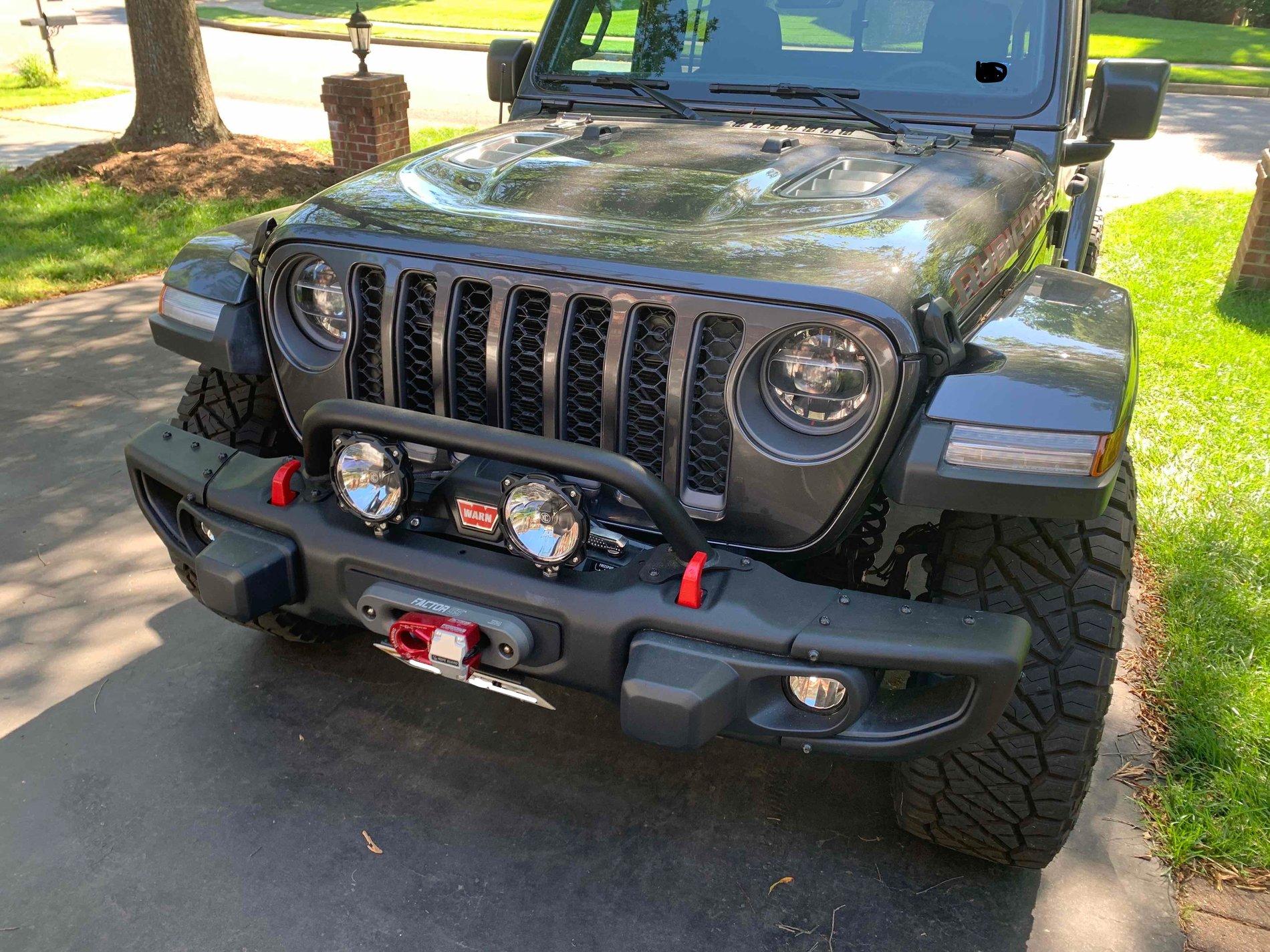

Here ya go. Clearly, this is gonna look REALLY familiar. The combo of the lights and the grille guard look like they were made for each other, given how the clearance works out. And thus the grill guard kinda sorta guards the lights too (from stuff falling on them).
The only thing I'm not crazy about is the way the grill guard crowds the tow hook on the Ruby steel bumper. So, I can't get the Factor55 Flatlink E over the tow hook for a double-line pull. But let's be real, how often does that happen, LOL. And on that very rare occasion, I'll just connect it with a soft shackle. (Or as my son noted, in 10 minutes, I can ratchet off the grill guard with tools we always carry.)
And regardless, I love the lights/grill guard combo, so functional and with a classic look. Thanks for doing the research and posting such great pix!

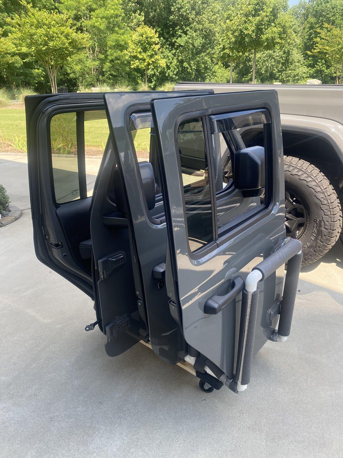

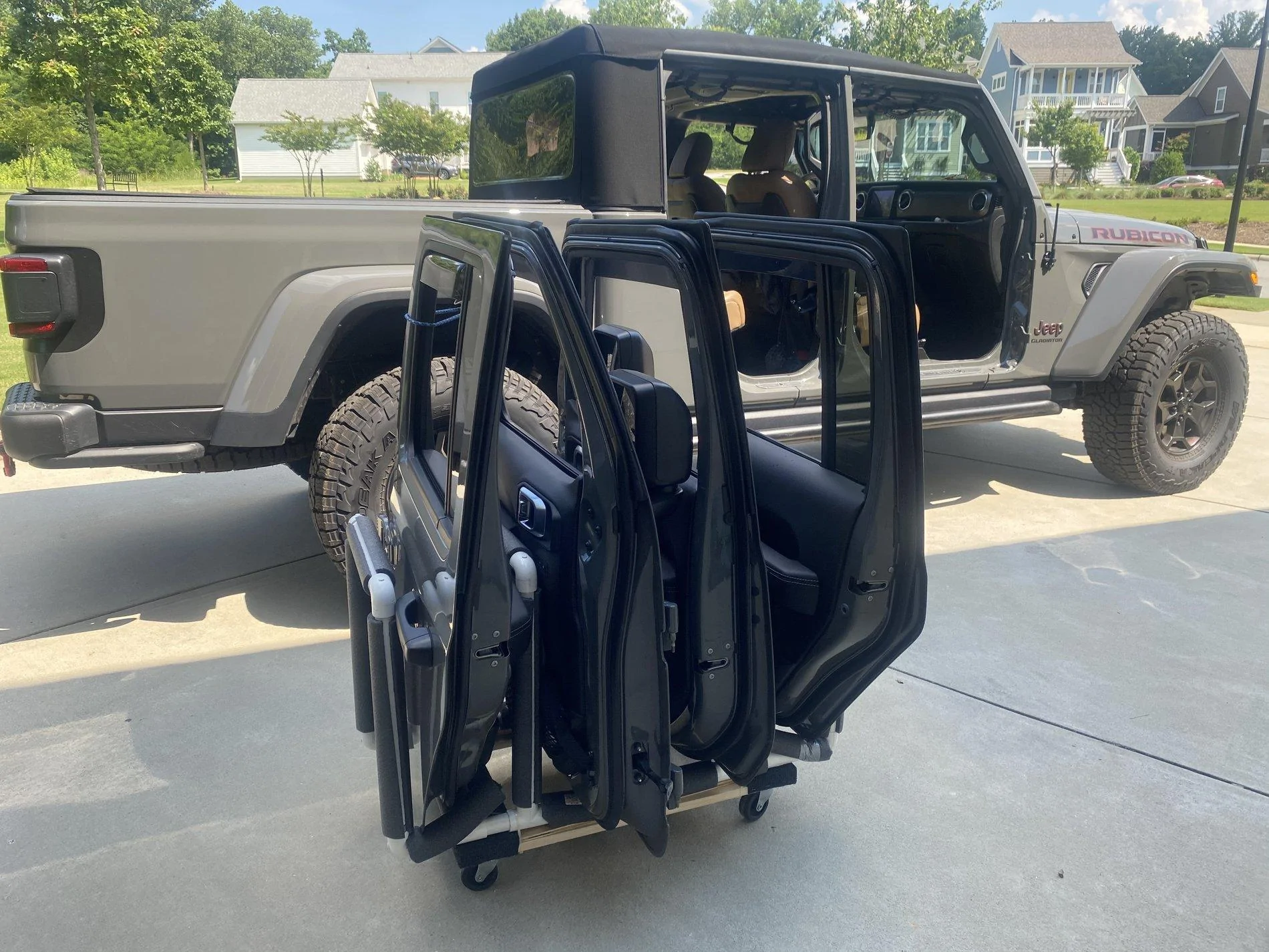

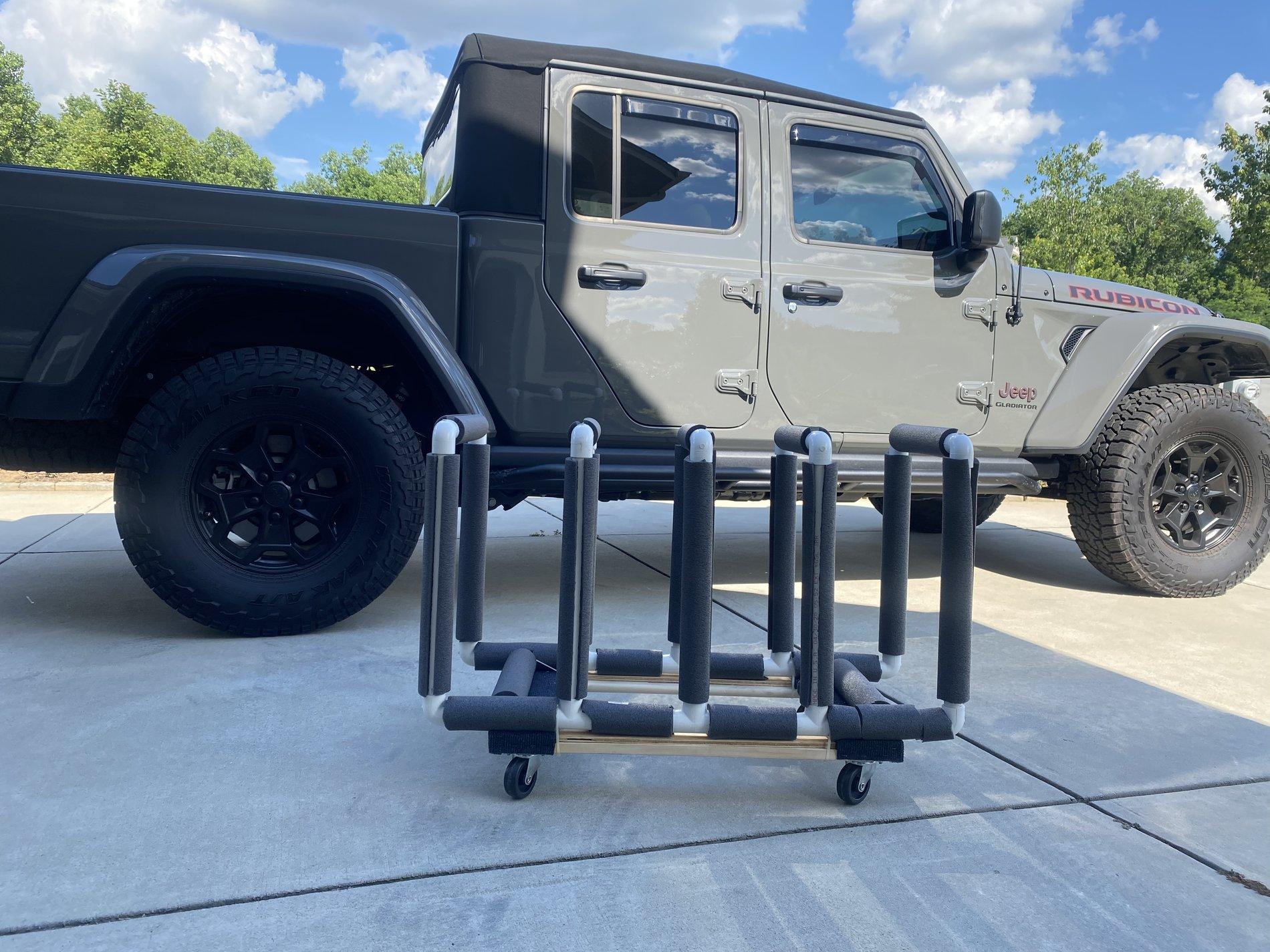

I built a door cart last week:
Jeep Gladiator Samson 0358E167-7559-4B96-B96F-2AA26D440F9E
So it was time to use it!
Jeep Gladiator Samson B41D50CE-44ED-4E17-BC9B-86A778A35536

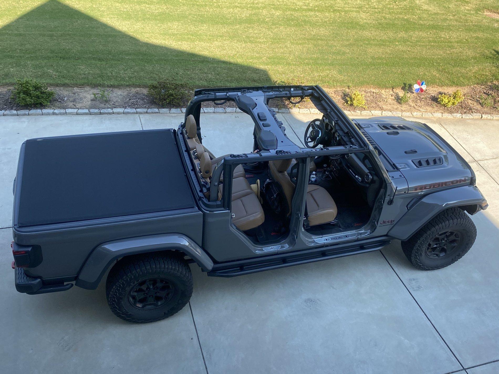

First time to be in nothing but a Tonneau Cover!
Jeep Gladiator Samson E25F517E-7395-4091-BE1B-7A53BBEF2C33
Jeep Gladiator Samson E60A07BD-6F36-46AD-B7B2-504DEE4BB6E5
Jeep Gladiator Samson 524F763D-8030-4AC2-BA89-589CB3F65FD1
