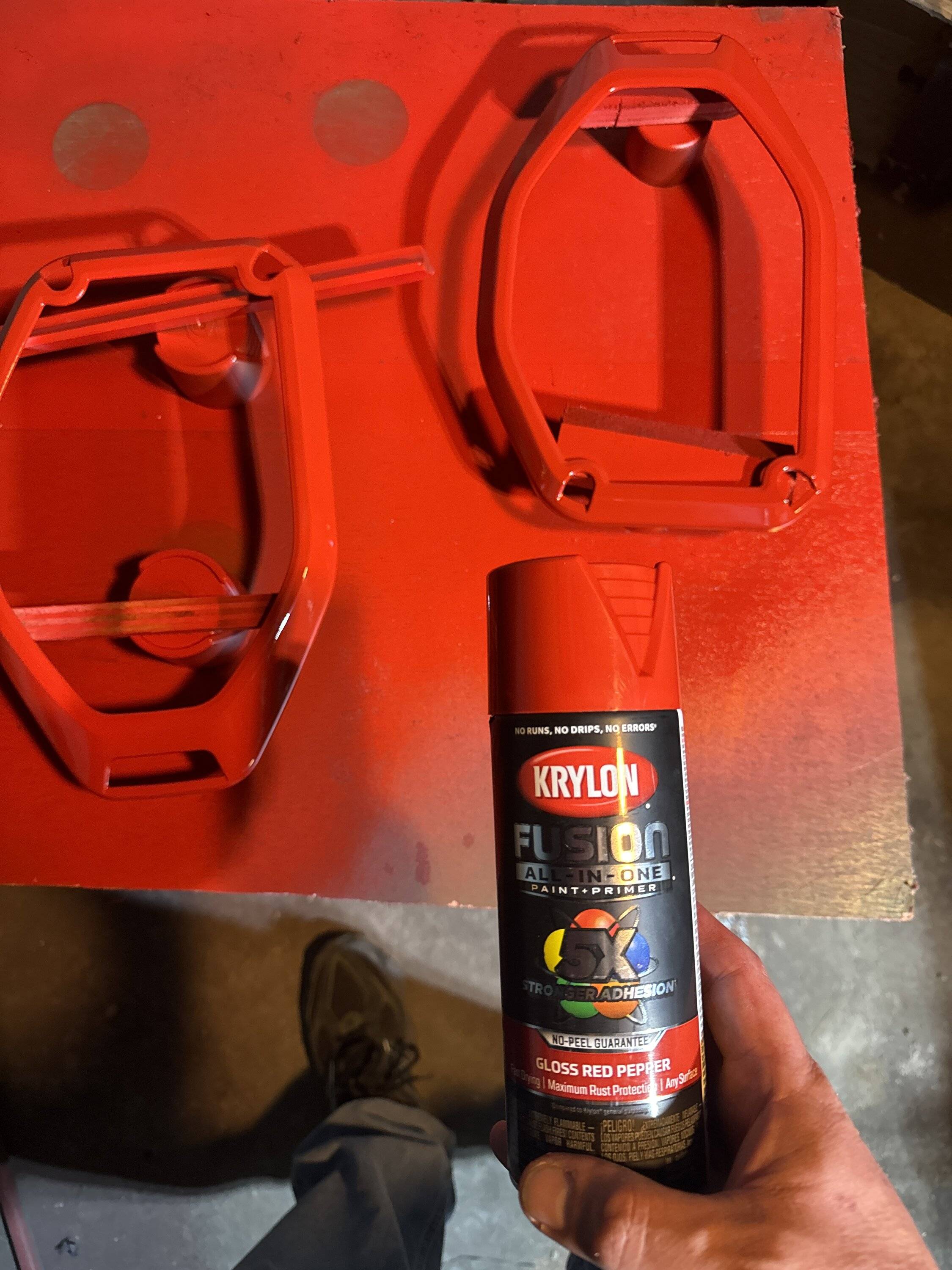

So I decided to give it a whirl.
Had these Amazon speaker trim plates. They came in super bright red.
Started off flat black base, the. I went to this red.
Jeep Gladiator Satin red paint match? image

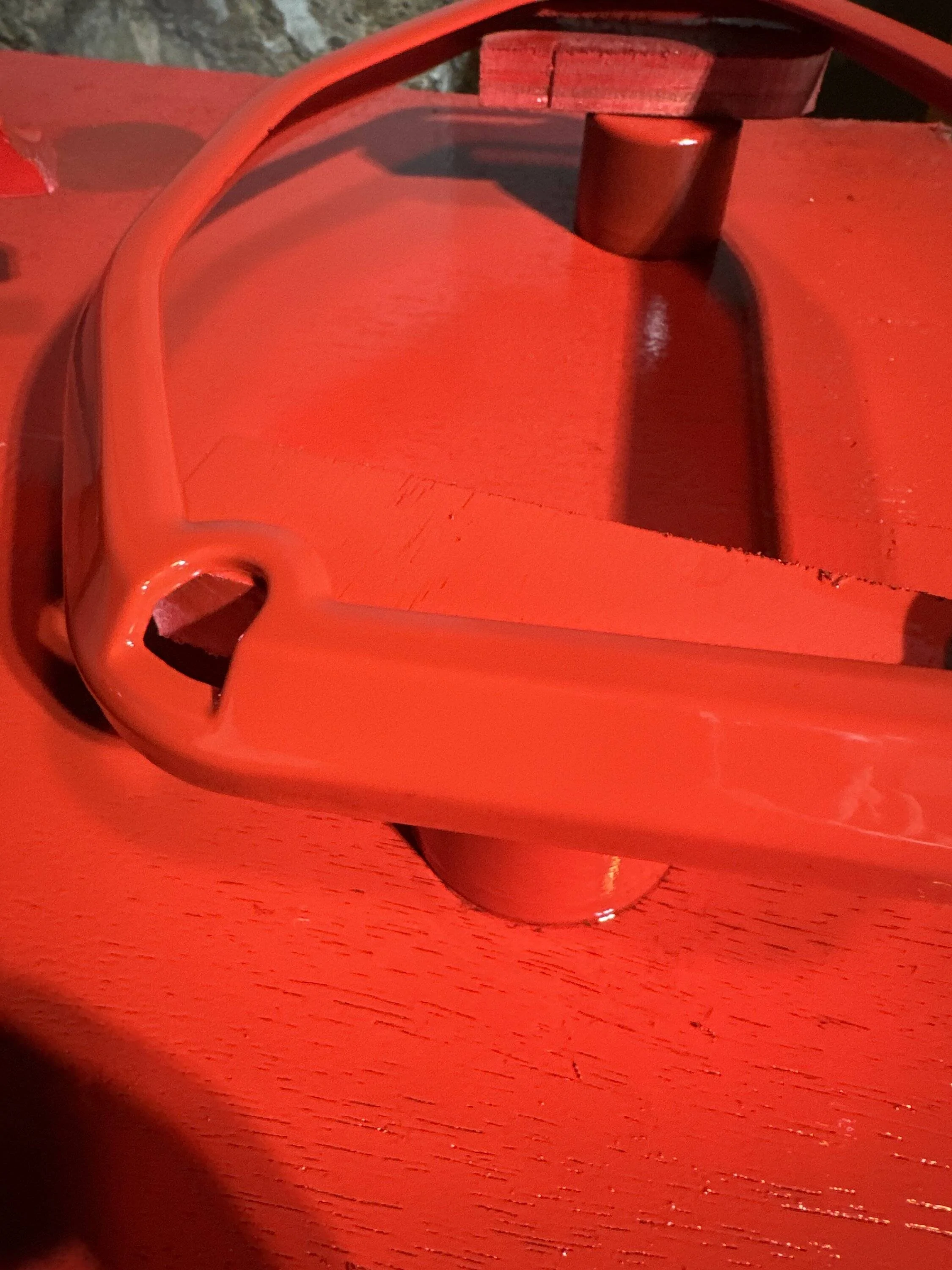

This is how they look WITHOUT A SATIN CLEAR.

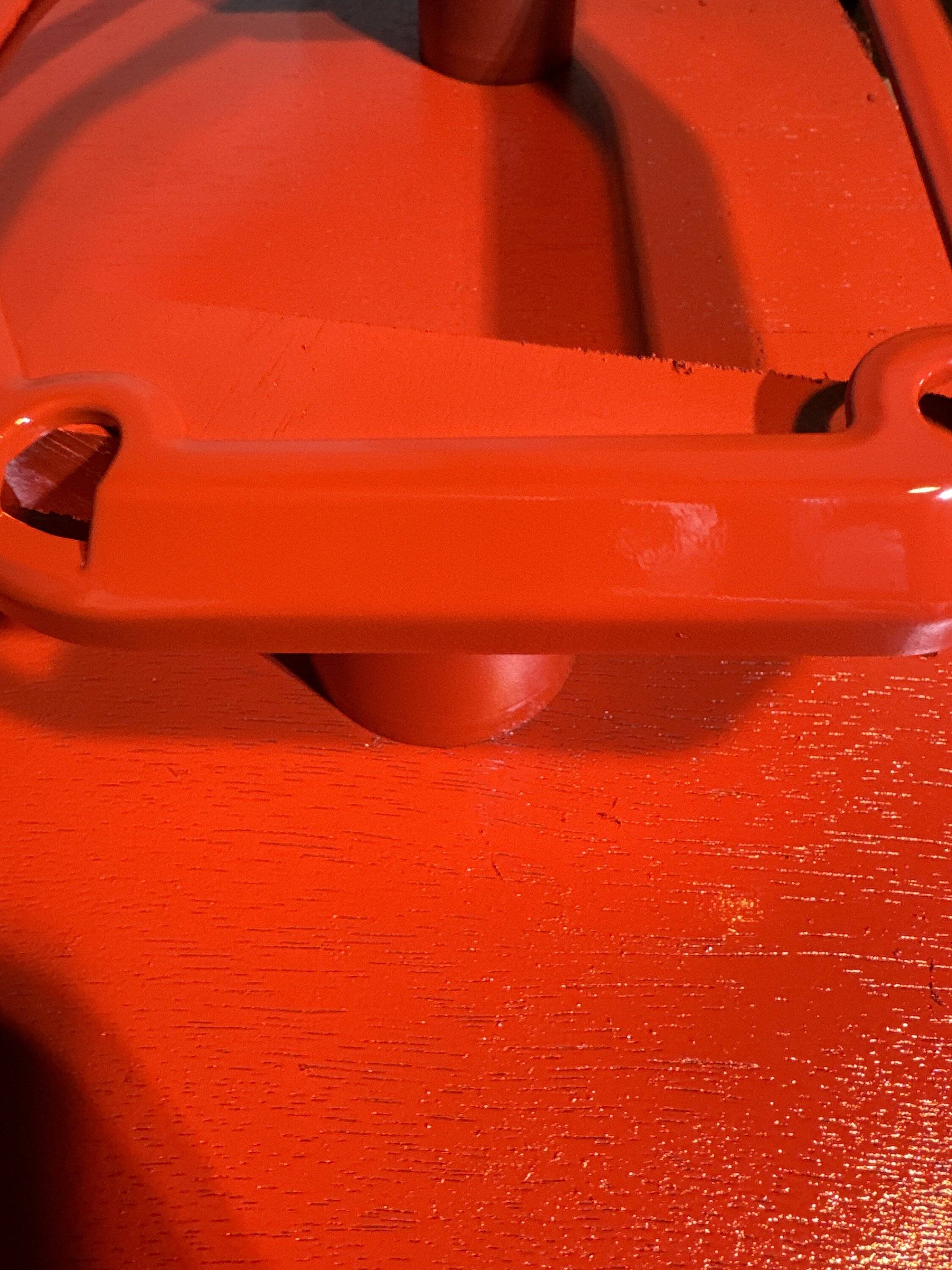

Here is 2 coats of satin clear.
Still has some shine to it. I may let it dry up a few days then put some matte on it and see what happens.
Also, it feels/looks a tad bright. Could go a bit darker.

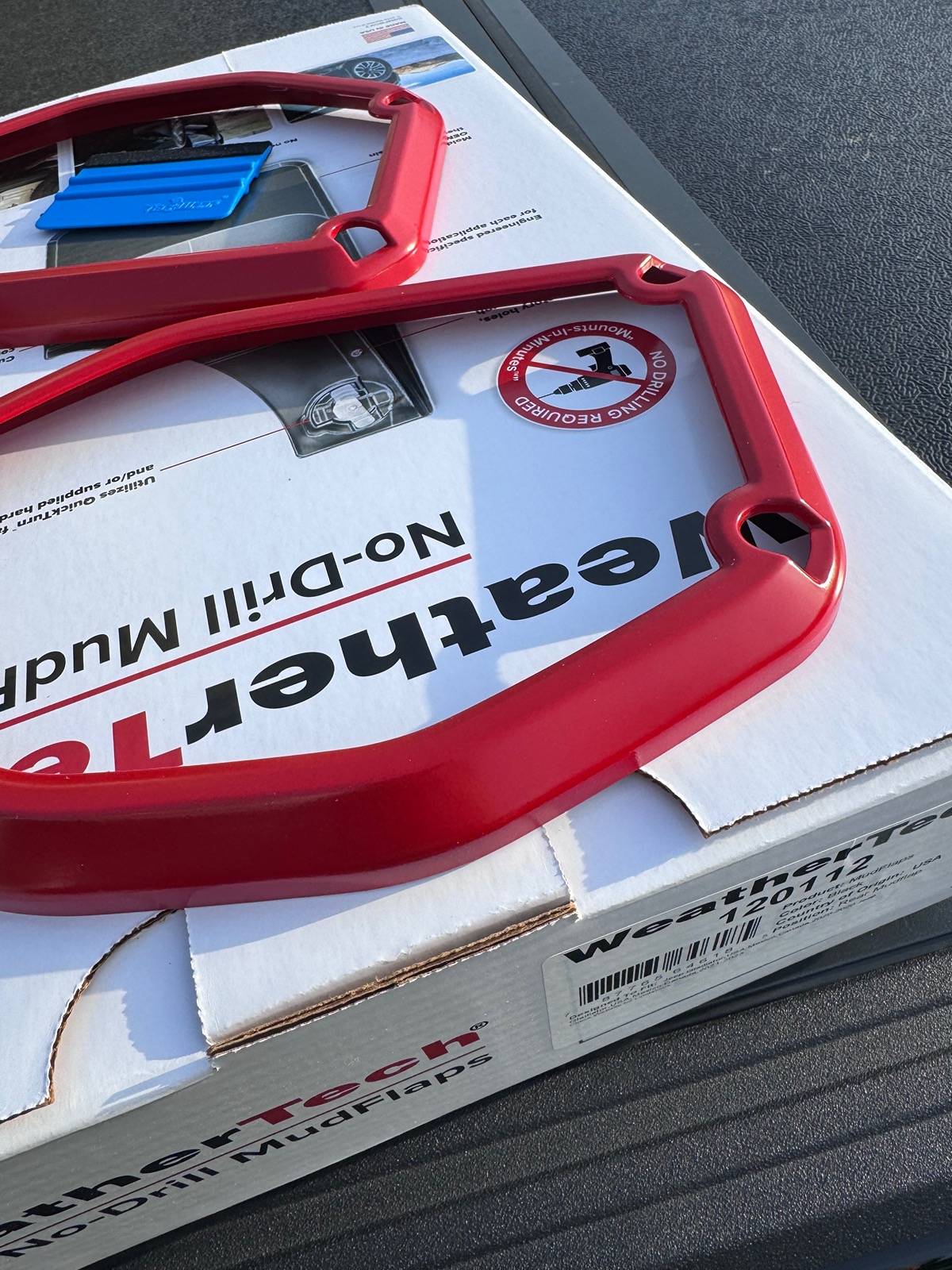

Here is what it looked like after another coat of satin clear. And drying
Looks crazy close
matte black base coat, 3 thin coats of the pepper red above and 4 total coats of satin clear.
Jeep Gladiator Satin red paint match? IMG_8739

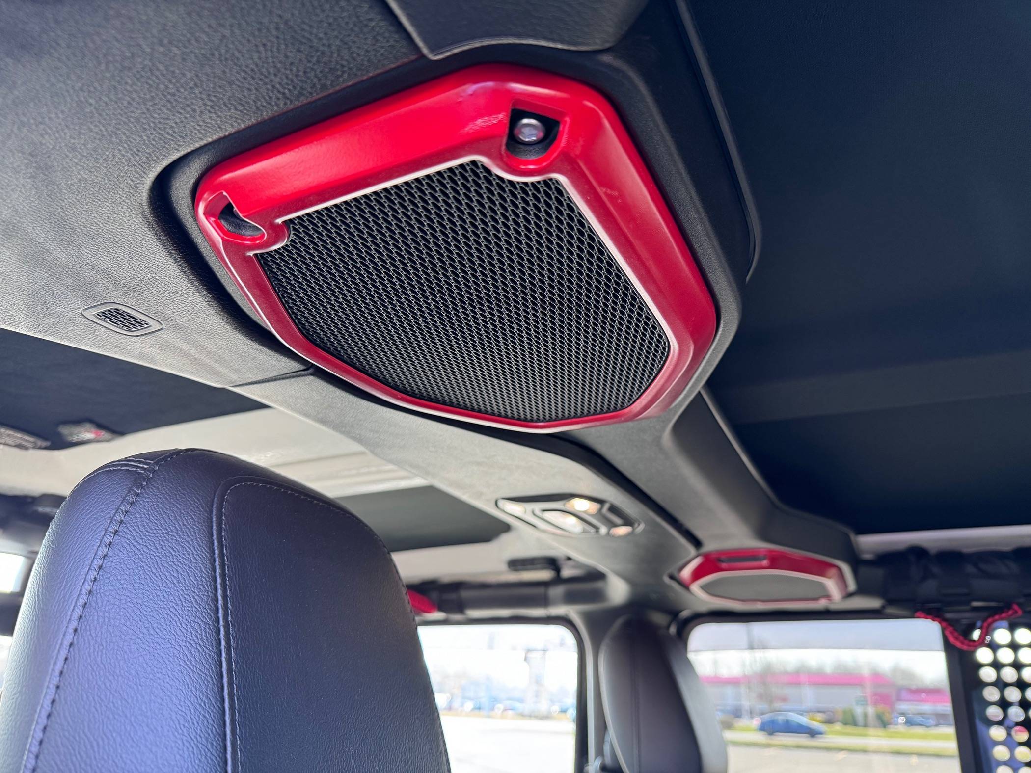

And installed
Jeep Gladiator Satin red paint match? IMG_8740
damn that color is hard to match. Lol.
anyone found a perfect or reaaaaaallly close match? These are close but I feel like they aren’t dark enough.

Are those the stock speaker surrounds?
Because that looks good

got them off Amazon. https://a.co/d/i7cbBGE
It attaches with 3m tape. The tape that comes on them is garbage. Easily replaced with better adhesive tape.
I ordered them in red but didn’t like the color so I painted them the best way I knew how to make the match as close as possible.
I also ordered a ring that goes around the shifter and the couple because those areas tend to be dirt magnets made out of a very tacky kind of rubber, and I wanted to be able to be easily cleaned.
come in I’m gonna use the same color paint, but I’m going to paint them in Matte clear instead of satin clear.
