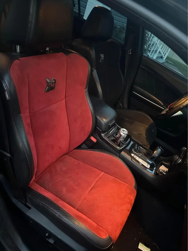

Anybody swap seats out? These scatpack seats are available to me coming heated and cooled, it would be a nice upgrade. Anybody swap seats in their jeeps?

With the right tools and resources you can make anything fit.
As long as width and height wise you have room, it's usually pretty easy to make seats fit any vehicle. Wiring in the heaters and plumbing the cooling will take some work as it's extremely unlikely the connectors will be the same, but if you can get both ends of the connectors you can splice them in however you need.

I swapped out the scat pack seats from a wide body to v6 challenger - had hell on the side airbag and never was able to get the airbag light to come off. Something about disconnecting all power before unplugging them - anyway, just fyi if you make the attempt, discharge all electricity and pull fused prior to unplugging them.
