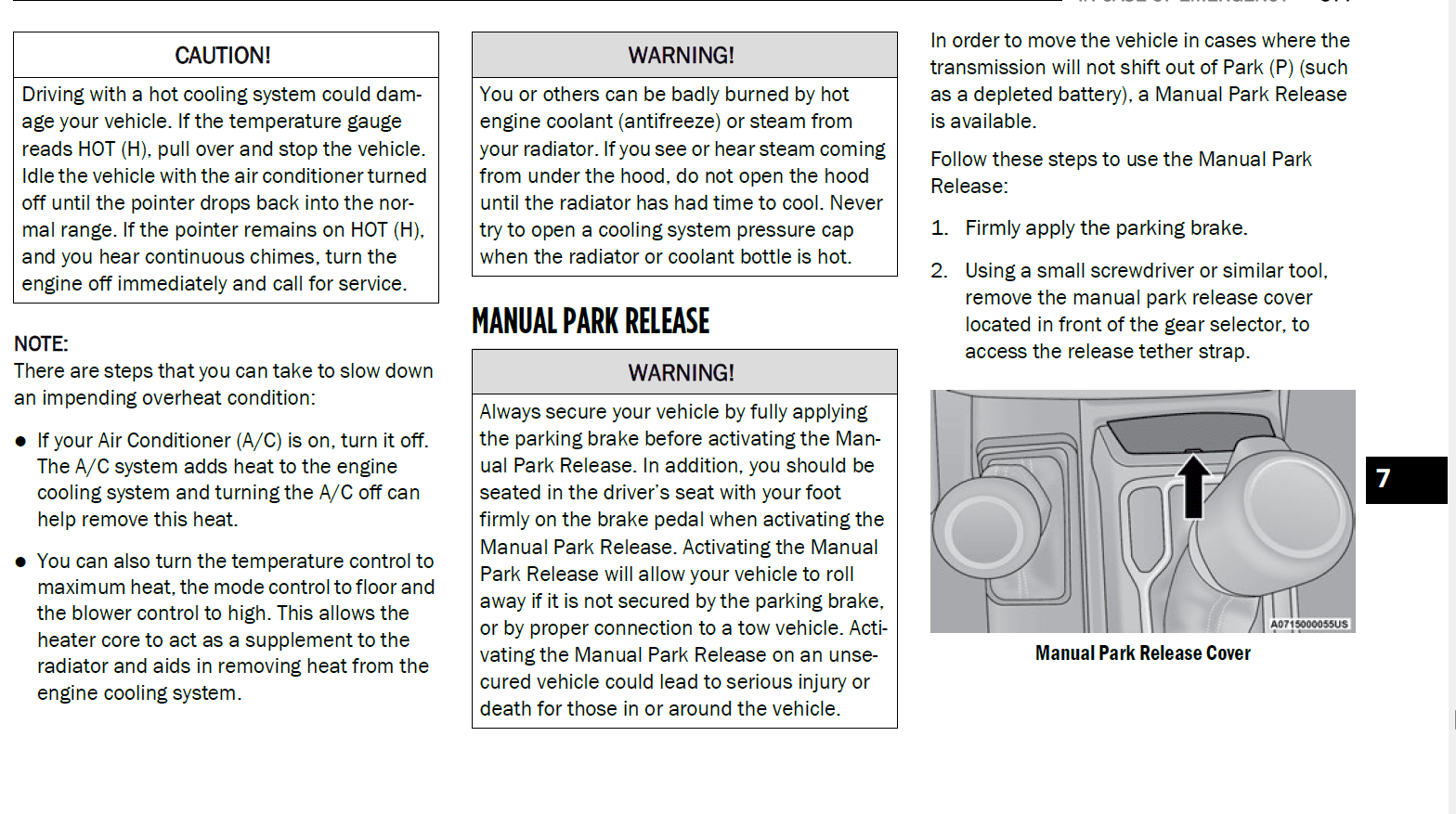

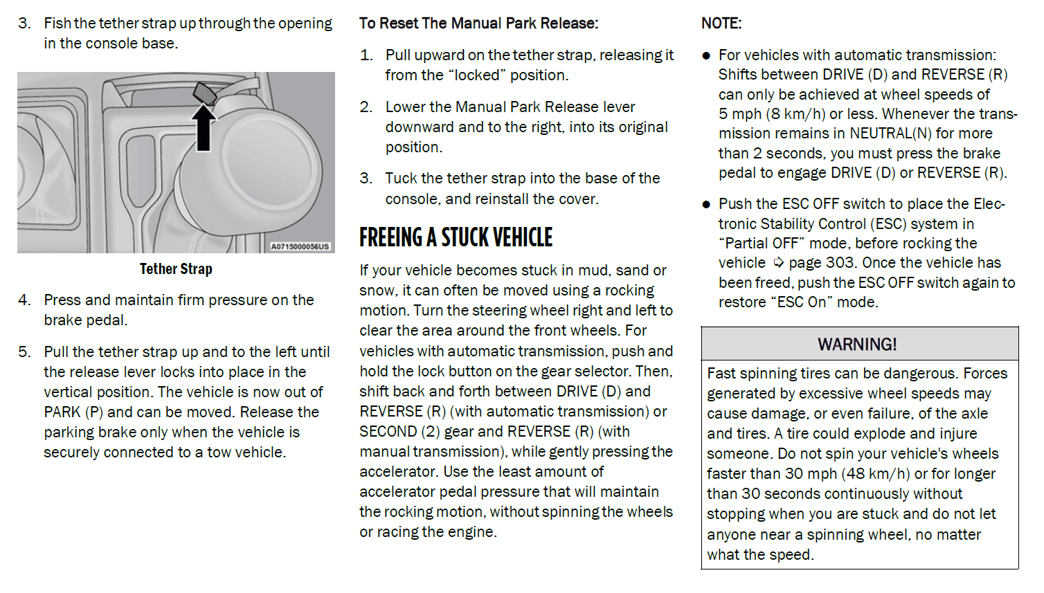

Beyond getting it out of park, did you get an arc when you disconnected the ground cable, or was there any incidental contact with ground after you removed it?
First thing I would try is to give it a power reset.
Carefully remove the cables and the IBS from the - terminal on the main battery. Leave them off for about 30 minutes. Carefully reconnect them and let the vehicle it another 4 hours minimum.
See what you've got then.
