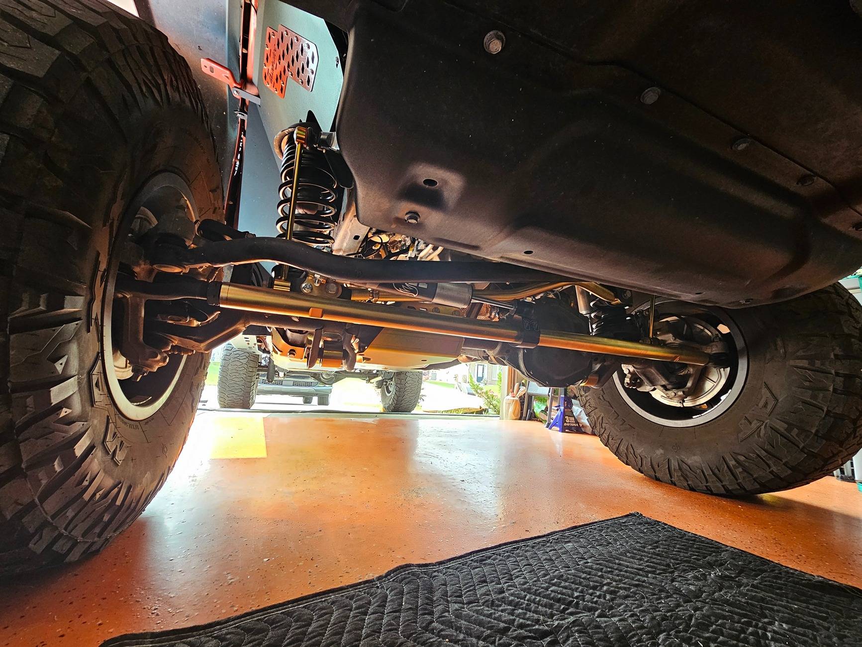

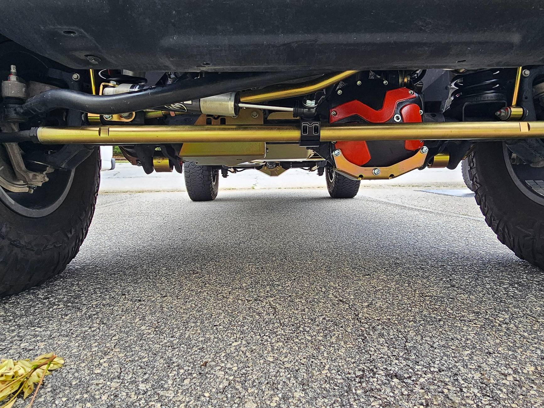

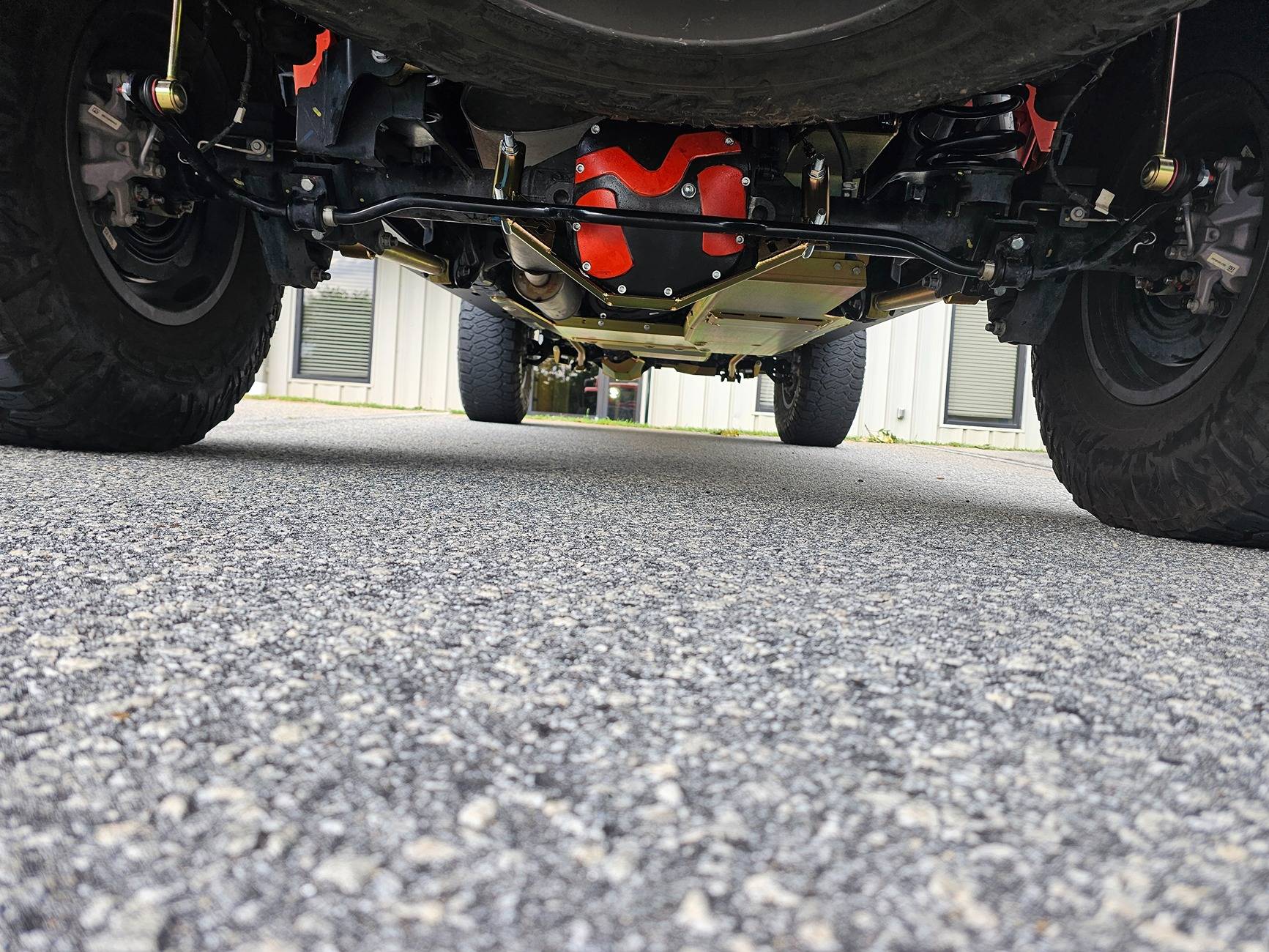

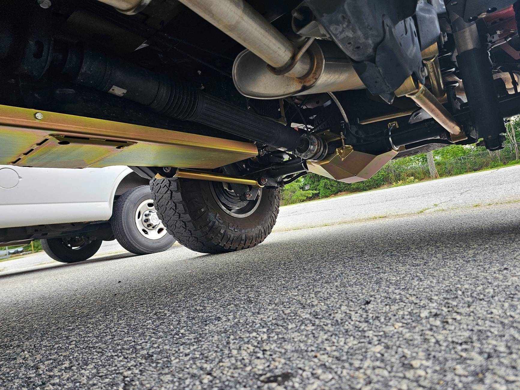

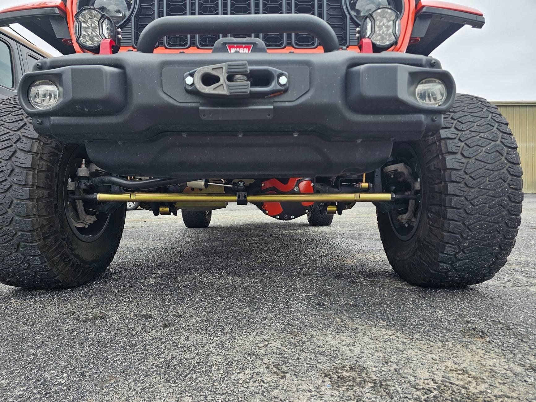

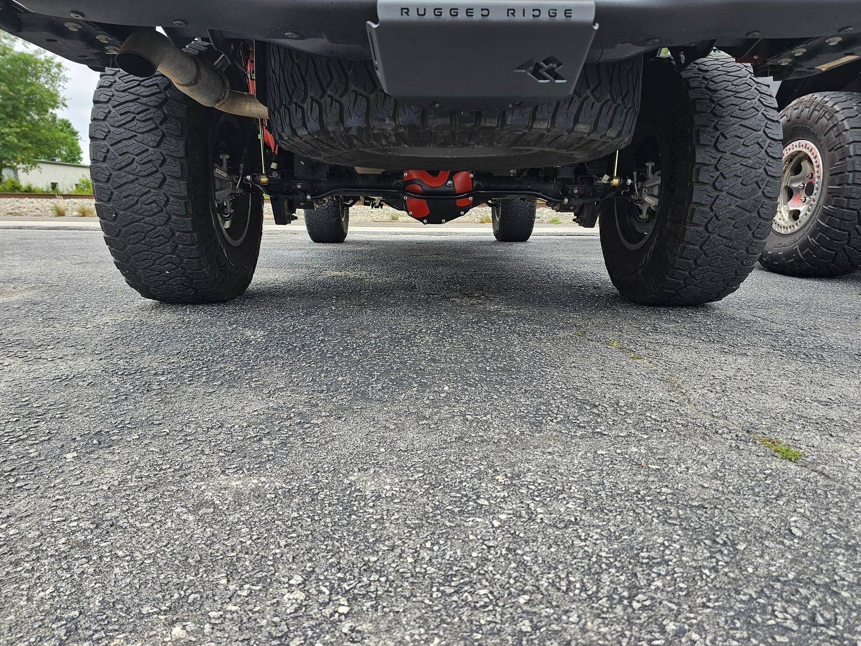

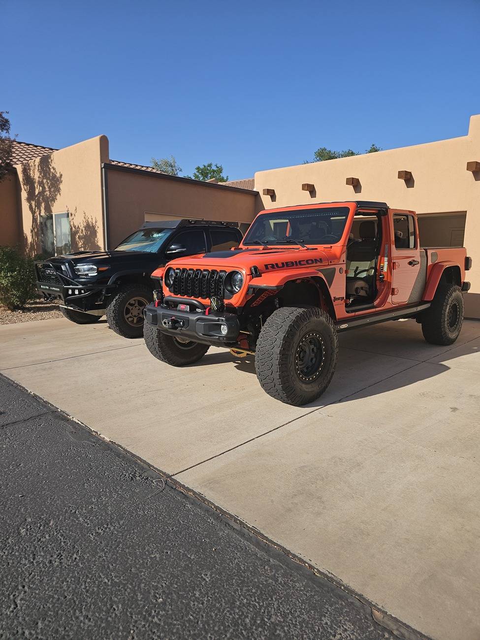

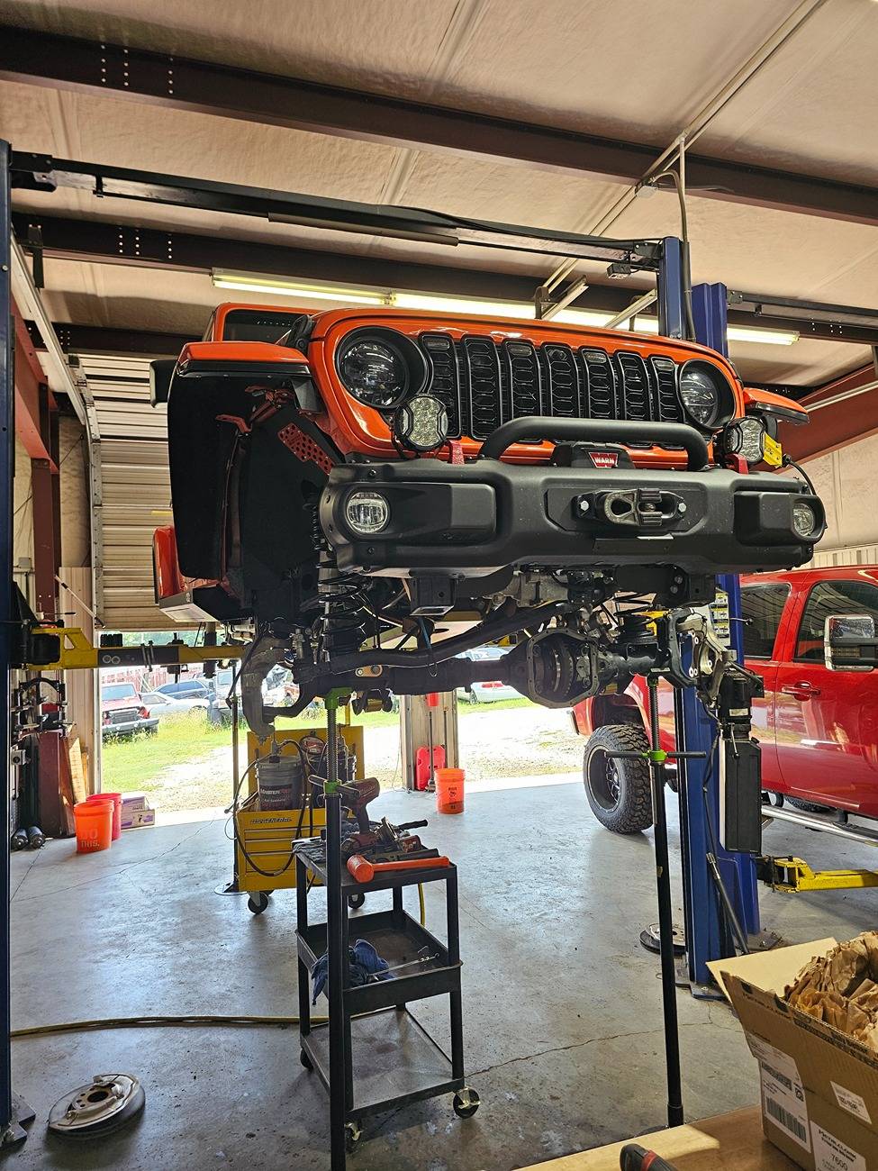

After 3 part time days( 3 or 4 hours each day) I finalized swapping from the Mopar lift to the Metalcloak Gamechanger 2.5" lift. And installed my Undercloak system as well.

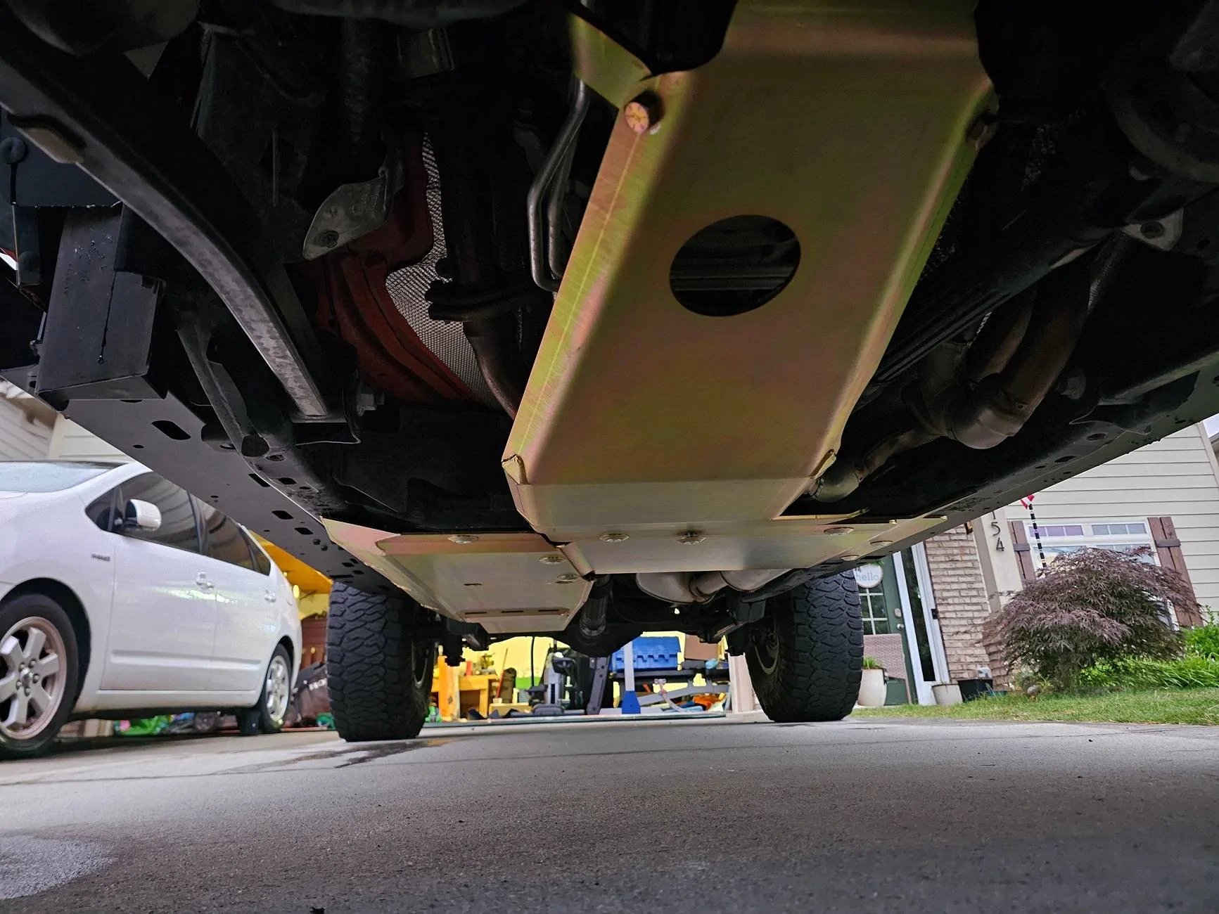

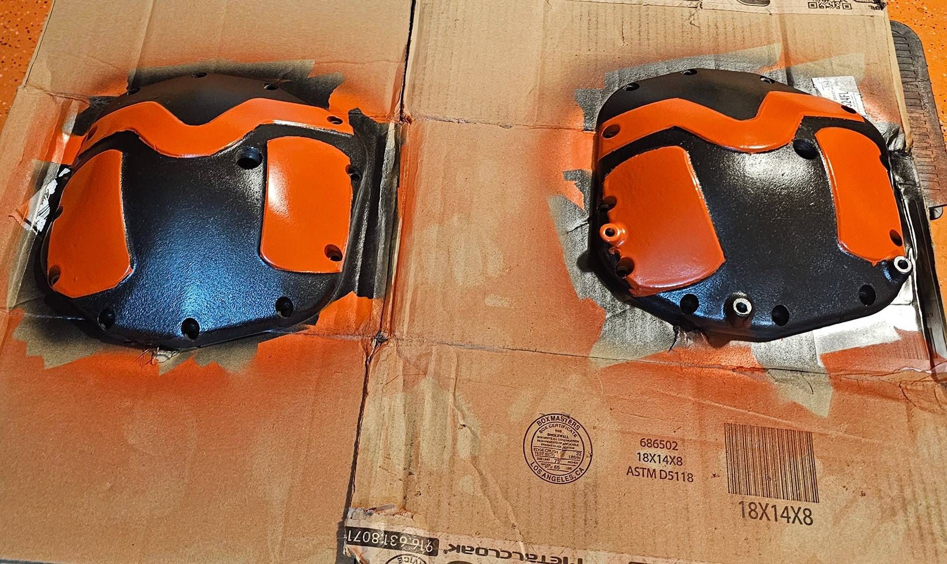

Got the break in diff fluid changed. And the shop did me a favor and threw on the front and rear @Metalcloak diff skids to complete the golding underneath.

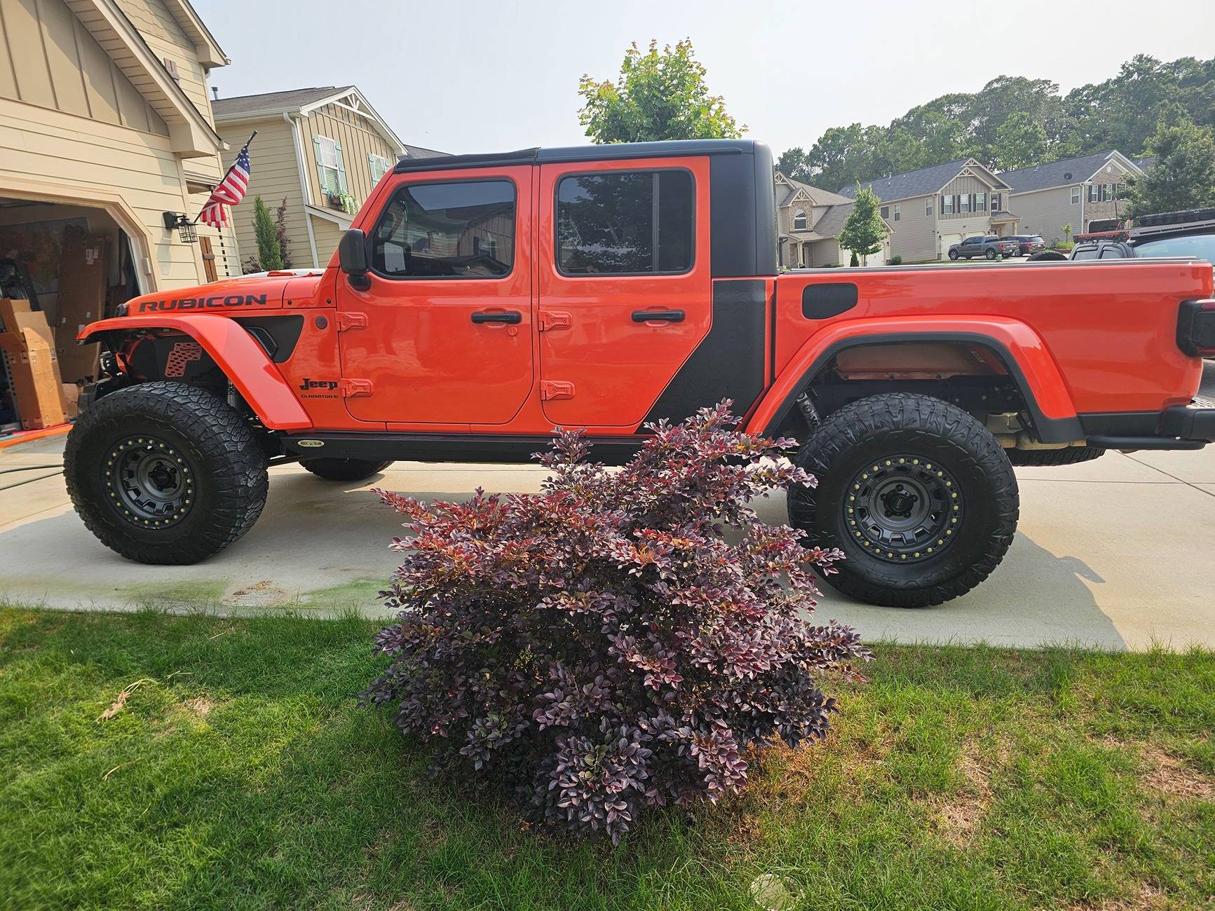

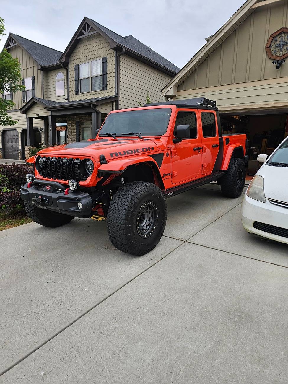

Then I got home and took the Trailrax front half rack I got used into a rear half rack. I removed one of the fairing bolts on each side and loved the lower bolt holes to the upper bolt holes. Added some of the rubber/metal fairing gasket to the front corner and I also ordered a pair of the rear feet so that it would stand up a little higher from the roof to prevent rubbing. Long term I will need to adjust the load feet so that they sit on the roof(I'll need to drill new holes in them to move them down) but for now its just got to house my rifle case on the roof so that I can put tools/recovery gear on top since the bed will carry all our luggage and food/water to Moab on the way out, and on the trail the spare will be taking up the bed. Its a good solution for now.

That's a nice machine you put together

Sweet rig and build. Well done!

Climbed right up like a pro, well done sir.
