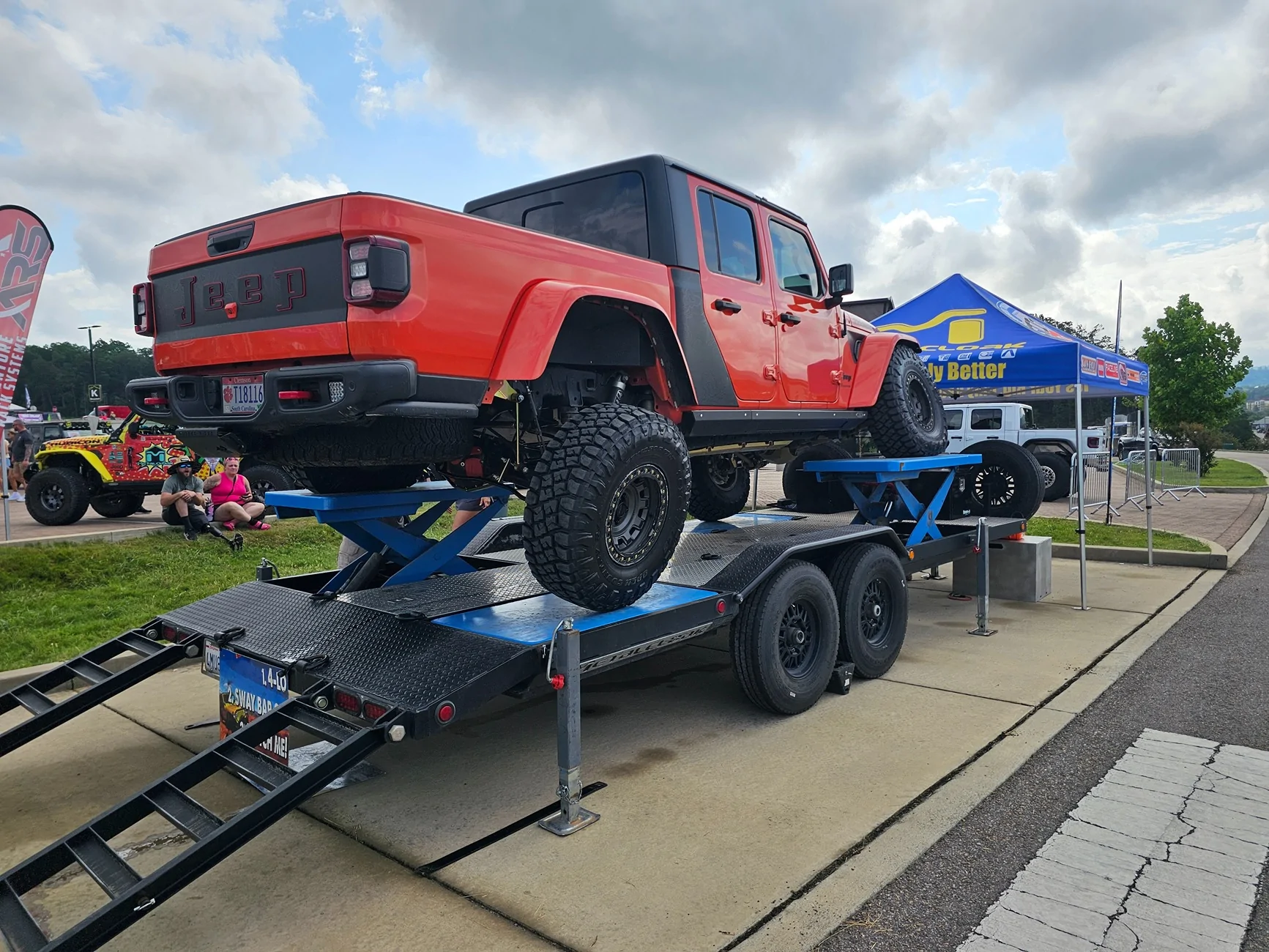

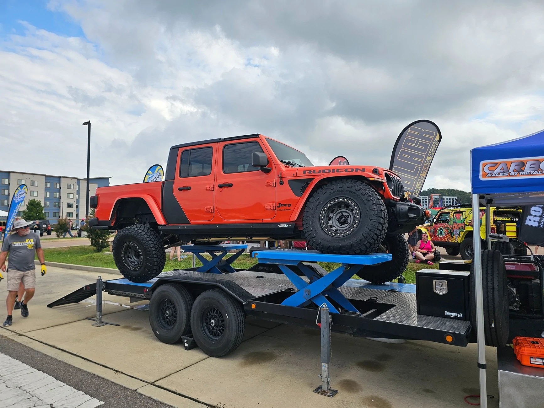

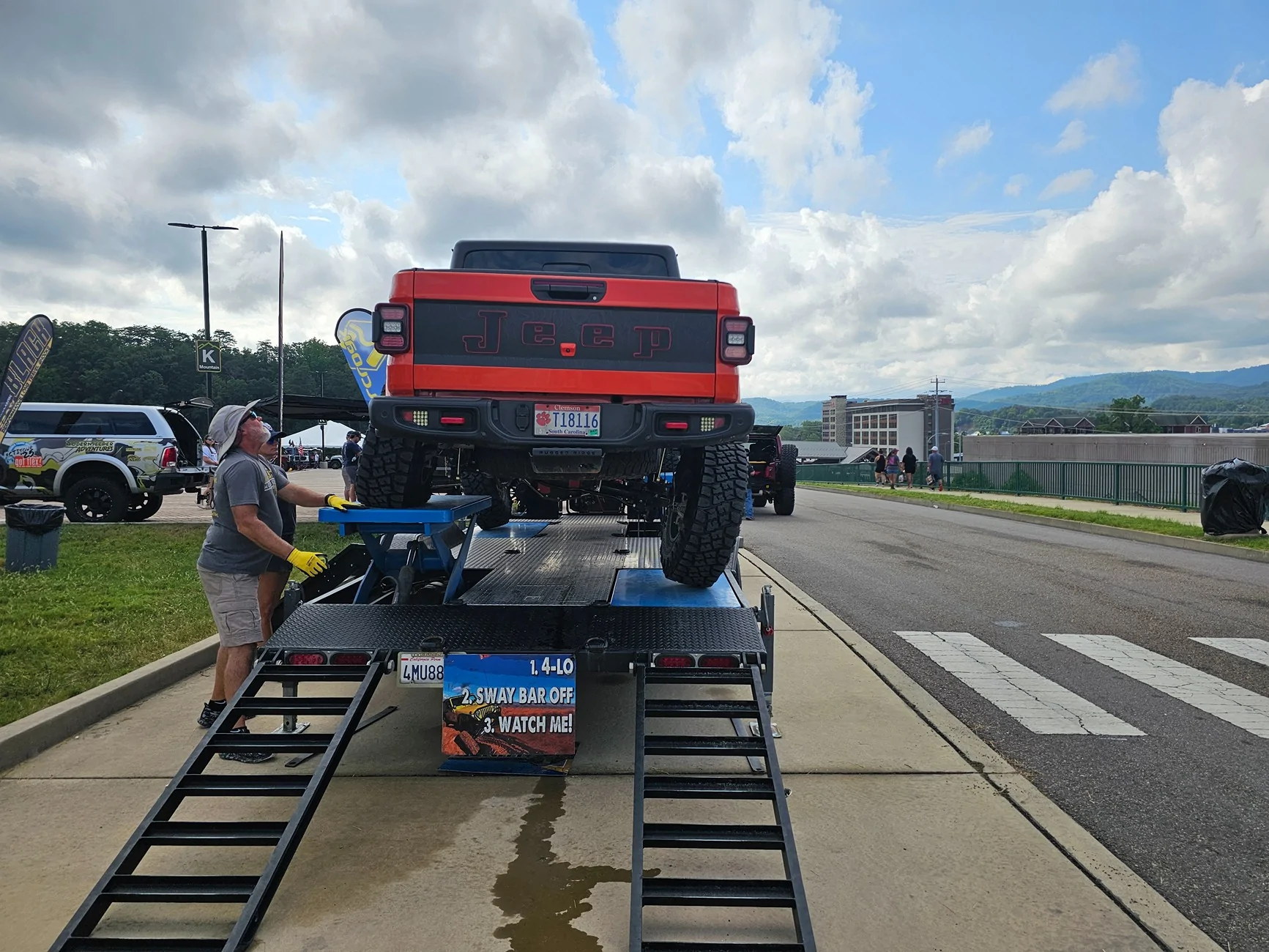

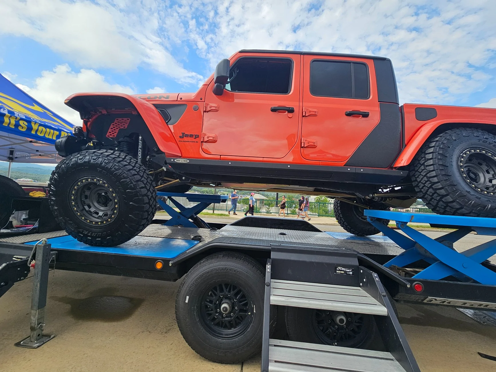

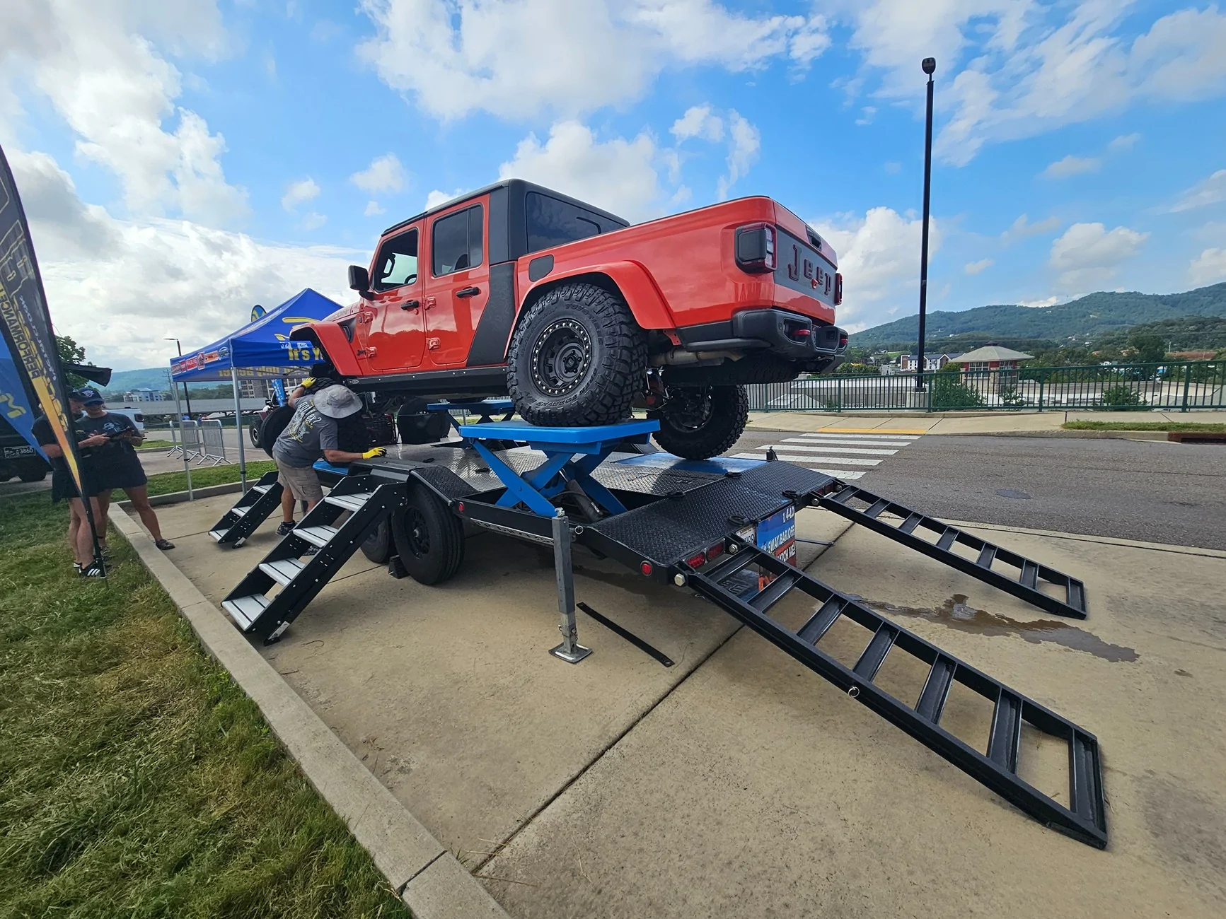

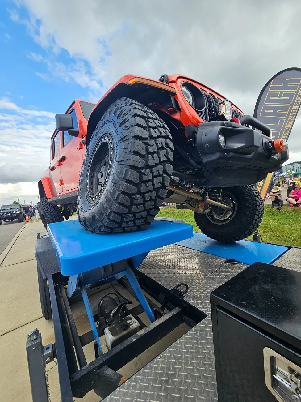

Got to SMJI early this morning, 3rd in line at 830, for the Metalcloak CTI trailer. Scored an 850. They said I was sitting on the rear bumpstop and think if I remove a puck then I could score as high as 880. Ill remove and possibly retest at Myrtle Beach Jeep Jam.

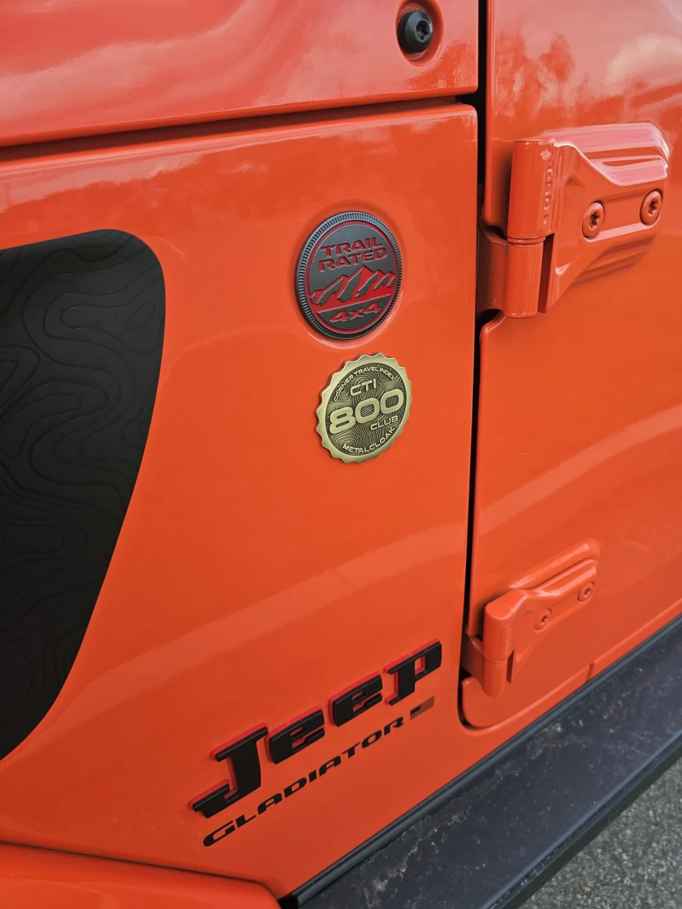

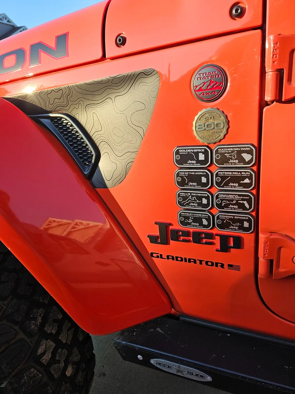

A week or two ago after getting the @Metalcloak CTI badge i decided to mount my Jeep BOH badges.

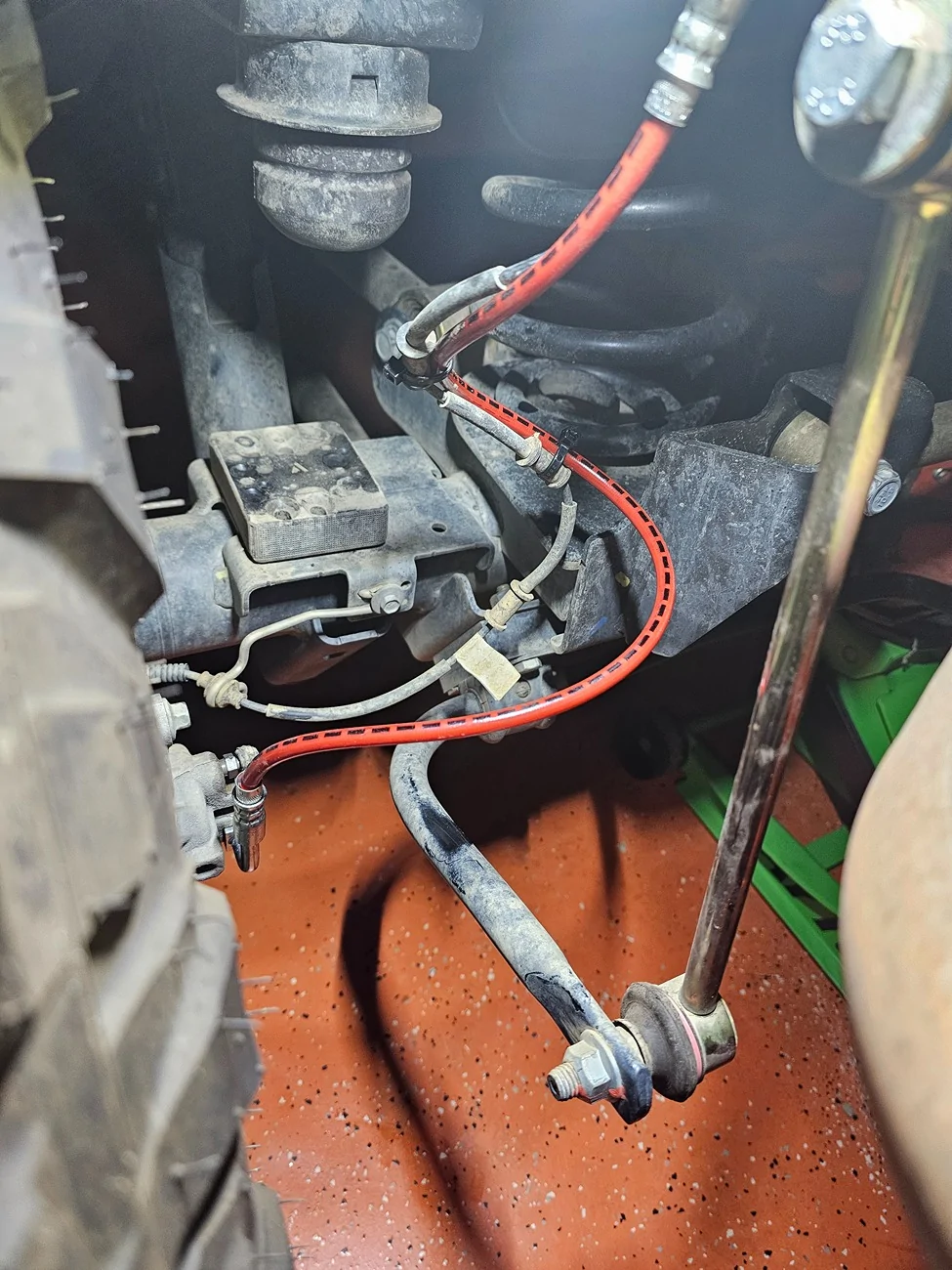

While on the CTI trailer they told me if I removed 1 puck in the rear they believed I would gain another 30 points or so. So I removed those and then last night I installed my MC brake lines that came with my lift bc they also said my lines looked maxed out on the trailer.

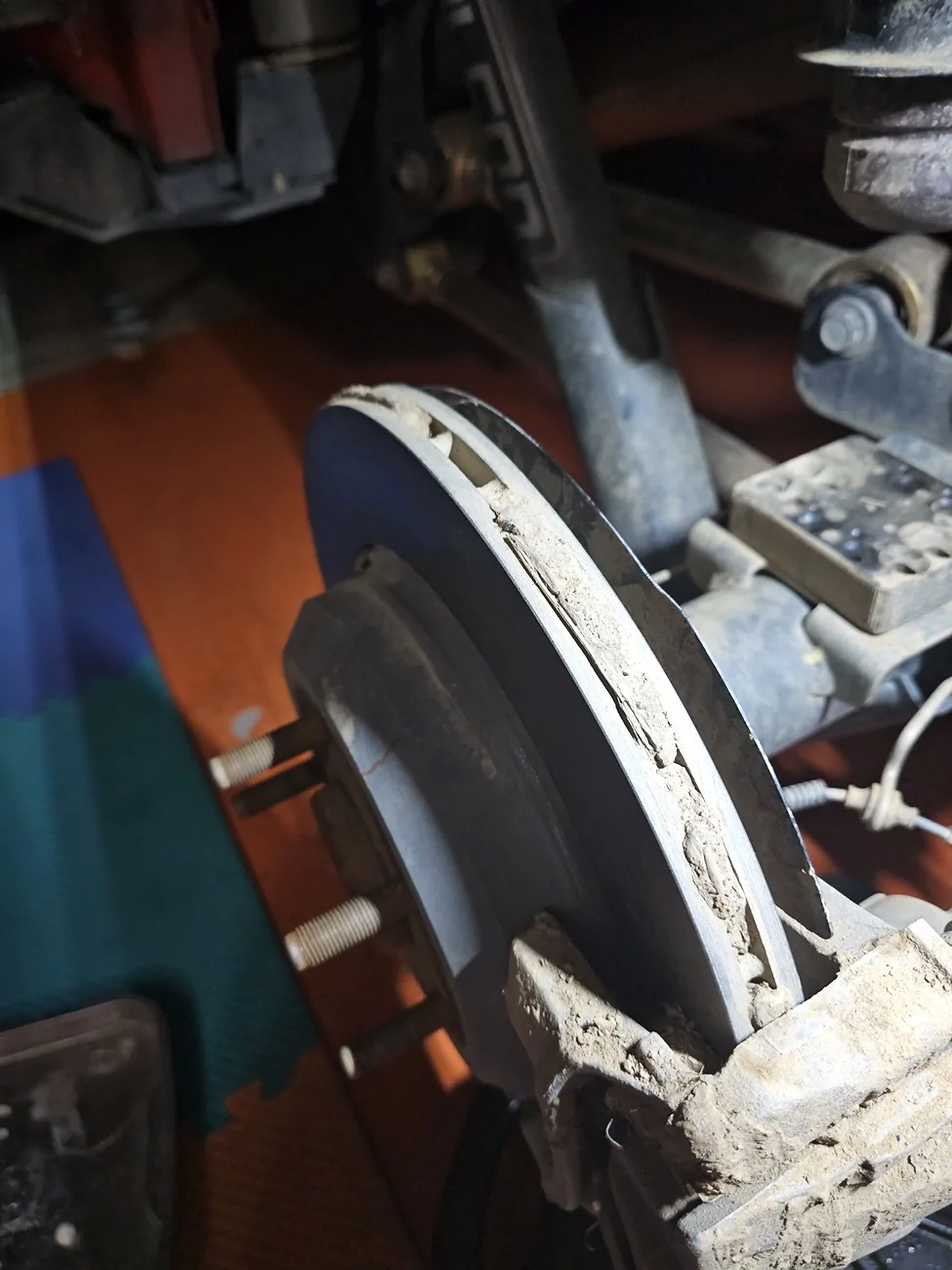

While I had the wheels off I found mud(more like cement lol) clogging up all the cooling flutes in my driver's rear rotor. Cleared the mud out and after driving to a localish Jeep show today believe the little shimmy I had in the rear is gone now.

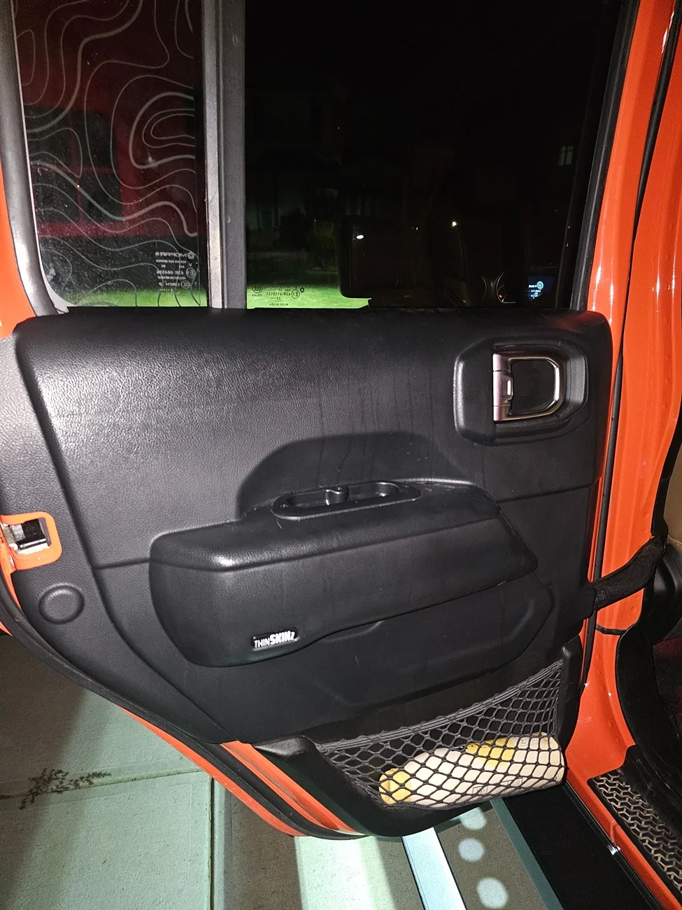

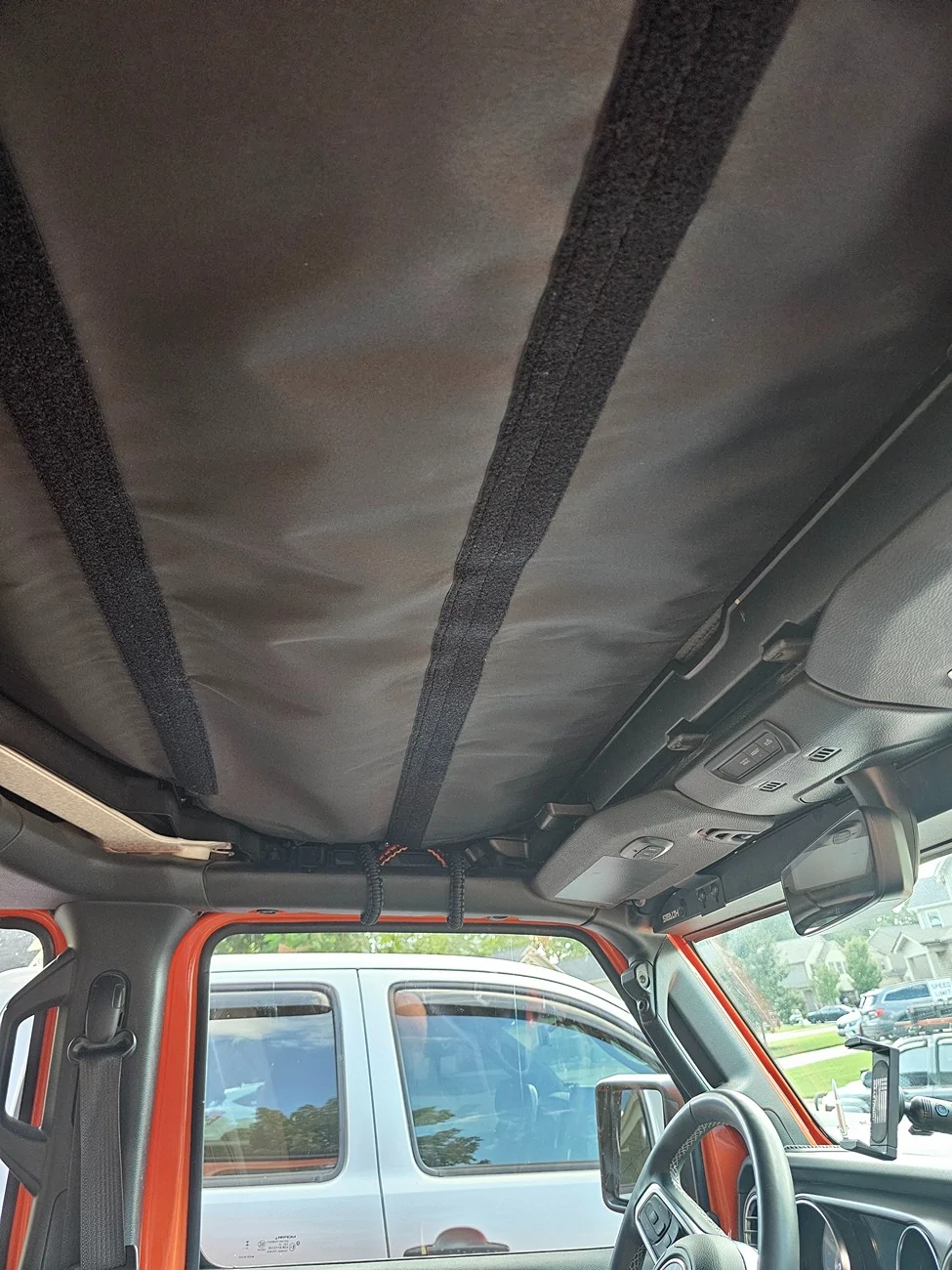

I also finally located a set of Thin Skinz for my truck on the book of faces market place.

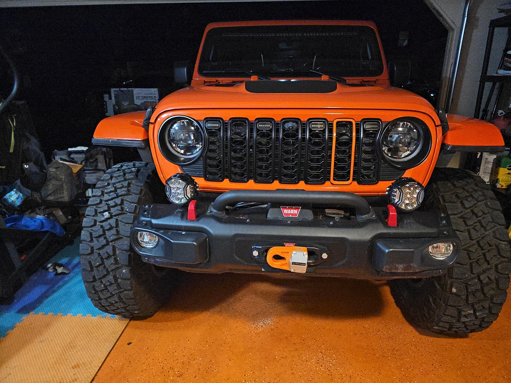

Finally I installed one of the Grille stripes from Underground Graphics at SMJI.

Dude better clean that mud outta them rotors Holy crapola
