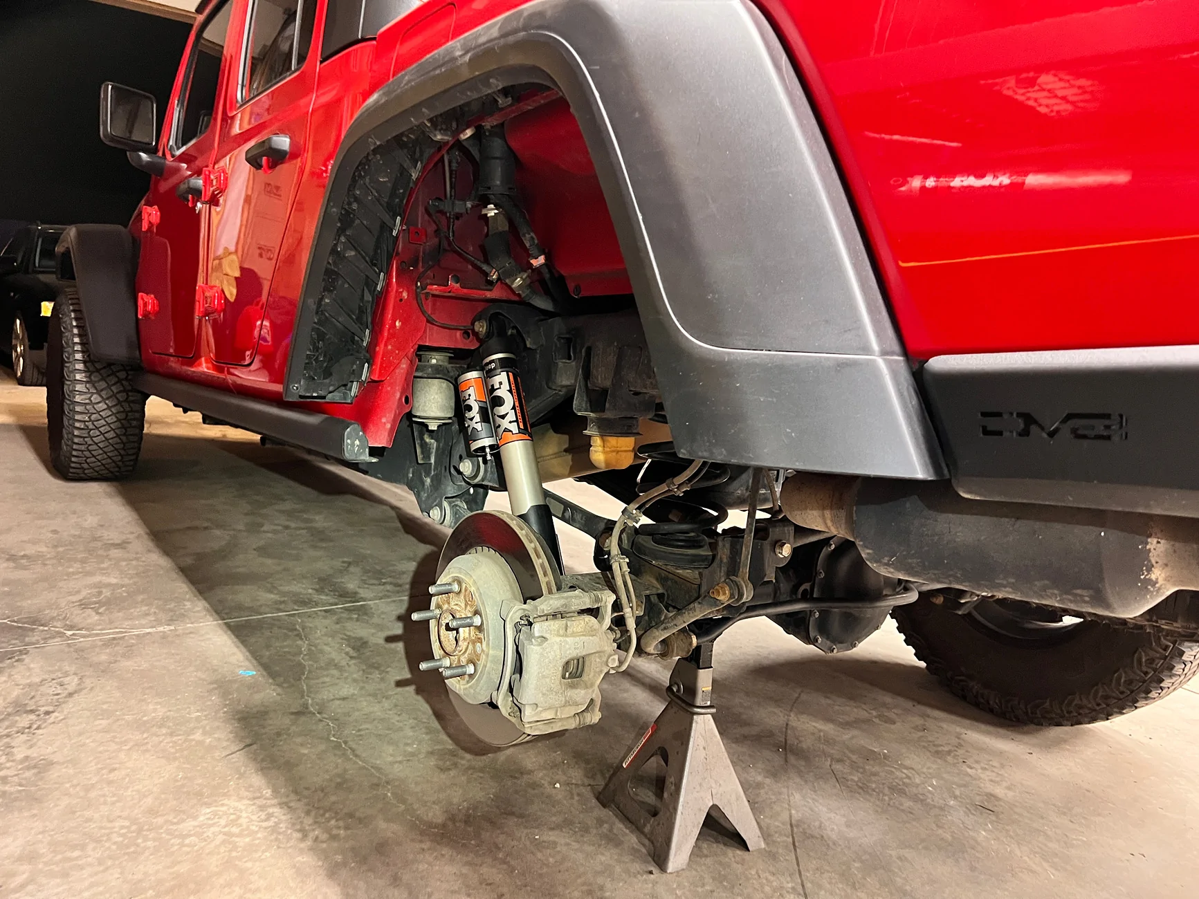

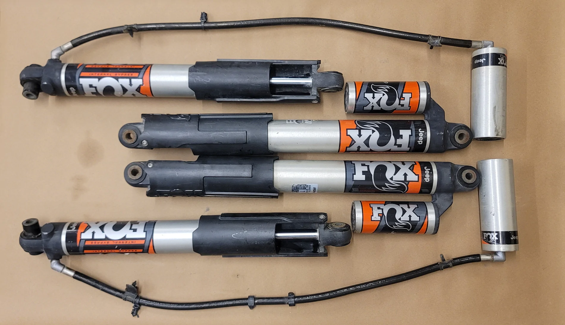

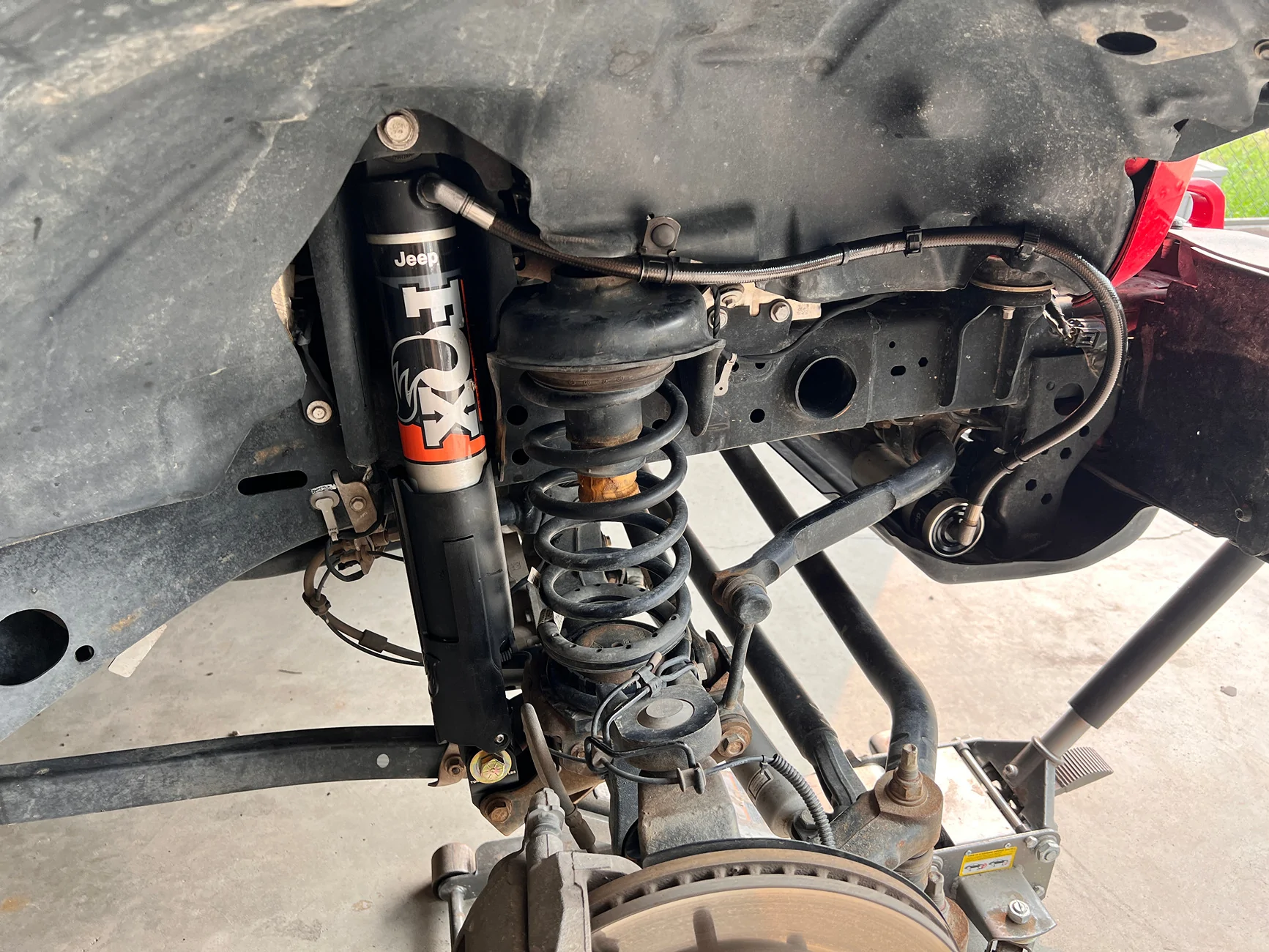

Skip the factory Rubicon shocks. They are crap. If you can find a deal on used Mojave 2.5" shocks they are amazing! They completely transformed my Jeep. They aren't a direct bolt on but they really aren't too difficult. I never weighed them but I bet one Mojave shock weighs the same as 3 of the Rubicon shocks.
