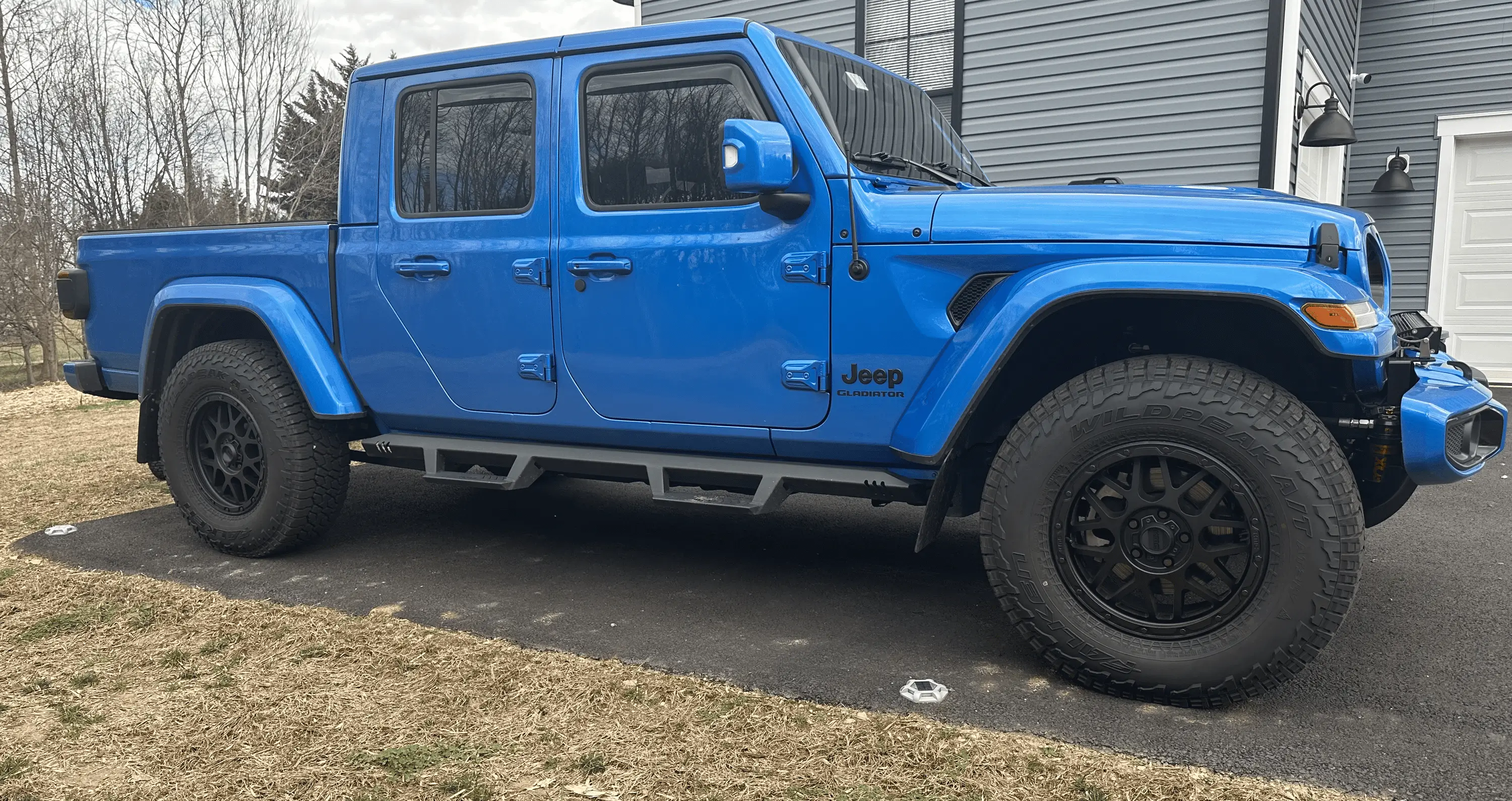

22 High Altitude here (wide dana 44's stock), fox elite 2.5 shocks and 1.5" front level. nothing else. 3.73 gearing.
35's (actually 35.4" 285/75/18s) work and fit perfect, I've been very happy with them over the 33's. 0.5mpg less maybe, nothing significant. Drives and runs much better frankly than stock. See 7 and 8th gear often, esp on highway. After i changed the tire size in the computer, the transmission re-learned and its perfect.

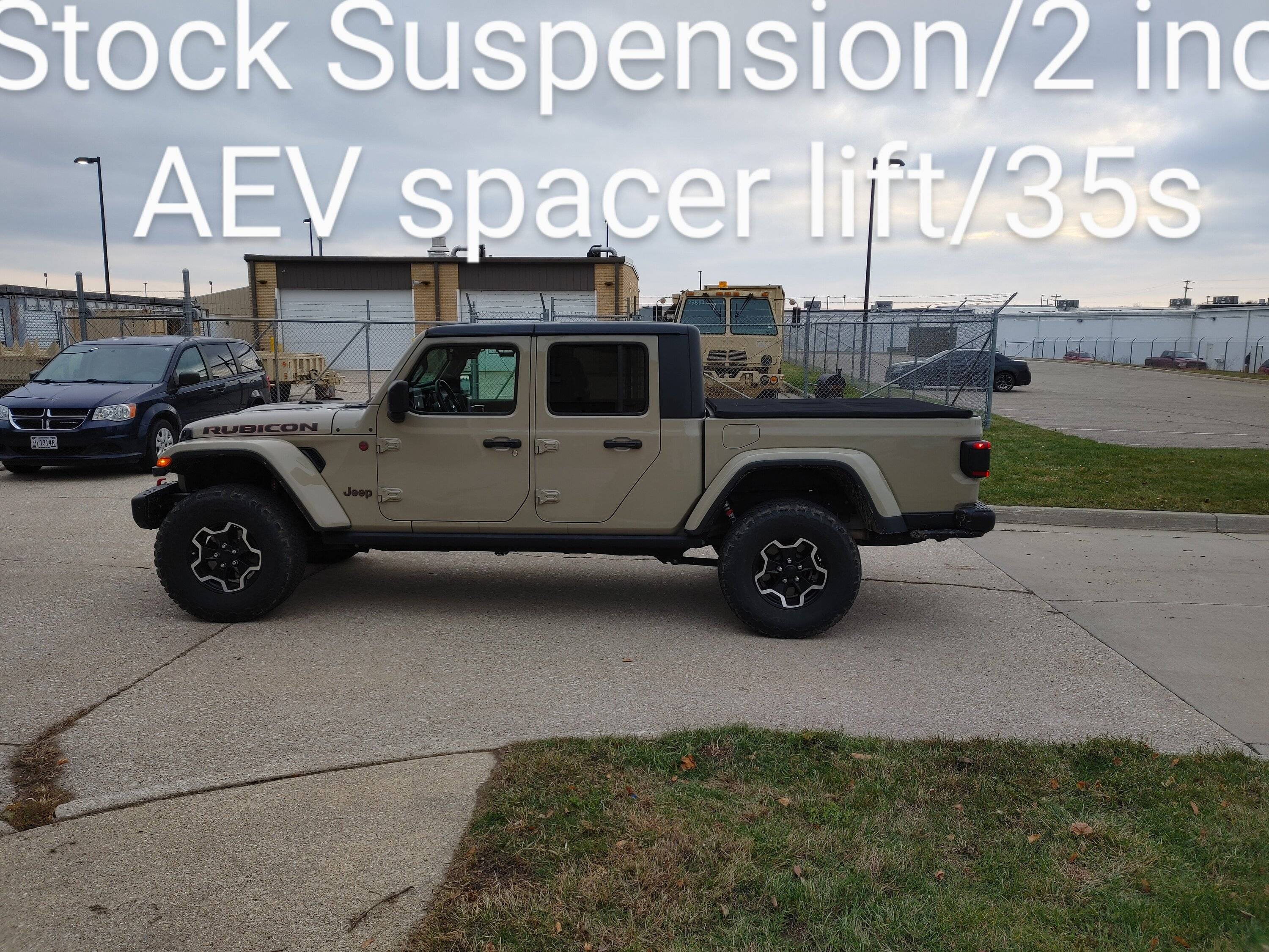

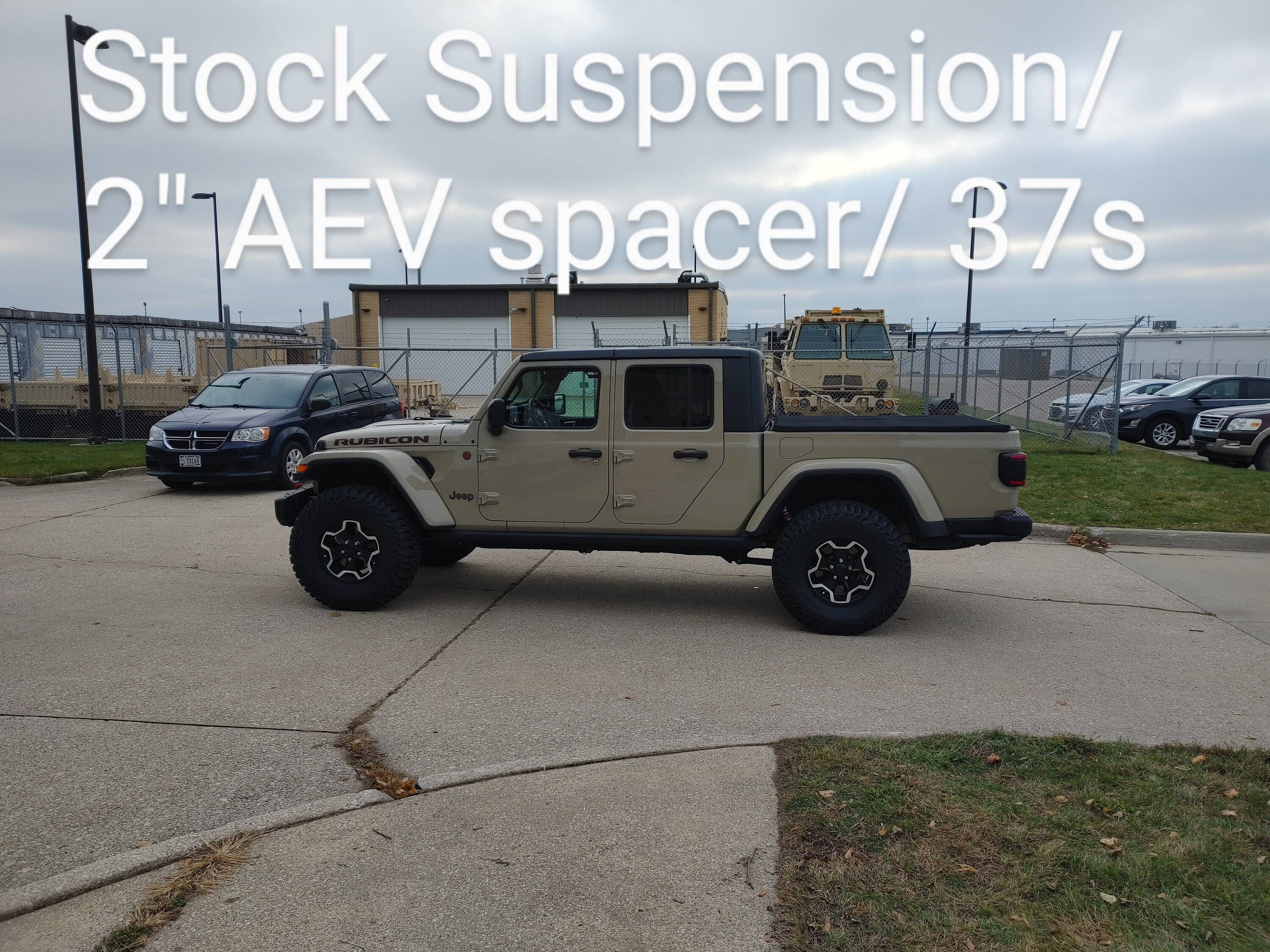

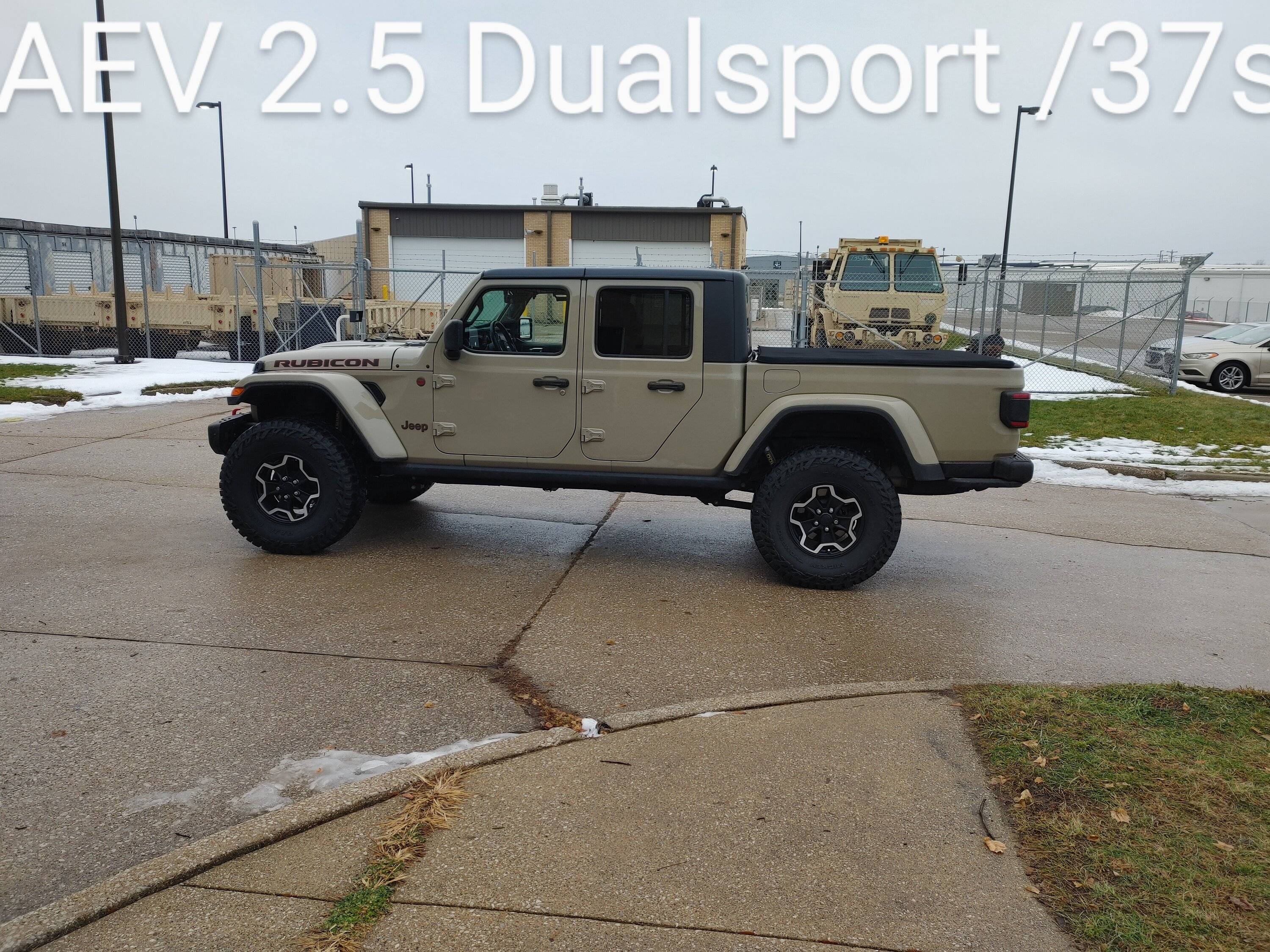

Different fenders on the Rubicon. But here are pics of the aev 2 inch spacer lift vs the 2.5 spring. I'd recommend either of these options for what you want.
Maybe do the 2 inch spacer lift and use the saving on a full lift to get a regear. If your going to go 35s or bigger the absolute best thing you can do is proper gearing.
