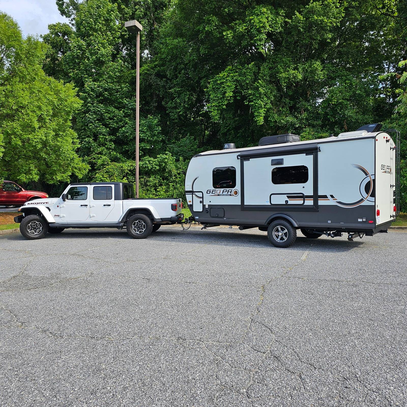

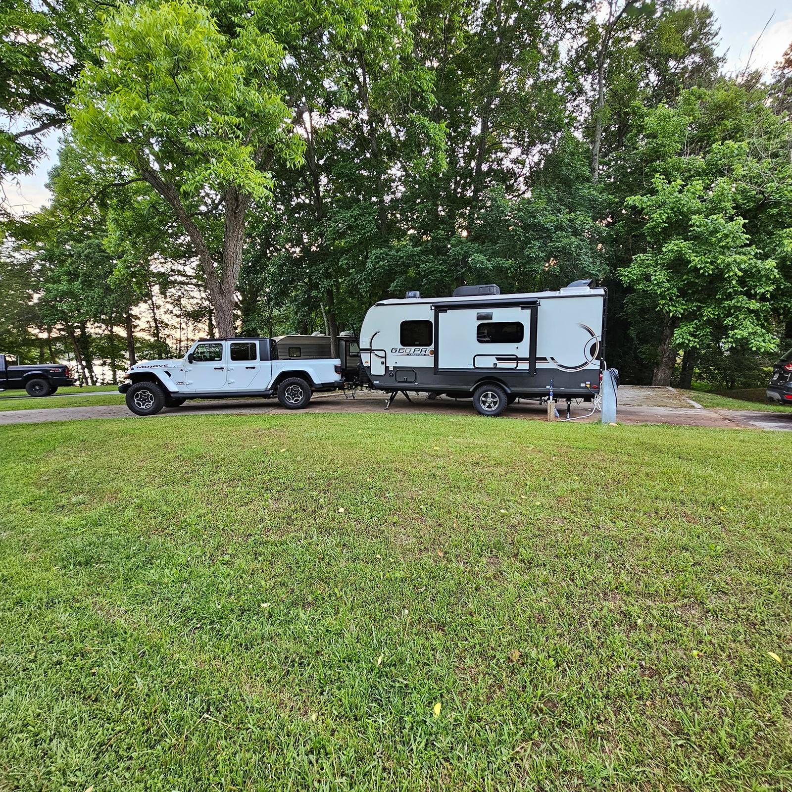

Furrion 5 inch rear camera.
I adjust up while in transit and then down when backing in to spot.
No noticeable delay.
Jeep Gladiator Side cameras and backup cameras what’s your setup? 1000028276
Jeep Gladiator Side cameras and backup cameras what’s your setup? 1000028258
No suspension mods on gladiator. Bone stock.
Tows fine up to 65. Manual shifting as needed.
