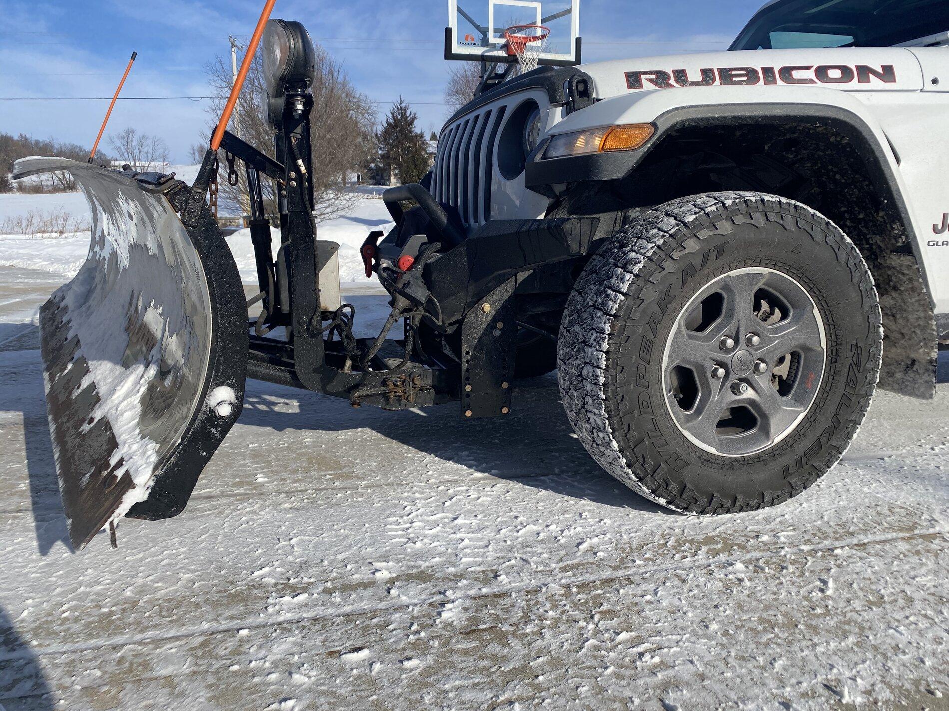

Just FYI for those looking at plows, Boss does have push plates and wiring harness specific to the JT/JL. Had one mounted up today and everything seems to fit fine.
Note I do have a 3 in. lift and 34's so the push beam sits a tad high even in the lowest setting. TBD how it goes when snow flies.

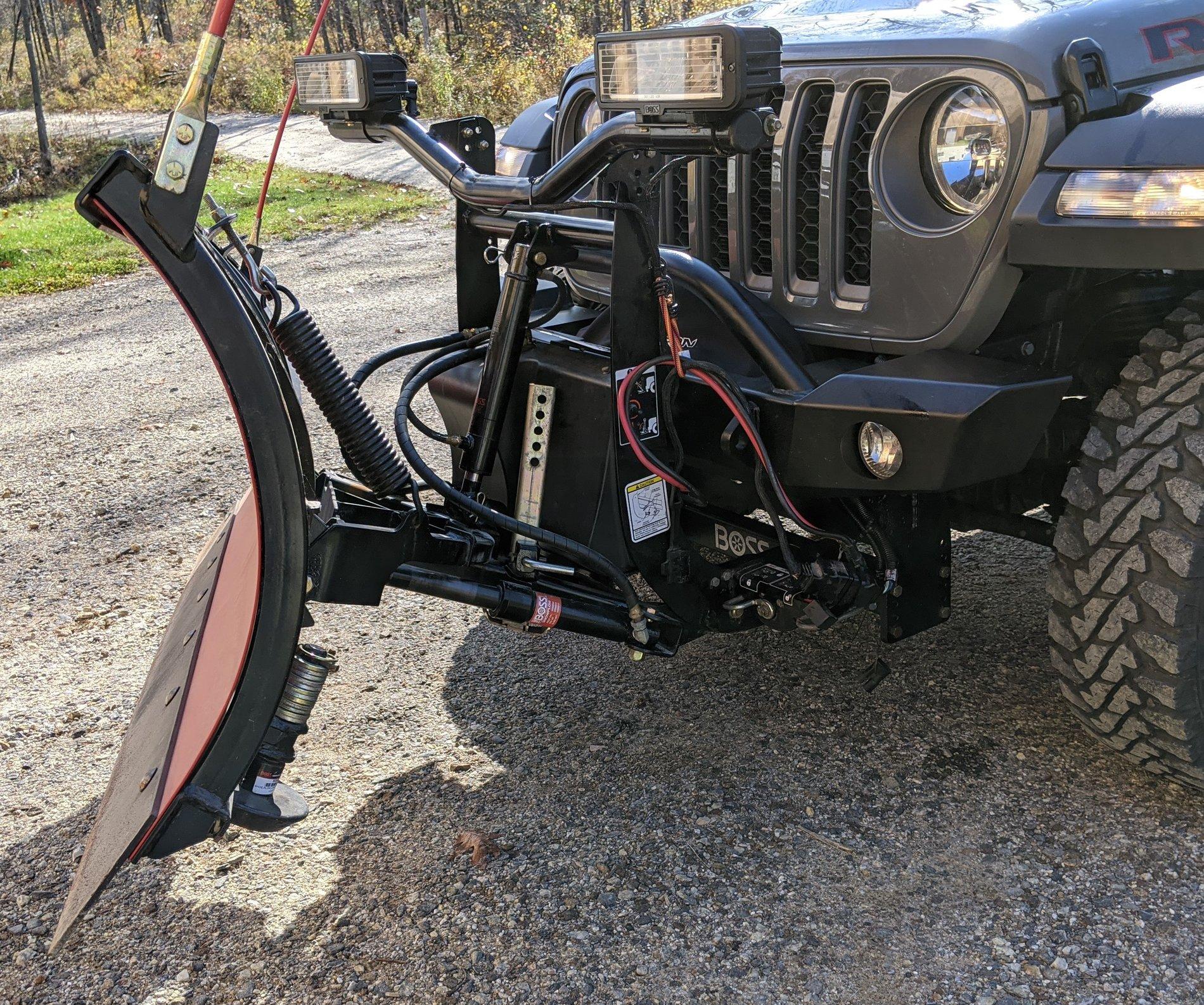

Heya, I just spent most of Sunday working getting a Boss plow wired in, any chance you could shoot me a picture of where your solenoid for the wiring relay is attached? I ended up going to the side of the airbox, but maybe there is a better place.

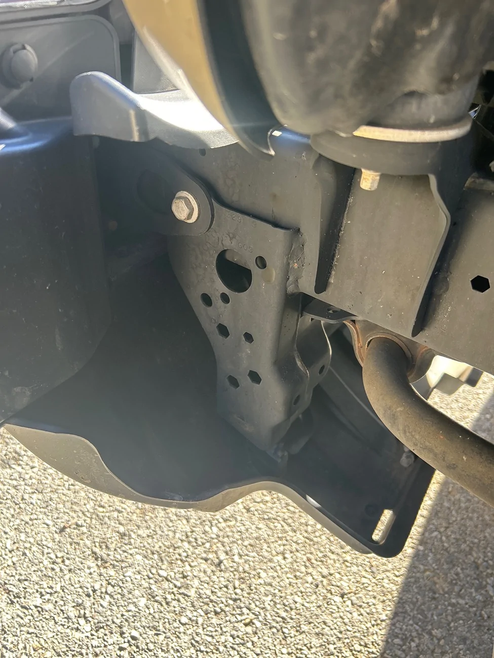

Quick question for you. I know this is an old post, but I’m looking into a snow dog plow for my 2020 gladiator and it’s off of a JK so the Mount plate is slightly different. He came across this post and saw your photos with the same style plow.. Did yours get attached to the piece of the frame that I took a picture of and included or did it go elsewhere on the frame?

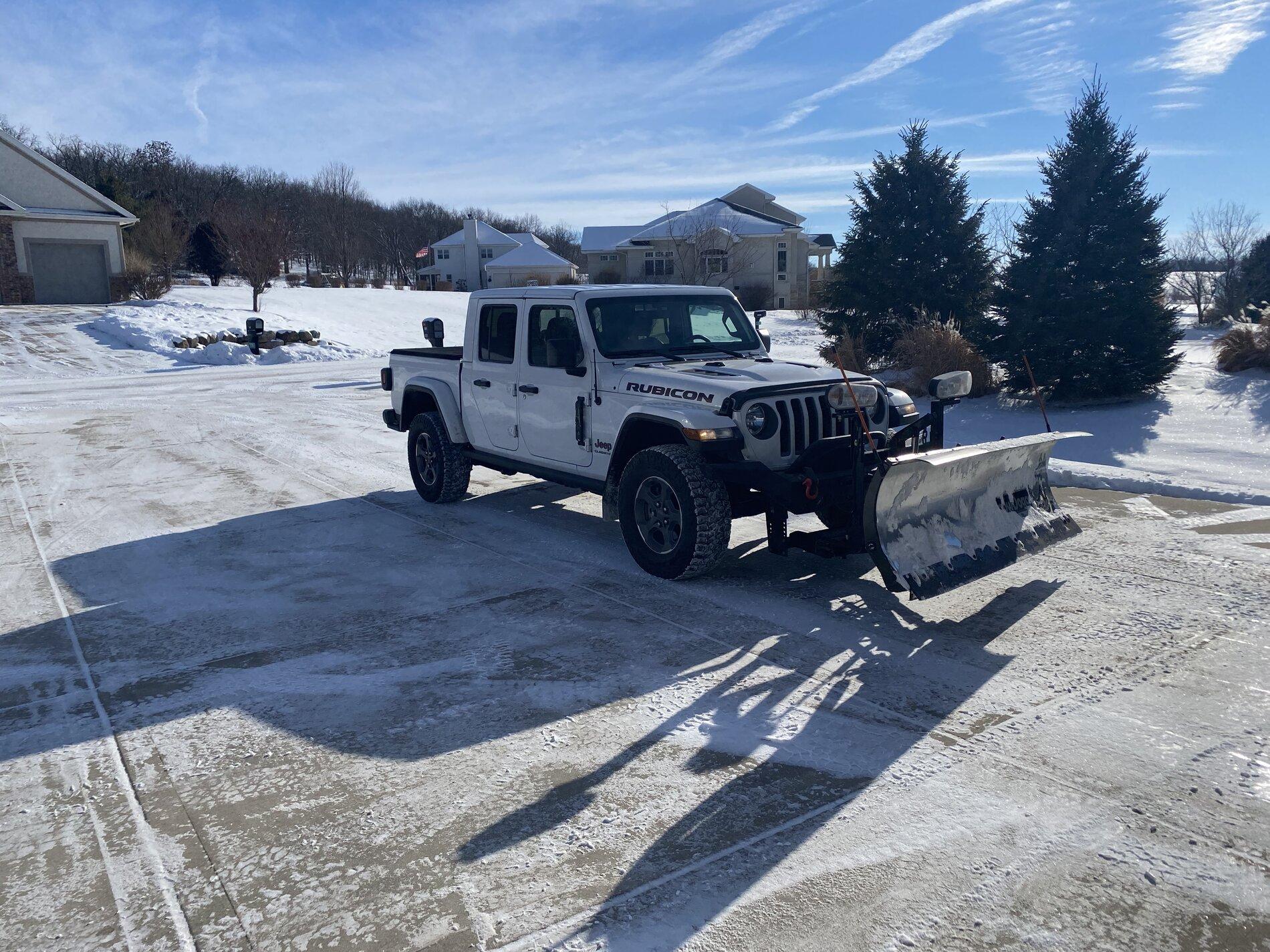

Yes. Skid plate off. That single bolt comes out and reinstalled once plow mount is on. On my mount there are two bumper nuts on each side that are used also. There are two bolts with nuts that are also inserted through the piece you have in the photo also.
kind of confusing but I hope this helps. If you can post a pic of the bracket I might be able to see if it’s the same truck side mount.
Thank you so much! That was very helpful. As soon as I pick it up I’ll post a photo. I think there will have to be some modification as it came off of a JK but there’s not much information online about mounting points for a plow on a Jeep gladiator.

I’ll get a picture of the mounts tomorrow when I get up to my property. By chance do you have any photos of how your plow was wired up onto the gladiator?
