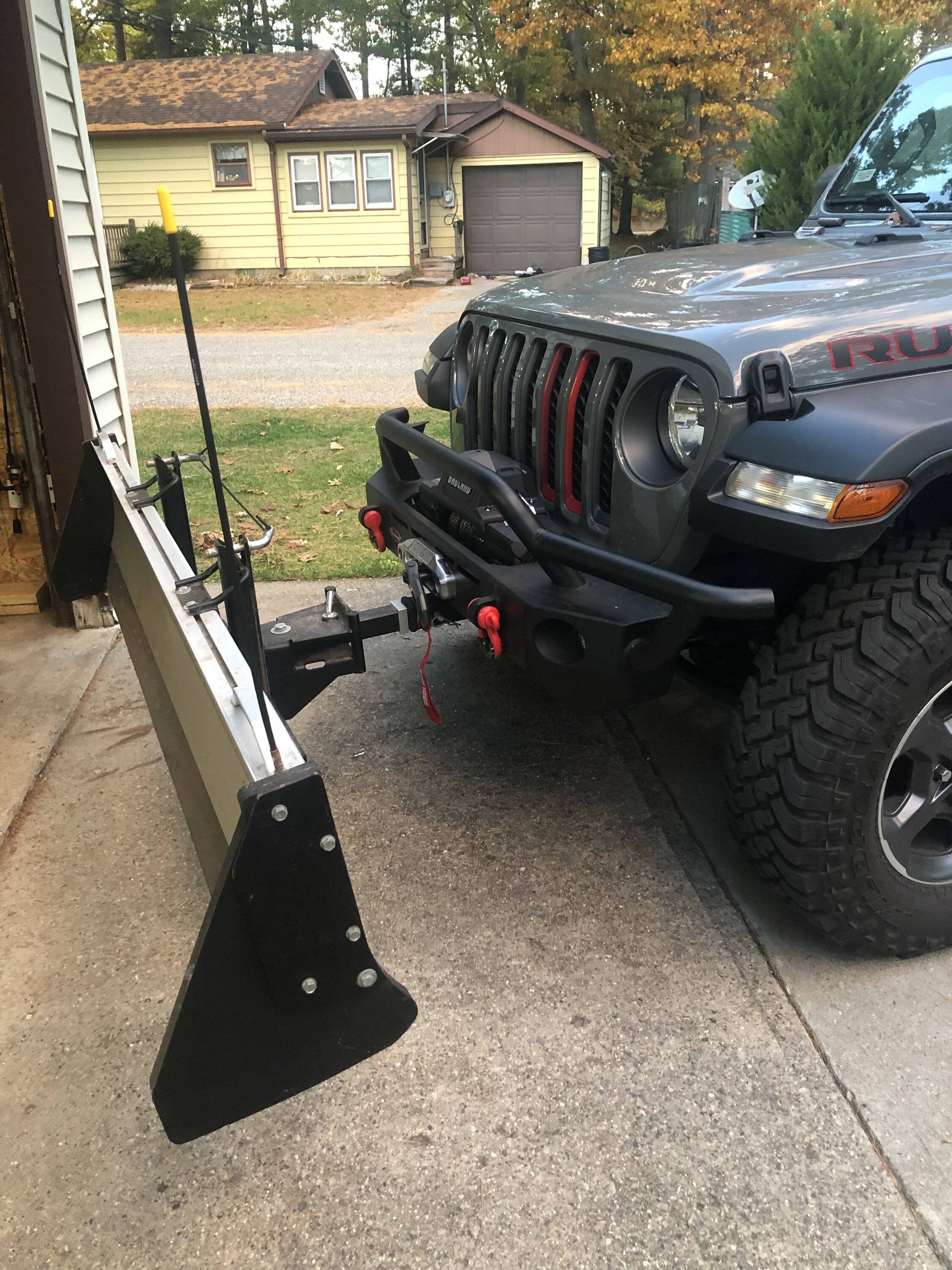

May I assume the brackets/mounting go on the outboard sides of the frame, and not the sides of the frame facing the engine? I have a receiver/hitch that bolts to the faces of the frame that face the engine and not the tires. There's no room to mount anything at all as the receiver and winch plate take more than every hole and every bit of real estate in that area. There's no way to put anything else on the frame there.
Blade/plow width - debating 6'8" vs 7'2" plow............ want to make sure when angled it plows the width of the truck and then a bit, but also want it to be able to fit into my garage and not be over-kill for my use and needs.
What is the purpose of removing the bumper and enlarging the holes in the front end of the frame? Just curious as I don't see where those are used for anything. .And, especially since I have solid steel spacer plates on the front to move the bumper forward 3/16" for clearance with winch. The yellow zinc color in this pic is the spacer plate I gave a nice plating in yellow zinc to prevent rust)
Bumper removal won't be fun with all the stuff I have up there LOL.
Using their measurement to determine mounting bracket needed, I come up with 21.25"
But I have stock diameter tires (a bit wider, but stock diameter) and the weight I have up front keeps the front sitting a bit low even with the Synergy springs.
I have an Overland - BUT - it's more like a Rubicon on the front now.
I have the Rubicon style steel bumper, the Rubicon skid plate that attaches to the bumper, and a Bulldog winch plate, Apex 1200 winch, etc. up front. And - I have a Curt 2" receiver up there so I can't bolt anything at all to the inward faces of the frame! There's no space, no holes left. In fact, I had to cut the lower/rear skid plate brackets to clear the receiver so those brackets are attached to the frame using only 1 bolt each.
Yes, the mount does go on the outside of the frame, and yes, you will need the 7'2" plow. That's where Meyers messed up. Meyers was set to go with the 6'8" plow, but realized that would underplow the width of the tires. Then Meyers was not able to make a 7'2" plow that would pass a crash test, per my Meyers dealer. The 7'2" plow is wide and long, i cannot close my garage door when the plow is attached.
The plow brackets bolt on the outer parts of the frame takes care of one of my concerns about mounting one with the stuff I already have on the front (especially the receiver)
I hope the receiver doesn't cause a clearance problem otherwise.
It hangs proud of the bottom of the steel bumper.
I measured and decided that the 6'8" wouldn't work well for any JT, especially anything with wider tires, or, the Rubicon, Mojave or Max tow with the extra 1.5" width. Yeah, that one must have been an "oops" on their part.
Even with the blade straight, not angled, I'd not have a width issue with my garage. I would have to be more watchful, but I should be anyway........
The door on the side where I park my truck is wider than where my wife parks hers in our garage (2 doors, not one wide door).
Depth isn't an issue, but I will have trouble getting the lawn tractor out past the truck with a snow blade on. I park my truck back far enough I can carefully run the lawn tractor out between vehicles and around in front of my truck and then out. I could run my truck back farther, closer to the front of my SX4 since I won't be working on it in the winter. The garage is 27' deep not counting the addition on the back. In the summer I'd need to find a spot to park the blade but that shouldn't be an issue either - I'll level a spot and get a load of gravel down for it to rest on.

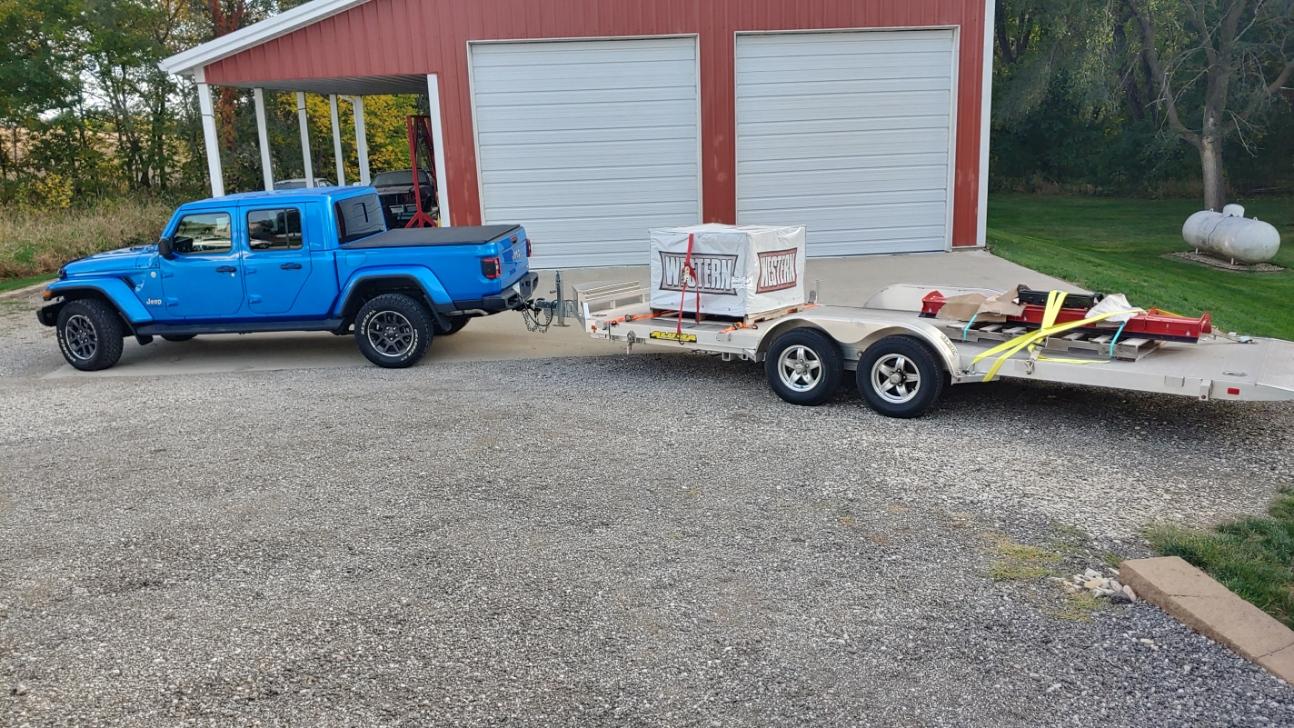

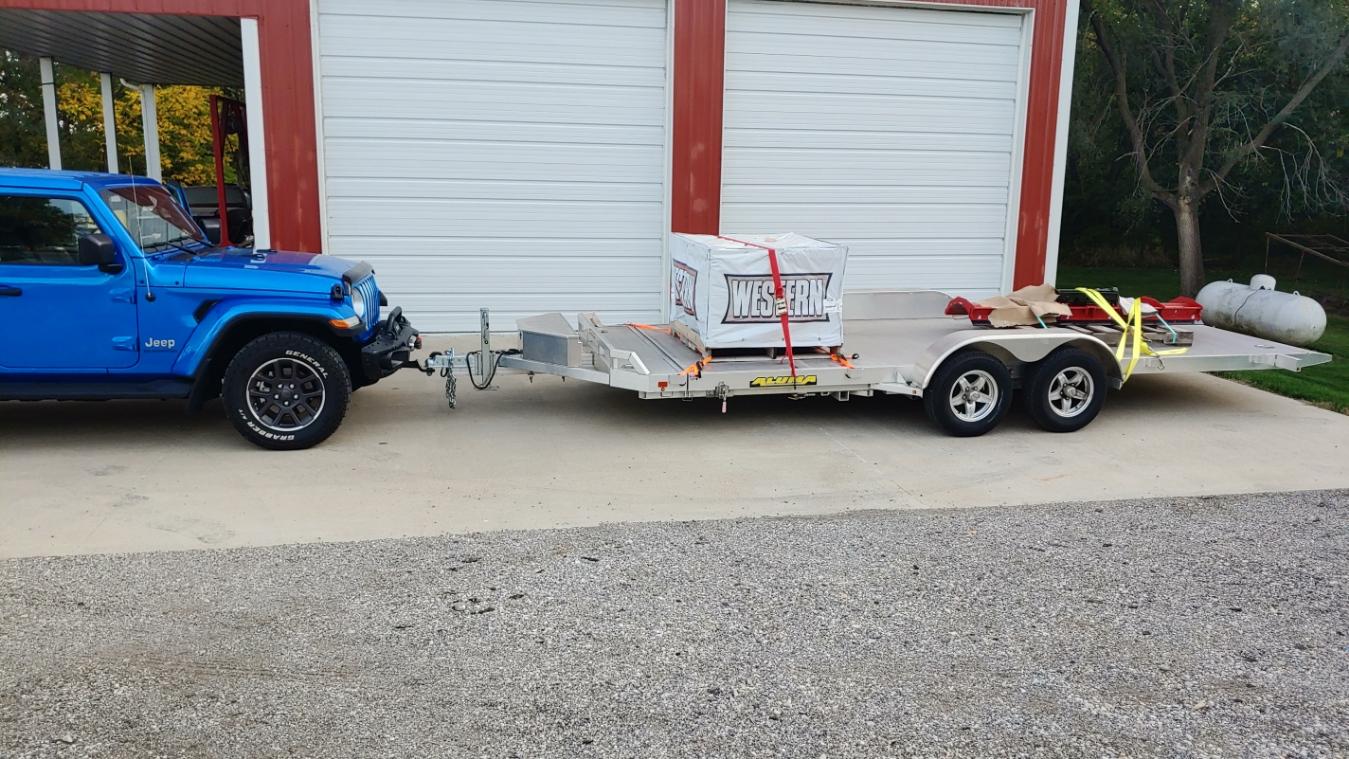

Then I switched things around and lined the trailer up in front of my shop, drove a stake in the ground and strapped the pallet under the blade to the stake and pulled the trailer back. It's a tilt bed so it tilted and the blade/pallet slid right off.
I moved the other pallet/crate back and did the same.
Man, I love the front receiver!

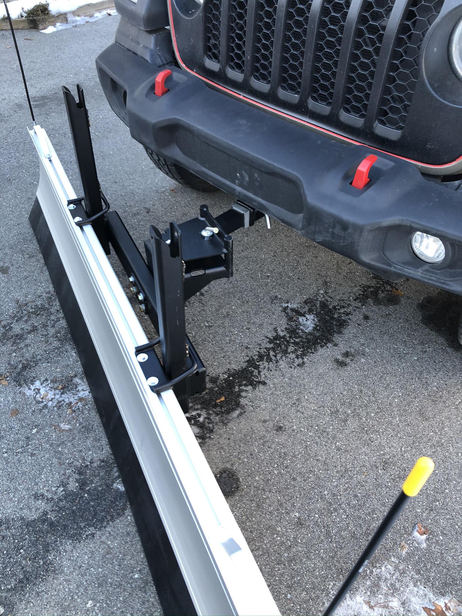

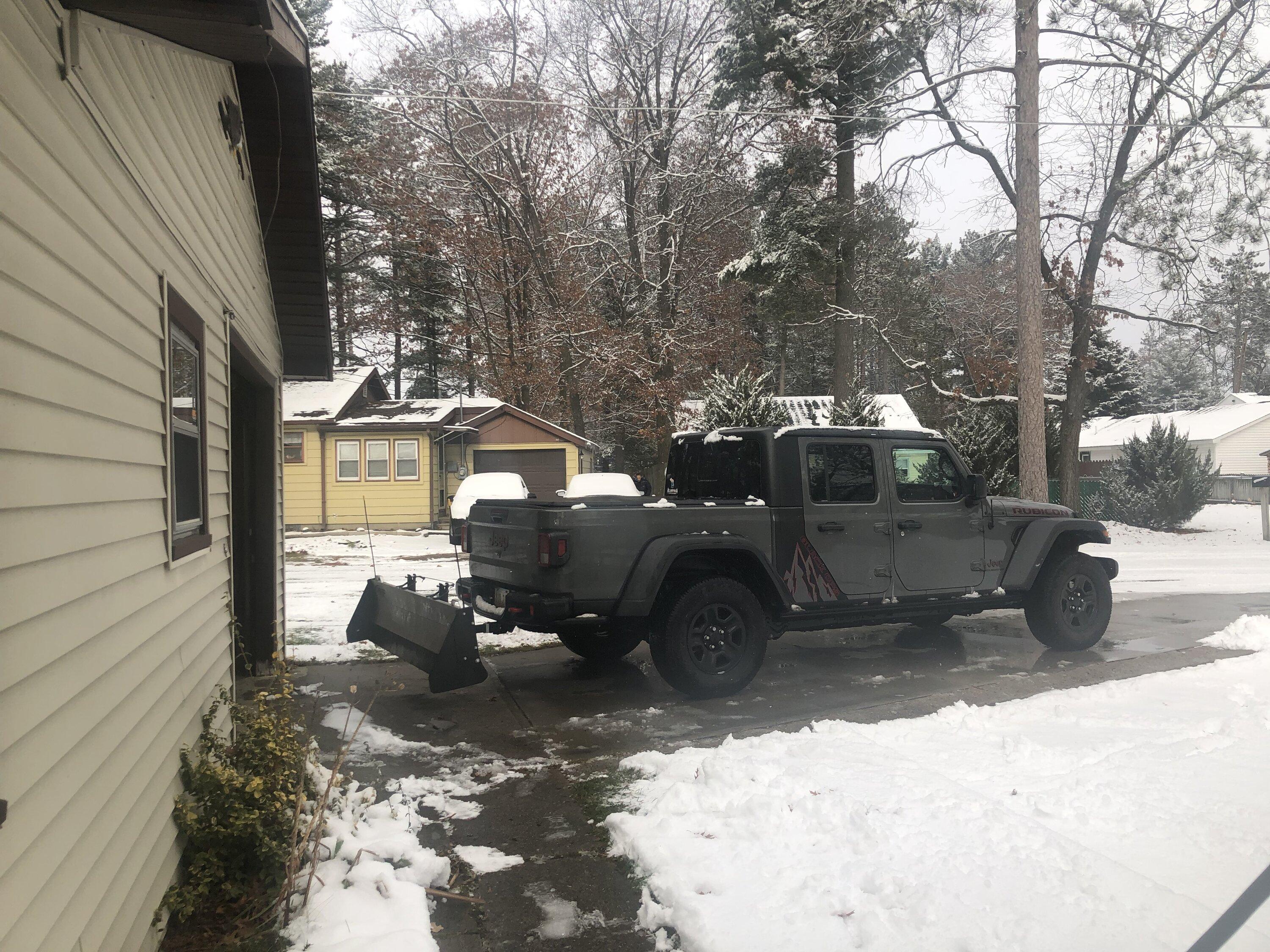

@ShadowsPapa is correct in his info. I have the receiver type and do not travel with it but short distance. You can always use the rear receiver as well. Mirrors and camera make it easy using it on the back. Mine is called a SnowSport weighs in at about 110# and $1800.

Thank you for the response! 110# is less than half the weight of the one I was looking at.. I see it has a rubber cutting edge so it won’t scratch our pavers too (so I won’t need the wheels on the bottom of the blade). This one looks like a no brainer for my situation.. Thanks again!

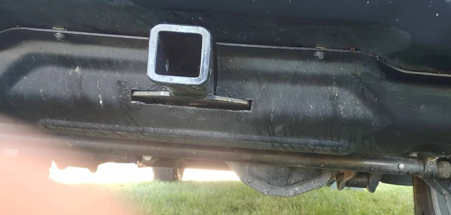

I have pictures....but you need to use angle grinder, Dremel, saw, files, or whatever and cut out the skid plate to fit around receiver.
It's tricky because you need to compensate for the slope or angle the skid plate sits at in relation to the receiver

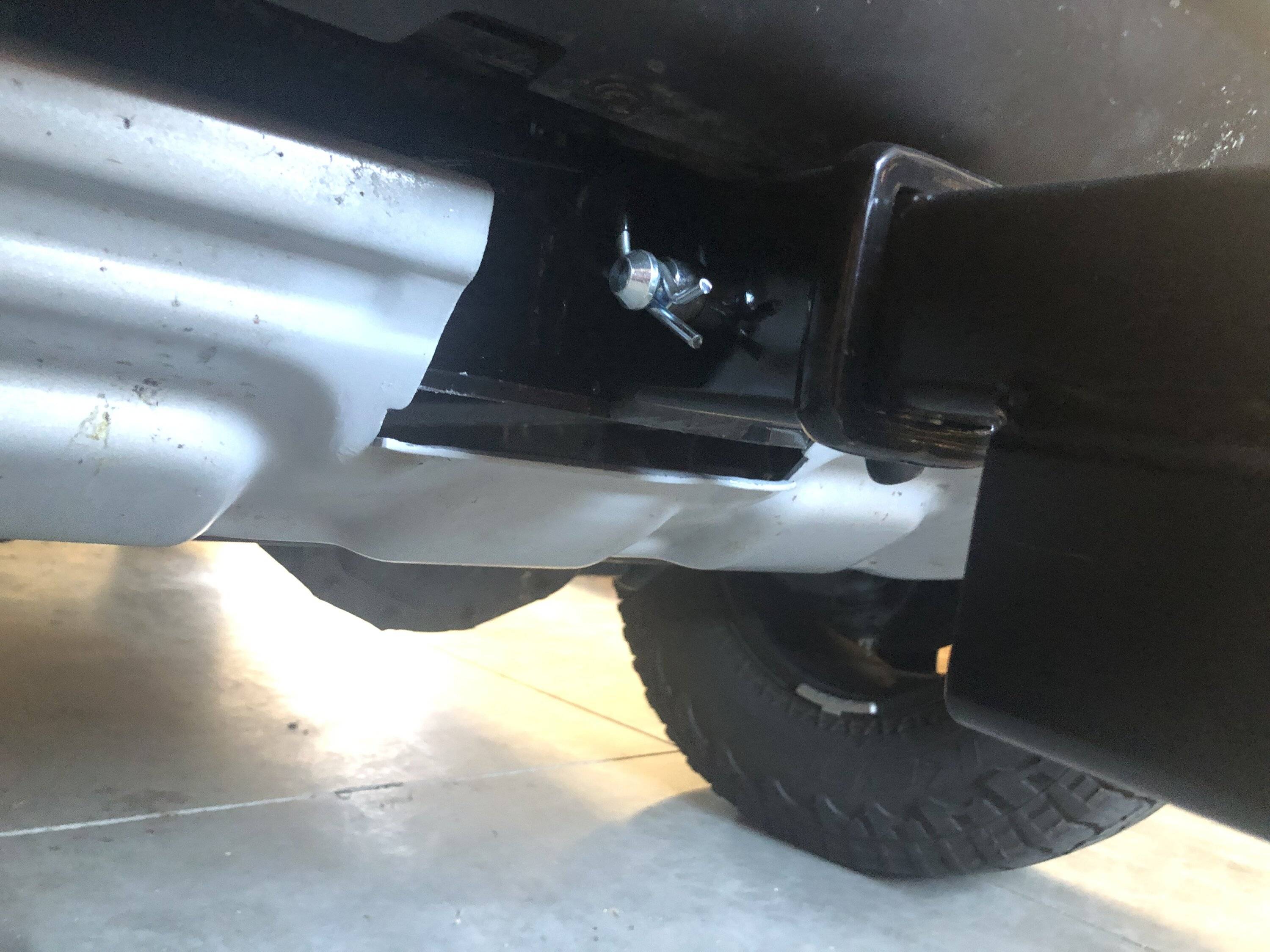

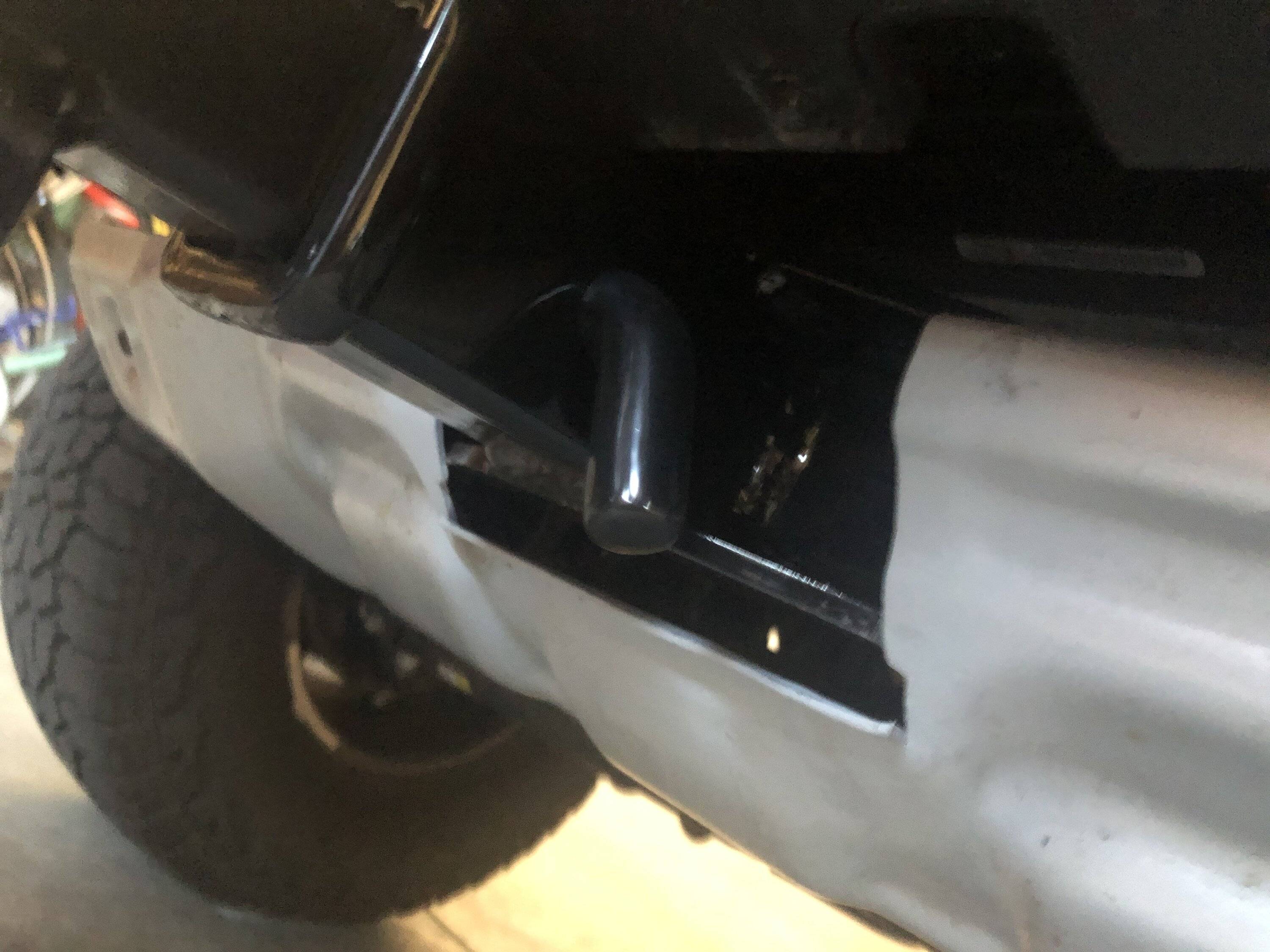

I had a custom 4x4 fabricator install my front receiver hitch on my Mojave. I was going to do it but with the shock reservoirs mounted right on the backside of the skid plate, I didn’t want to screw anything up. He was able to not only cut the hole perfectly, but he modified/reinforced the Curt receiver mounts so they were stronger than stock and modified it in a way that he didn’t have to relocate the reservoirs. Well worth the $400 I paid him! Only problem is the Mojave sits too high and I had to use a drop down receiver adapter.
