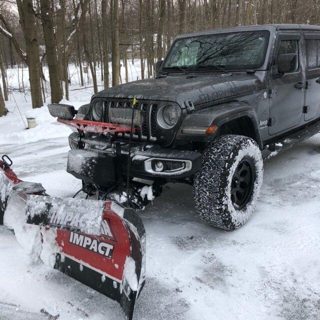

Plowed with mine all last season. Love it!!! Mine is a Western Impact V. There is only one dealership that does this setup called Storks Plows in eastern PA. It is actually a UTV plow, so a little lighter. They shipped the whole kit to me. Plow install was pretty easy and straightforward, but the electrical was a bit more involved. The biggest problem is how tight everything is in the engine area. Really not a lot of room to stick all the wiring (and there is a lot!!).
I do feel the V plow is a bit weaker when really pushing the snow up and over the snowpiles you've made previously. For example: when the blade is set flat, but angled to one side, if you are pushing the snow, the wing that is pointed out further will give, and fold back. Not a huge deal, but does add some time to plowing. But, the V is way more aerodynamic when on the freeway! I can honestly say that I don't see a drop in my mileage with the plow. I drive about 45 minutes to Cleveland to my shop every day. A worthwhile tradeoff to the above-mentioned plowing weakness, I think.
I live in Ohio's snowbelt where we get around 80-140" of snow, and use it to plow my 90' curvy driveway (and sometimes a neighbor or two), then plow my 10 car work parking lot.
I had a straight blade Snow Dogg on my previous JKU, and think it was stronger in the above-mentioned situation. I would be curious to try out a standard straight blade Western plow on my Gladdy to see how it holds up. But for now, I really like the V.
Plus, it just looks cool! I get compliments from the "real" plowing guys all the time.

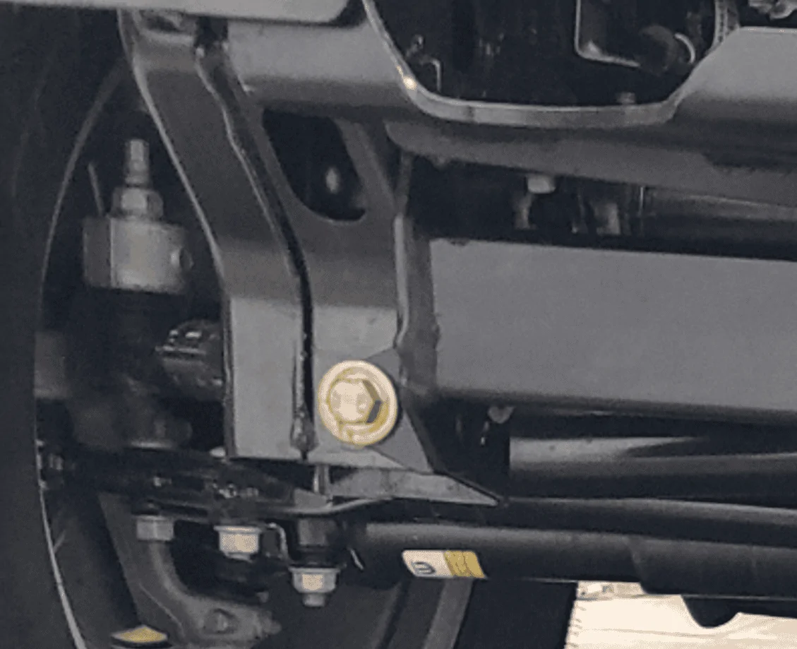

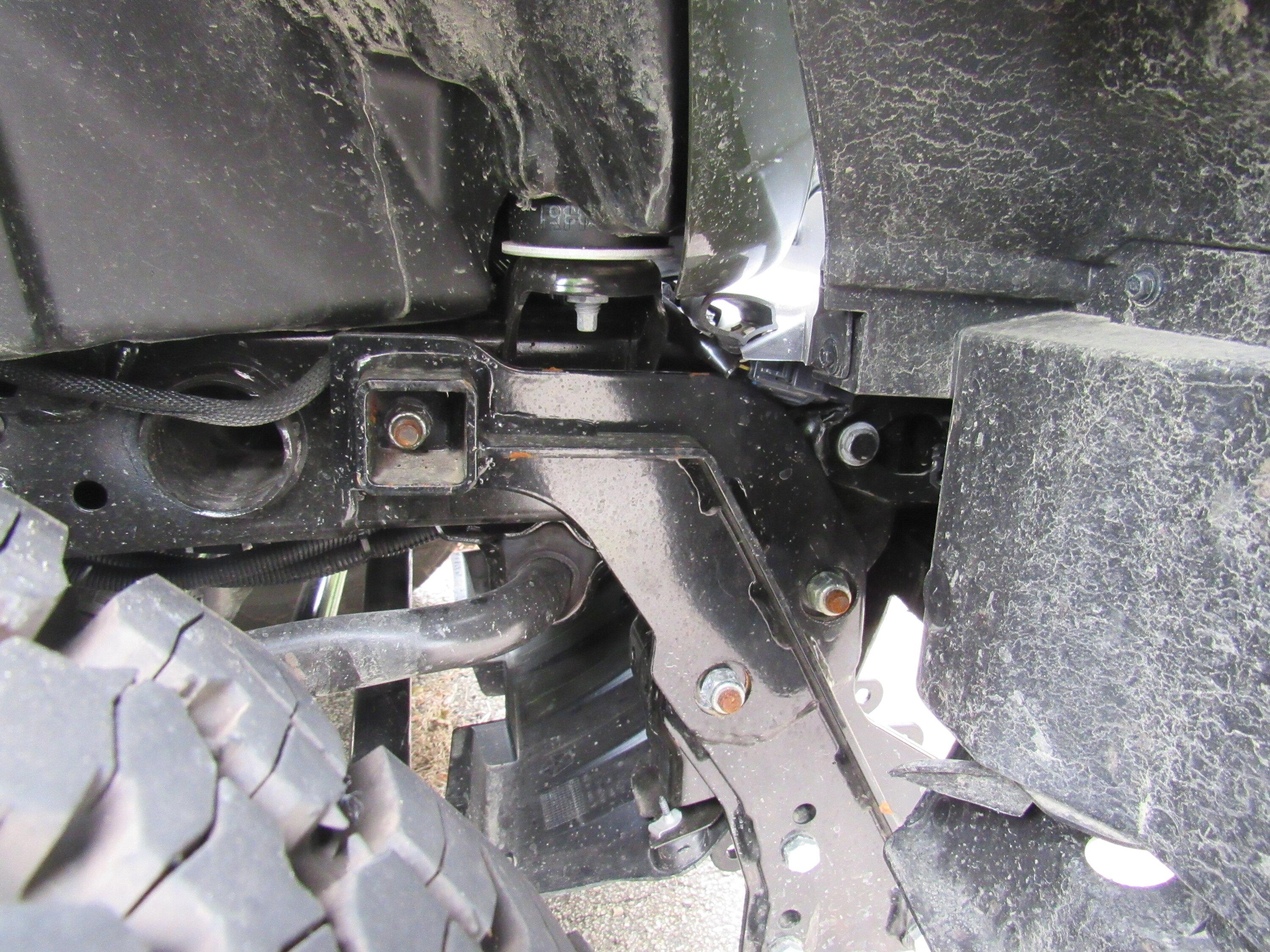

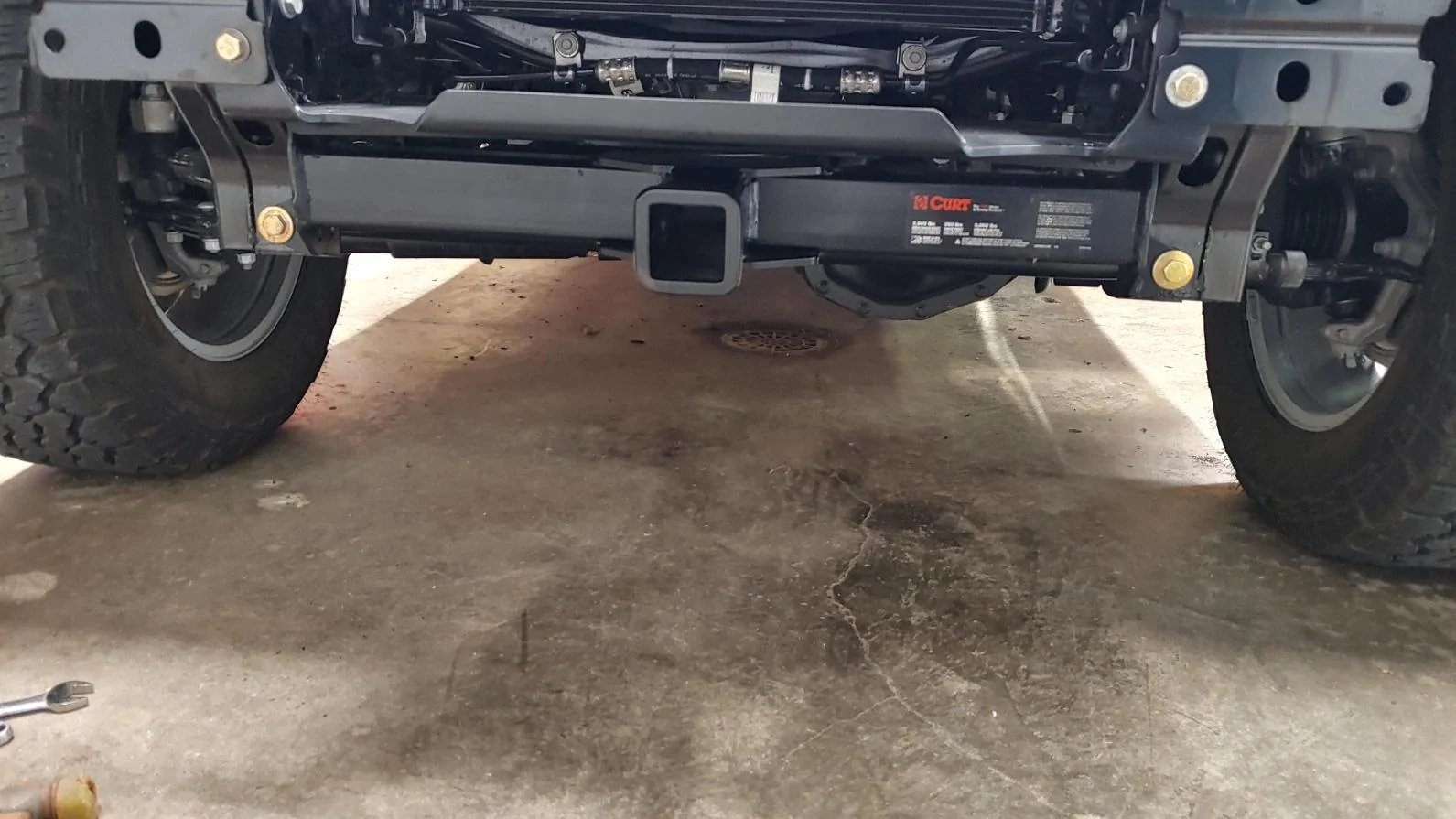

I have the 7'2" Defender and this is the passenger's side view. 3 bolts attach to the frame. They had to drill into the frame, but i do not know for which bolts. The mount is cut around the bolt in the upper right. It is different from my older plow, but i am happy with it. With the receivers removed, the front end drops only 3/16"
They did cut the wind dam on each side and removed the center piece of the grill to make room for the wires. I could always cut holes in the grill for the wires and reattach the center grill
Wow, thanks for the great picture.
Multiple questions -
May I assume the brackets/mounting go on the outboard sides of the frame, and not the sides of the frame facing the engine? I have a receiver/hitch that bolts to the faces of the frame that face the engine and not the tires. There's no room to mount anything at all as the receiver and winch plate take more than every hole and every bit of real estate in that area. There's no way to put anything else on the frame there.
Blade/plow width - debating 6'8" vs 7'2" plow............ want to make sure when angled it plows the width of the truck and then a bit, but also want it to be able to fit into my garage and not be over-kill for my use and needs.

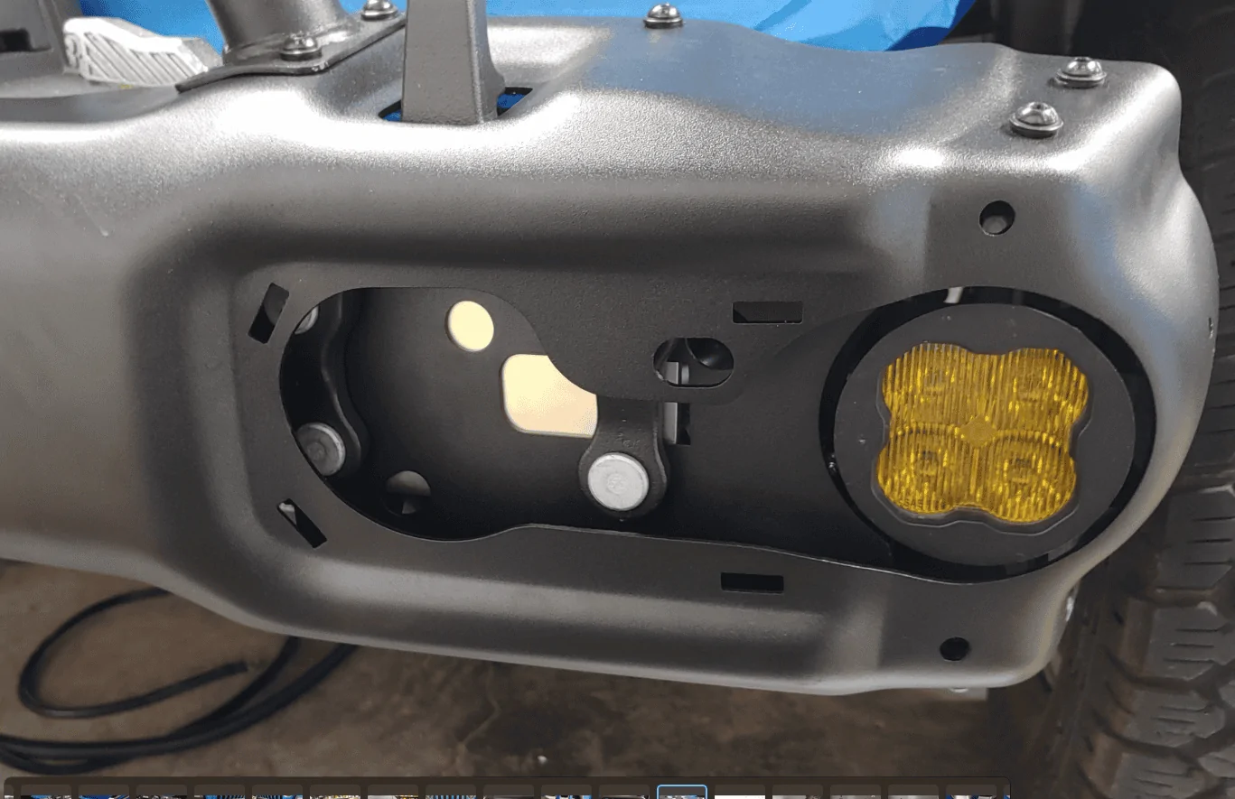

What is the purpose of removing the bumper and enlarging the holes in the front end of the frame? Just curious as I don't see where those are used for anything. .And, especially since I have solid steel spacer plates on the front to move the bumper forward 3/16" for clearance with winch. The yellow zinc color in this pic is the spacer plate I gave a nice plating in yellow zinc to prevent rust)
Bumper removal won't be fun with all the stuff I have up there LOL.

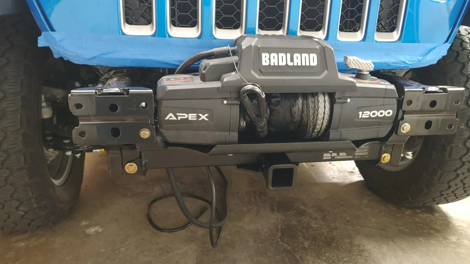

I've got an Overland with a 2" Mopar lift, Teraflex 3/4" spacers and 35" tires. My height measurement was way more than the required 10 1/4", so I also had to add their lowering brackets to the receiver points where the plow fits in.
The installation is pretty easy, and took me about 2 hours to do working at a slow pace. The front bumper does need to be removed, and the underside plastic air dam has to be removed and trimmed.
Using their measurement to determine mounting bracket needed, I come up with 21.25"
But I have stock diameter tires (a bit wider, but stock diameter) and the weight I have up front keeps the front sitting a bit low even with the Synergy springs.

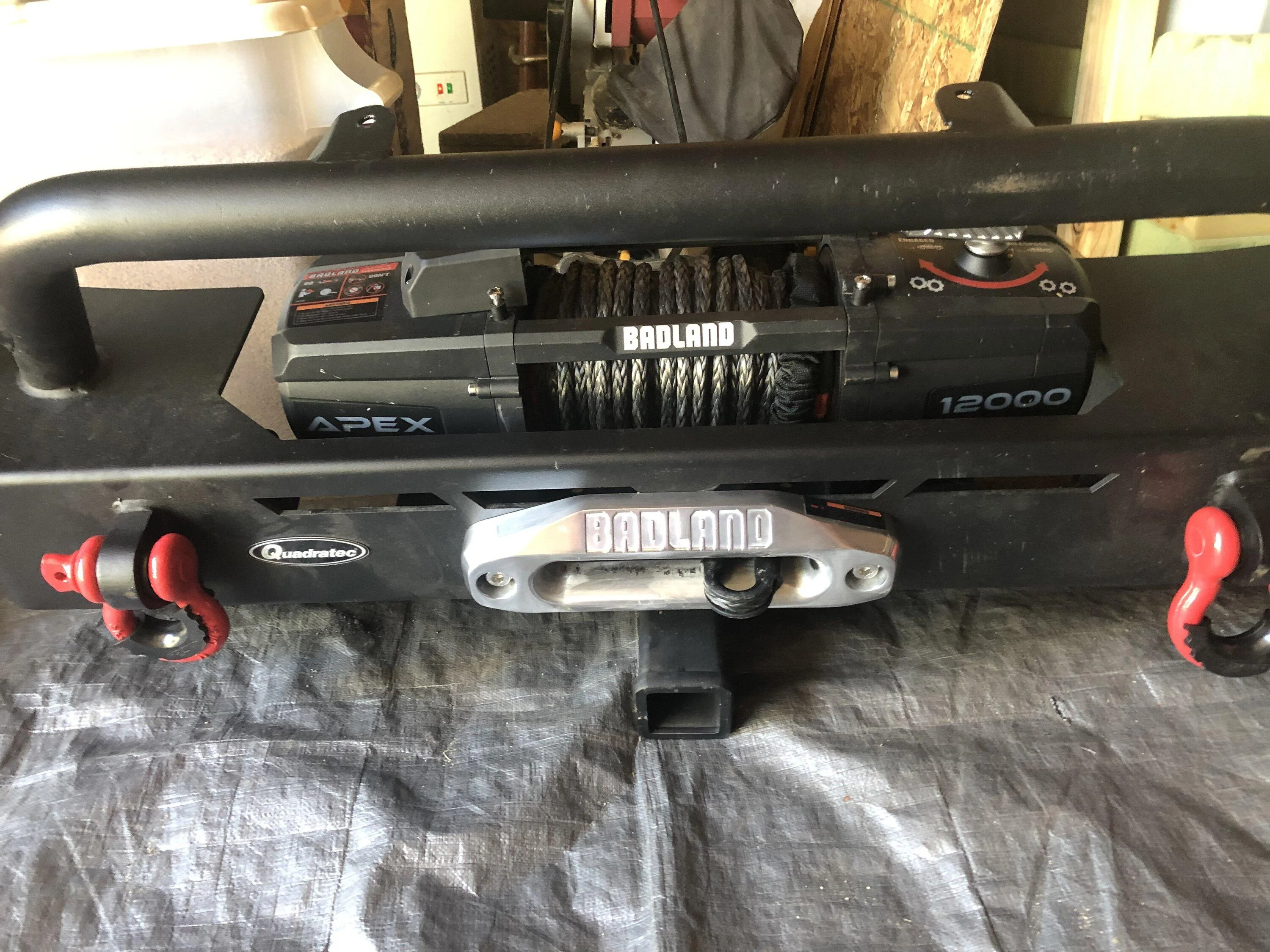

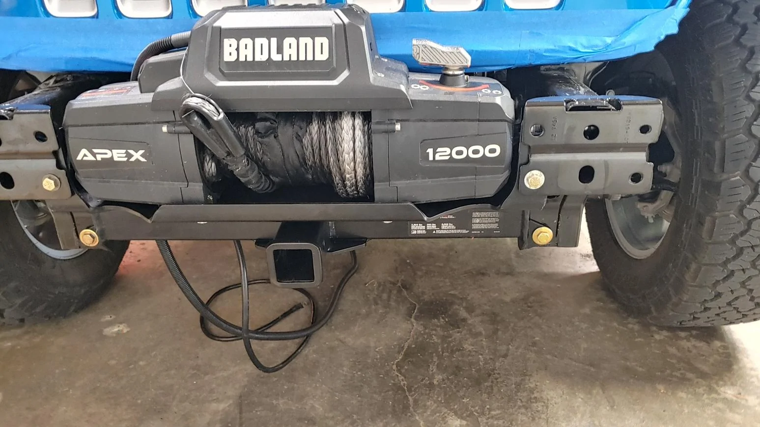

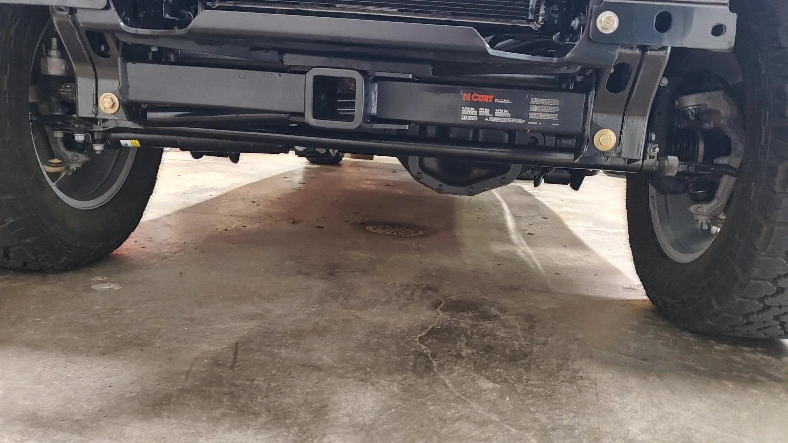

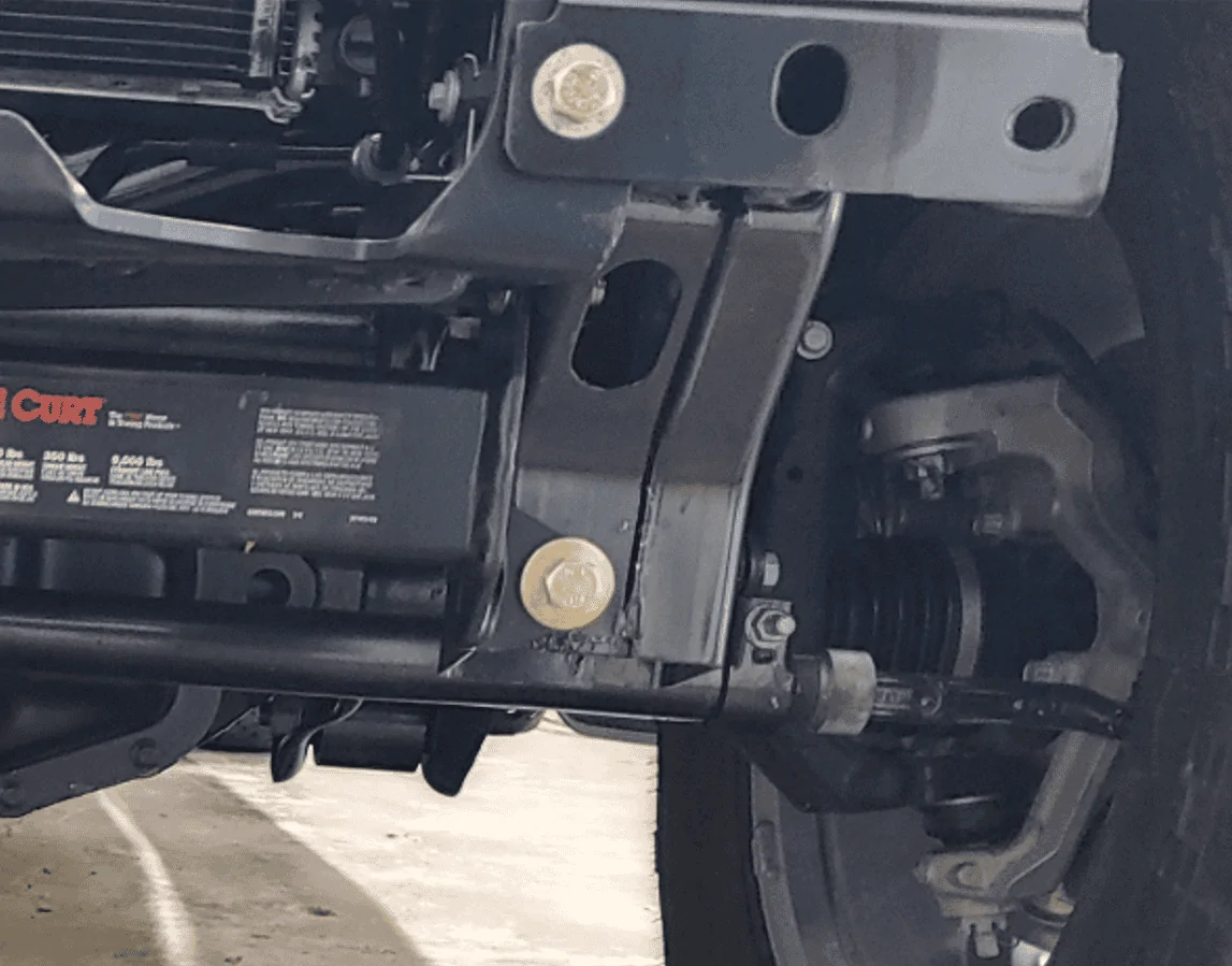

I have an Overland - BUT - it's more like a Rubicon on the front now.
I have the Rubicon style steel bumper, the Rubicon skid plate that attaches to the bumper, and a Bulldog winch plate, Apex 1200 winch, etc. up front. And - I have a Curt 2" receiver up there so I can't bolt anything at all to the inward faces of the frame! There's no space, no holes left. In fact, I had to cut the lower/rear skid plate brackets to clear the receiver so those brackets are attached to the frame using only 1 bolt each.
Enlarging the holes in the front bumper plates is to allow for the nuts with welded on arms to slide through. You fish those in (~12" or so) and the welded on arms stick out through the hole. Give you something to hold onto while you tighten the bolt through the bracket from the outside. Once done, you use a cutoff wheel and trim the couple inches sticking out so its flush. The hole in the side is just to allow for a bigger bolt.
248
40,497
54,066
Yeah, I finally read the install instructions on a real PC with a real screen and saw where they used the larger hole in the front to fish in the rear-most bolt for their brackets. And they used the bracket hole as a "template" to make the side slot larger for said bolt.
Did some measuring and I can't see a 6'8" blade working well esp when angled. So I'm looking at 7'2"
Looks like their brackets bolt on the wheel side of the frame - should be no interference with the receiver or winch plate
