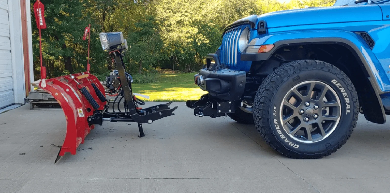

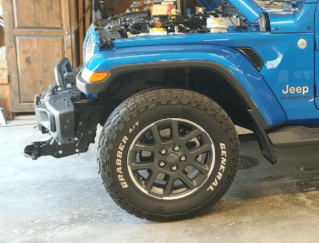

Well I have had both 1st was a gas rubi now I have the exact same only eco diesel I will tell you the gas did better holding the plow up, the eco is pretty much on the bump stops all the time, springs are to weak for sure, hit any bump or Train tracks it hits hard, as for heating issues Non existent , I am in Ontario CANADA it’s cold, eco diesels will bottom out new with nothing on the front they need different springs, I am putting on my Aev spacer kit so will see if it helps at all, mine is a snow dog plow for the gladiator or reg jl steering and all are fine , I installed this plow in both jeeps the first gas last winter and the eco this fall
MDII ?
Curious - how much does your Snowdogg weigh?
I've had mine on for a week now and have driven it 4 different times with plow on - highways, city streets, tracks, gravel road, etc. and no problem at all. It sits a bit lower than I'd like but the springs do seem to be holding it up well enough. I've not hit HARD bumps or pavement dips with any speed and the tracks here are pretty mild in any case.
Still, not any issues driving it around.
I was really afraid I'd need to drop it off it I wanted to go anywhere - no.
Will take it off later this week since we're supposed to hit 40 and lose most if not all of the snow we have (only about 3 to 4" tops) so no need to leave it on.

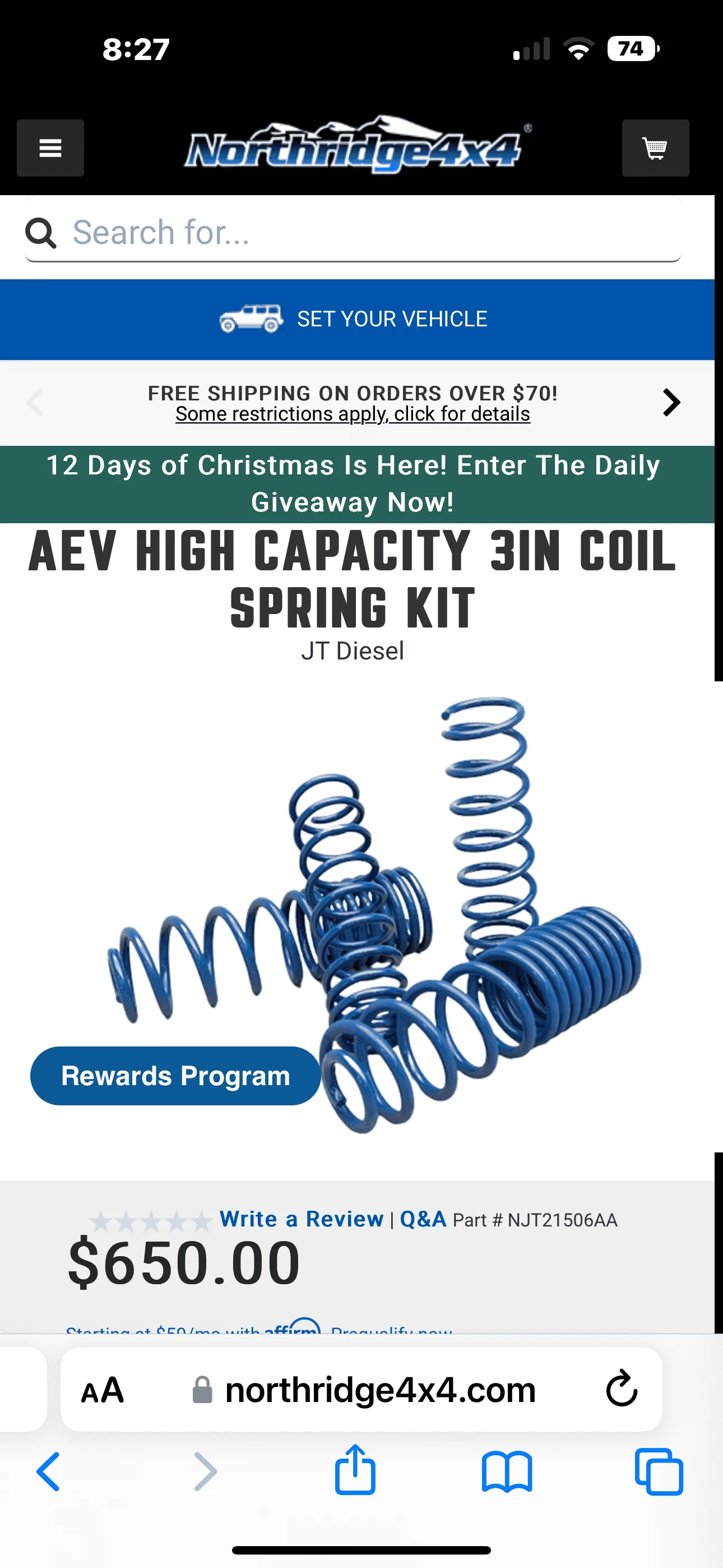

Yes md 2 I am not sure if the weight I took the Jeep yesterday to my camp to plow the road out , every dip or bump it hit the bump stops, very rare that happened with the gas rubicon, I am now looking at a set of Aev high capacity 3 inch coils

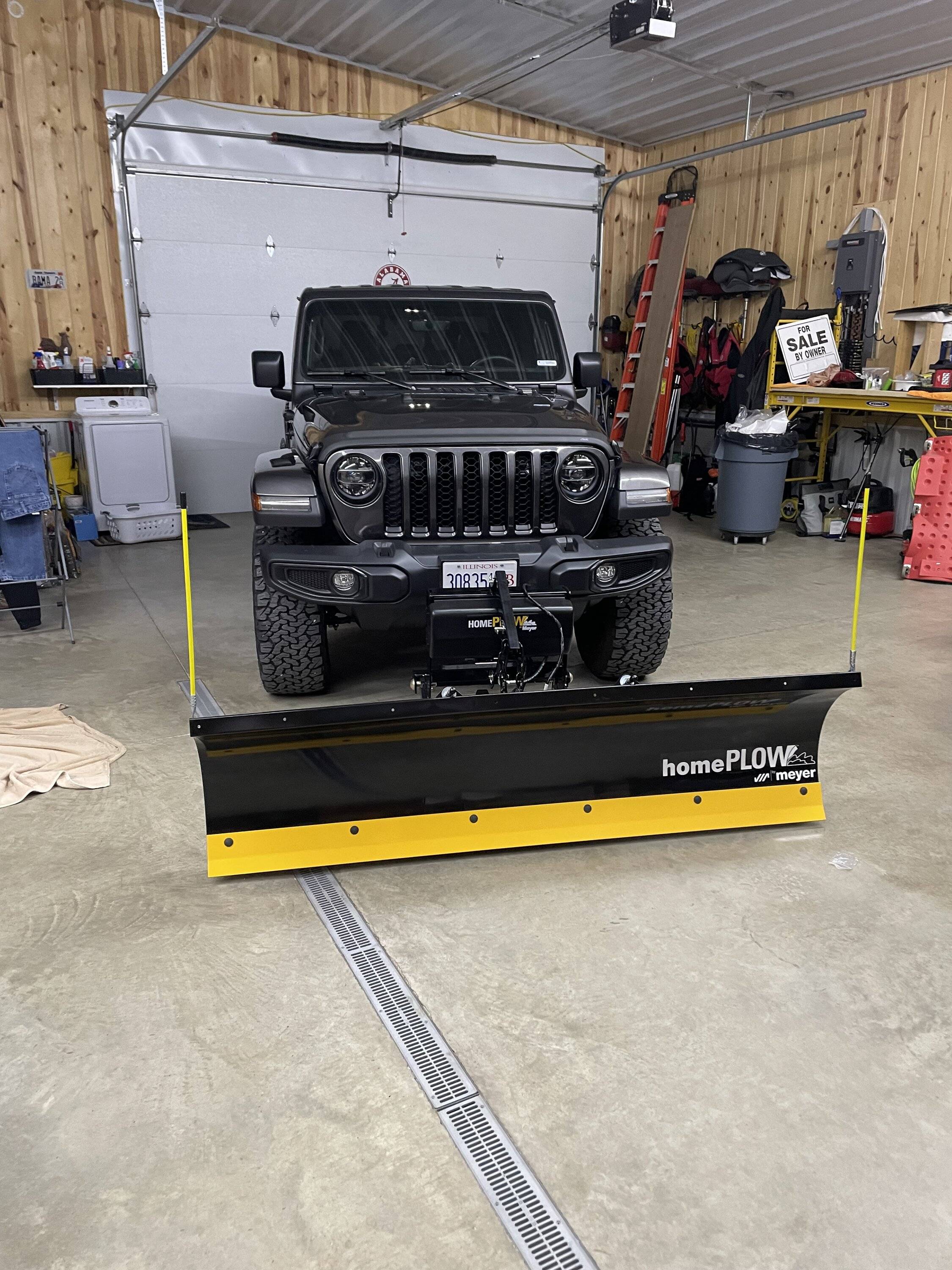

I ended up buying a Myer Home plow that uses a front mount hitch. Install was super simple. It does sag the front of the truck down but I'm only using this to plow our drive and the in-laws drive (a block away). It literally takes about a minute to put it on and take it off and I have no plans on driving at any speed with it on the truck.

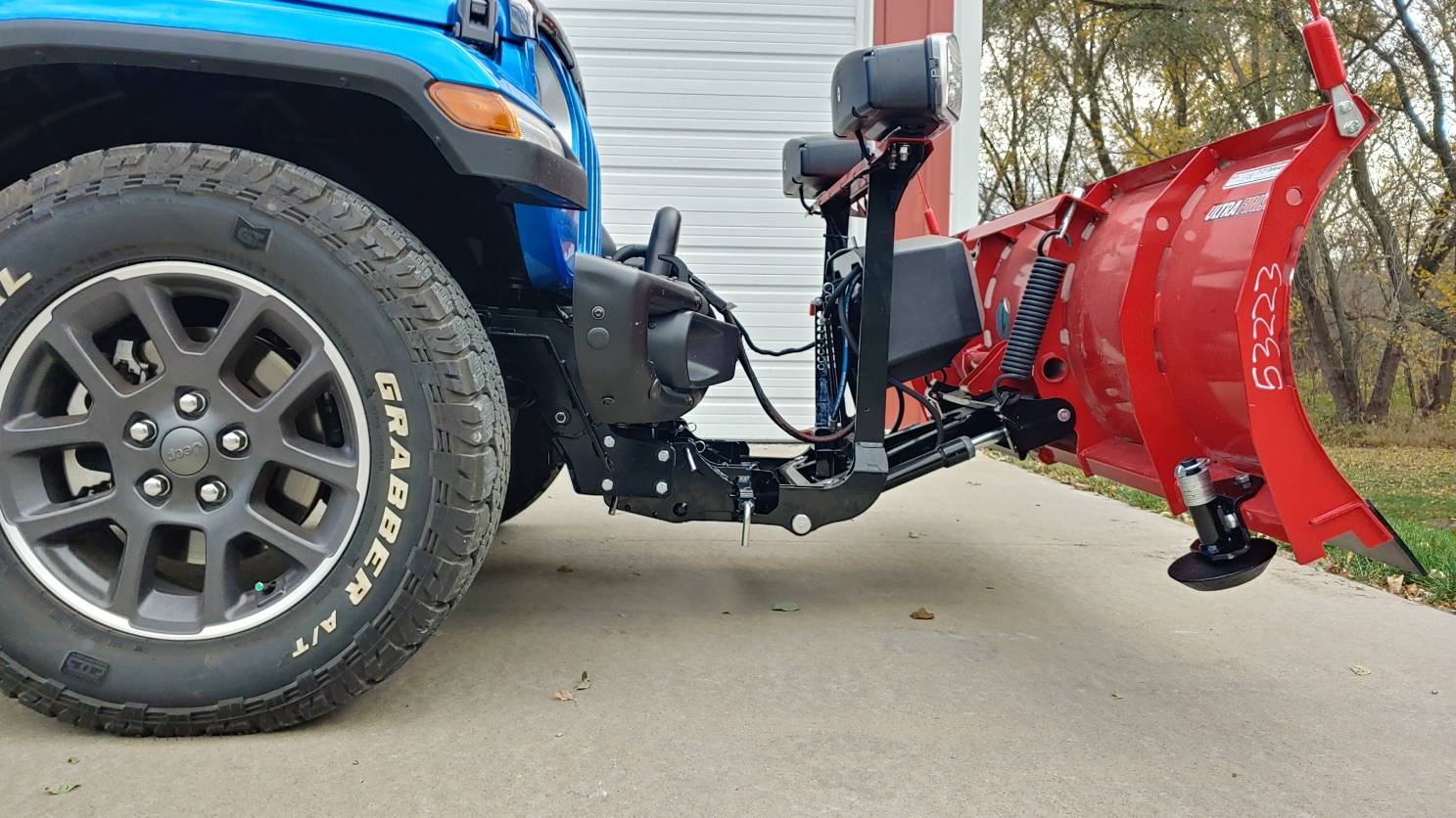

Most of our smaller plows (1.5 ton trucks and smaller) are Western UltraMount2 setups. It literally takes a minute to install or remove the plow. So those usually come off if there is no snow in the forecast for a week or more. The older Fisher minute mounts are more like 20 minute mounts, so those stay on all season. Same with the plows on the big trucks.

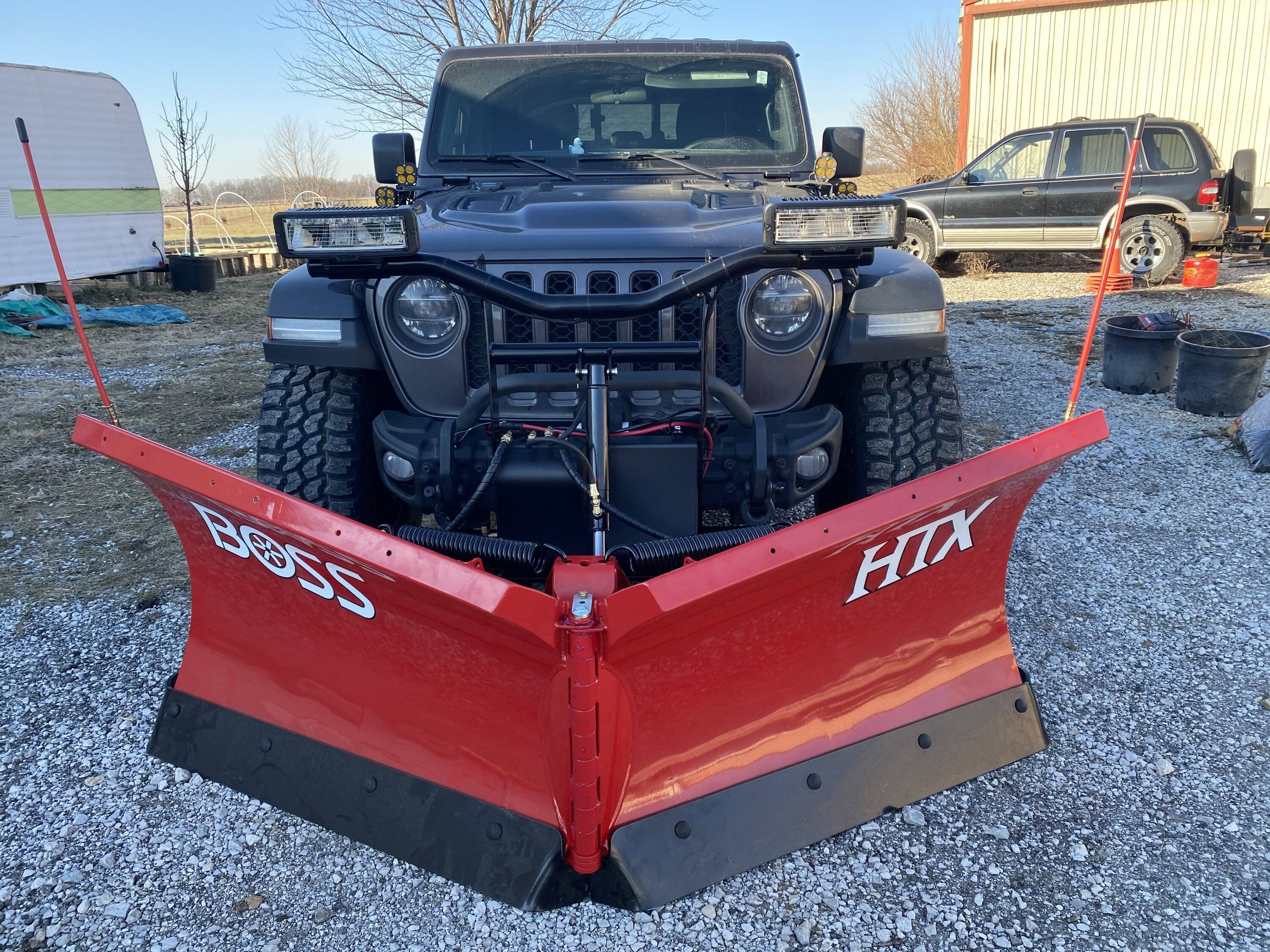

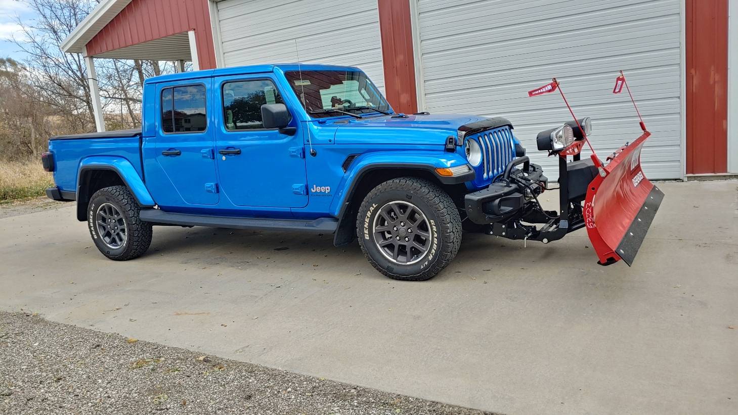

Looks like you already chose one but I’ll throw this out there. I have a 21 diesel with Rustys 4ā€ lift 37s and am running a Boss HTX vplow. I have plowed 2 seasons with this and couldn’t be happier. Last year was 35s no lift and with the new springs from Rusty it carries the plow no problem and very little sag. I pull the mount at end of each season.

Good looking plow that’s what I wanted but dealer here said to heavy for mine
