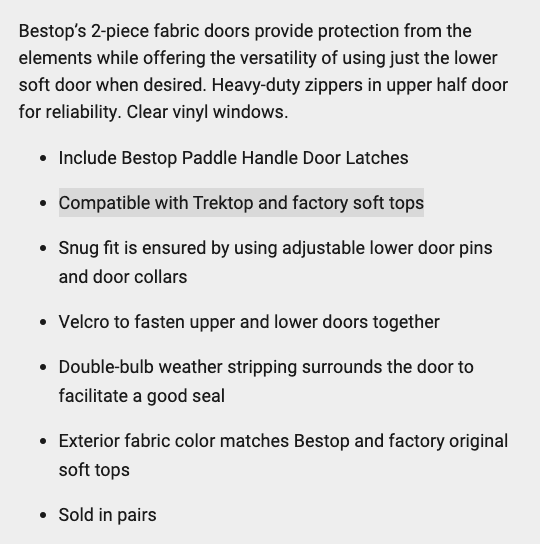

Thank you, I see that now. I'll look into making it more clear.See screenshot below (highlighted section). Specifically calls out factory soft tops, but no mention of hard tops. I had the same question. Same technical specs for front and rear doors.

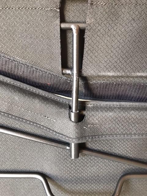

The front passenger side door and window do not line up correctly. I can't get the middle pin on the window to slide down into the hole on the door. The pin on the window will go down into the hole on the door about an inch and then the pin is wedged in the hole. The pin seems to be going one direction while the hole seems to be going a different direction The first pin and the last pin on the window line up correctly with the holes on the door.@GregW68 Do you mind elaborating for us what your issue is?
Hey Greg,Hey Lee @Bestop,
Received my doors almost a month ago. There is a problem with one of the doors. I opened a ticket with customer service but no response yet. PM me if you'd like the ticket number to see if you can help with a resolution.
Thanks,
greg
