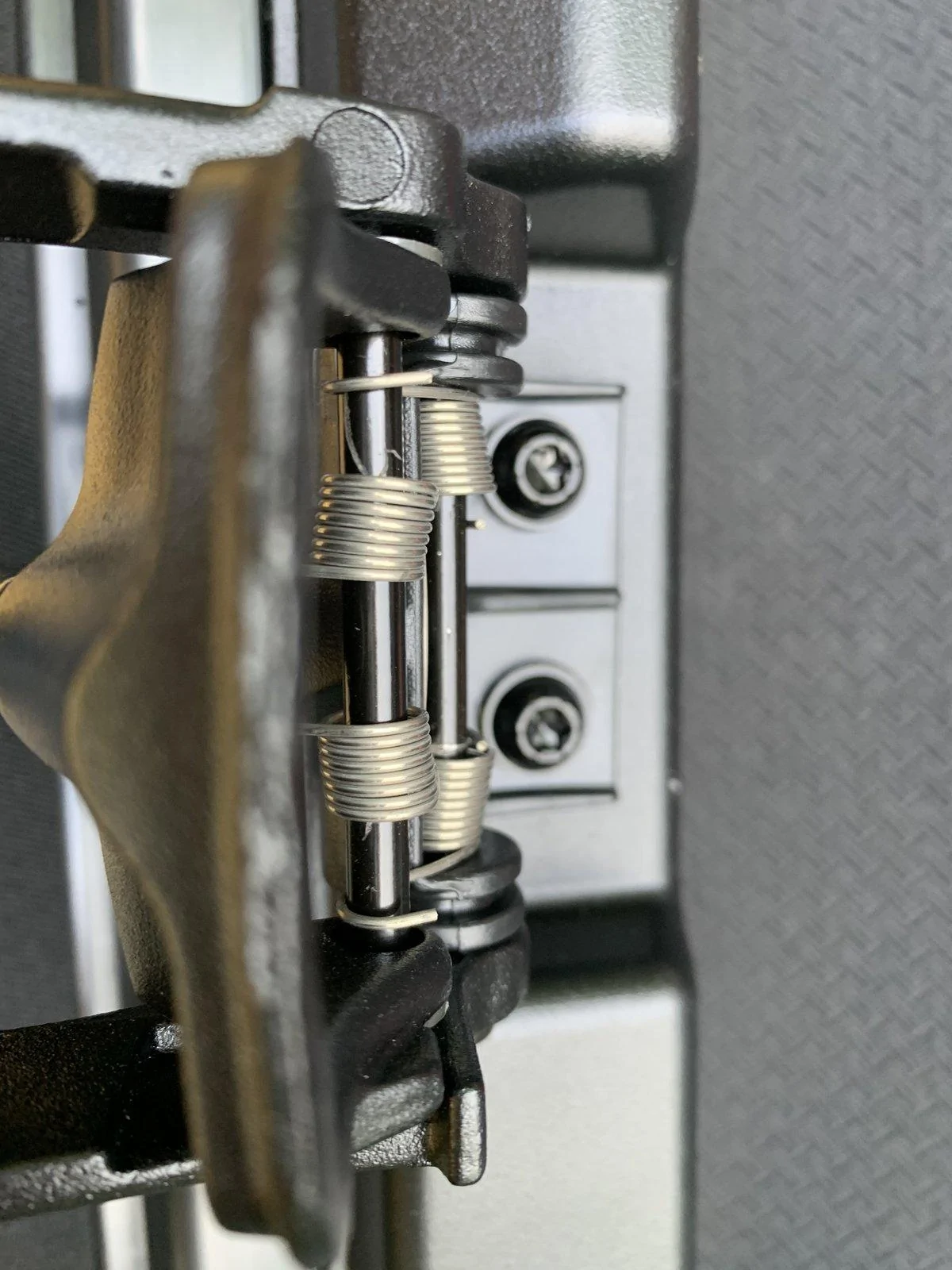

I just installed my soft top today and ironically, took it through a major rain storm. It began dripping underneath my visors. Some channel had water filling in it and I know it’s because the latches do not latch tight enough. I can flip the latches open with my pinky finger with hardly any pressure at all. I can see how the top easily popped open on you. I just sent this question through the Mopar site to see if it was like that for anyone else. Now I’m not sure what to do. My boyfriend and I tried to see if the latches could be adjusted or something.

Ok!! Actually adjusted the screws shown here in the picture and I have a much better seal. Latches actually latch and click shut. Phew. Simple fix. Thank you to who ever made the suggestion.
