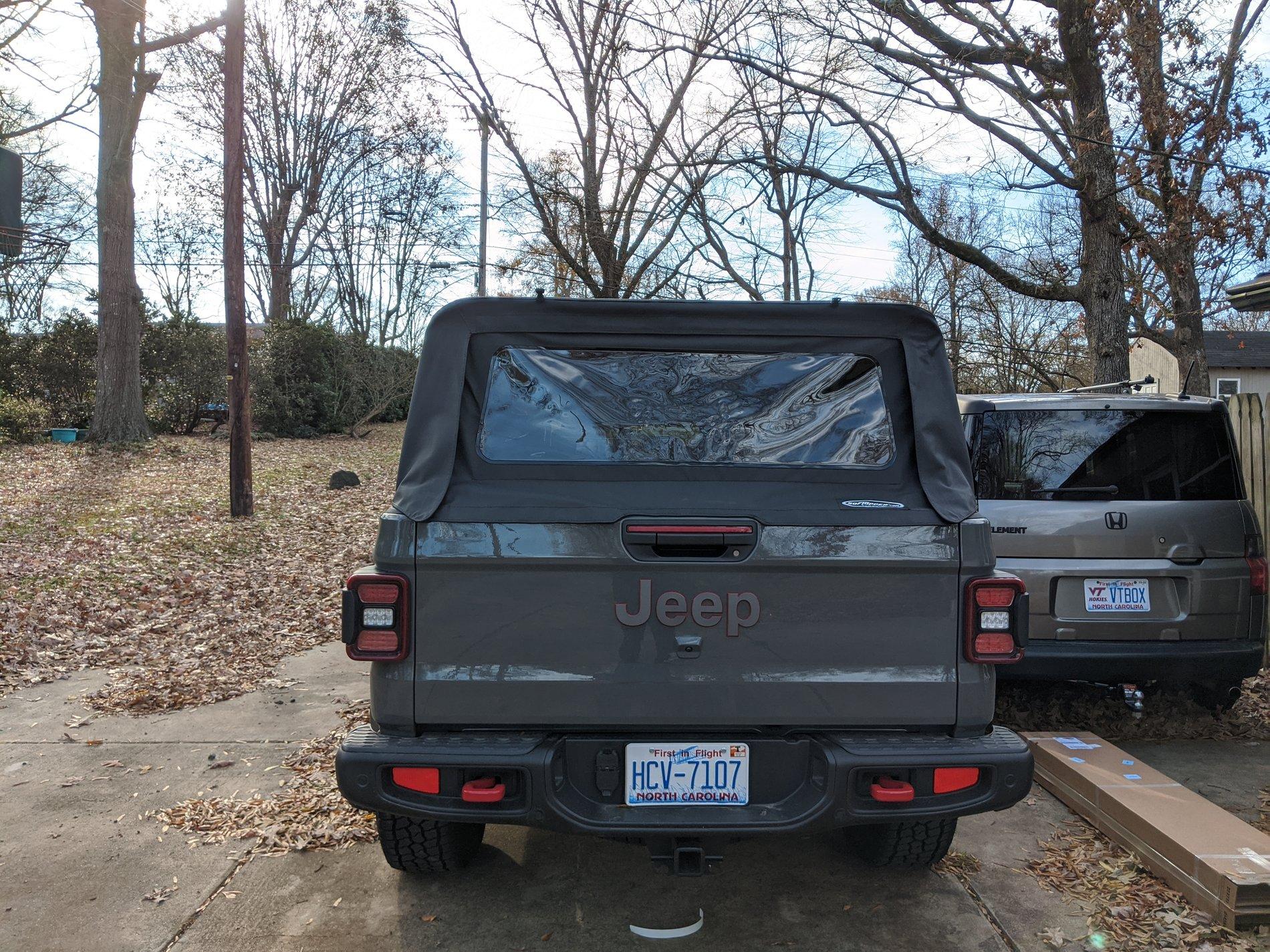

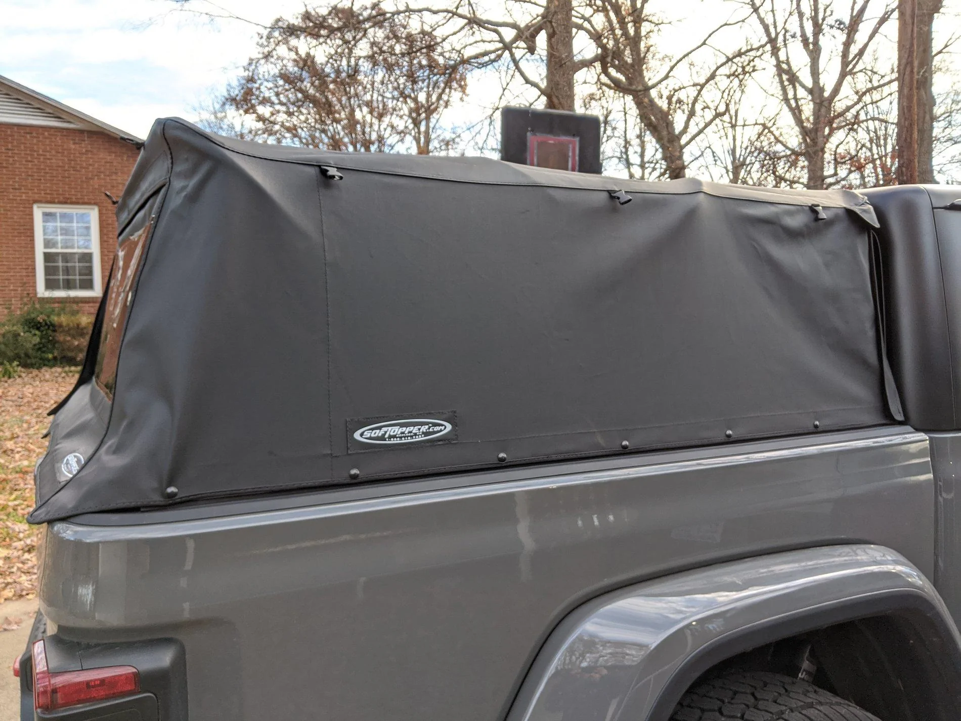

I enjoy it so far. No discernable noise, and you have to contend with Frost in the back. No big deal. Still didn't have a solution for the front window flap, but it hasn't been a problem really. Another member posted about removing front trail rail and reattaching, but I don't want to have to do that if I take the softop off when going topless for the summer

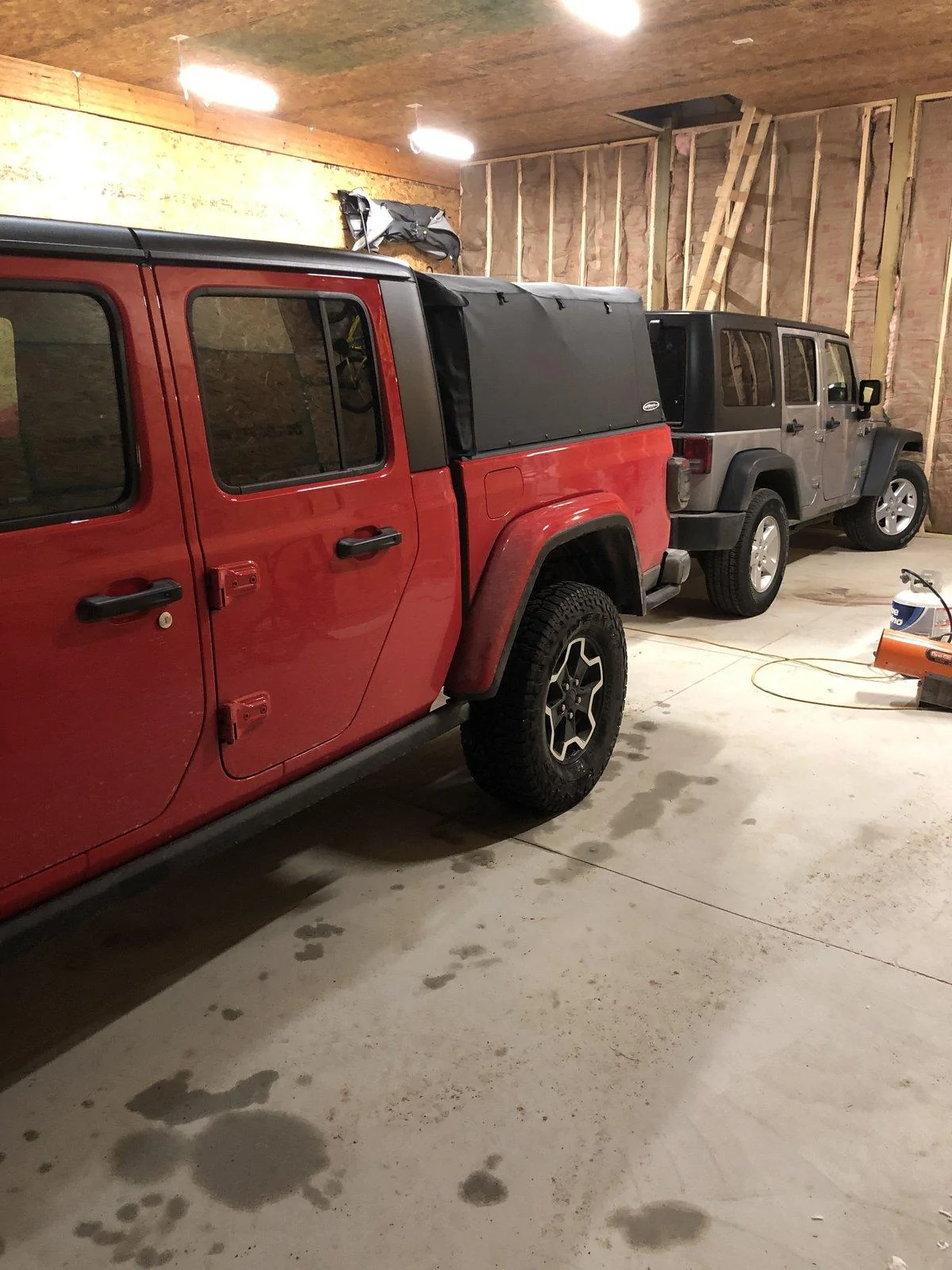

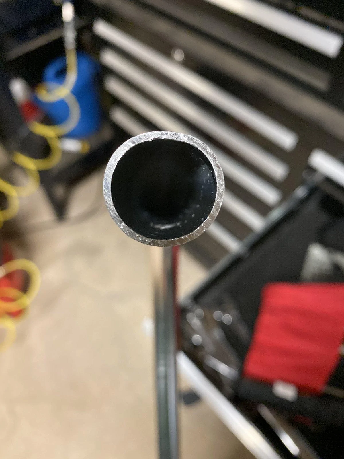

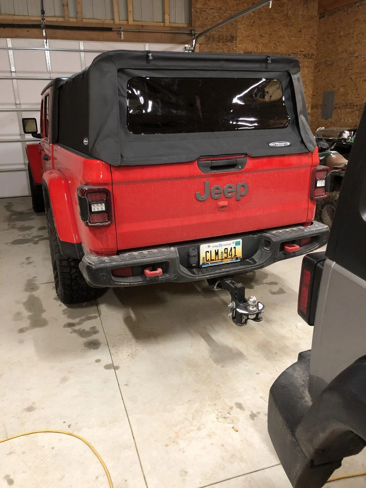

Finally got around to installing my Softopper. Ran into only one issue. This bar had been bent at some point prior to shipping, and wouldn’t attach like it was supposed to. I was able to pry on it enough with a wrench that it eventually became round enough again to install. Just need to install the rear window in the morning and I’m all done

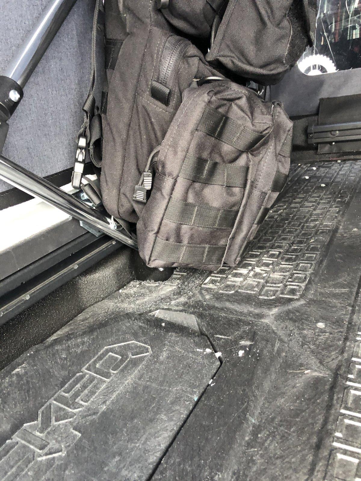

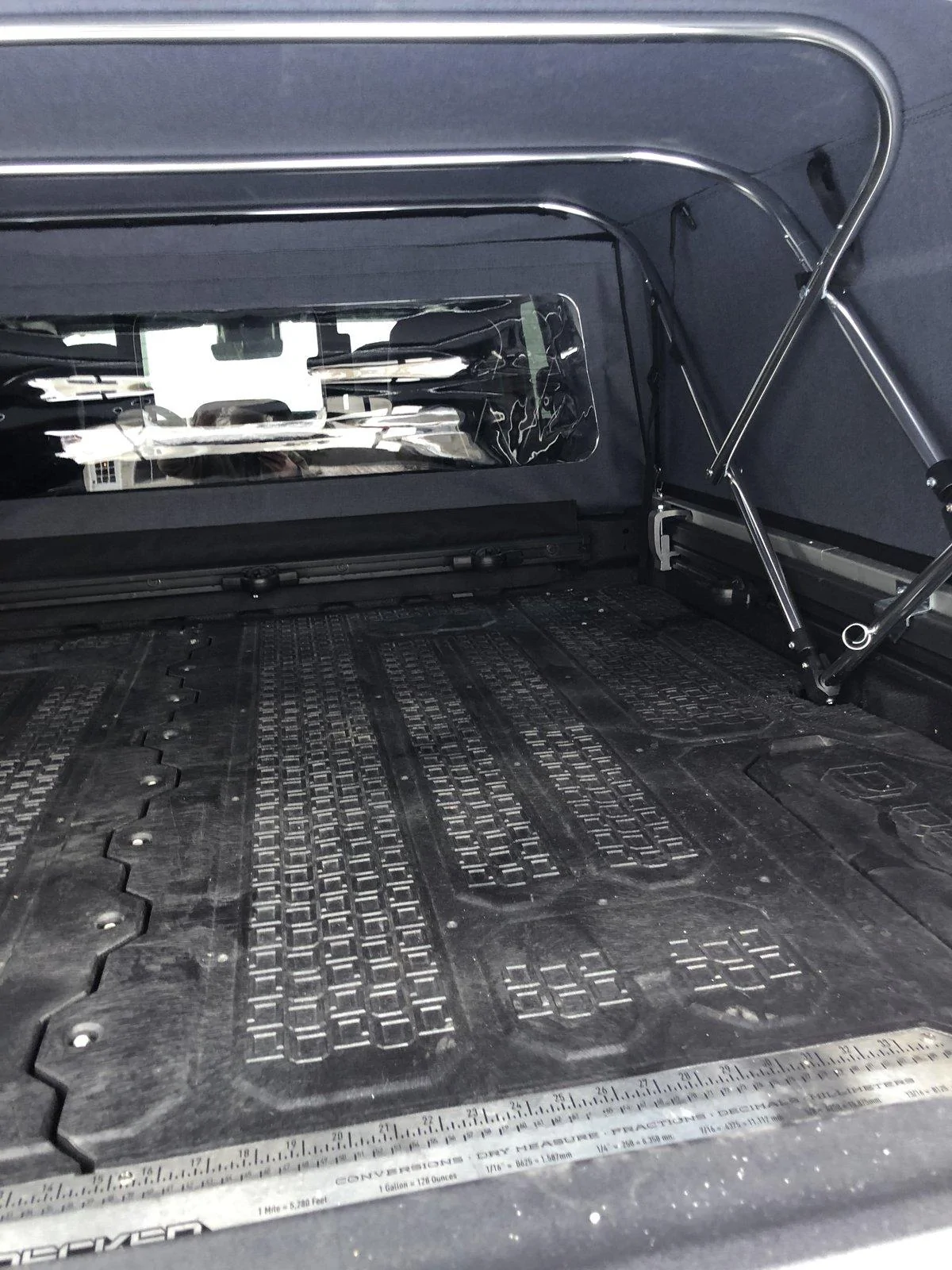

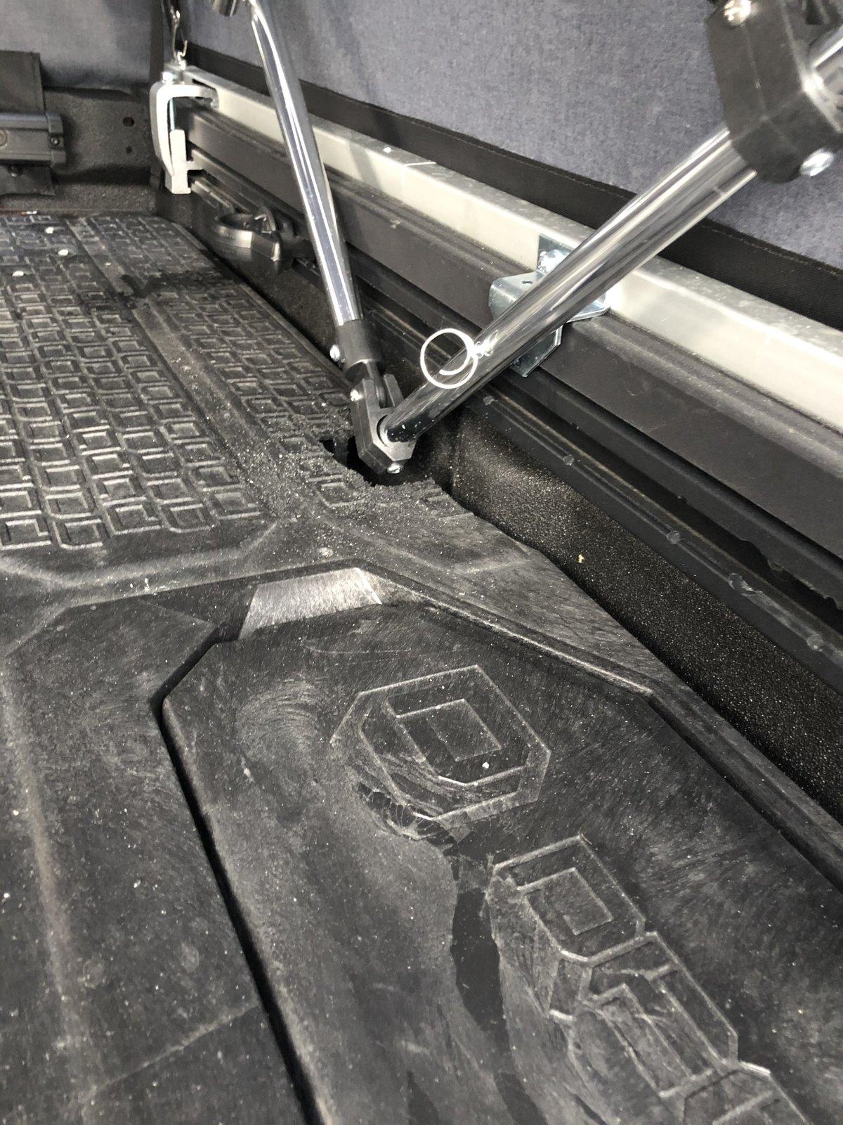

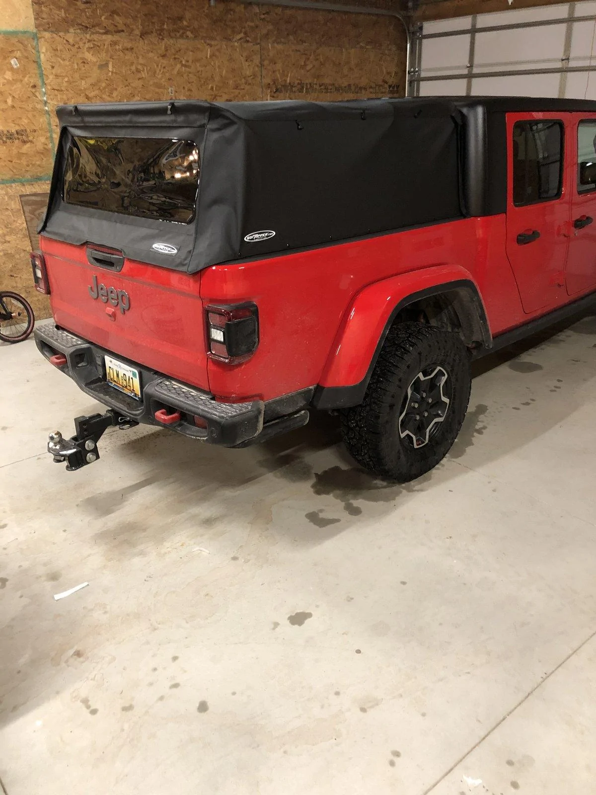

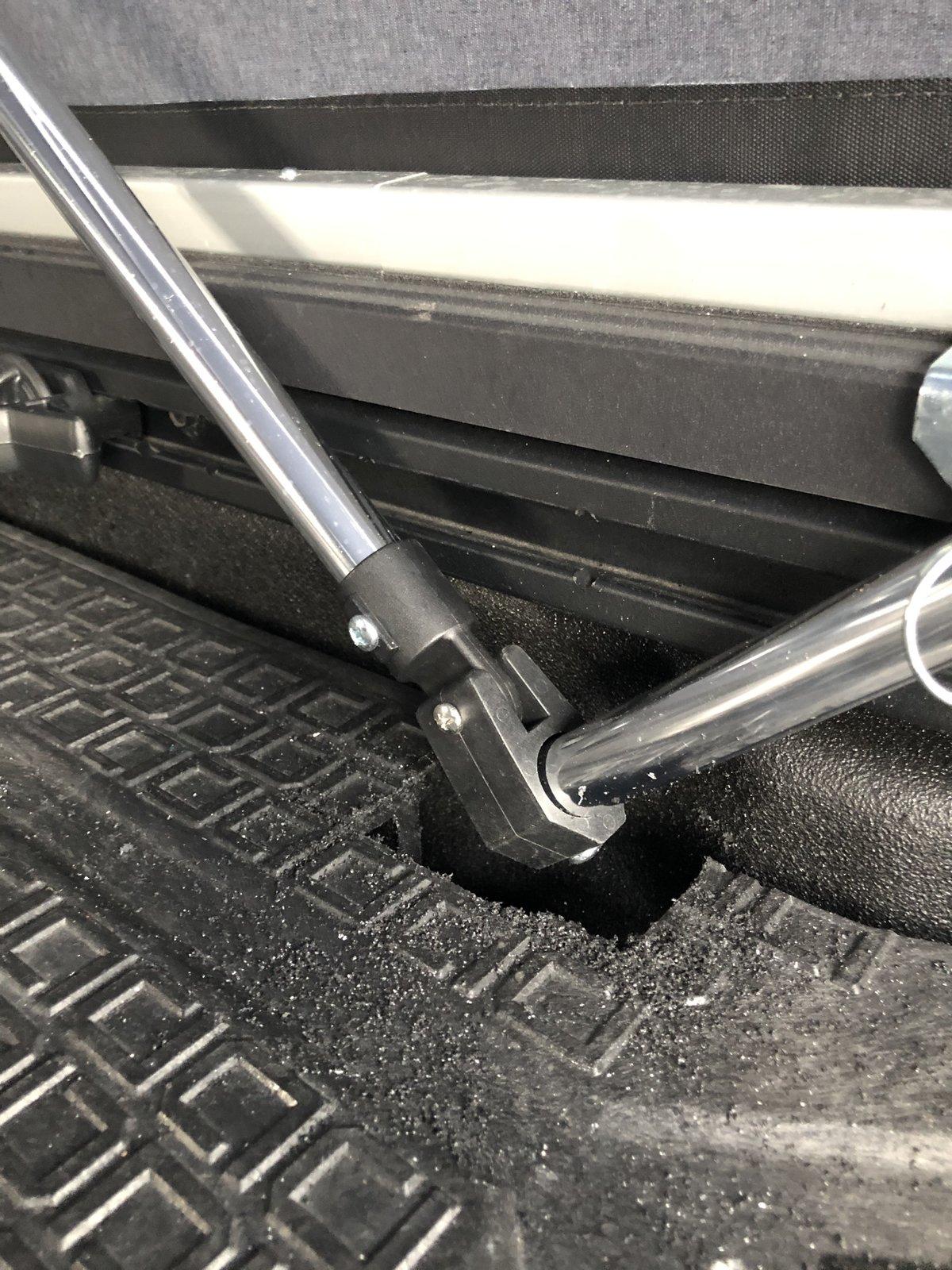

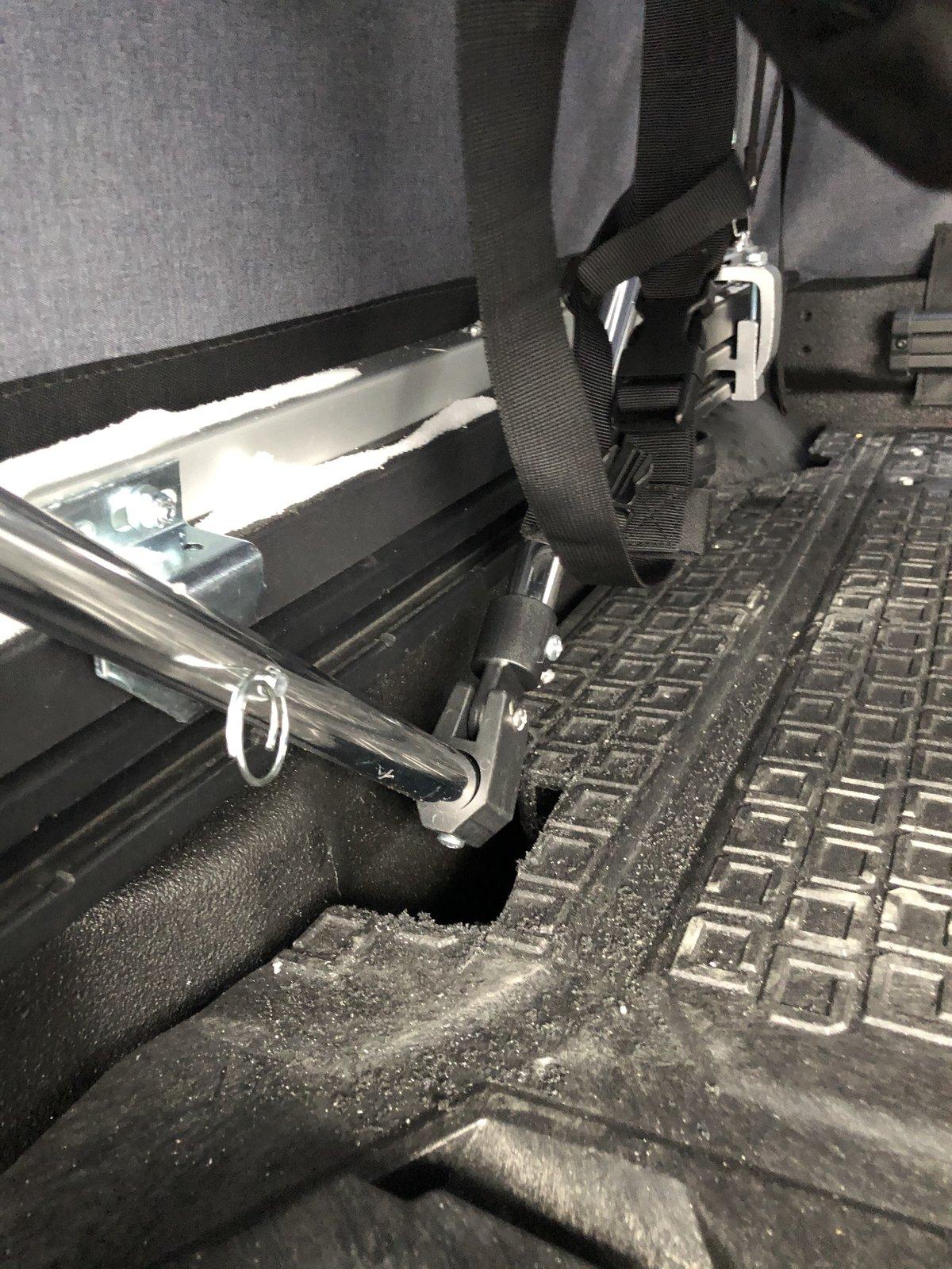

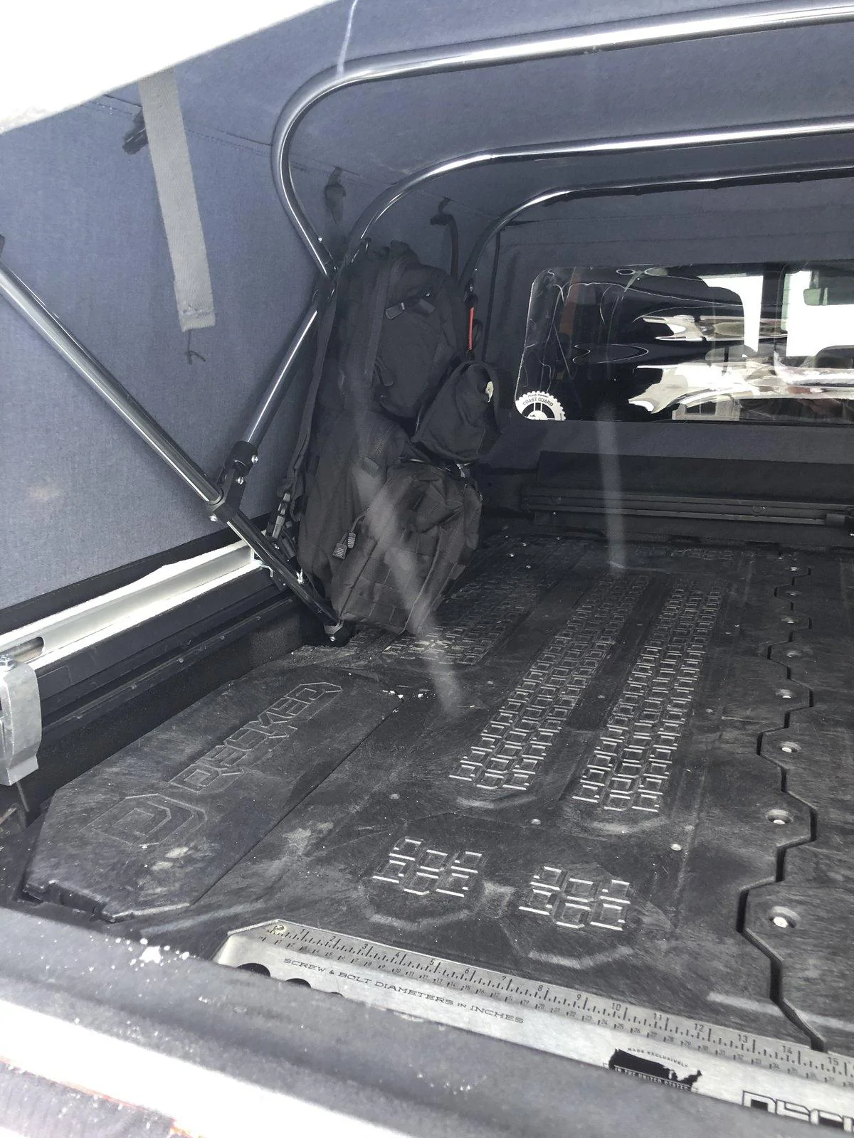

Softopper arrived today at dusk via fedex. Got the kids fed and in bed and went to work! Overall I am happy with the product, quality fabric and frame. I ran into 2 small problems that were easy to fix. 1st as mentioned before, the factory trail rail prohibits attaching the front window properly. I wasn’t giving up my trail rail, so I removed it(4 bolts and 2 body plastic retainers), marked the lower fabric with a sharpie poked a few holes and reattached the trail rail. It is solid, that window ain’t going anywhere, and I don’t plan on removing the top on a regular basis. From there, I had previously installed a Decked storage bed locker system, and unfortunately the Decked system is too high for the rails to fold as designed. Simple fix, body saw to the ABS plastic sides, cut out a 2”x2” block out of each side, the frame bottom can now rest about an inch lower than the Decked. If anybody needs pictures of that I will post them if asked.
I'd love to see what you did for trimming.
