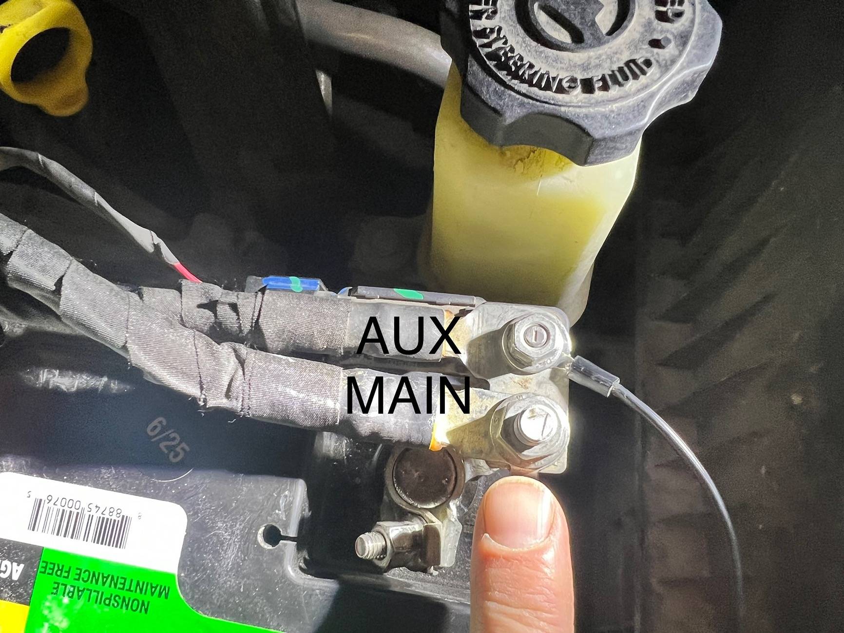

Turns out you’re brilliant & I now have a lost morning, an extra Z fuse, and most importantly, a running truck again! The winch was what I thought it was, but I’d removed the main negative (I guess) instead of the Aux negative (though I was sure I did that & then drove it). So it looks like the main negative is the one that’s easily removable & requires a 13mm wrench while the aux negative takes a 10mm, but has no real way to remove it as it’s part of the whole bit that clamps onto the battery post. Jeep REALLY wants to keep selling batteries, I guess 🤷🏼‍♂️

Hey all, hope you can help! Truck is COMPLETELY dead, no lights opening door, no dash lights or anything when trying to start.
So I had gotten a new battery, deleted the aux battery & heat shrink & taped up the ground for it. Truck was running well, but still had some parasitic draw, which seemed to be coming from my winch. Removed the winch negative (positive is already on a shut off switch) BUT bumped the negative battery post & got a spark. Battery is still good at 12.97V, all the fuses & relays seem to be good, the BIG fuses running off the main battery to the buss bar on the engine side of the fuse box are giving me continuity with a multimeter. ANY ideas on what else I should be checking please & thank you so much I love this thing & won't even move :/
