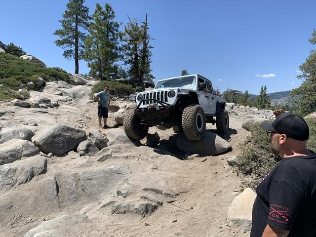

So I recently finished the Rubicon trail, a trail in Salt Lake City and a few days in Moab. I drove from Pittsburgh pa and back afterwards.
ive come to absolutely hate the seats in this jeep! They are awful at best... what are “the Best” suspensions seats available?
Next I had a tough time with the jeep in 4wheel low, it’s an automatic but it stalled quite a few times on the rubicon! Has anyone else experienced this? And how do we fix it?
also in 4low the vehicle would surge/ rev slightly causing the it to pull me down ledges faster than I wanted and I would have to stand on the breaks to slow it down and yes it was in manual mode!
please help if u have had these issues…
Thank u in advance
