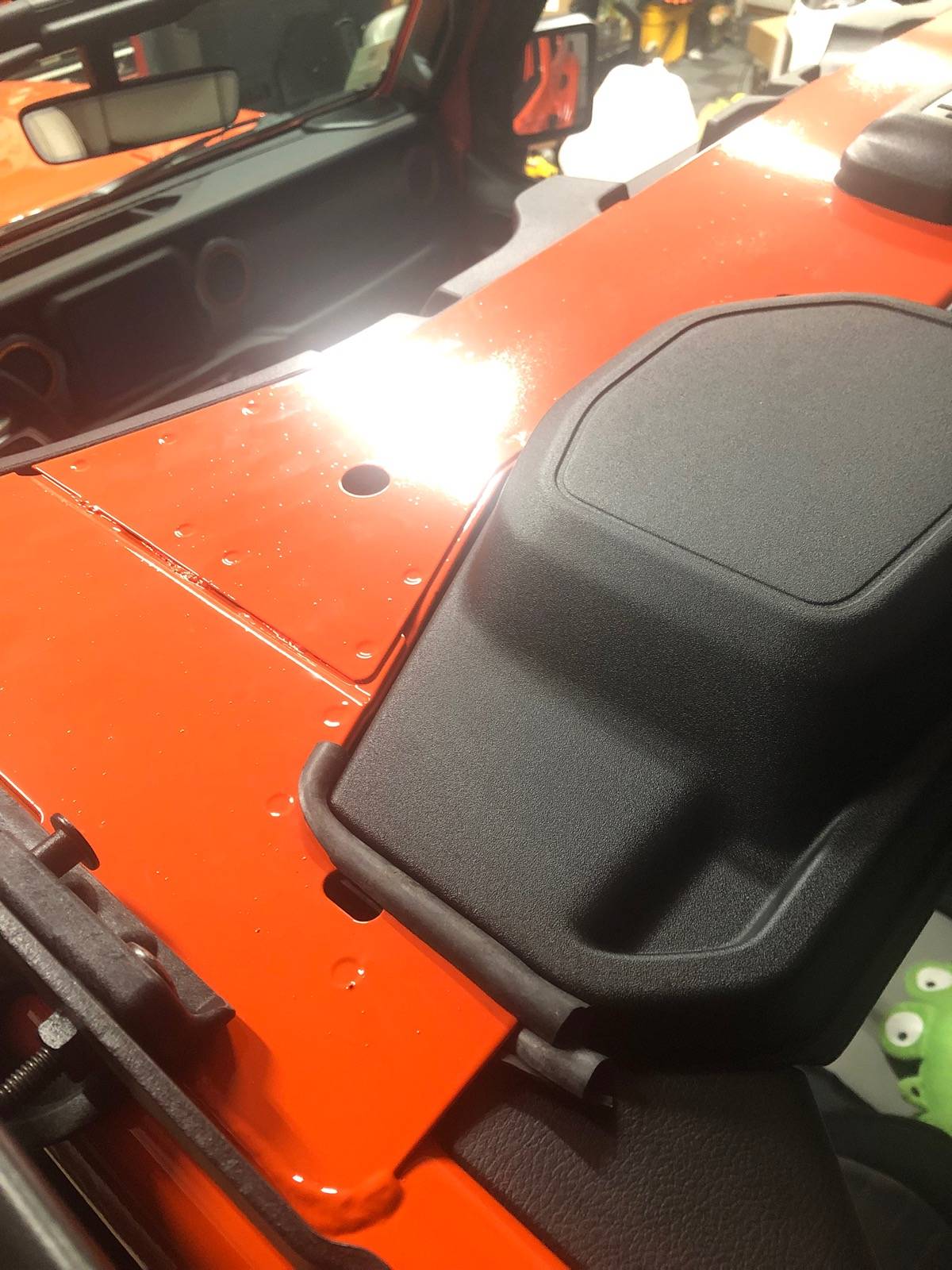

I figured I'd make a quick post to potentially help someone else out in the future. My Jeep is brand new with roughtly 2,800mi. The other day headed home from work, I had the top back and the stereo cranked pretty good. I started to notice a subtle yet annoying rattle at certain frequencies during virtually every song. When I got home, I decided to see if it was something as simple as the speaker grill or maybe even the screws that hold the speakers themself in. I took off each grill on the soundbar and double checked that everything was tight (it was). While at home, I replicated the sound and was able to confirm that it was just the plastic housing of the sound bar itself. If I pressed it ever so slightly, the noise went away. Its a little hoaky, but my solution was to slit a piece of rubber tubing and wedge it in there. Shouldn't have to do it on a truck that cost as much as this, but hey, it works and its basically invisible. Hope this helps someone in the future.

I had thought about squeezing some silicone sealant into the seam but your way of doing it is much less messy. Thanks for the tip!
