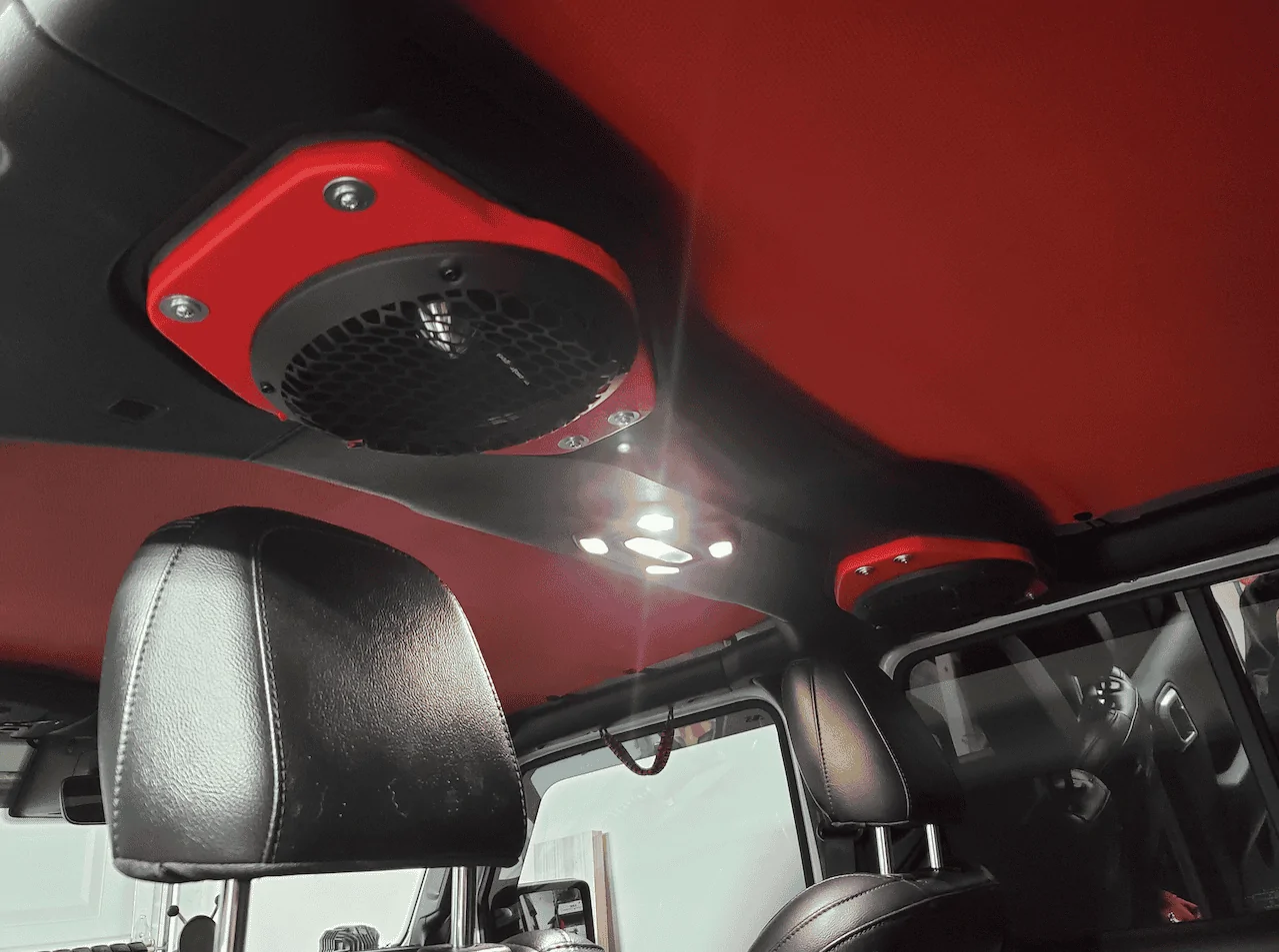

You could always go nuts like I did... haha!
Jeep Gladiator Sound Bar Speaker Replacement 1671136308191
In all seriousness though... I wish I would have seen this a couple of weeks ago before I through all of stuck stuff in the trash! I would have just brought them to you!
