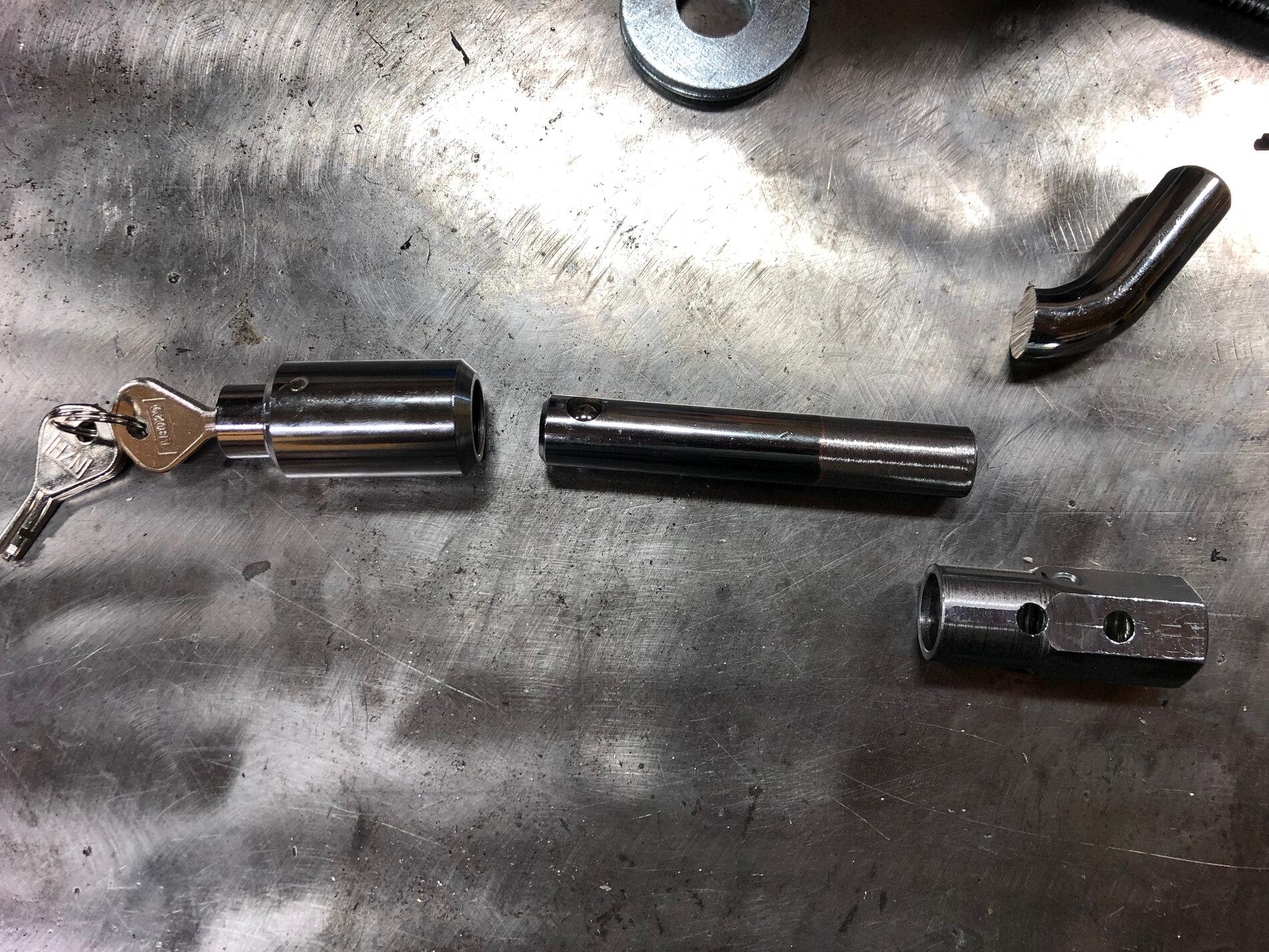

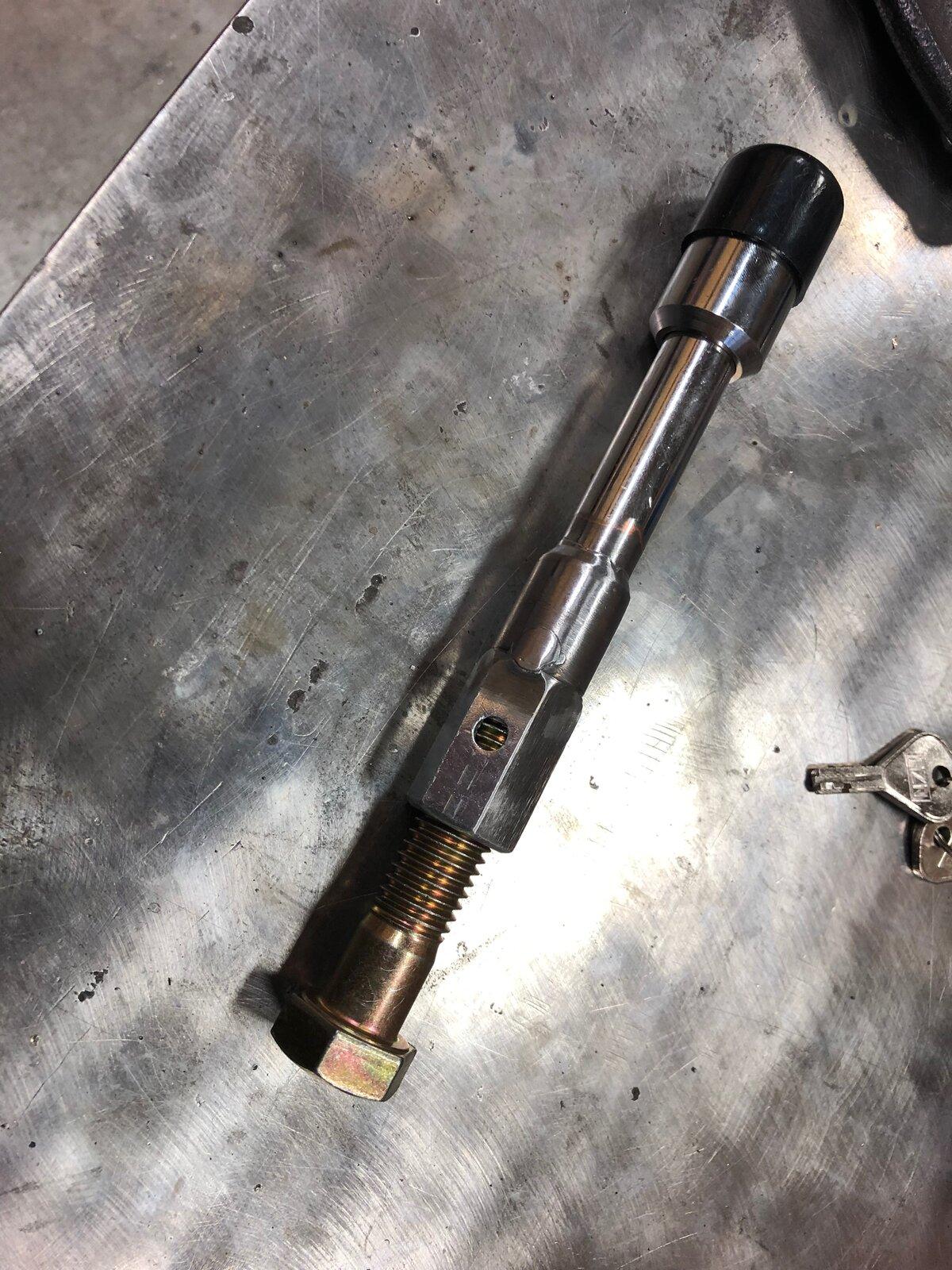

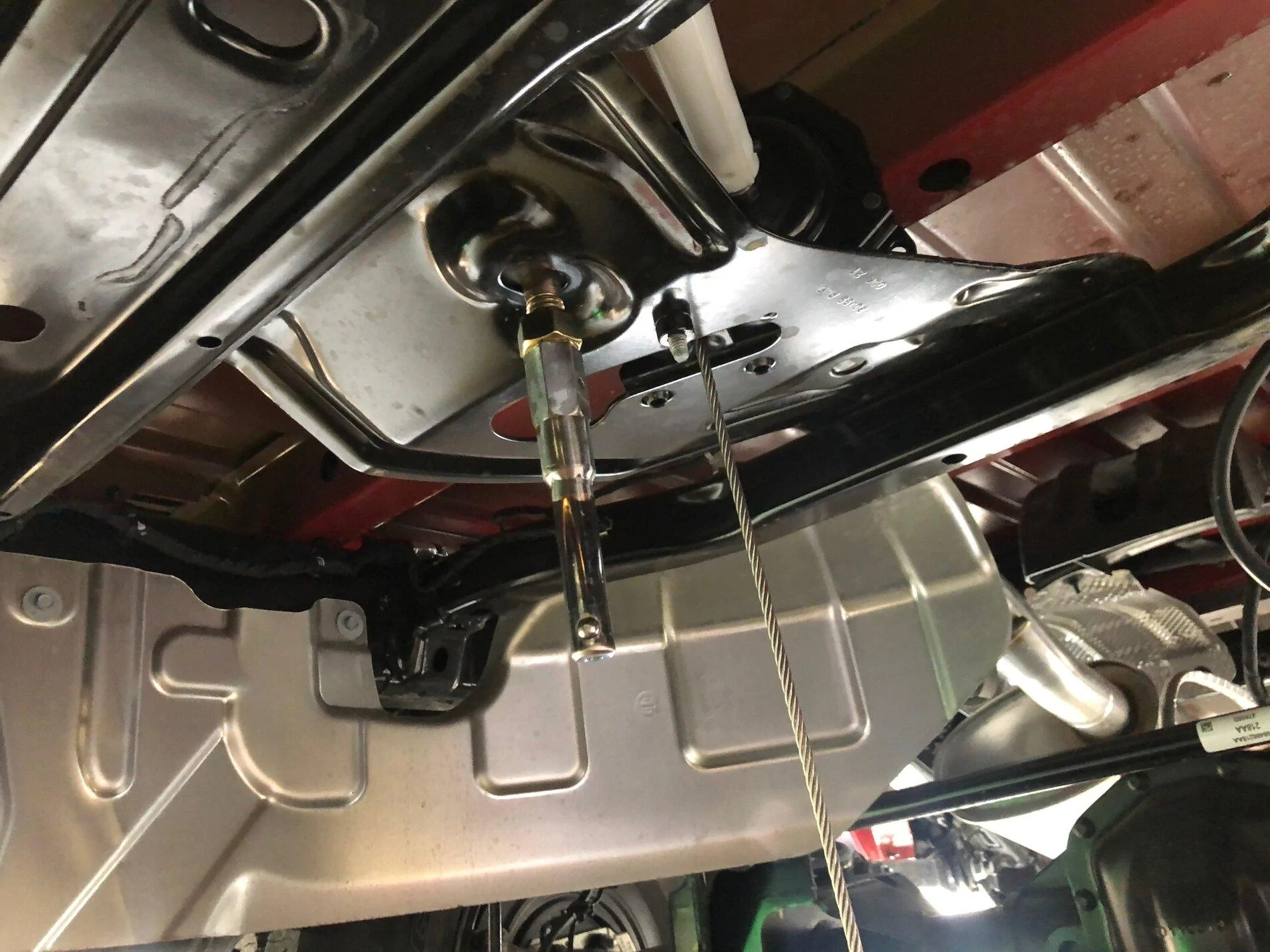

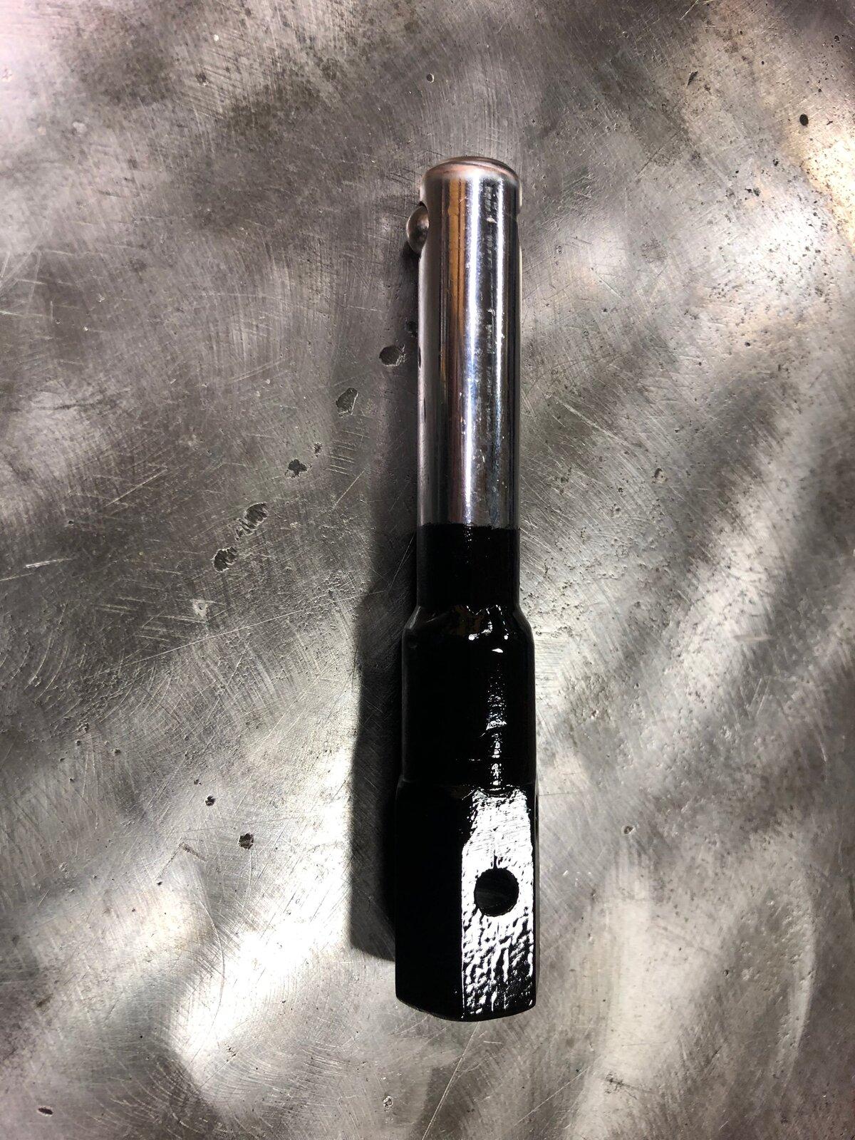

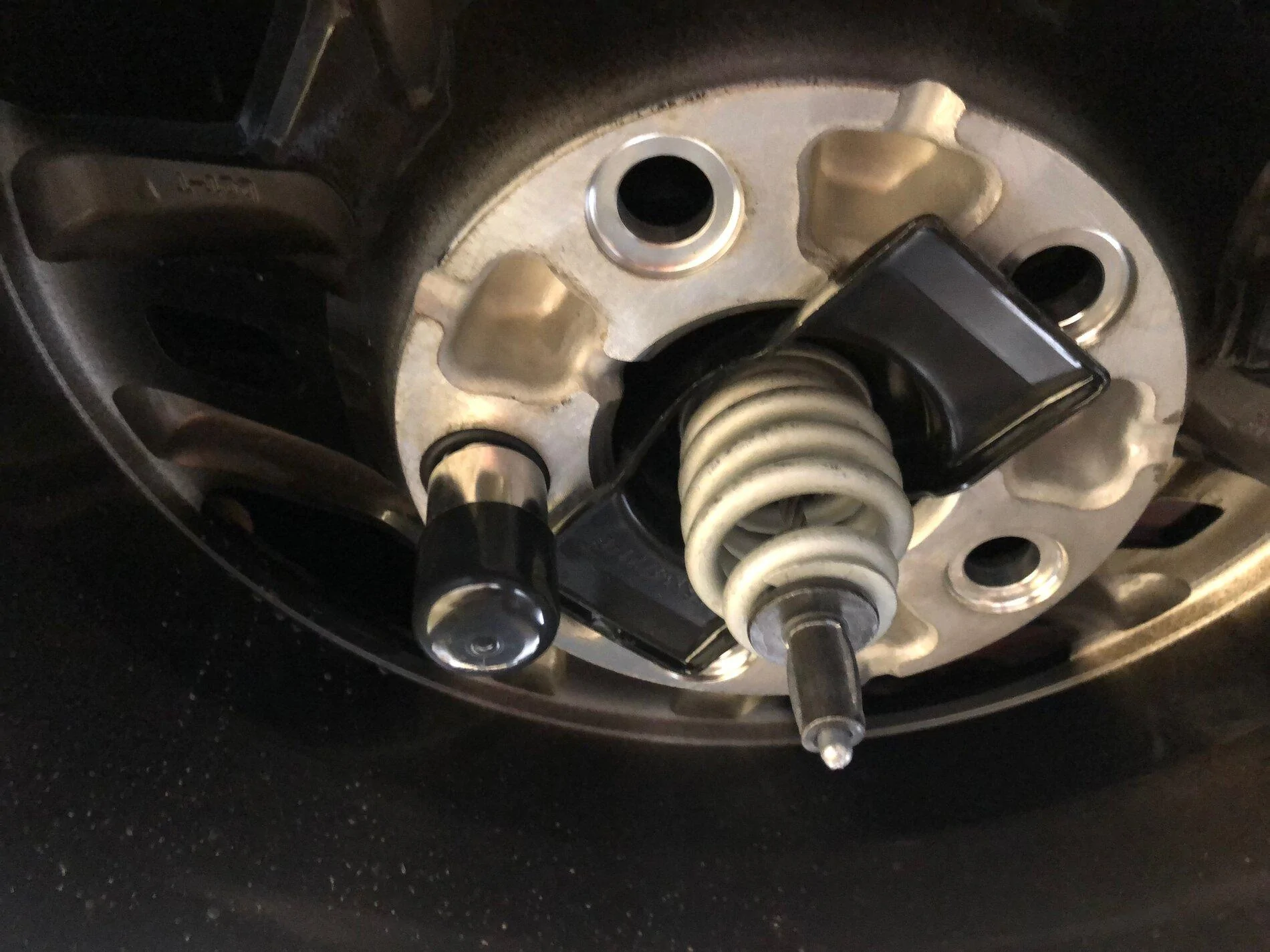

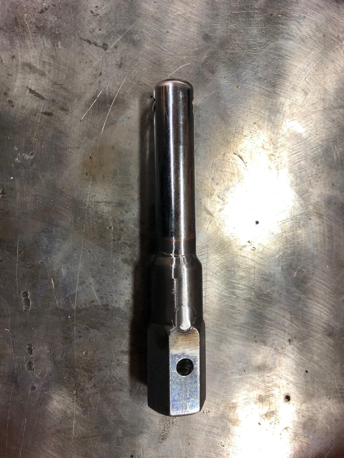

I saw the mopar lock, but I wanted something with a real key. There's a few holes in the frame above the spare. Not sure what they're originally for, but the slotted one nearly lines up with the lug holes.
So I ended up cutting and welding a receiver lock to a coupling and threaded it onto the end of a 5/8" bolt. Added some rubber washers to prevent rattles, and overall am pretty happy with the result!
