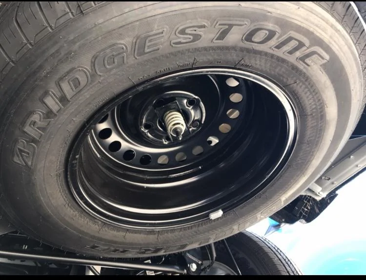

Got a flat today and only have driven 1300 miles on the gladiator. I had to watch the mopar video to learn how to winch the spare tire down.
So, I am guessing it doesn't have a sensor in it? Cause my reading on the dash says "--" and is red. And TMPS light is on too.
Correct. Unless you put one in the spare, the stock spare does not have a TPMS sensor. At least mine didn't.
Nope. there is not a sensor in the spare.
