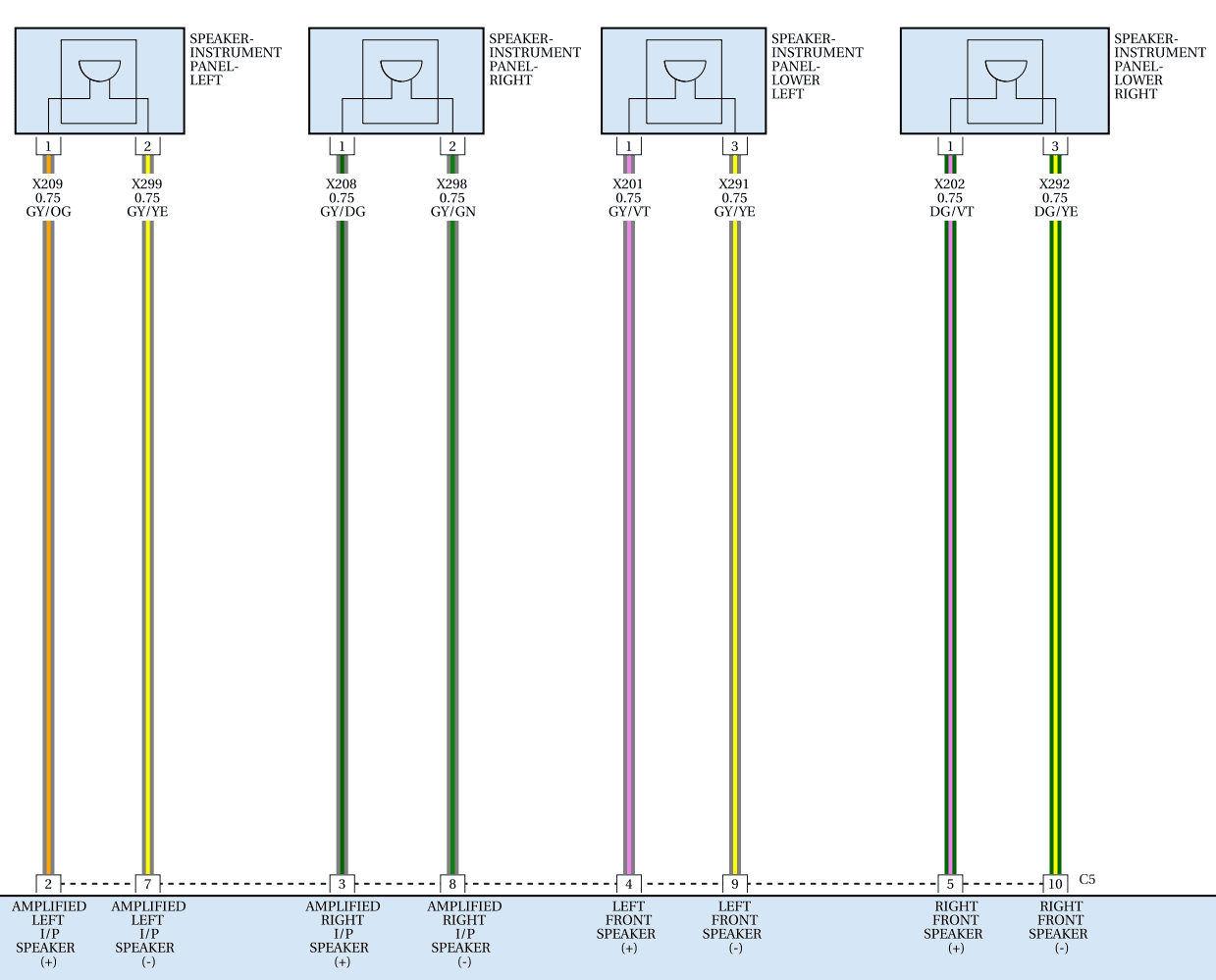

JTR 8.4Uconnect. I swapped both upper front dash and both soundbar 3.5" speakers with four Kenwood eXcelon KFC-X3C 3.5" Mid Range Speakers for Chrysler/Toyota/Others, 50 RMS Max Power (Pair) using the metra 72-7902 adapters. The sound is noticeably crisper with more depth from the front than with the factory 3.5".
Sharing a couple of things I learned if it helps anybody. The metra adapter wiring (polarity) was aligned correctly with my factory wiring harness in the dash and in the soundbar, meaning I did not need to flip the wires in the metra adapter (as is the case for many JL/JT owners) to maintain the existing polarity. Here's a wiring diagram I created, keep in mind the 8.4Uconnect uses a different factory wiring harness with differently colored wires than the other system levels.

I realize this post is a little dated, not sure if you can remember back... but I used your diagram when installing my speakers and passed it along to help someone else and now they have pointed out that your diagram is opposite of the Factory Diagram (Premium System).... Do you remember where you got your original diagram information ? attached the factory diagram.
I created the diagram by opening up my 2021 JTR and polarity testing the factory speakers.

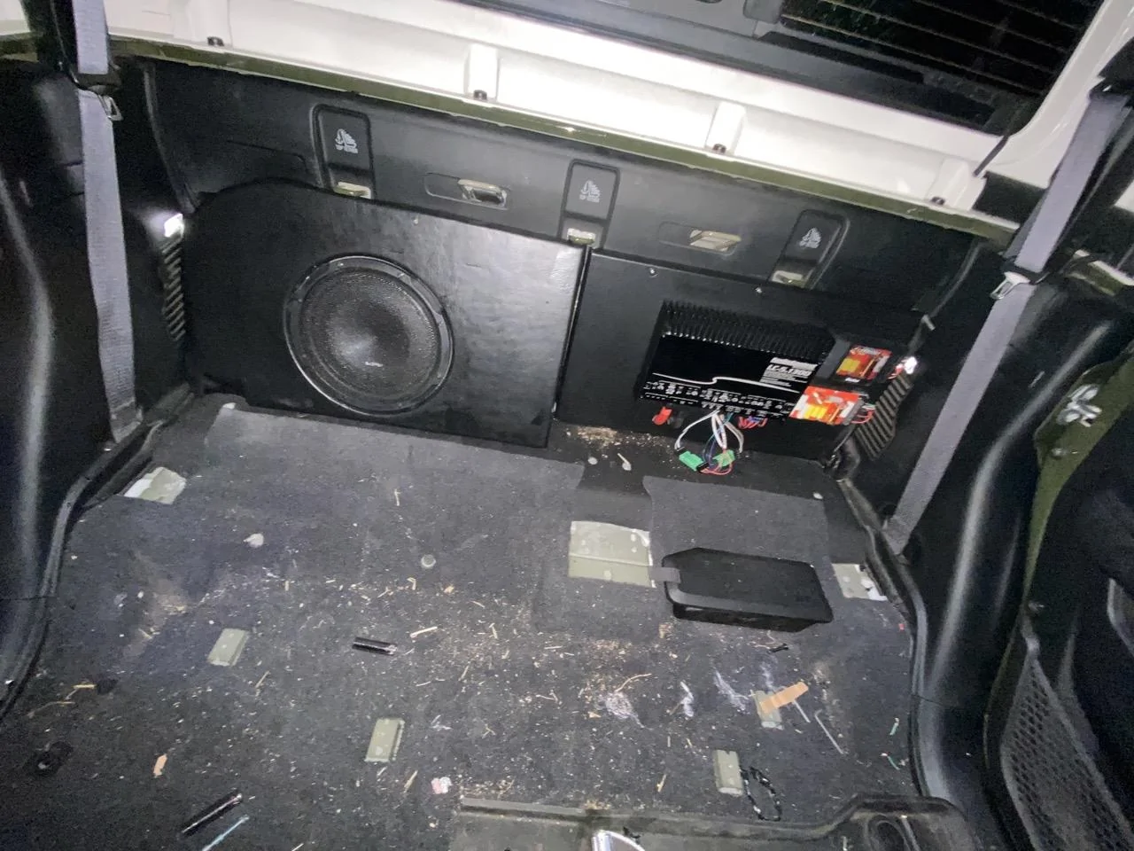

As for subs, they need power and they need specific sized enclosures to work correctly. There are pre-made subs and enclosures that will fit un the seat and behind the seat. Behind is reare but they are out there. I built mine with a shallow mount sub, 10" Dual Voice coil, fiber glass enclosure. I would not recommend replacing the factory sub driver. You will spend a lot of money for a driver that is not designed for the enclosure then blow it. I cannot stress enough, if you want better sound, get a real amp if you can. The factory "Upgraded" Alpine is a silly marketing thing. Does it work, sure, sorry just not great for the money it cost. It's a mess, needed to get the truck back together.
Sounds good ! I doubt with our system setup, the polarity of the dash speakers would make much of a difference anyway... Someone had mentioned if your sound seemed on the high midrange side that you might have the polarity reversed and then the person pointing out the reversal between your and the factory diagram ... I just cant remember exactly how I hooked mine up..... lol I guess if it really bothers me I can use a multimeter to know for sure. Thanks again !
