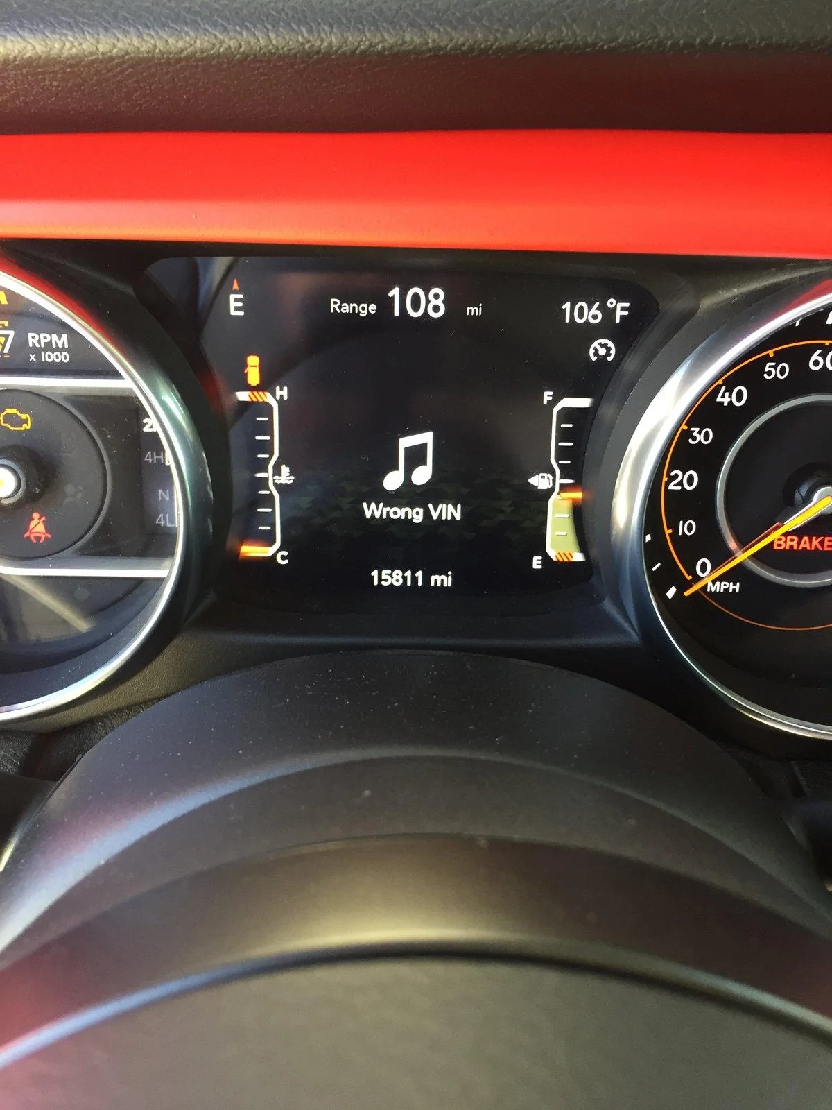

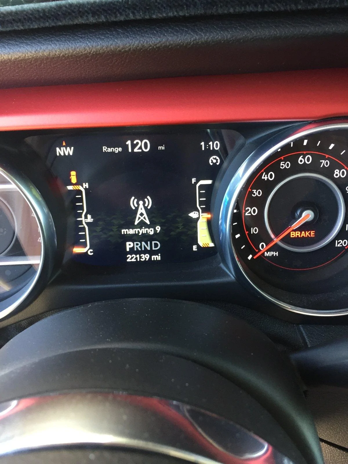

I get that, but what I want to know is has anyone tried to change the tire size on another JT without marrying the Tazer to it?
Example, I can take my Smarty S67 Catcher and EFI Live V2 unit, and it can remain VIN-locked to my Cummins, but I can still plug it into someone else's and check and clear DTC's and adjust things like tire size without having to marry the unit to the 2nd vehicle. Why is the Tazer any different? Is it programmed to be different than that? Has anyone actually tried this so we know 100% for certain that it will not work that way, despite what we're assuming based on what ZAuto says. That's all I'm asking.
Will pictures convince you?????
At least four different people have stated the same thing.
So I remarried the Tazer to my wife’s Jeep to prove my point.
Jeep Gladiator Speedo calibrating / Tazer / Dealer DB573950-583F-48CC-A2C0-0F44EFABFFAB
Then hooked it to my Jeep.
Jeep Gladiator Speedo calibrating / Tazer / Dealer 059724D9-CBD0-43DA-84E8-BF56E7A6B554
See the message? Wrong VIN!
Please stop spreading incorrect information. Tazer is a one vehicle at a time deal.

I'm not "spreading incorrect information" I'm asking. And yes, the pictures helped. I guess they are just programmed to not work that way at all. That's all I was asking.

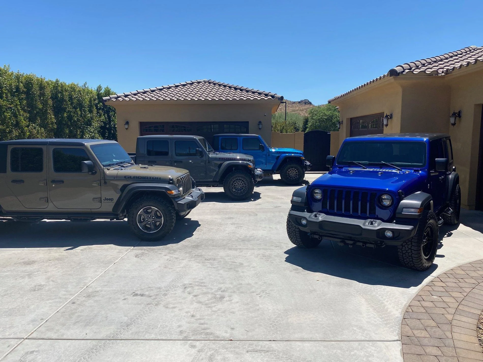

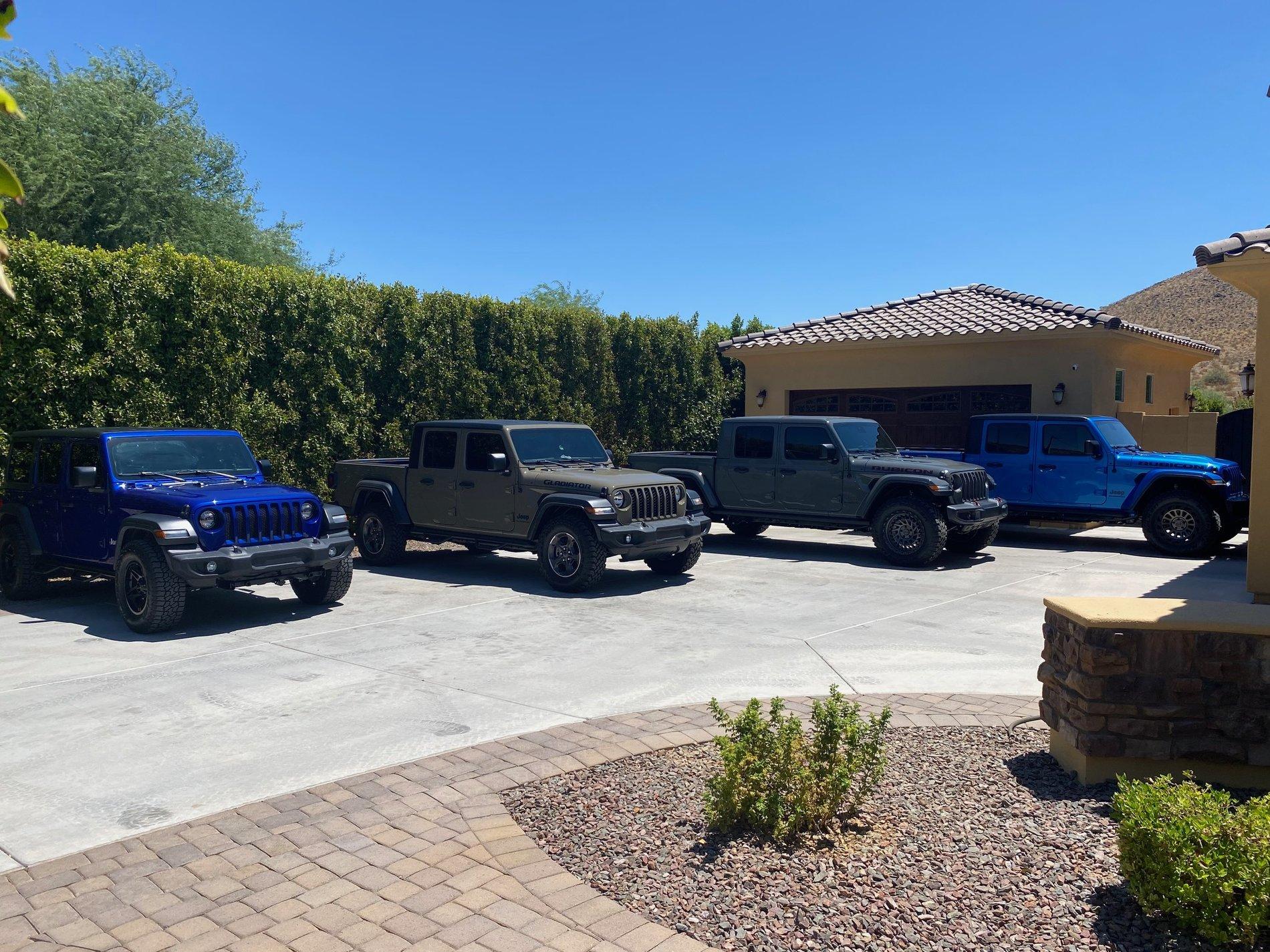

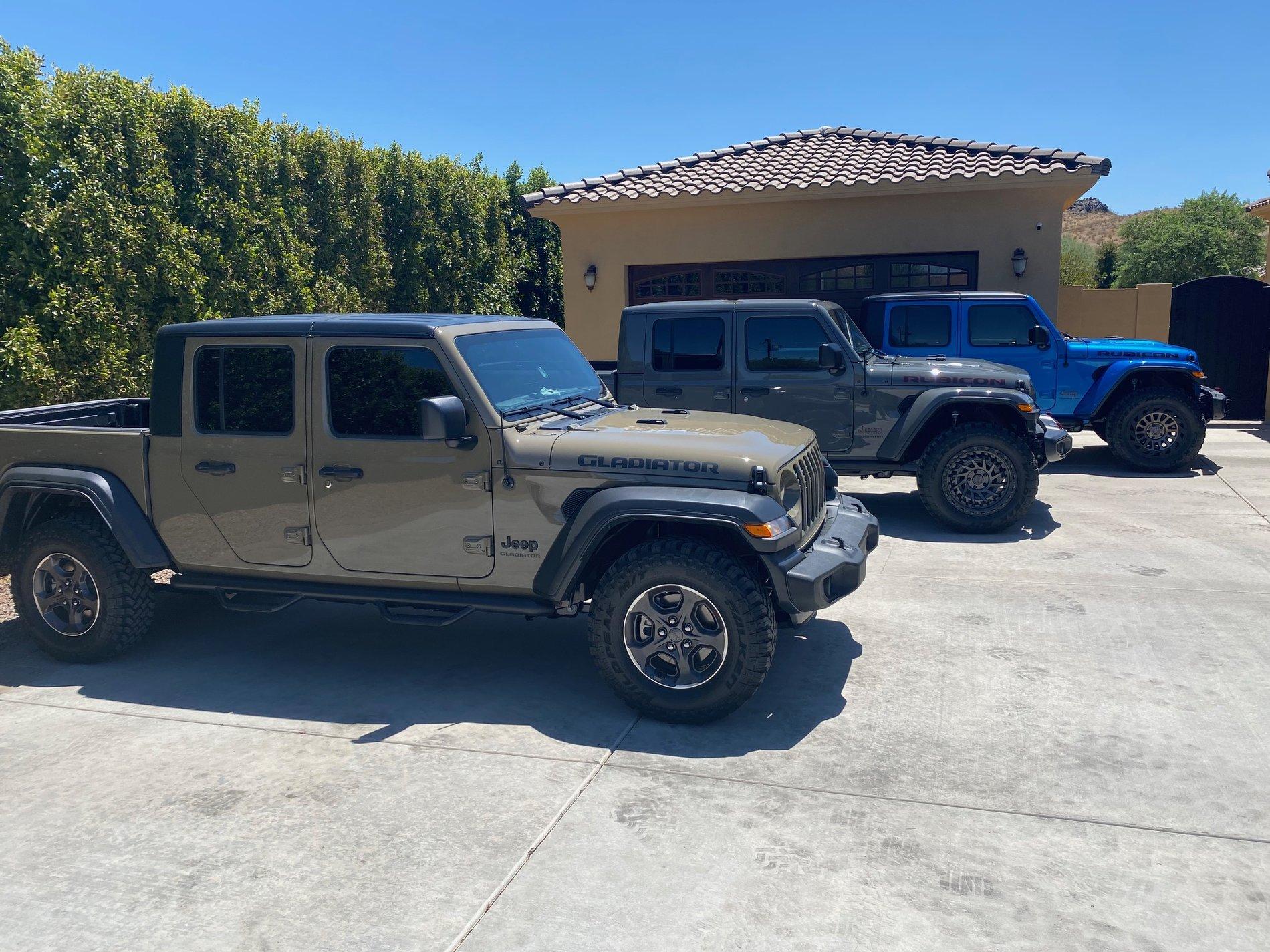

We have 3 Gladiators .... 2 Rubicons, and a Sport S Max Tow........and also a 2018 JL Wrangler UL Sport.
(Pictures below)
The background story is..... in the last 2 weeks we have played "musical chairs" with the wheels and tires of all four vehicles.
My new factory Rubicon wheels and tires went on to our sons Sport S Gladiator when I got my new wheels and 35's.
Wife saw it and said " I WANT THAT! "..... and a few days later she also got new (different) wheels with 35"s on her Rubicon.
Then, her factory 33's (tires only) went on our other sons Wrangler. It already has aftermarket wheels.
So now, everyones speedometers are off.
