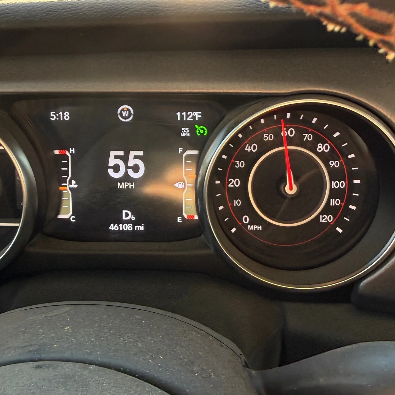

Until recently, my analog gauge was spot on with the digital but last weekend I set the cruise and noticed it’s off by 2 mph. I don’t use the digital gauge normally. How/why would it change? I’m guessing the analog isn’t manual like the olden days. IDK
I noticed recently that mine gets closer to the same at higher speeds, and were almost identical on a recent highway trip running between 85-90. I remembered this item from the build sheet:
97 MPH VEHICLE MAX SPEED CALIBRATION
I now wonder if that’s not the point where they adjust them to be the same and let the rest float a bit. As usual, YMMV, IANAL, etc.
