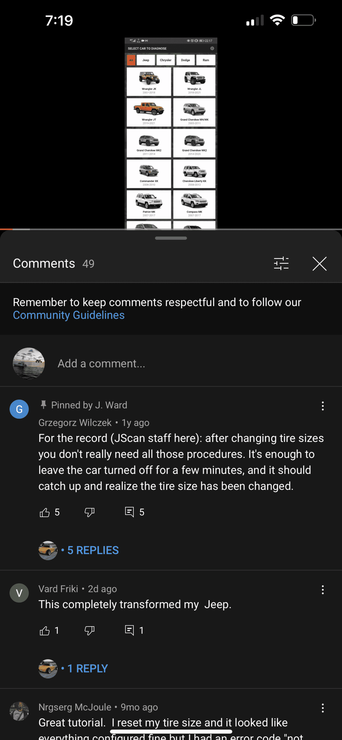

Download JSCAN app, get the license, apply your VIN, then you should be able to follow the steps in the video below to change the tire size. However check the first comment to that video from a JSCAN employee. You don’t need to do all the crazy ECU reset crap after changing the tire size in JSCAN.
