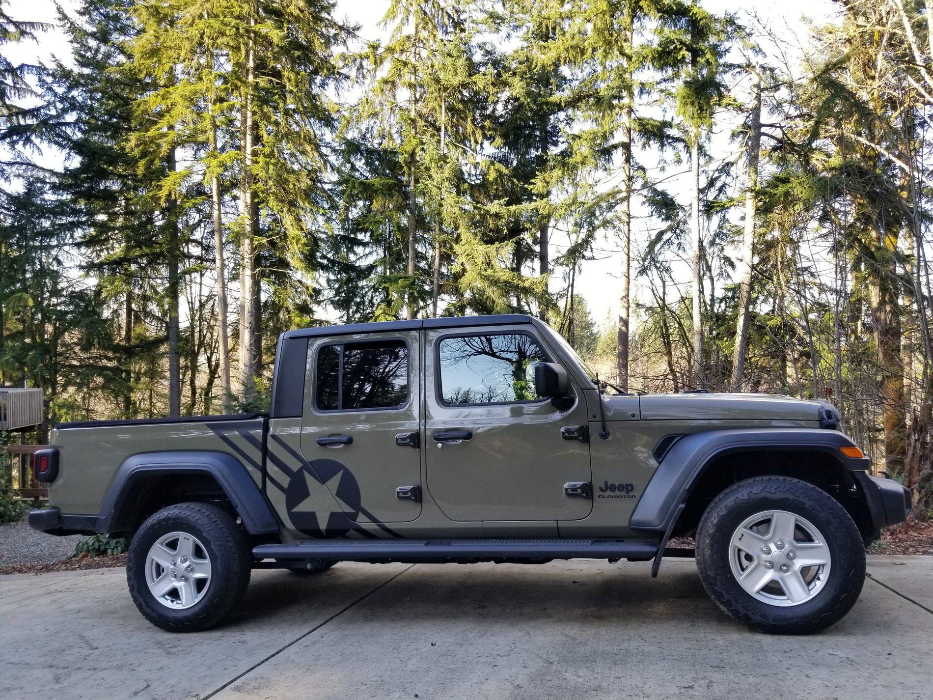

Anyone know if I the Overland Stock Wheels will fit my stock Sport S with Max Tow Bridgestone Dueler tires?
Overland P255/70R18, Sport S P245/75R17.
I will be towing a Travel Trailer at maybe 4,000 lbs. loaded and maybe 500-750 lbs. of people and gear in the bed so don't want to sacrifice any load or towing specs with the Overland wheels.
Tire sizes and wheels sizes are not my strong suit and don't want to screw things up just for looks.
Thanks in advance for any advice/answers. (did a search and didn't find a answer).

The Overland stock wheels will fit, but they need to be paired with appropriate tires. The Overland wheels are 18 inch, where all the other factory wheels from Jeep are 17 inch for the Gladiator.
I like the Overland wheels. I plan to put these on when the factory tires need replaced. Currently, in my area, they are $143 each (plus mounting, balancing, etc.).
255/70 R18 113T SL BSW CM

Thanks Mr. Bill. Some people said no problem putting a 17" tire on 18" wheel, was very skeptical so double checked here.
Erievon
Al
Apr 20, 2020
695
933
Cleveland, OH
2023 JTR., 2021 JLU Altitude
International Banker
Oh no no no. The rims will fit your truck. The tires need to be 18". Your stock 17" tires will not fit on 18" rims.
