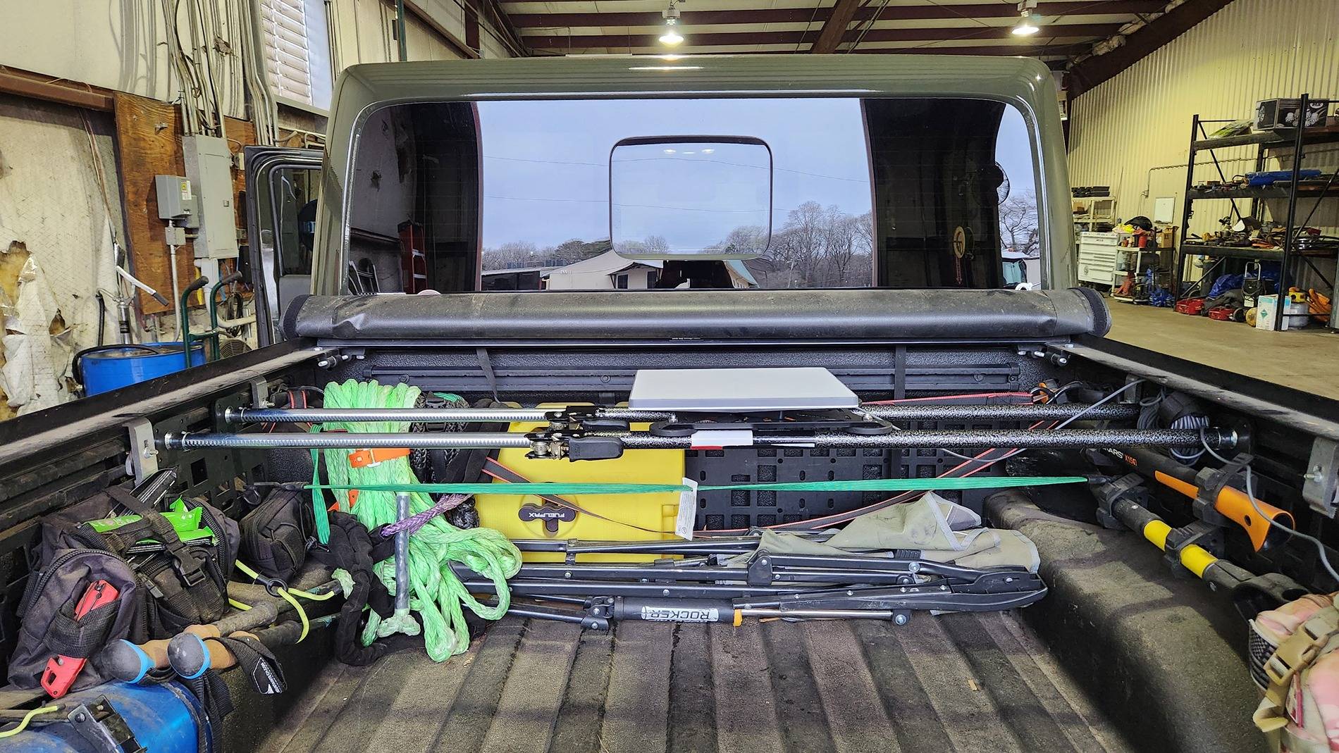

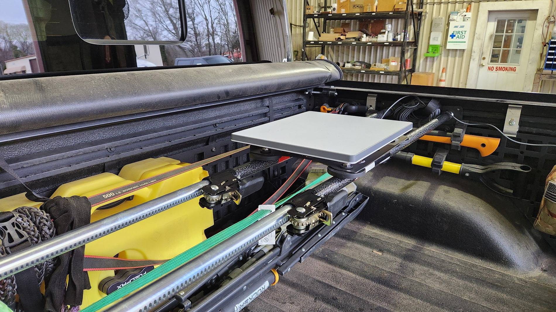

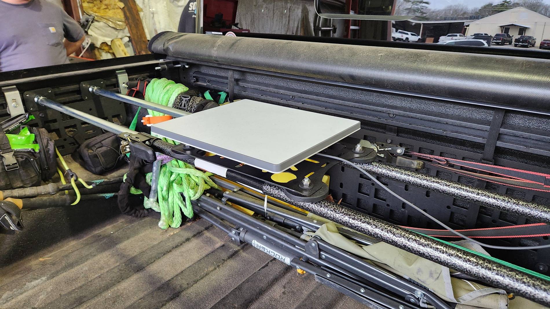

I was trying to figure out how to make a good in-bed mount for my Starlink Mini. Then I came across some mini load bars at Harbor Freight. It keeps it mounted high to reduce the bedside obstruction and allow me to still toss stuff in the bed without worrying about it. Less than 50 bucks
Jeep Gladiator Starlink Mini Mount 20250131_102857
Jeep Gladiator Starlink Mini Mount 20250131_102909
Jeep Gladiator Starlink Mini Mount 20250131_102848

That was my first setup, but it wasn't ideal because I have the hot head roof panels with the foil heat deflectors, and the Bestop sunshade straps to keep it tight are so cheap they continually loosen, and the sunshade would start drooping.
