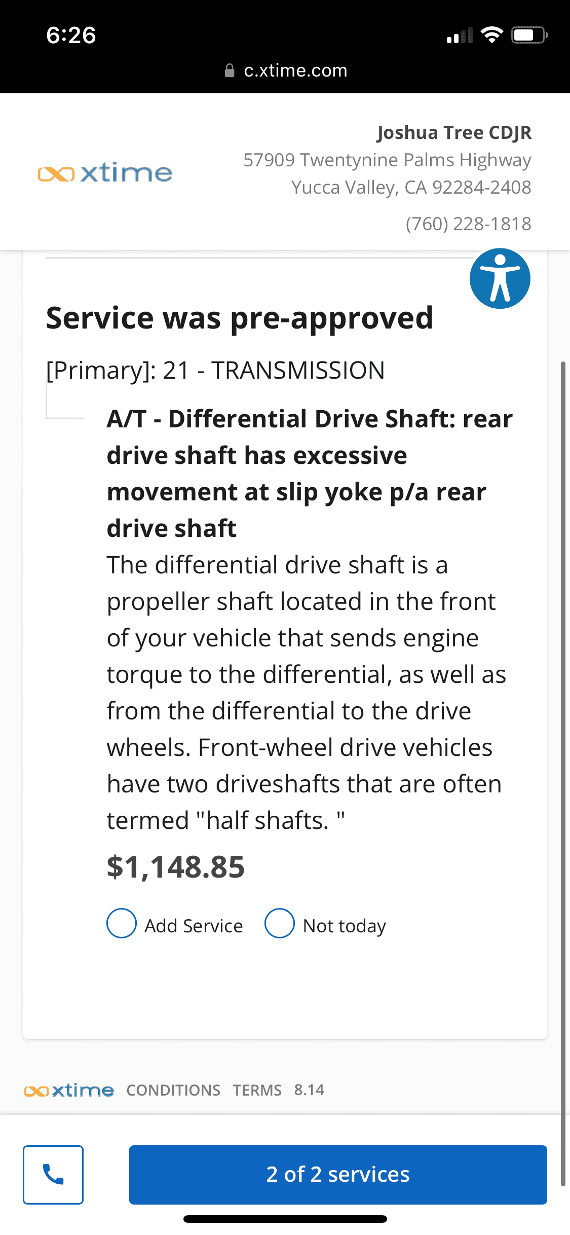

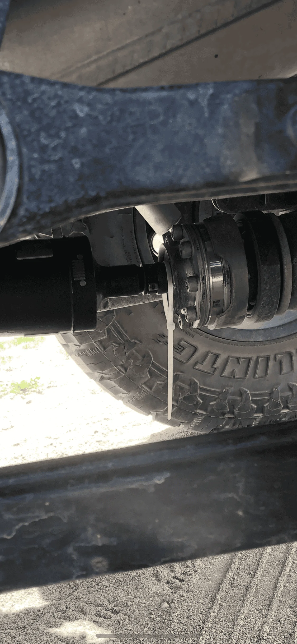

However, they now have confirmed they found the park to reverse noise but still cannot figure out where the noise is coming from. They originally removed the new driveshaft and found nothing out of spec. Yesterday they called and stated that the Mopar engineer states that greasing the yoke could fix the P-R issue which sounds more like a bandaid..

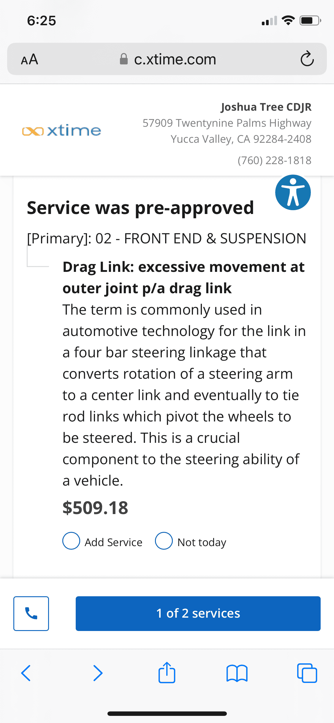

Steering - they state TSB for the steel box is complete and it fixed the steering wandering

6/10 - We requested the invoice before picking up the truck to ensure everything was completed and we weren't being billed for something crazy since the dealer has been playing games since we first started. We received the invoice and no TSB on the steering box was done, dealer states they spoke about it but it didn't need to be replaced (after being approved on 4/10 and being told it was completed 4/18)

The wandering/loose steering is still present but today is day 100 of it being in the shop so we’re just stoked to get it back and will address the steering tsb at a different time..
All in all the noise and shift issues were caused by the transmission but we ended up getting a new transfer case, rear end and driveshaft in addition since the trans was the last thing they replaced.
