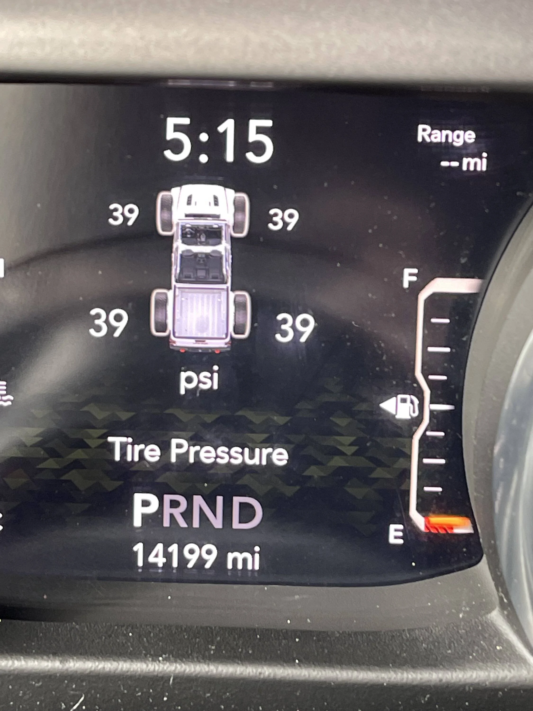

So, I’m looking at the tire pressure, all at 39. That maybe the problem. Everyone is suggesting about 34, so I’m going to try that. I’m assuming that won’t hurt the tires either right? I don’t know why the Dealership didn’t suggest this. I would’ve tried replicating with my sons Jeep, but it’s with him in CA but in driving cross country with him in his Jeep, didn’t have that issue. Thank you everyone, I really appreciate your input.

id suggest MAYBE a lower cold tire pressure. Remember that cold means as the vehicle sits un driven for several hours (typically left alone overnight) lowering the pressure too much may work for some folks but its not necessarily the manufacturer suggested fix. Ive never ran MT tires and im aware they’re more sensitive to road input…but im always leery of under inflated tires so I usually just stick to the pressure set on the B pillar door by the factory.
if yours are 39 COLD…then you are over inflated and that may be part of or your whole issue.
