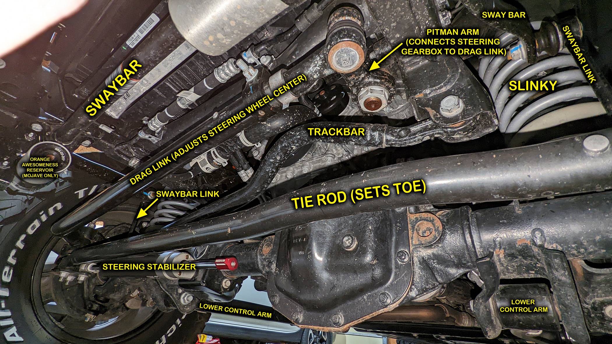

After a few wheeling trips I smashed my steering stabilizer but didn't notice due to it being covered in a plastic sheath. You could try looking at that if you are still on the stock one as opposed to the metalcloak one.

Steering stabilizer looks good. Now I’m wondering if it’s the steering gear box.

Took the steering stabilizer off and checked the torque on the entire front end. Still no change. Thanks though.
