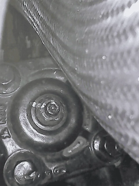

I just re-adjusted the set screw to closer to 1/8 turn. Still good feeling on the road (much reduced dead spot and slop) and after stress-testing like I did before the steering wheel felt good with no binding.
The obvious silver marker line at about 10 o'clock is the original position of the nut against the steering gear housing. The not-so-easy-to-see silver dot at almost 12 o'clock is the set screw position
Looks like about 1/8" turn or as close as you can tell without a Starrett protractor.

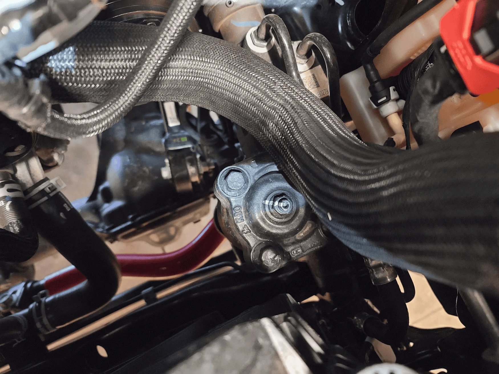

Had 3 to 4 inches of play in the steering wheel on my 2021 Rubicon.
Tightened adjusting screw clockwise slightly more than 1/4 turn.
Now have about an inch of play. A great improvement.
Maybe I missed it, but no one has mentioned the "W" word, wander.
The drifting left and right was making me crazy.
I bought my new to me El Nacho Libre with 15,000 miles on it
in January and was ready to sell it in February.
YouTube videos gave me the courage to try tightening the box.
I think I will keep it now, but am tempted to tighten it a skosh more.
