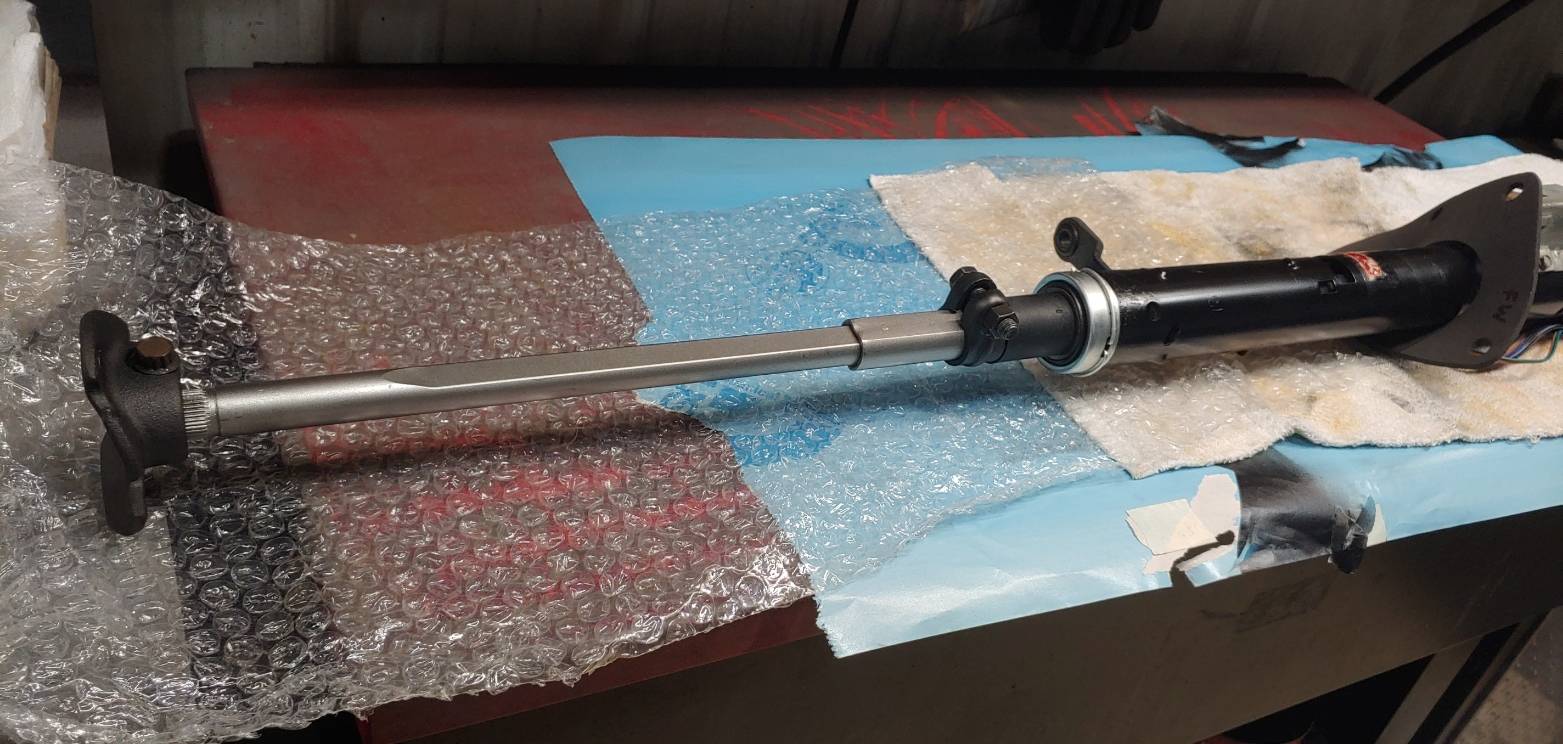

My Jeep is a bit loose at high speeds and seems to wonder. I have a 2020 Rubicon with 67k miles so out of warranty… anyone know if a dealership still replace with steel box for free?
at 130,000, mines starting to feel a little loose too, ugh!!
