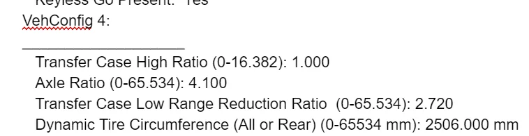

From my Mojave with ATs. MTs might be a different setting. That's only 31.4". Nice "33s" Jeep! Lol. "Dynamic" might account for the the lower calculated diameter there. When you input a tire size in the scan apps, they convert that to this Dynamic # in the BCM. The Jeep computer does not reference tire size in inches.

Make sure the scan app you use allows for inputting in mm for that setting. Don't convert it to inches. AlfaOBD allows this. Jscan might try and do the "user friendly" inches setting which it then tables to the mm's for Dynamic which won't line up the same as you would do with circle calculation.

It's that "Dynamic circumference" setting. The BCM has no entry or setting for tire diameter in inches. Some apps just calculate it from the Dynamic setting and report it to you, and then when you set it in "inches" in the app, the app calculates the circumference, does some calculation to come to that proper Dynamic #, and sends that to the BCM behind the scenes.
With AlfaOBD, when I send the "circumference in mm", a different # results in VehConfig 4 - the "dynamic circumference" setting.
