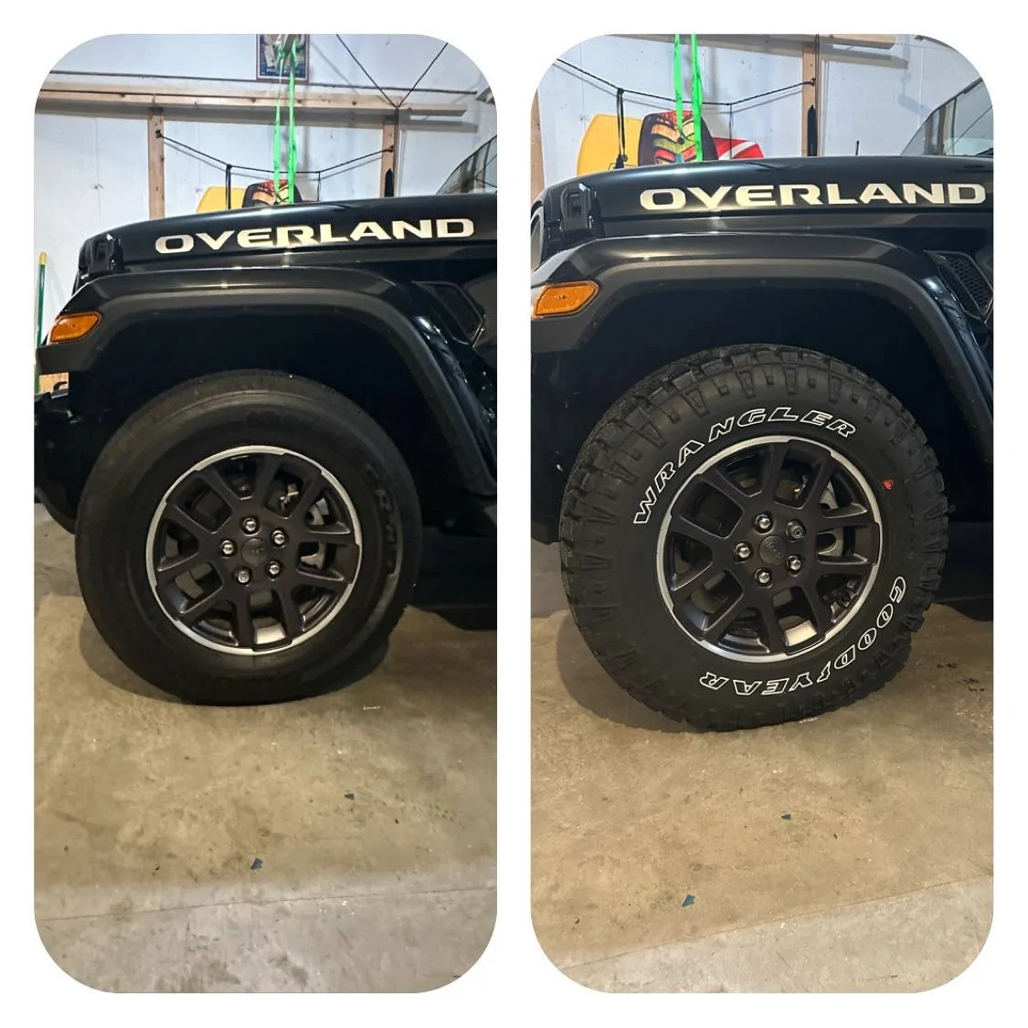

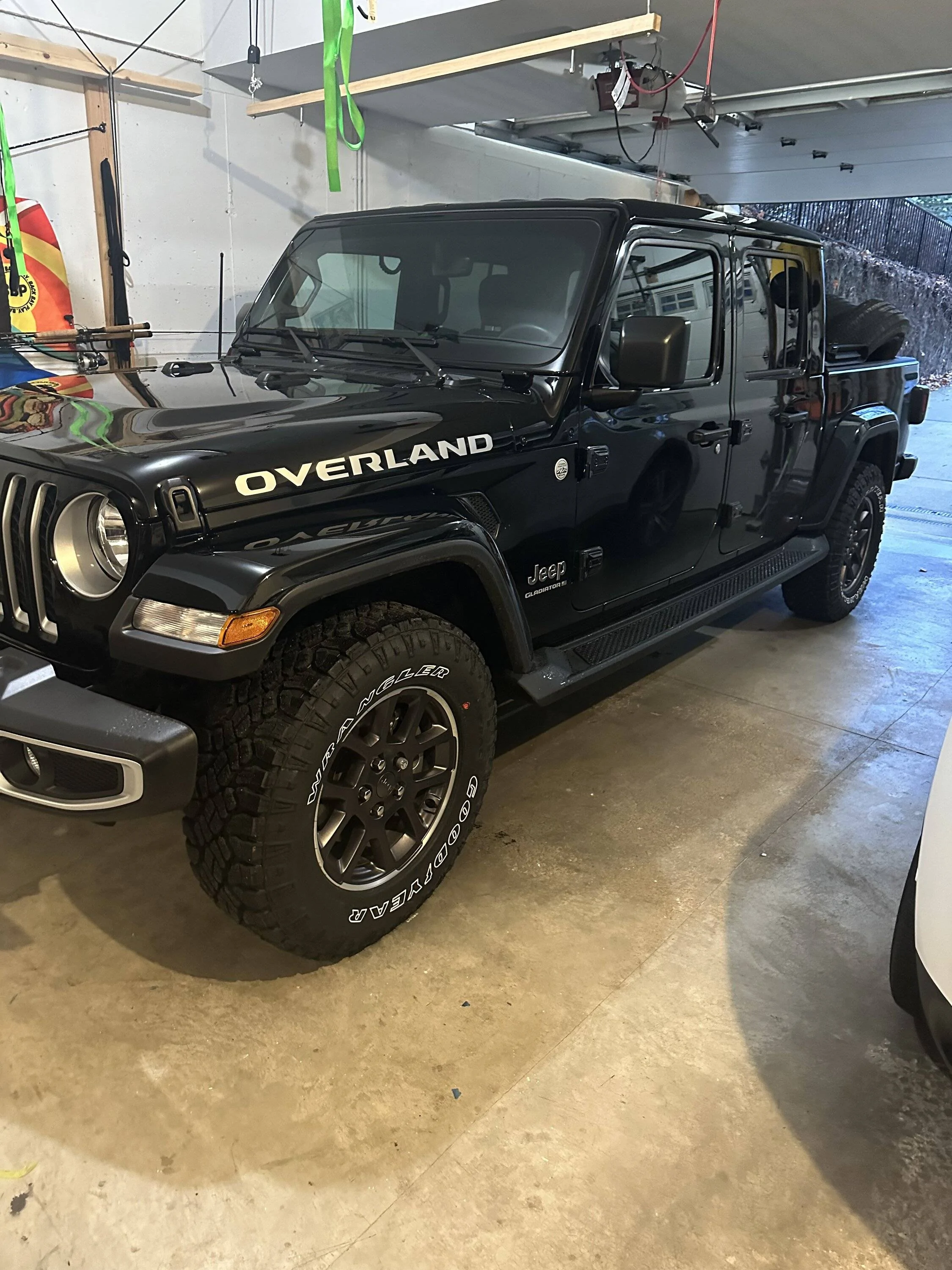

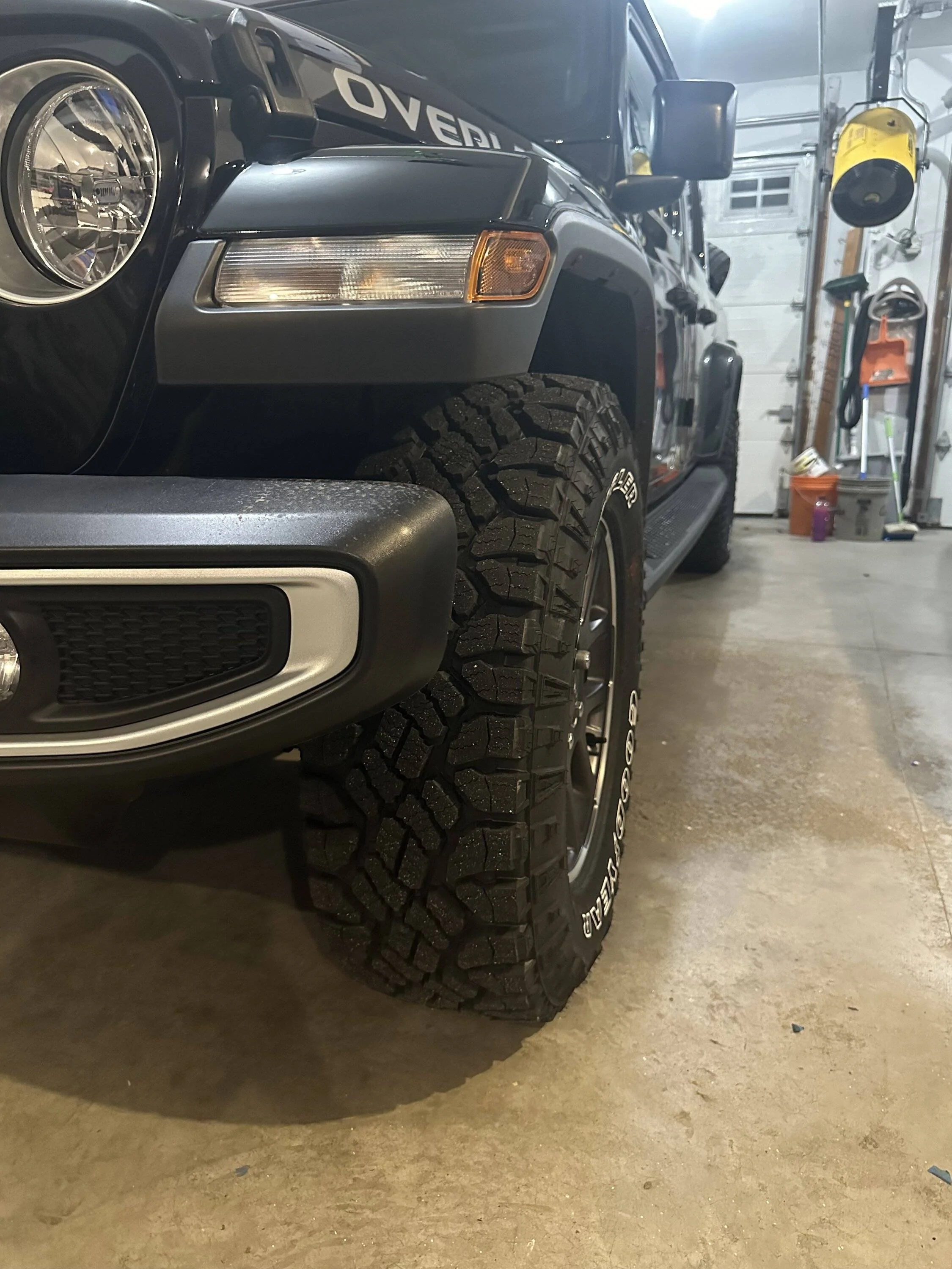

I know this has been covered a lot, here are some pics of stock overland wheels with 275 70 18 duratracs just installed if anyone is wanting to do the same. Only have a few miles on them so far, I’ll report back as they wear.

OWL out, bold move and I like it. Good job

Funny thing is the shop manager came and apologized they forgot to ask, figured I’d try it and so far like the look. What a difference in slush and snow today, much more solid.

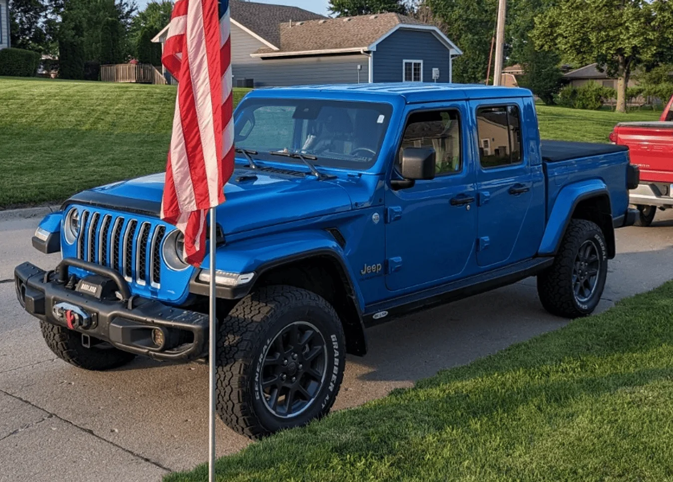

Yup - gotta agree, pretty gutsy.
When I had my Generals installed originally (bought through Jeep dealer - they matched the online pricing I'd found) they suggested it looked better with the RWL facing out.

That's a bit over 33" tire - larger diameter than say the Rubicon Falken A/T tires.
I believe that's a full 1" taller than the stock tires.
How does it do with those larger tires and the tall 3.73 gears of the Overland?
I'm hesitant to go taller at all due to the high gears these have.

I can feel it a little more sluggish around town, but feel that’s more due to the aggressive tread vs street tires. The truck feels more planted vs the stock tires. I have them at 38psi, haven't been out on the hwy yet to see the mpg hit, no problem cruising in 8th around 60 so far and Speedo off by 1mph at that speed so not noticeable.

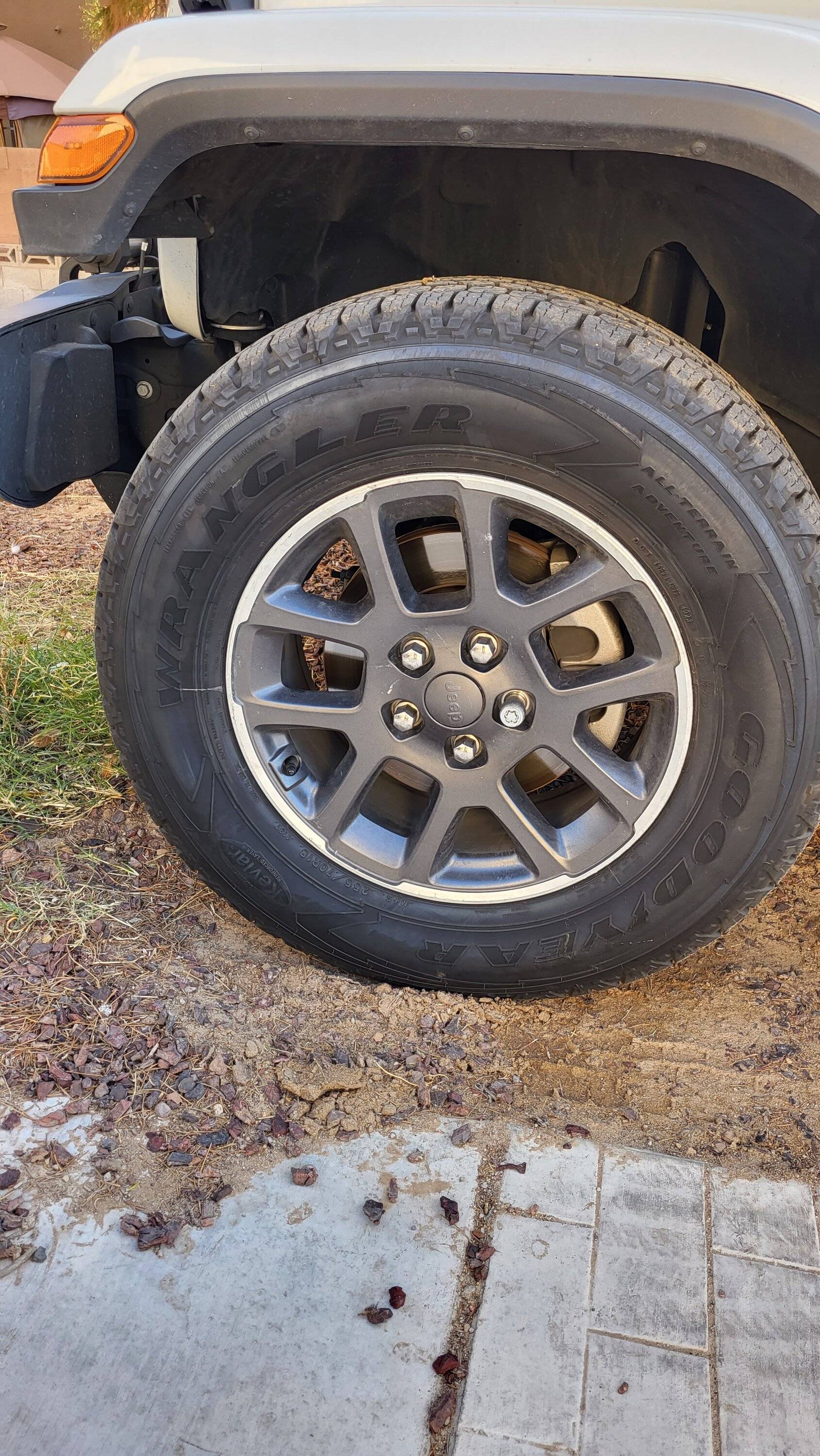

I stayed with the stock size. I replaced the street tires with the AT's that have the Kevlar.
I've been driving it over four years. I got my first duck after these were put on.
