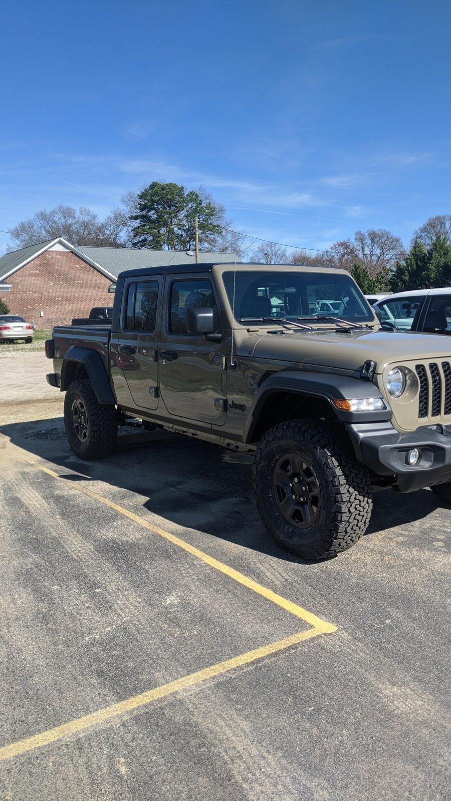

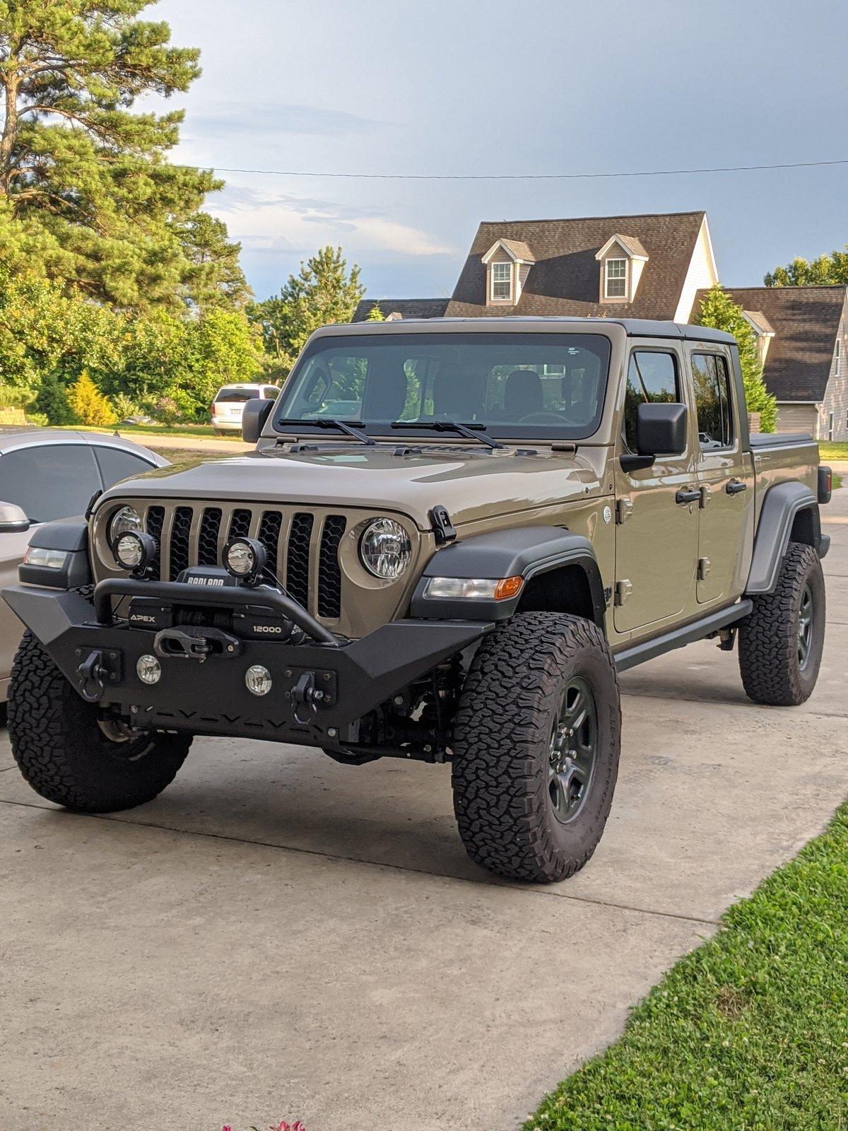

I recommend 315 70 17 BFG KO2S, they made little difference drive wise when compared to the stock wheels. I got a Max Tow with 4.10 gears so take that into account as well. Here some pictures.
No lift or wheel spacers

With 2.5" lift 1.75" wheel spacers and RR Spartan full width bumper and Badlands 12000lb winch
Jeep Gladiator Stock Rims With Larger Tire Question 00000IMG_00000_BURST20200619193653437_COVER

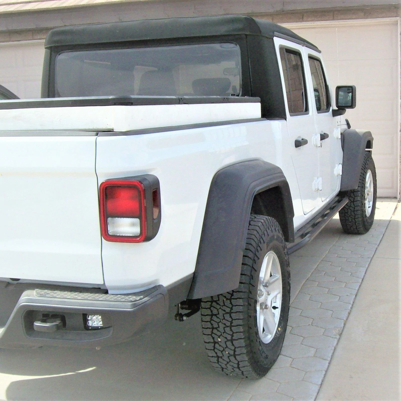

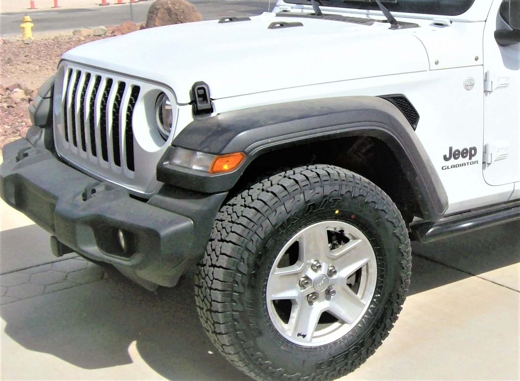

I prefer the Falken AT3W in 255-80-17 over the Rubi size Falken of 285-70-17. The 255s are 10.3 lb lighter, .3" taller, 10" wide instead of 11.2", better for snow and to clear suspension parts on turns.

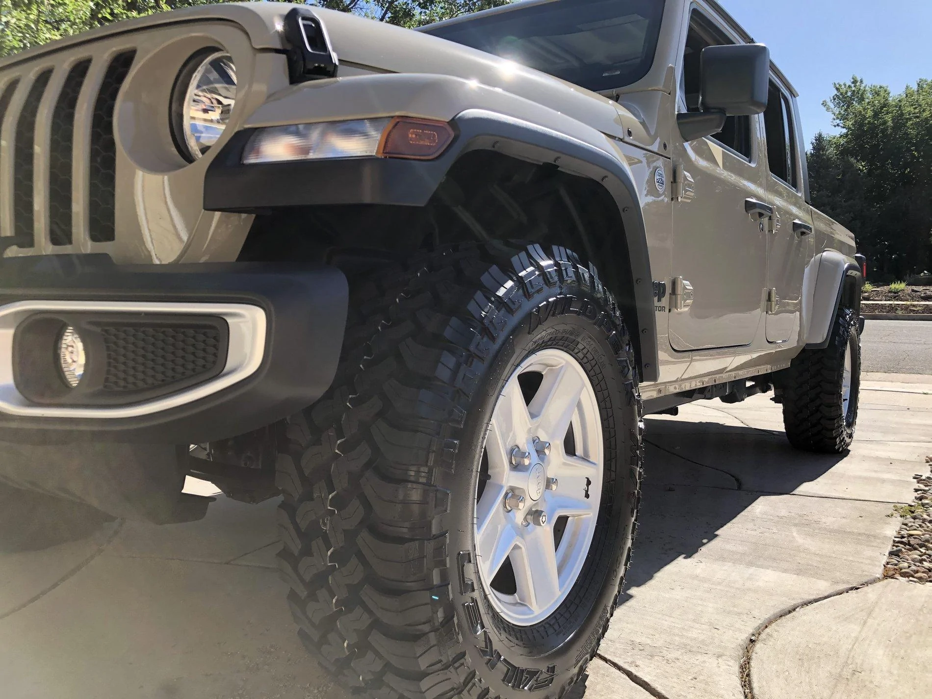

35 BFGs on stock rims with a 3.5" lift. Looking to sale them though as i want to run 37s on 17s

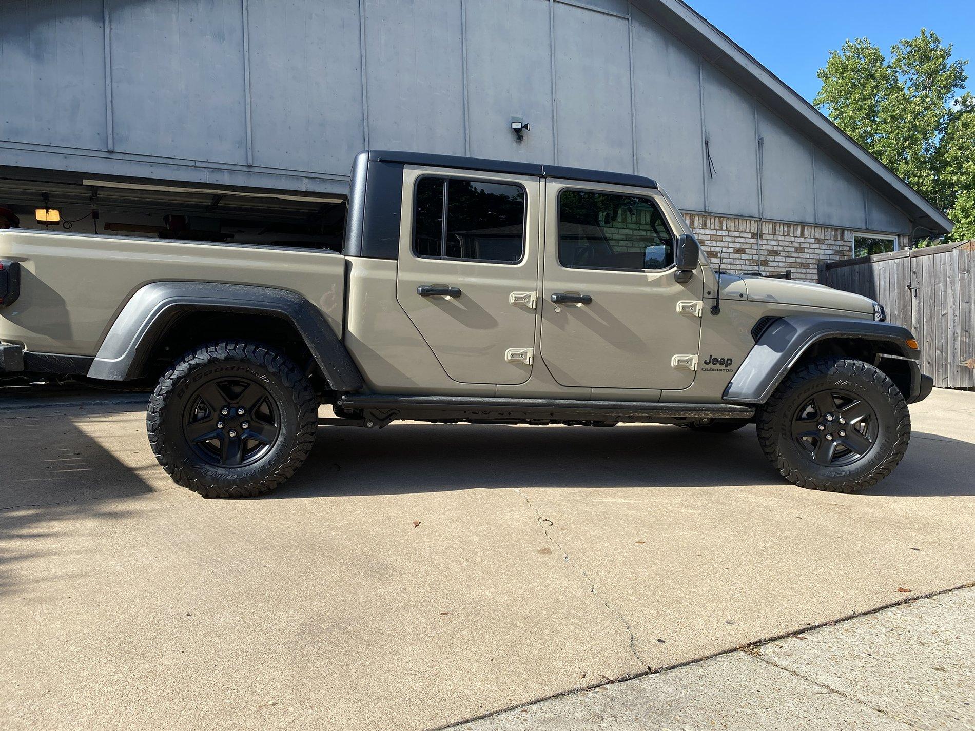

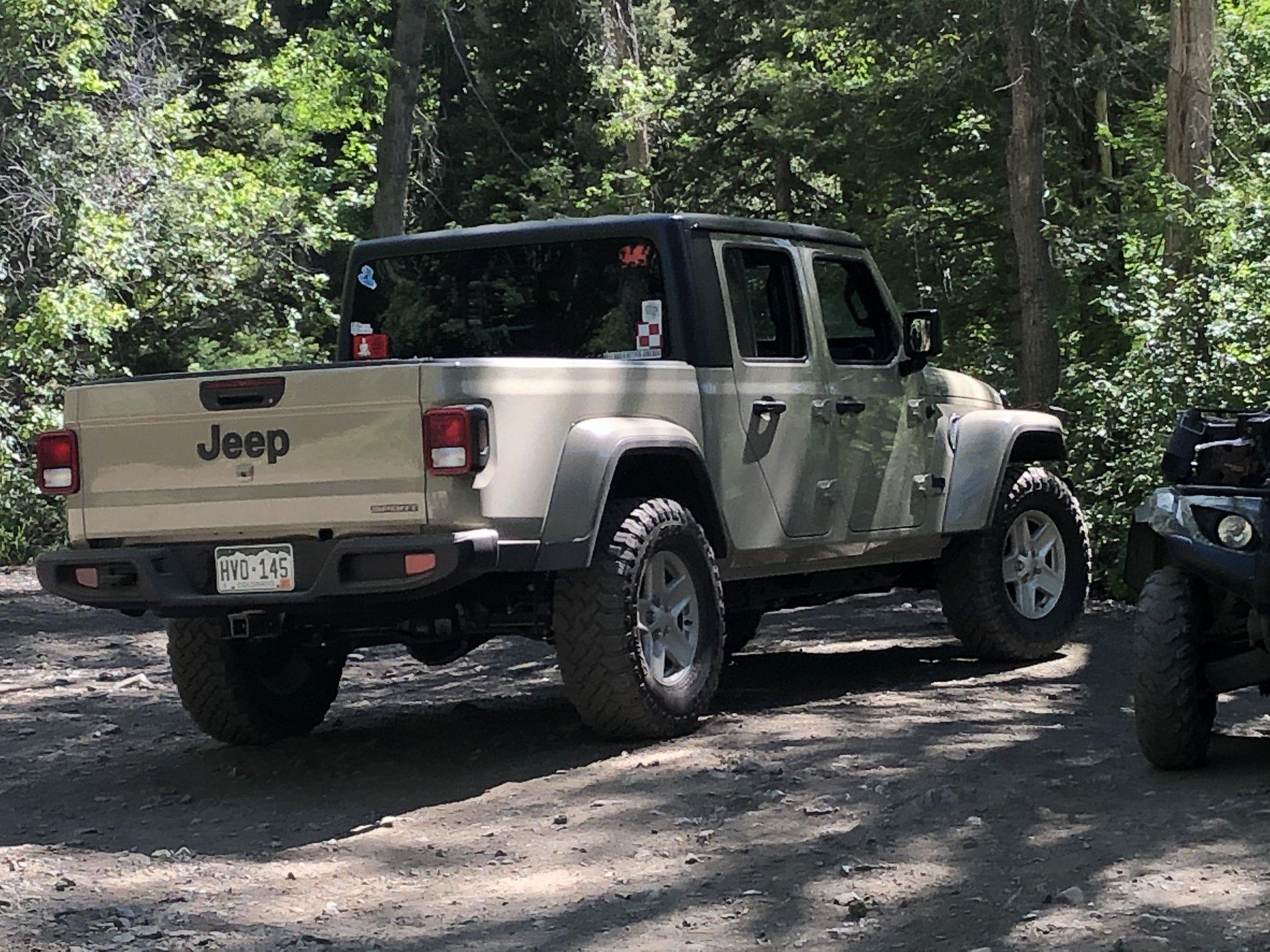

Here’s your stock Gobi Gladiator w/max tow package on BFG KO2’s (285/70R17) mounted on OEM rims powder coated in satin black. The ride is smooth, no discernible loss in power/handling/braking. No lift kit, no spacers, no rubbing.

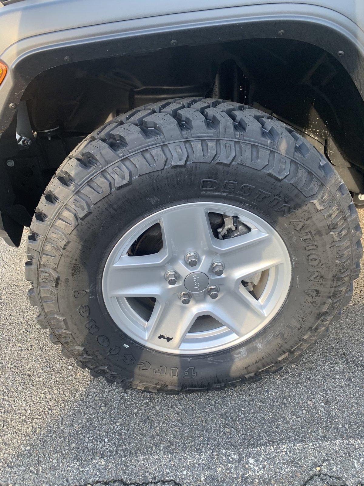

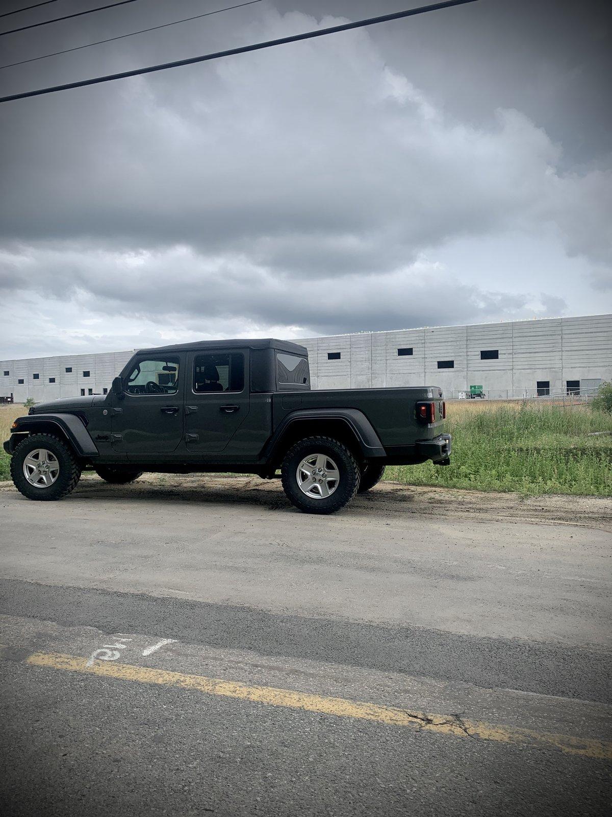

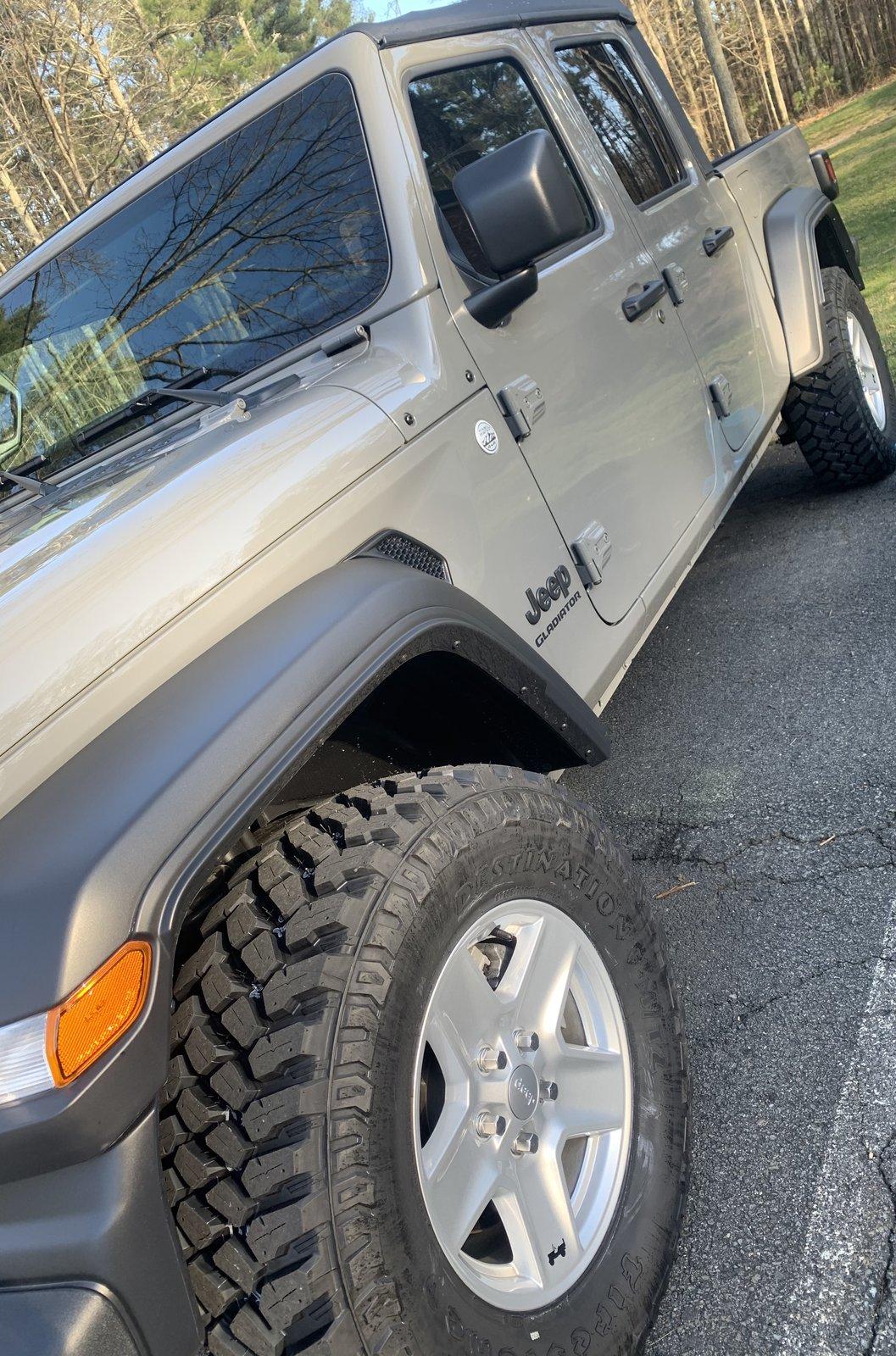

Firestone mt2 285/70r17 on a sport s max tow no lift. Debating on powder coating the wheels black. Definitely made the rims look much better!
Jeep Gladiator Stock Rims With Larger Tire Question A928D0D0-FE00-44E6-9F57-1377F622C340
Jeep Gladiator Stock Rims With Larger Tire Question 8B0F6E57-FC99-42CE-97C0-9788443E67B4
Jeep Gladiator Stock Rims With Larger Tire Question B2999E11-295B-4C79-96E4-6206CD55CFA5
