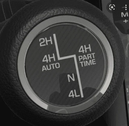

Just curious without reading the book then googling and forum searching for days. I'm new to the Jeep world with my 21'Gladiator 80th anniversary. Fsr as I can tell it would be like a Sport S pretty much (maybe I'm wrong) I'm from the Chevy world specifically the Duramax world. The transfer case on this unit says 2wd 4wd auto then 4wd part time then low. An someone explain how this unit works exactly? I get auto, I assume it must kick in and out when something slips but then 4wd "part time"? Wtf thats new to me...

4 wheel drive PART TIME is where the front and rear driveshafts are locked together in the transfer case. It does not allow for any speed difference at all between front and rear axles.
NEVER use this on a solid surface like concrete, blacktop and so on.
It's exactly like any other older pickup with a 4 wheel drive high option. You'll "wind up the drivetrain" and cause stresses and even make it hard to get back out into 2 wheel drive.
The 4 high auto is a system with clutch packs and it reads the relative speed of the 4 wheels and if it "sees" a slippage problem it engages the clutch packs inside the transfer case to transfer torque to the front driveshaft as needed.
It's a rather complex system.
You can run it on any surface - like a highway with some ice, then clear spots for a quarter mile, then ice and show, then clear again and not have to shift in and out of 4 wheel drive. You can leave it in that position in heavy rain, snow and ice.
4 high part time you would need to take it out of 4 wheel drive for driving on dry pavement between snow drifts.
My 2011 Silverado 4x4 had an "auto" mode for the dial on the transfer case - it was similar. You could drive it on any surface and it only engaged when it detected wheel slippage.
this is really nothing new at all - it's a system similar to that in other Jeeps like the Grand Cherokee and so on for years, similar to modern Chevy and Ford with an "auto" position for the transfer case.
When I say how it works is complex - it's sort of counter to what you'd expect. When sitting at a stop light in 4H auto, the clutch pack is actually engaged and with the right software, you can observe how it applies, what percentages of application and so on.
But again, it's not really different than what other vehicles have used - maybe how it shows you or the names it uses, but it closely matches the "auto" dial on a Chevy truck.
2 is exactly what is says - 2 wheel drive only. The FAD (Front axle disconnect) has split the right axle and there's no power going to the front driveshaft.
4H auto is 4 wheel drive - automatic mode. It senses wheel slippage and delivers torque to the front and/or rear driveshafts as needed via a clutch pack system.
4H part time is - use it on slipper surfaces only - not dry pavement, etc.
4L is 4 low, a low gear ratio for crawling slowly on tricky surfaces - like any other transfer case for the last several decades.
If it's got the 4 high auto, it's Selec-Trac
It's an option on Gladiators,
but it's standard equipment on Wrangler 4xe (4 by E) PHEV.
That's because those are high torque hybrids and the torque output is limited on those in 2 wheel drive but slip it into 4H auto and it no longer limits torque and is a real demon among Jeeps.

I see, so when winter hits, for city driving its 4wd auto (similar to a chevy half ton) in thia thing. Then 4wd part time for a mild trail at moderate to regular speed within reason and 4wd low for the low speed stuff as normal. The 3/4 ton and 1 ton chevys don't have auto (until 21' + I believe which changed the dmax city/towing winter city driving 4x4 game IMO) but I am familiar with the half ton Auto tcases too. 4Low is a rare necessity with those and if you need it you were probably looking for it. A jeep is a different bread built for a different purpose. Being that mine isnt a Rubicon I'm sure its not as purpose built but I can only assume should still function well enough. Thank you for the info and well said description. Gives me a better insight here to go from. I have a lot to learn here. Trying to avoid the modding bug on this thing but I've already started with a few minor things that add up fast. I really shouldn't have made this account haha. Appreciate the info though. Thank you

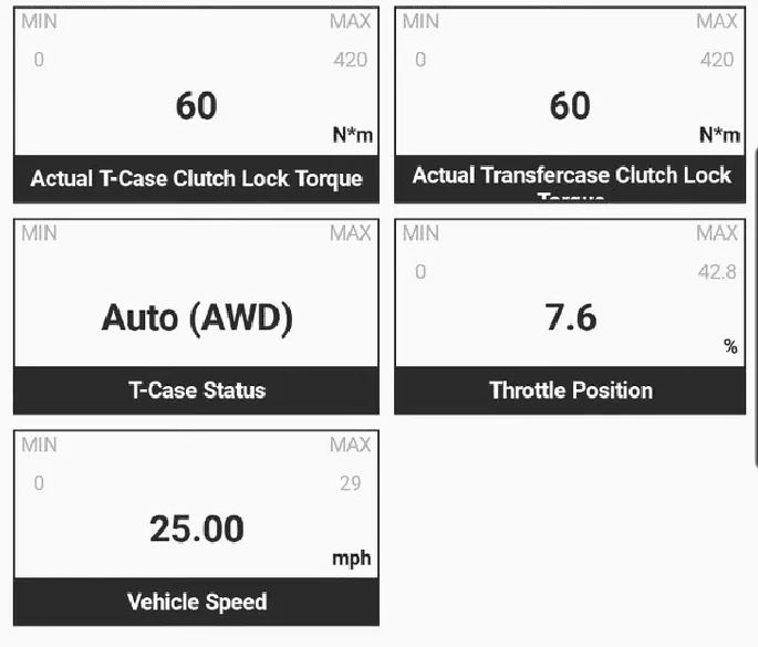

When in 2wd, the clutch pack is relaxed.

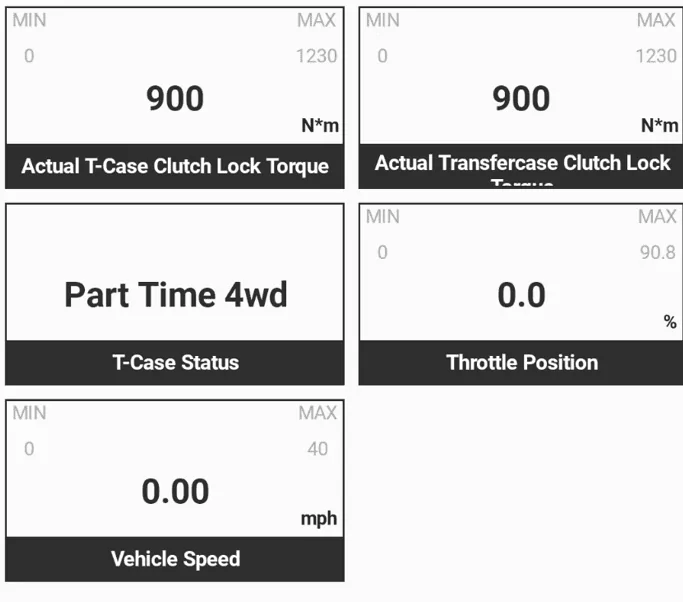

In 4H part time, the clutch pack is fully locked
In 4H auto, when you are stopped or driving very slowly, it's locked, then as you increase speed, it relaxes and unlocked but there is a little pressure to be "on the ready" for wheel slippage.
4H auto - slow speed

4H part time -
Jeep Gladiator Stock Tcase 1692457112508
