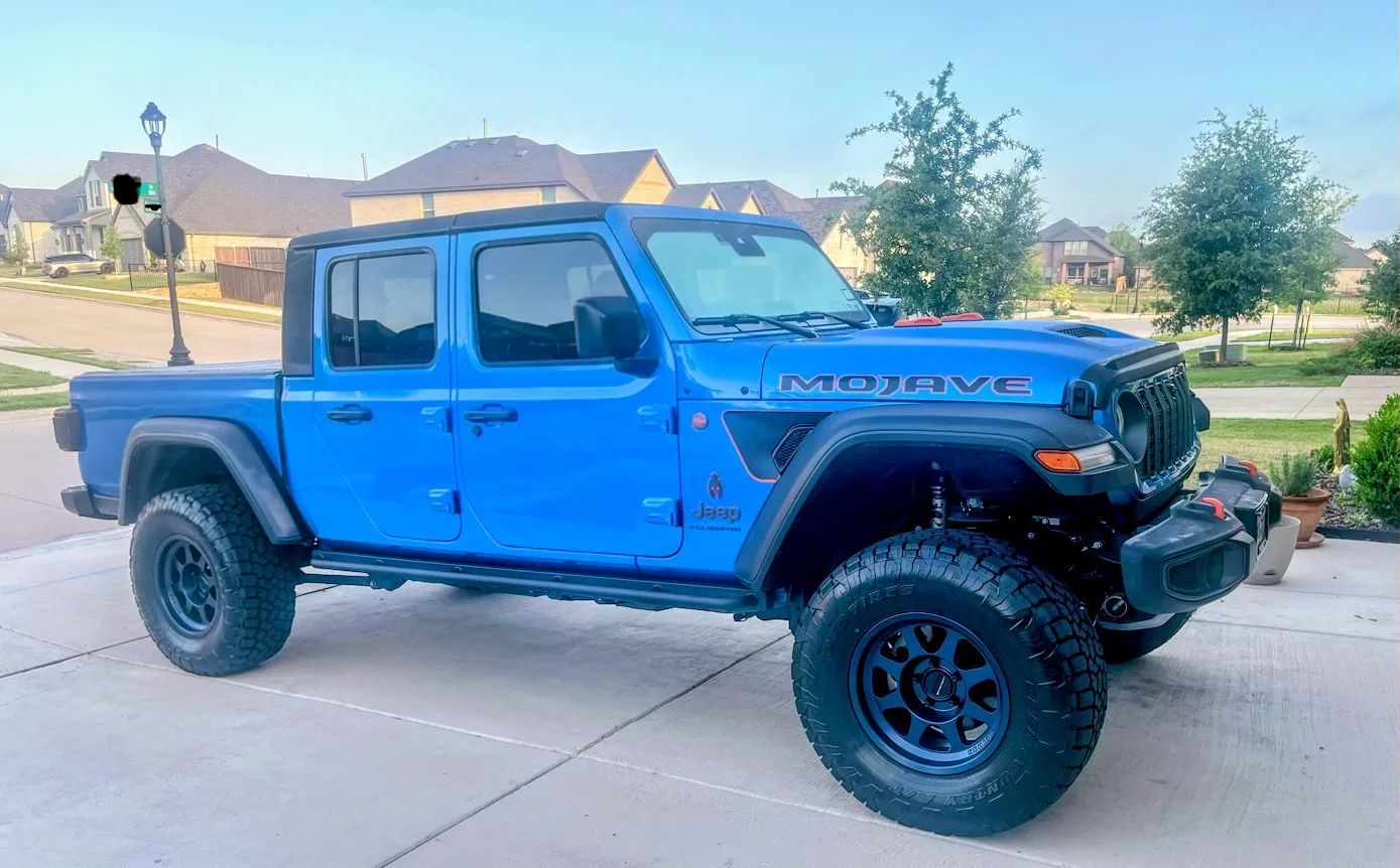

I have a '24 Gladiator Mojave, with 3" JKS J-Kontrol Mojave lift, still have the stock 4.10 gears. I am about to put on 37" Nitto Recons, with the idea of eventually re-gearing. Do you think I will be find for a few months without re-gearing? I use it mainly as a daily driver, in town & hwy, with some light trails and pasture land. Will I be ok? Is this a horrible idea? My Gladiator currently has 13,800 miles... Pic is current with 35" Toyo AT3

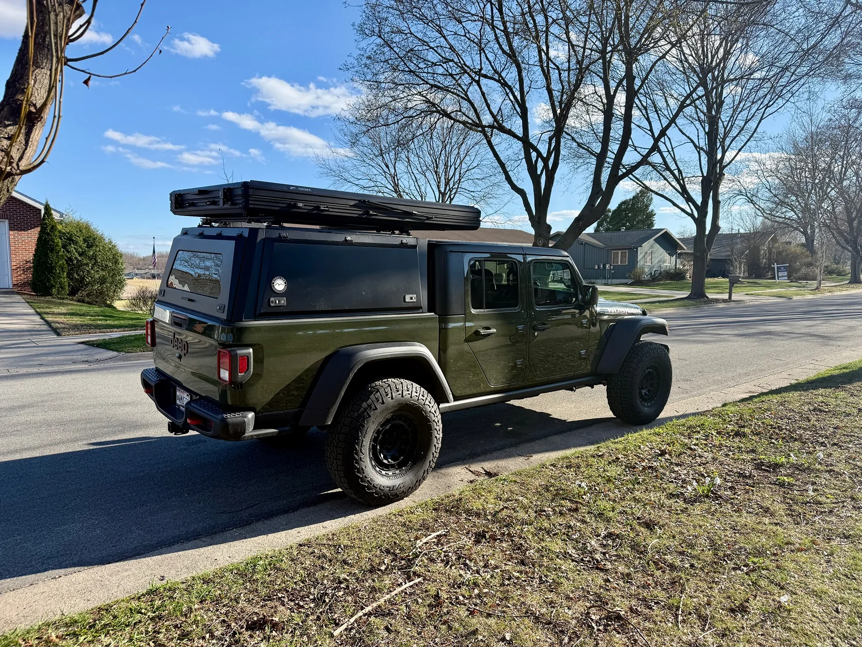

I’m on 37’s with 4.10. It’s fine so far. Will likely regear in a year or so, but none of my trips until then will need it. Be sure to update the computer to get the shift points updated.

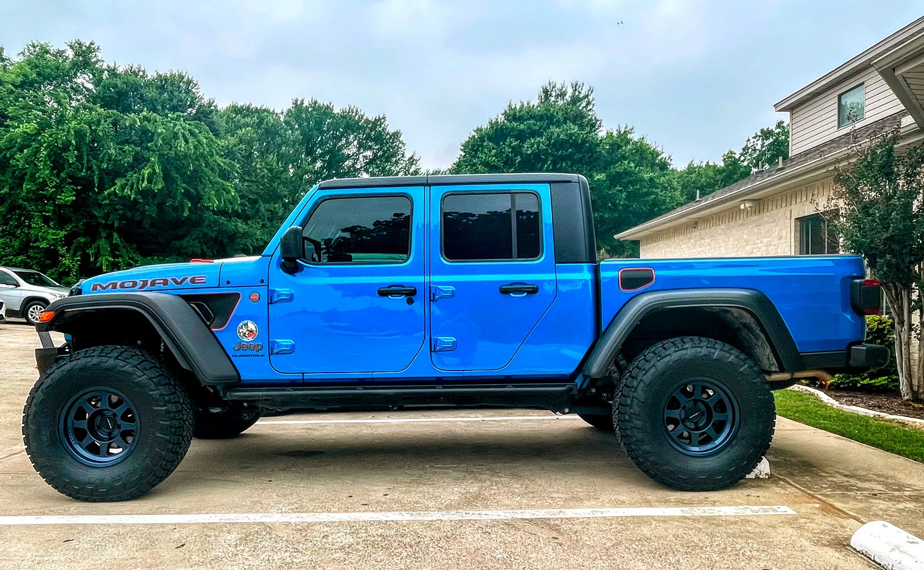

These look great.

Well I made the leap to the 37x12.5x17 Nitto Recon & I am glad I did!
Looks great Steve. Now how are you feeling about the 4.10s? Once you set the tire size appropriately and let it learn the shifting I think you'll find it is very liveable.
Looks great, gorgeous color!!!😜
