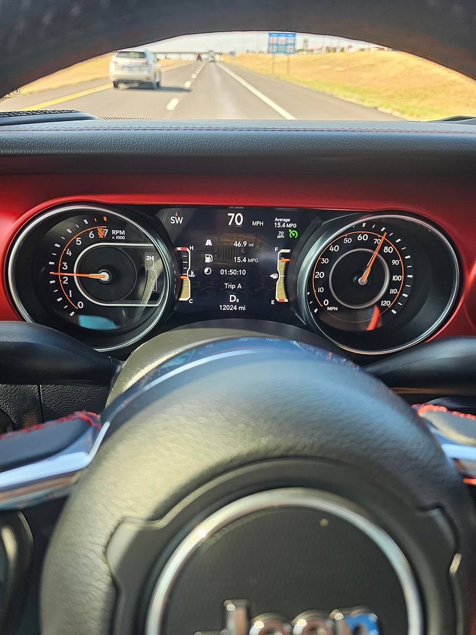

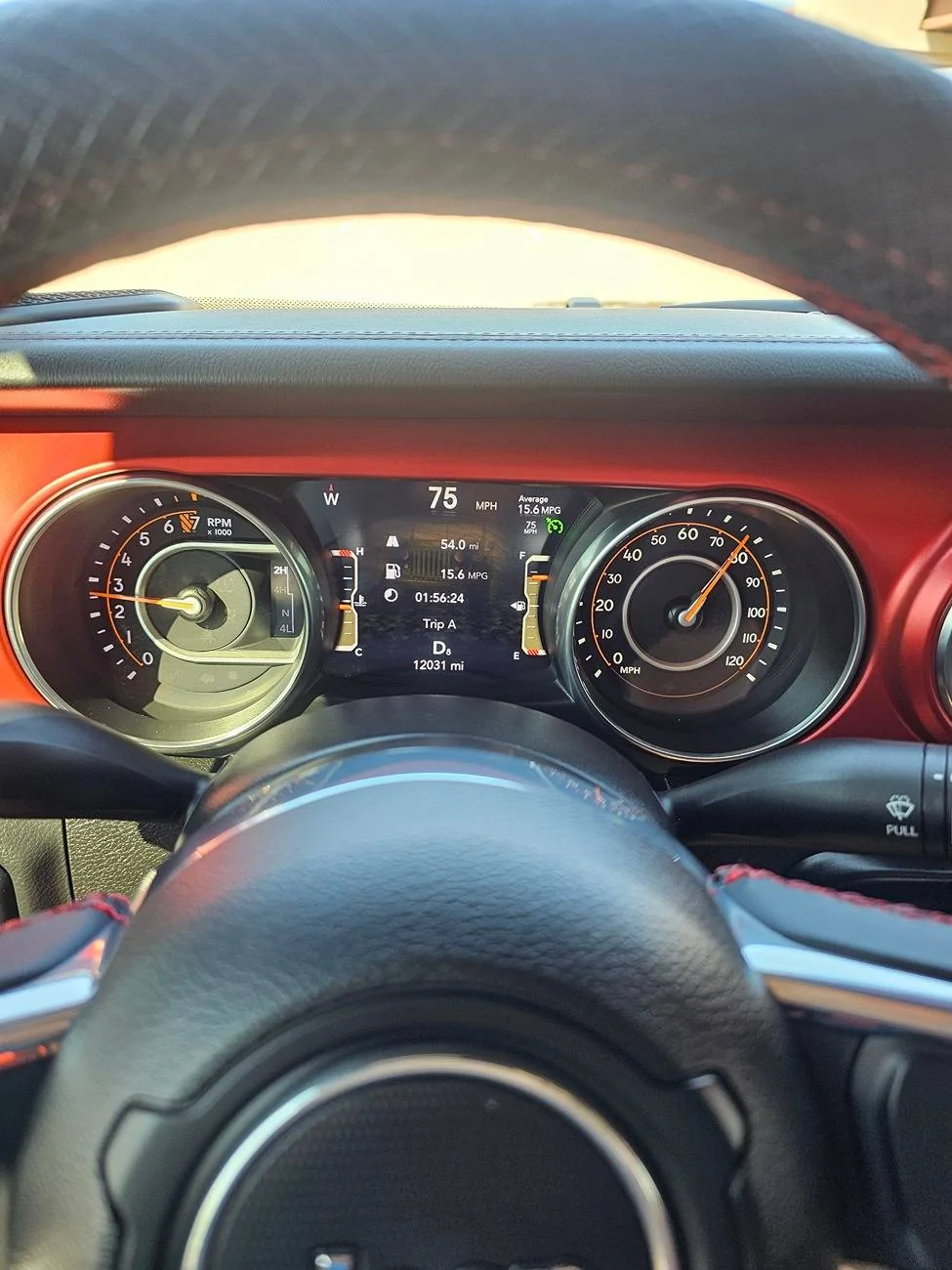

Good for you glad you've found a 3.6 that can hold 8th with wimpy 3.73 mall crawler gears on 37s you have a unicorn 😆🤣. I have almost 150 miles on my 5.13s and I've had it up to 60 for a brief moment and was only doing 2k RPM. At 75 I'll be 2580 which is perfect as the 3.6 makes peak torque around 2500. Been babying it and it feels like a rocket from a dead stop. Gas mileage went from 15.5 to 17.3.

You might be right but 8th gear didn't exist unless on flat surface no wind. Why have an 8sp with those results? Have all the power in the world now plus get 1.5 to 2 mpg better. That's a win win if you ask me. Less strain on the drivetrain at highway speeds as well.

All I know is hunting between 7th and 8th all day my mileage would drop off which tells me I'm working my vehicle harder. Worst thing you can do to a motor is lug it. 3.6 makes very little power below 2k. 5.13s were the best mistake I've ever made. Pulls up hills with ease in 8th. Consistent RPM is much better on the highway in the long run.
