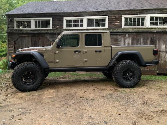

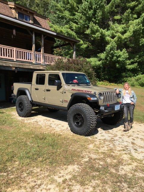

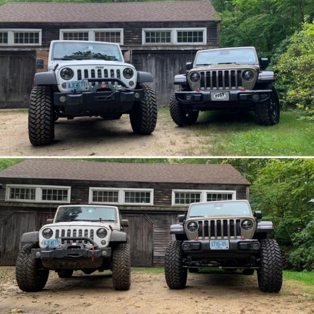

Ok everyone...so I got the truck, drove it for several weeks, and have since lifted it. I went with the Evo 4.5" lift, 40" Nitto Trail Grapplers, Borla exhaust, upgraded almost all of the drive train. For gears I went with 5.38. It towers over my JK which is not small but still rides like a freaking dream. I'm so happy with it. Next month it goes in for a Ripp supercharger. :involve: Check it out!:
